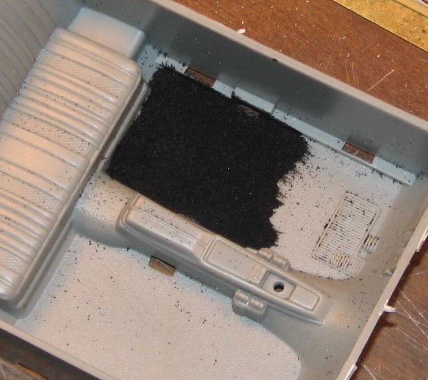

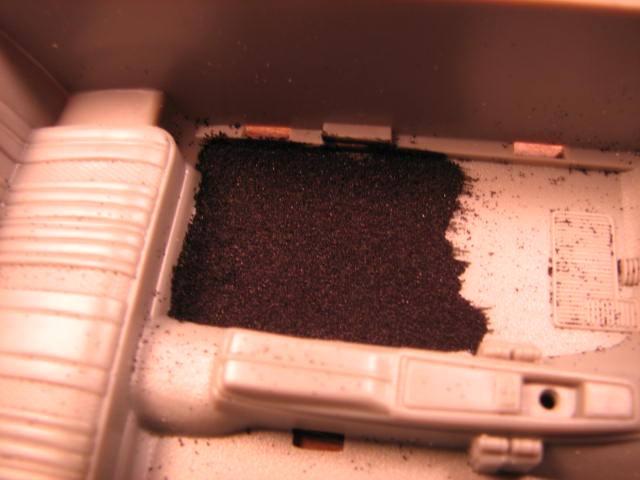

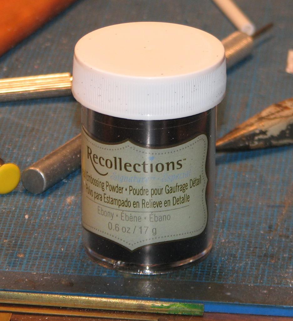

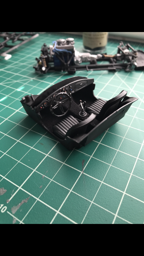

Straightliner59 Posted October 11, 2017 Posted October 11, 2017 Yesterday, I was at a Michael's store, looking for flocking. After unsuccessfully searching, I asked an employee, who referred to their computer and informed me that they didn't carry it. So, I looked in the scrapbooking, stamping and card making area, and found something called "embossing powder". I was looking for black flocking, so, I neglected to look to see if there were other colors. When i got home, I tested the embossing powder over flat black paint. I am pleased with the result! I think it looks very nice as the short pile that carpets many cars. What do you guys think? Am I all wet, on this?
cobraman Posted October 11, 2017 Posted October 11, 2017 Hey Dan. That stuff does work well. Guys here have been using it for quite awhile. You can search and find a topic about it.
Straightliner59 Posted October 11, 2017 Author Posted October 11, 2017 Hey Dan. That stuff does work well. Guys here have been using it for quite awhile. You can search and find a topic about it. Awesome! Thanks! Now I know I'm not entirely nuts--at least by myself!

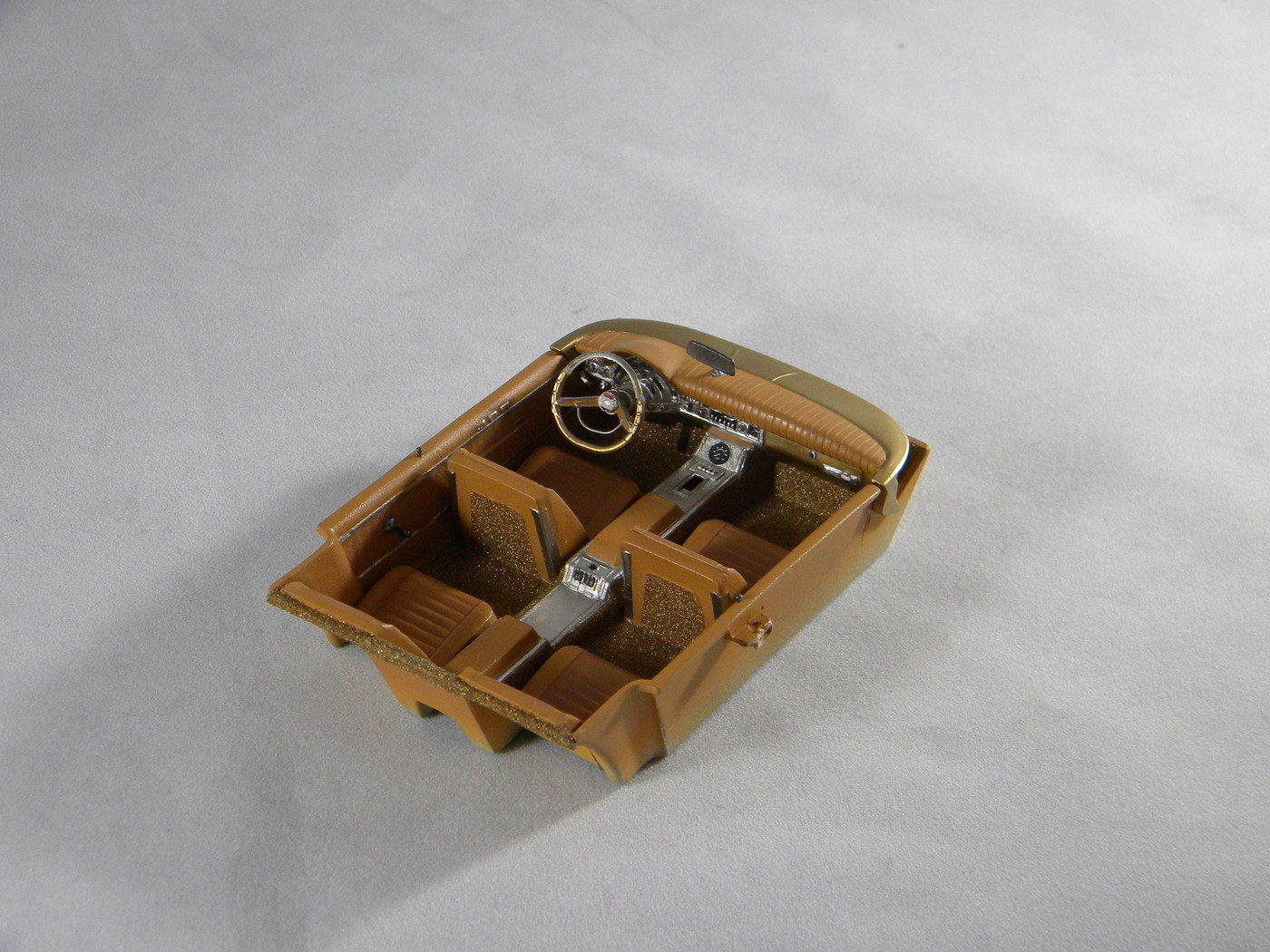

Alix Bernard Posted November 6, 2017 Posted November 6, 2017 Steve those tubs look FANTASTIC!!!!! The carpeting/ powder really looks 1:1.

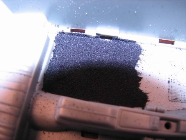

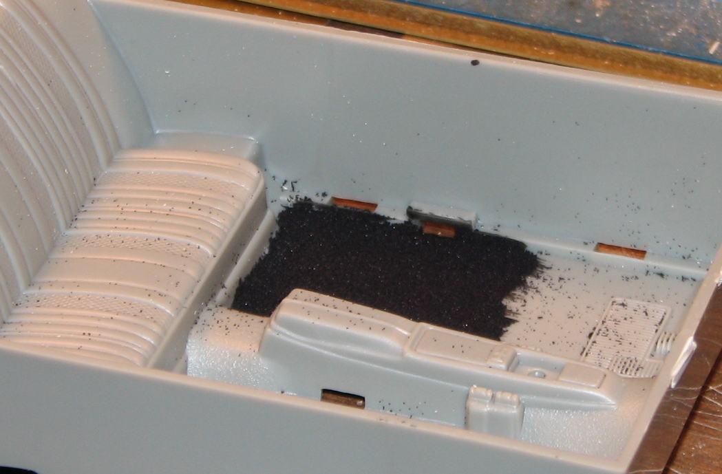

gtx6970 Posted December 3, 2017 Posted December 3, 2017 (edited) On 11/6/2017 at 6:50 PM, KWT said: Out of curiosity... since I've missed out somewhere on this and flocking... how does one go about using this? Paint the floor area ( or what ever you want 'carpeted ' with a like color paint ( some use clear elmers glue ) While the paint is still quite wet , sprinkle the embossing powder on it. Once dry turn the tub over and shake to remove any excess.,,,, viola , carpet. Edited December 3, 2017 by gtx6970

StevenGuthmiller Posted July 3, 2018 Posted July 3, 2018 2 hours ago, NYLIBUD said: Just looks like a big mess to me.I don't know,my skills aren't that good I guess.I just buy the stick on fabric sheets from AC Moore,or any craft store.They work fine if you ask me.Yes,they only have a few colors,but most of my carpets in my builds are usually black anyway. You would be very surprised on how simple & economical embossing powder is to apply. Basically no skills required whatsoever. Especially if you're doing a modern "platform style" interior. If you can operate a paint brush & run a salt shaker, you can apply embossing powder. It's one of the easiest aspects of building in my opinion. I can flock a carpet in a matter of about 10 minutes if it's not an older "tub style" interior that requires some masking. But then those interiors usually require masking for painting anyway, so it's a moot point. Steve

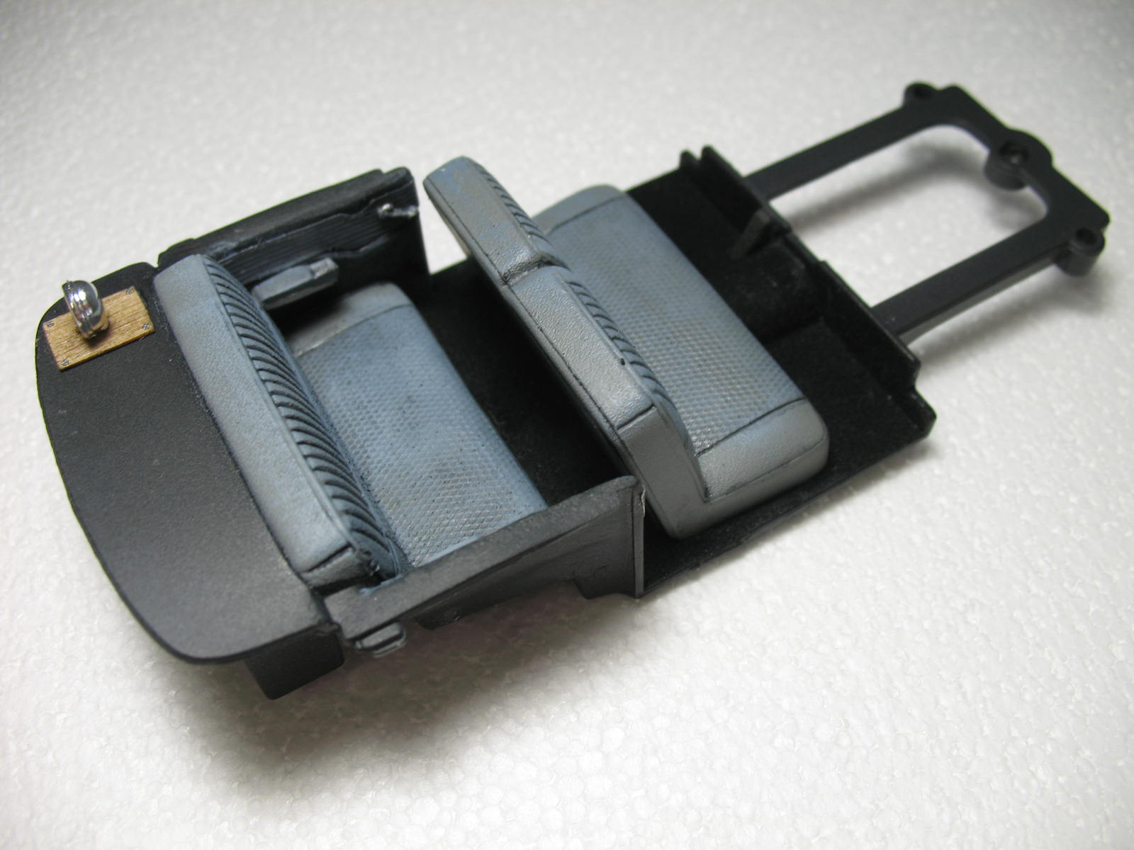

Mike999 Posted July 4, 2018 Posted July 4, 2018 (edited) Another vote for embossing powder. As everybody says, it's dead easy: paint (or white glue) on the floor, shake the embossing powder onto the wet surface, then turn the interior upside down and knock off the excess. If you have thin/bald spots, just carefully re-apply a little more powder The (bad!) photo below shows that "Recollections" embossing powder on the interior of a Maisto die-cast '55 Buick California Highway Patrol car. I had to work around the accelerator pedal, which is molded in place. Here's a Bonus Tip in that photo: the quarter-panel upholstery was made with HO-scale corrugated metal. (Armrests/ash trays are made from Evergreen rod and the window cranks are from the parts stash.) I did a little more wash/dry-brush on the seats after the photo was taken. I wanted the seats to look sort of used and grubby, it's a cop car. I could have made the back seat area even grubbier. While the 1955 CHP didn't usually transport prisoners in the back seat, they sometimes carried DUI arrests to the local lock-up. But a Technicolor Yawn might have been a little TOO much realism... Edited July 4, 2018 by Mike999 error
