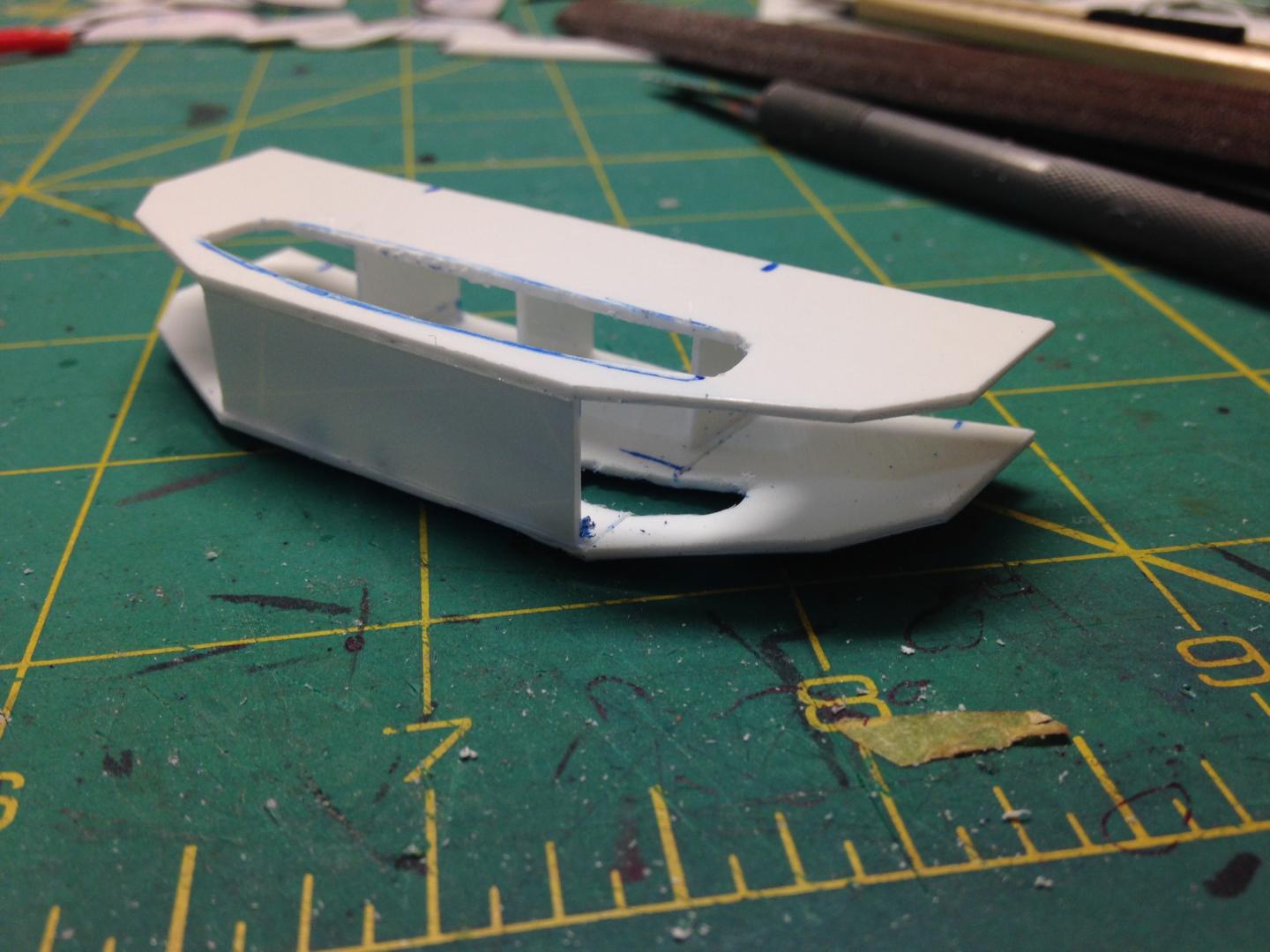

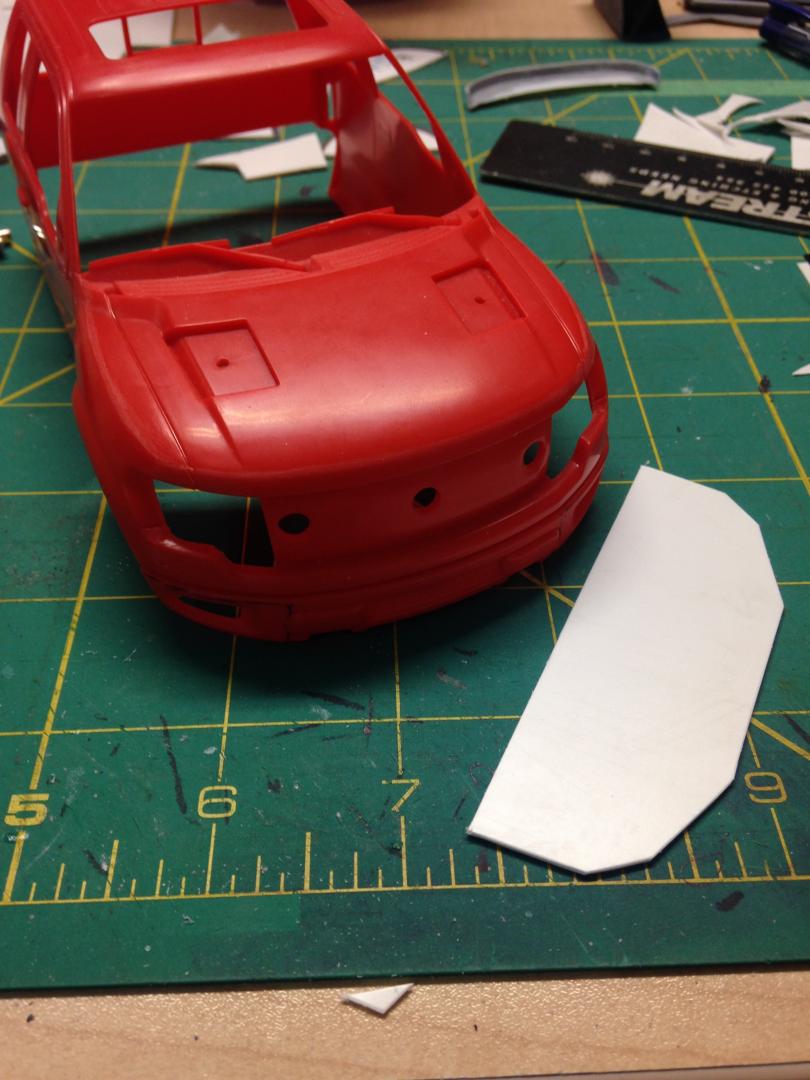

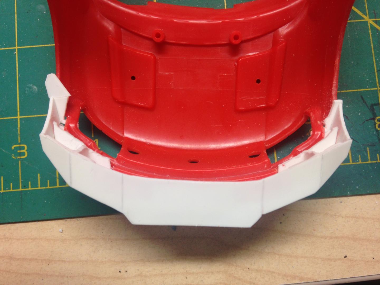

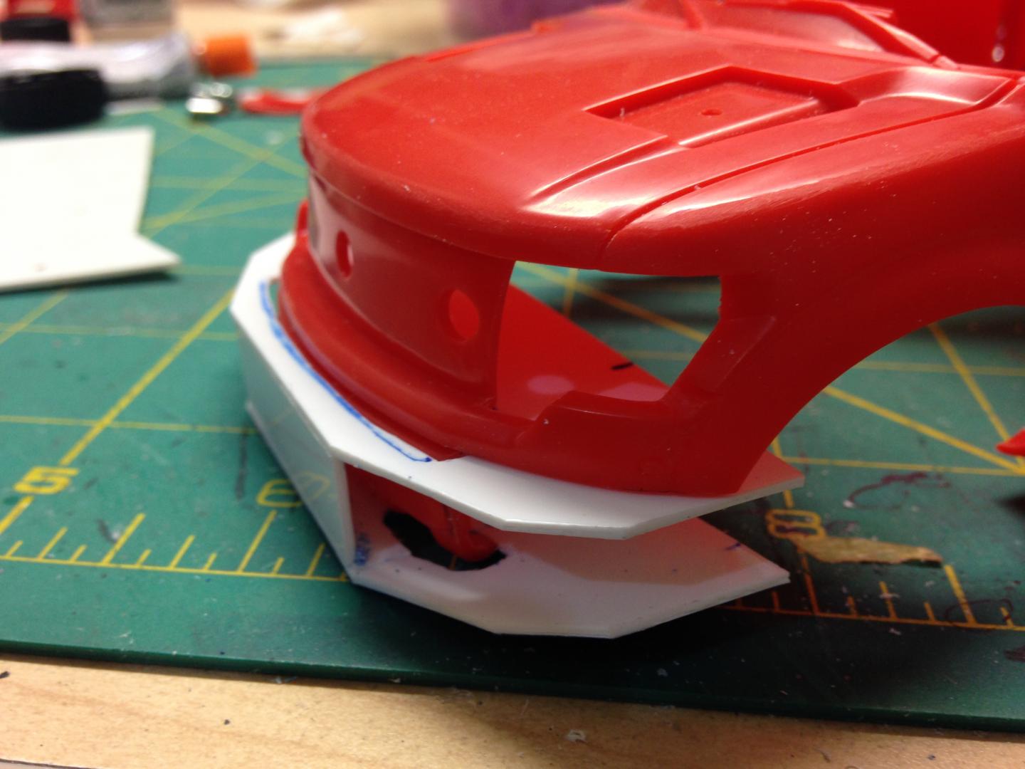

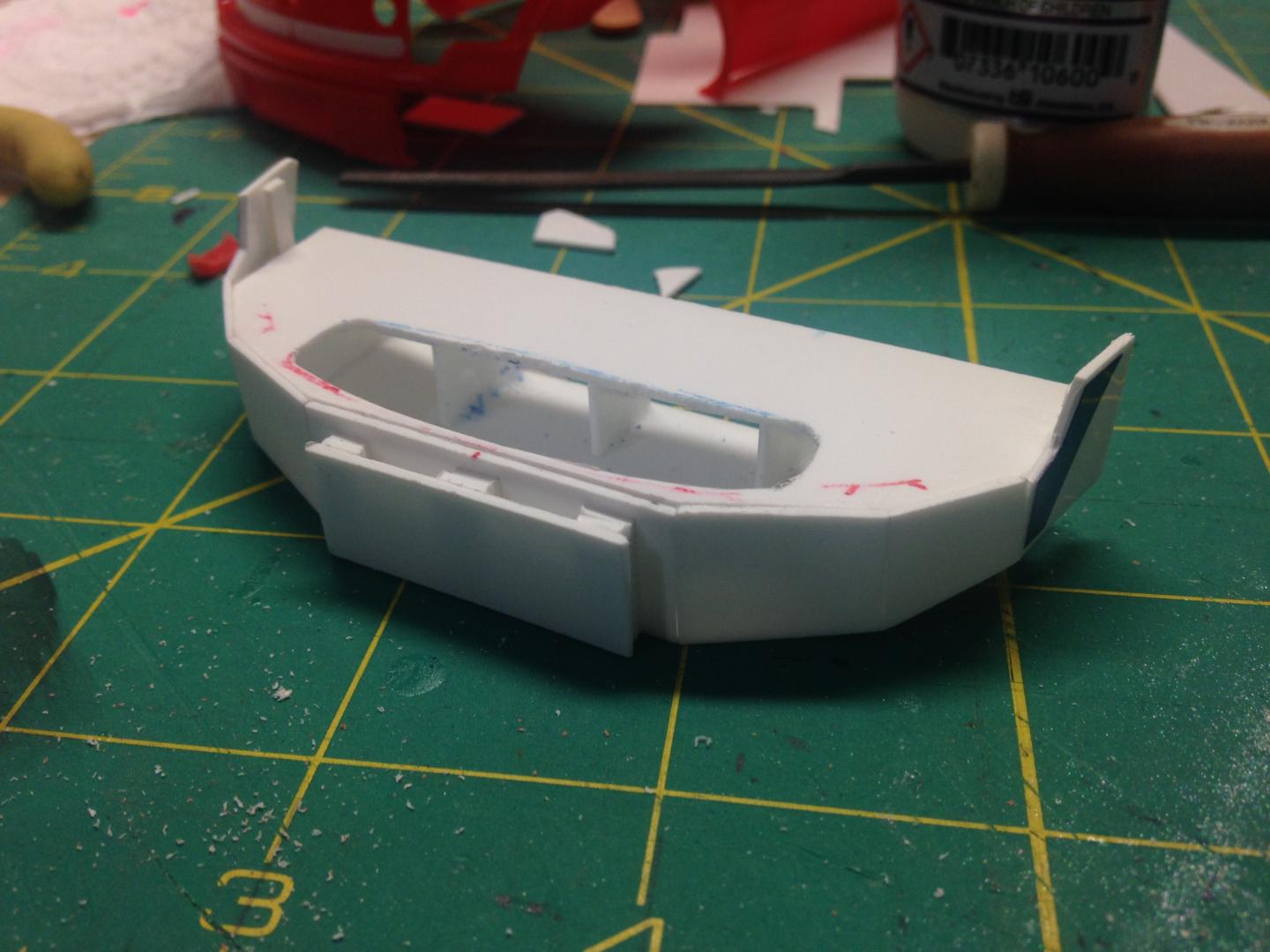

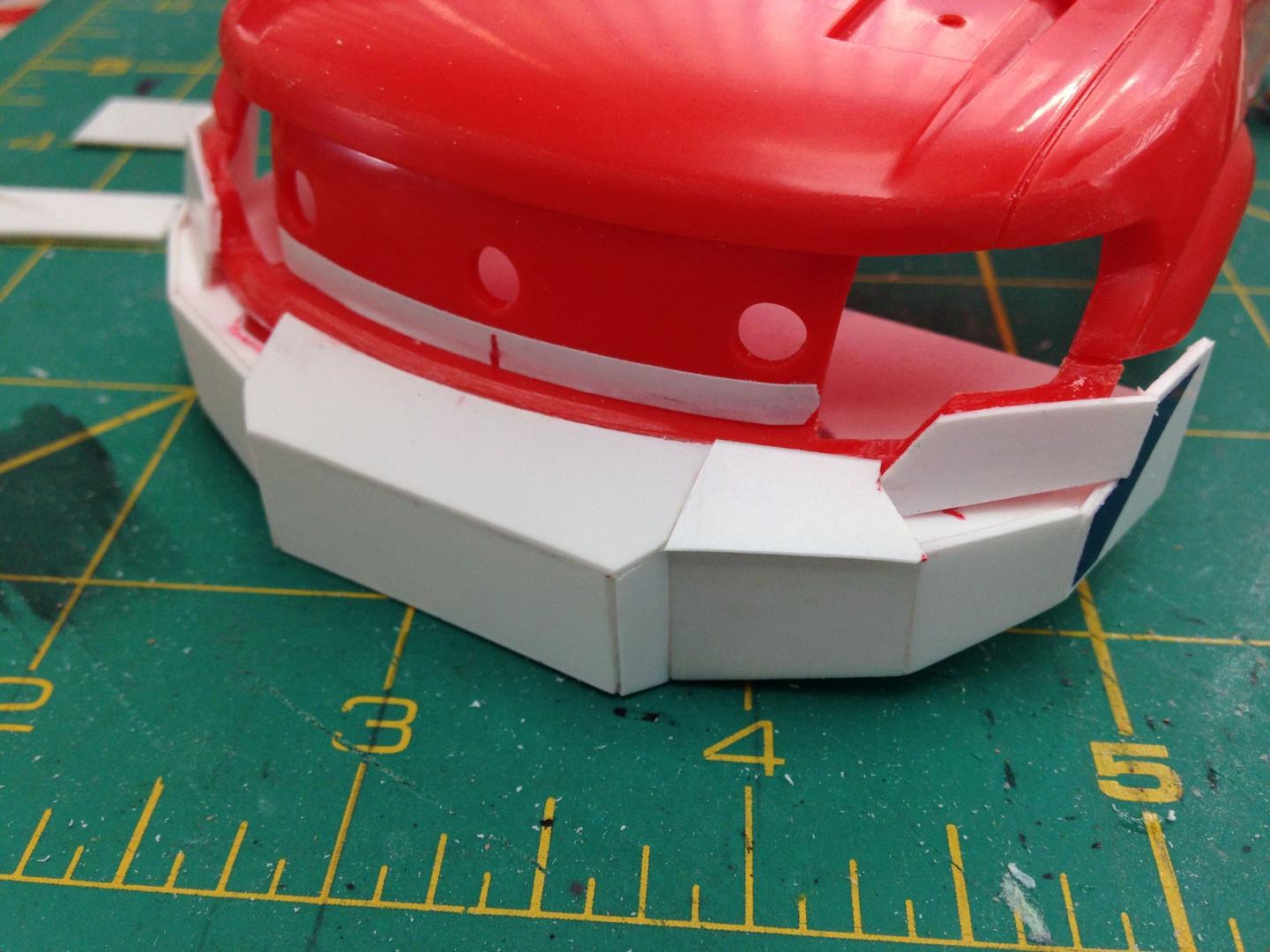

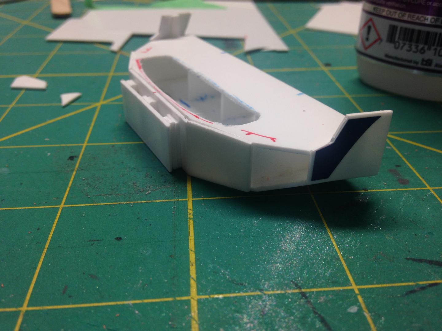

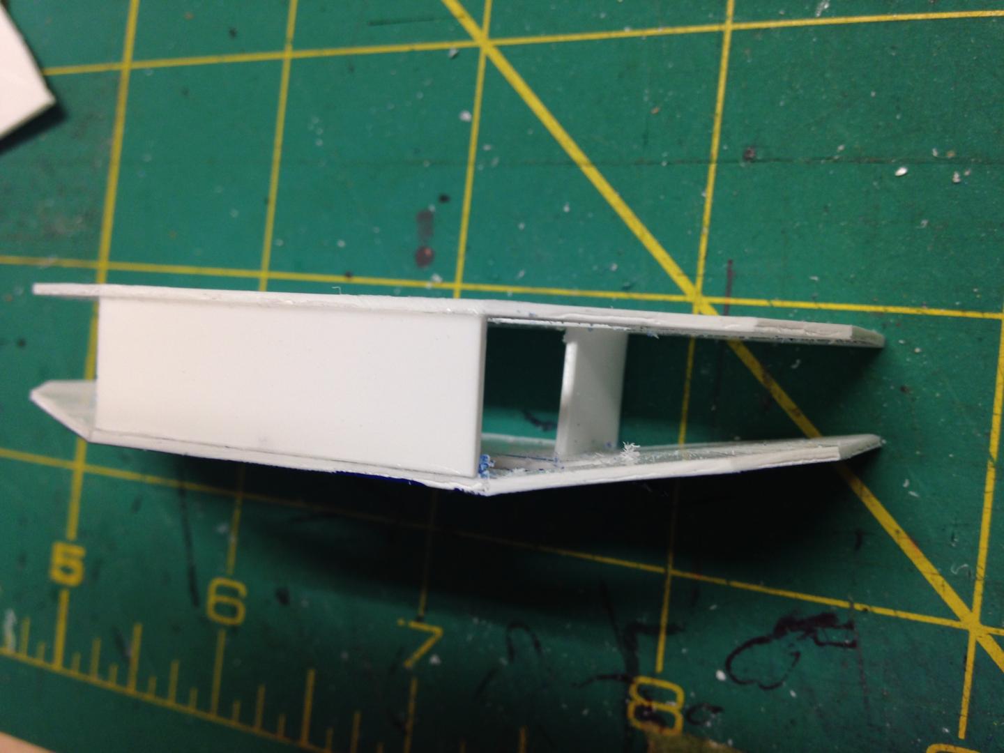

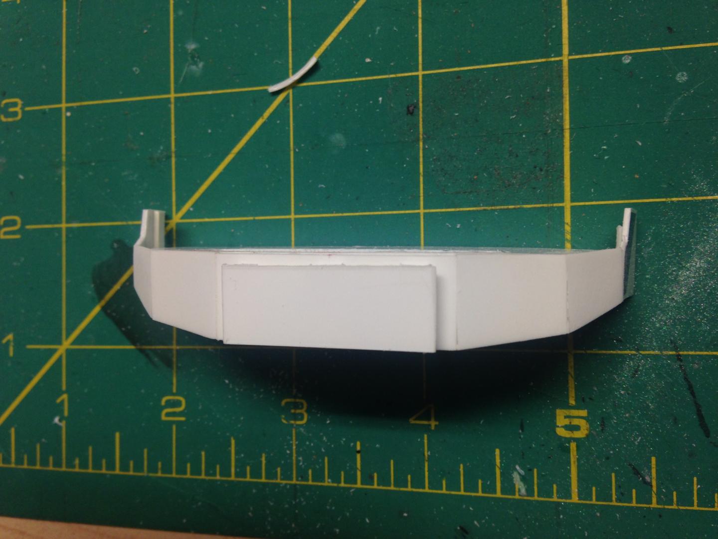

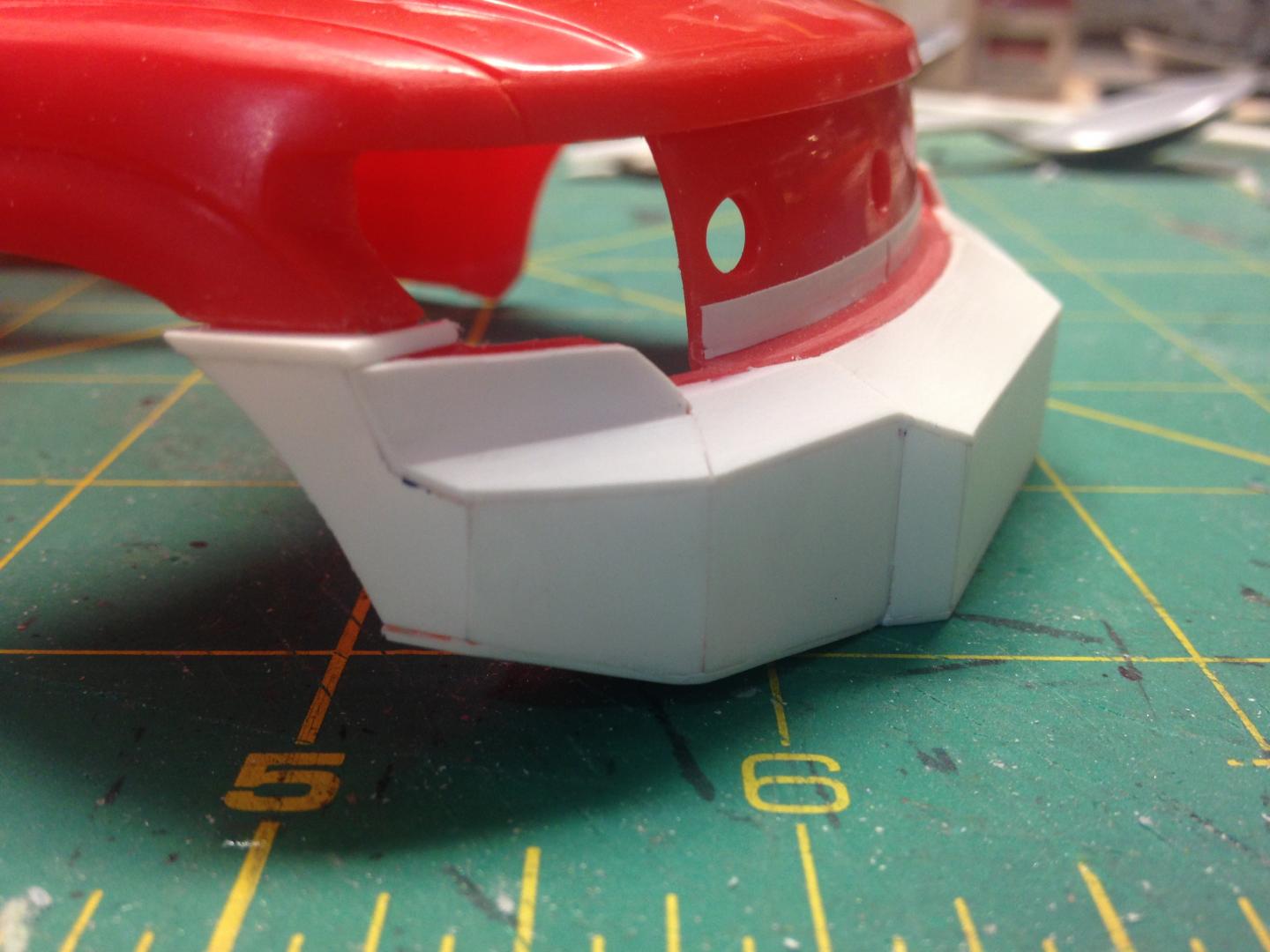

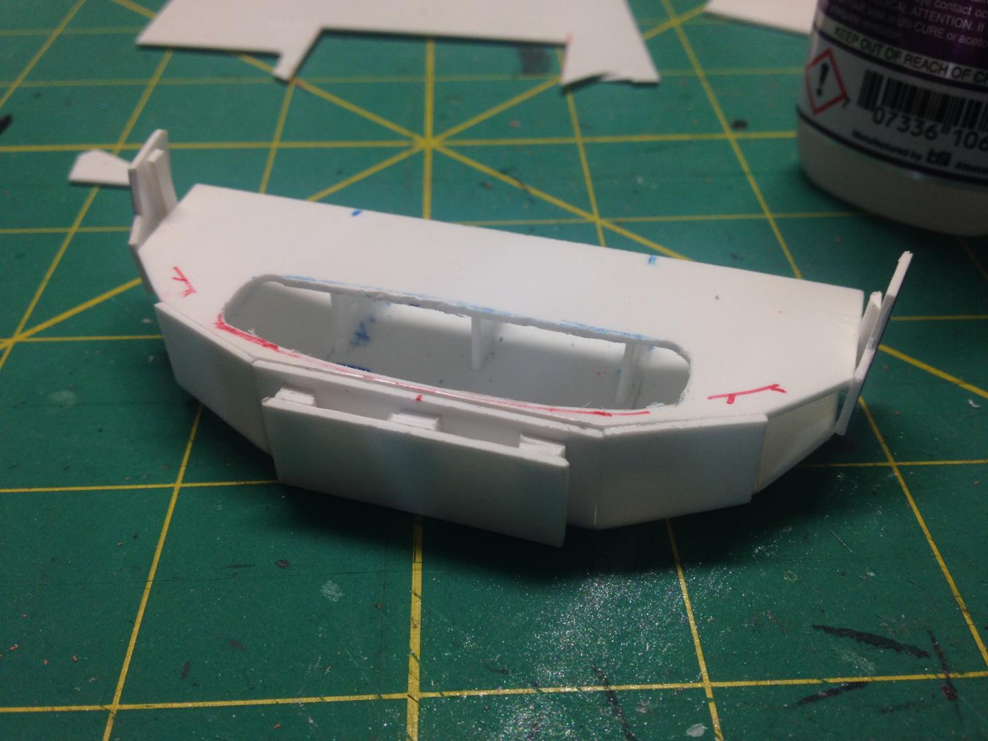

Thought I would share my latest WIP, Its only early days at this stage, got the framework for the front bumper started last night, have drawn up a template for the shape of it.
I'm wanting to build something like this.2014-hennessey-ford-f-150-velociraptor-6
It featured on an episode of Top Gear (when Top Gear was Top Gear...) Clarkson drove it up a snowy hill.
Heres Stig drifting it around the track! https://www.youtube.com/watch?v=3iSftD0j2zY
59e5459956c27_Hennessey-VelociRaptor-in-I'll be using Revells Snap Kit F150, which is a really decent kit esp for the price!
The hardest part is fabricating the front bumper, with all the flat surfaces & angles. But i;m keen to give it go.

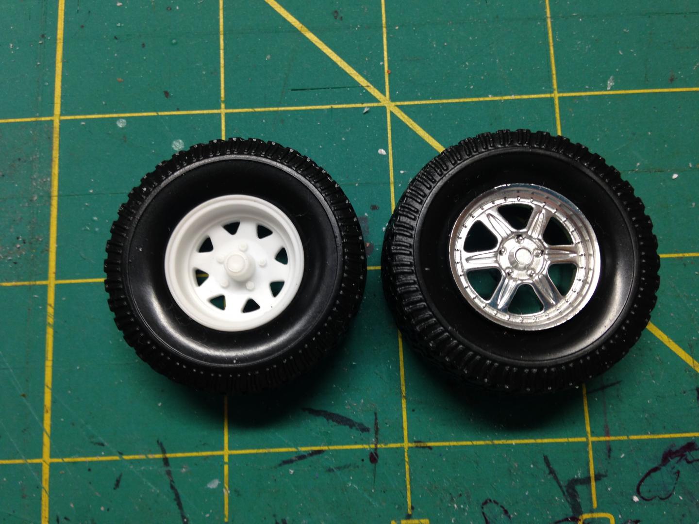

I havent been able to find anything close to the proper wheels, But I do have these 2, One on the left is from Scenes Unlimited & the 18" Dupond wheel is from Fujimi

I think use the Fujimi wheels, paint them satin black, and hit some of the bolt heads with silver. They will be close enough for what you're trying to accomplish.

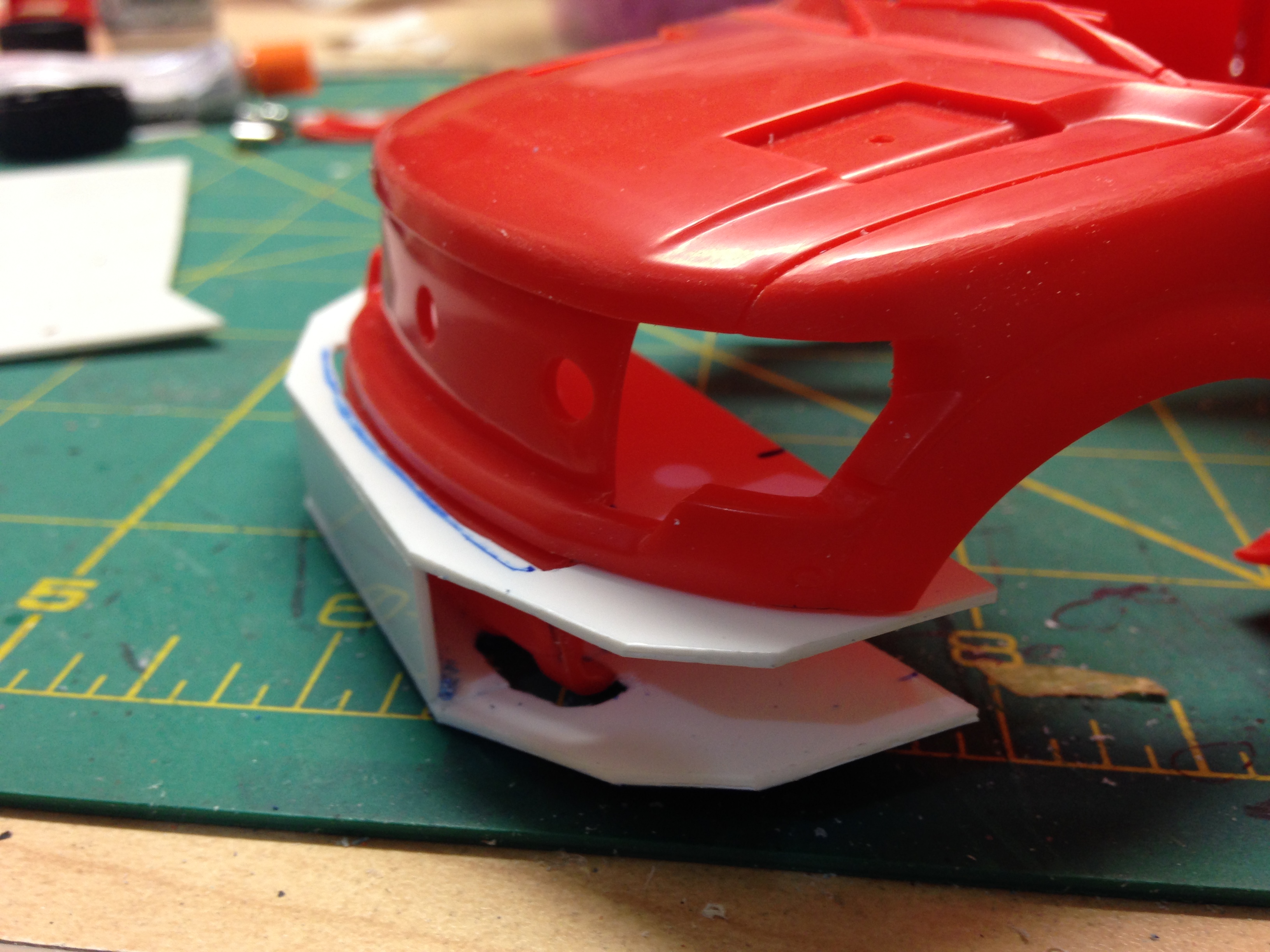

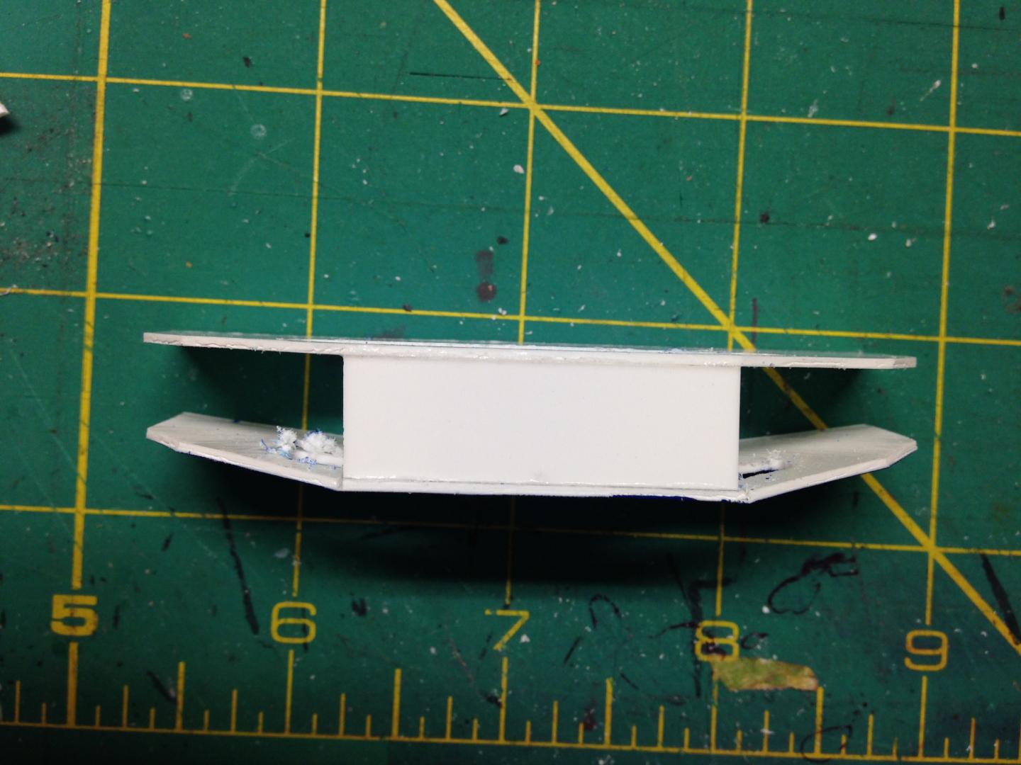

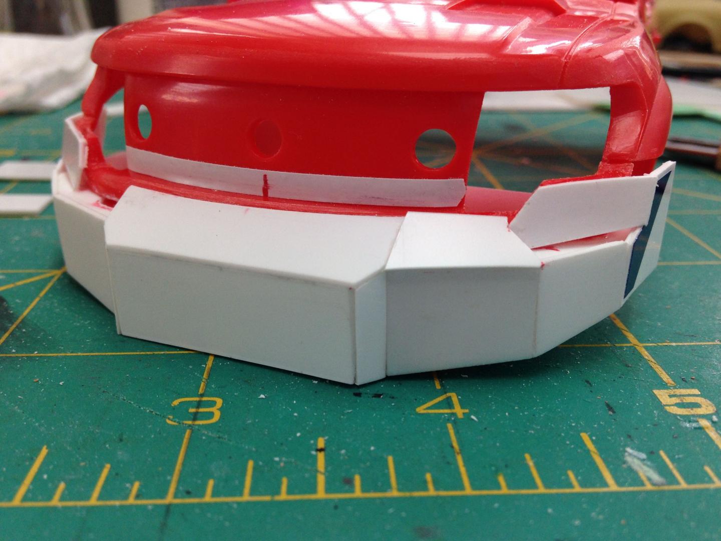

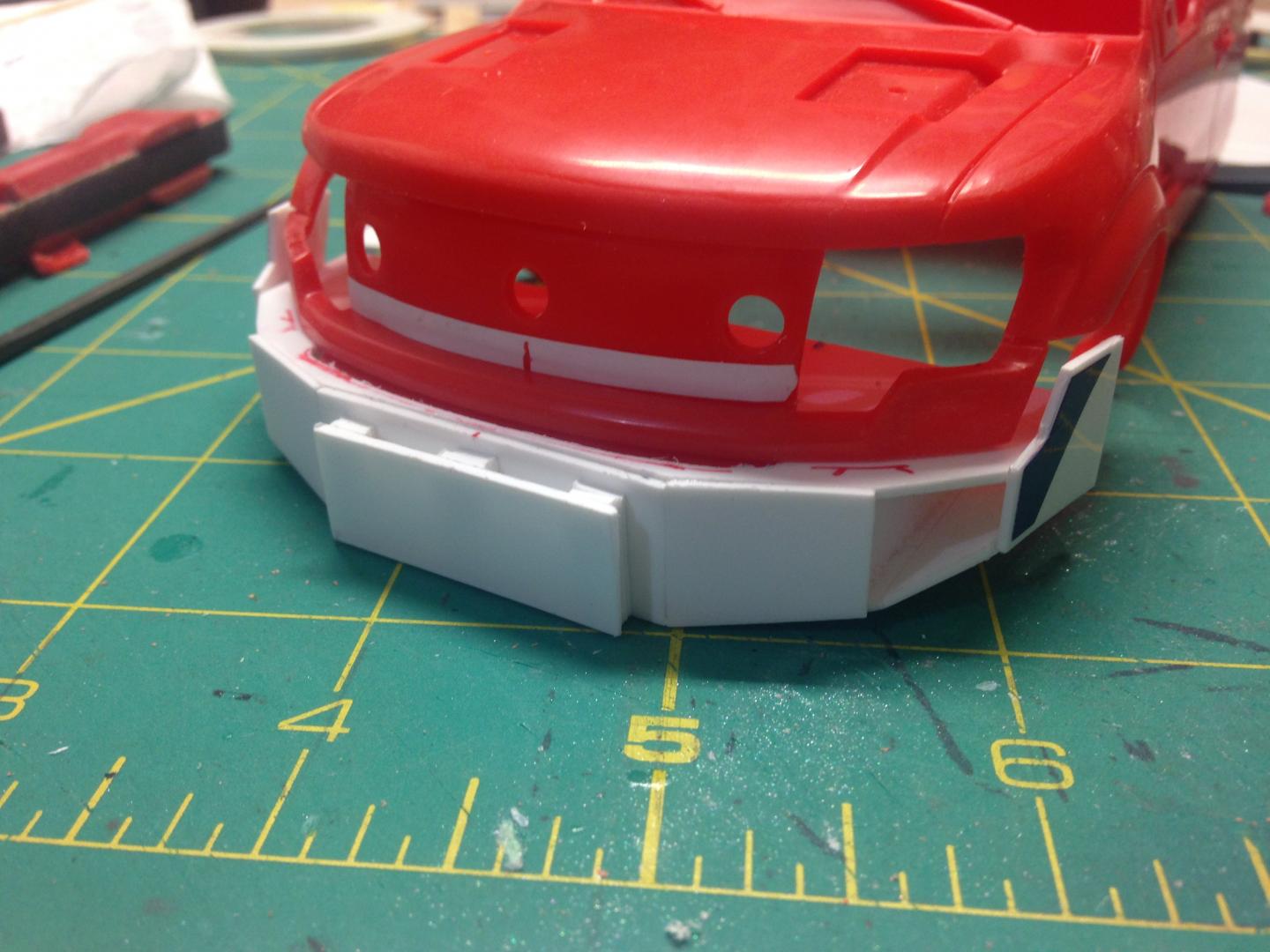

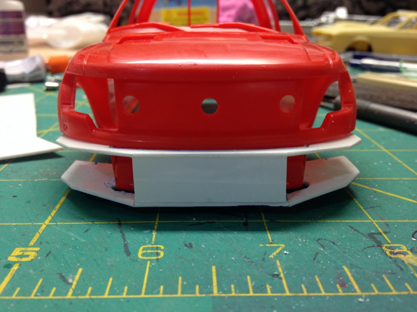

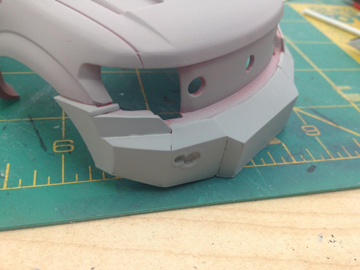

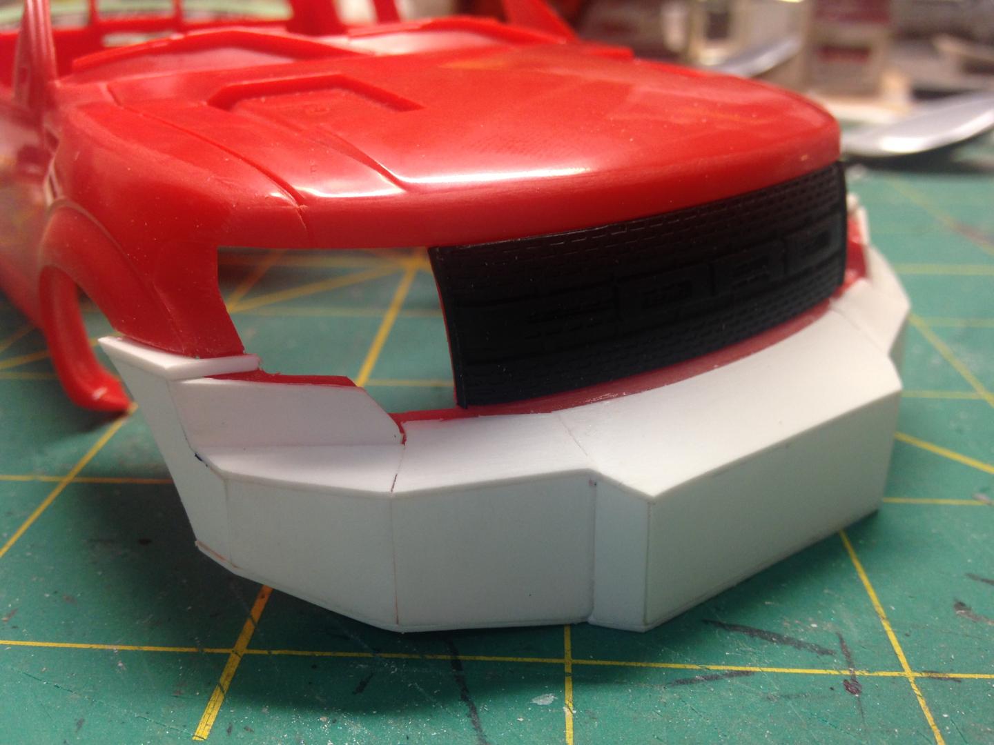

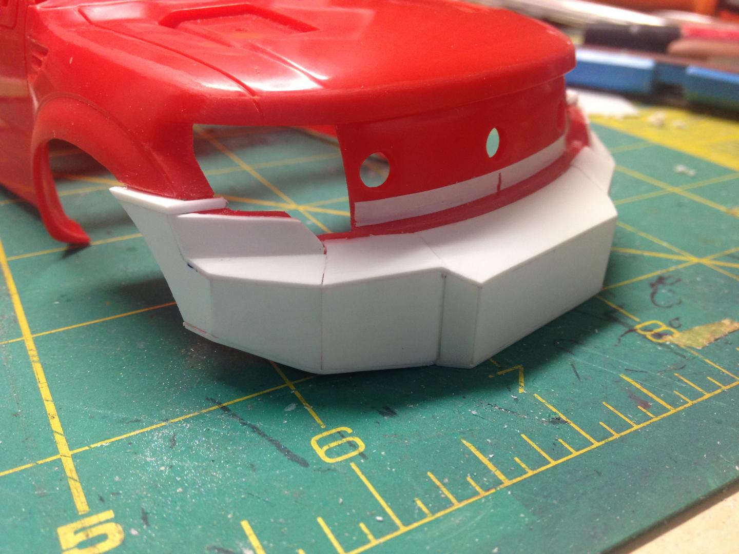

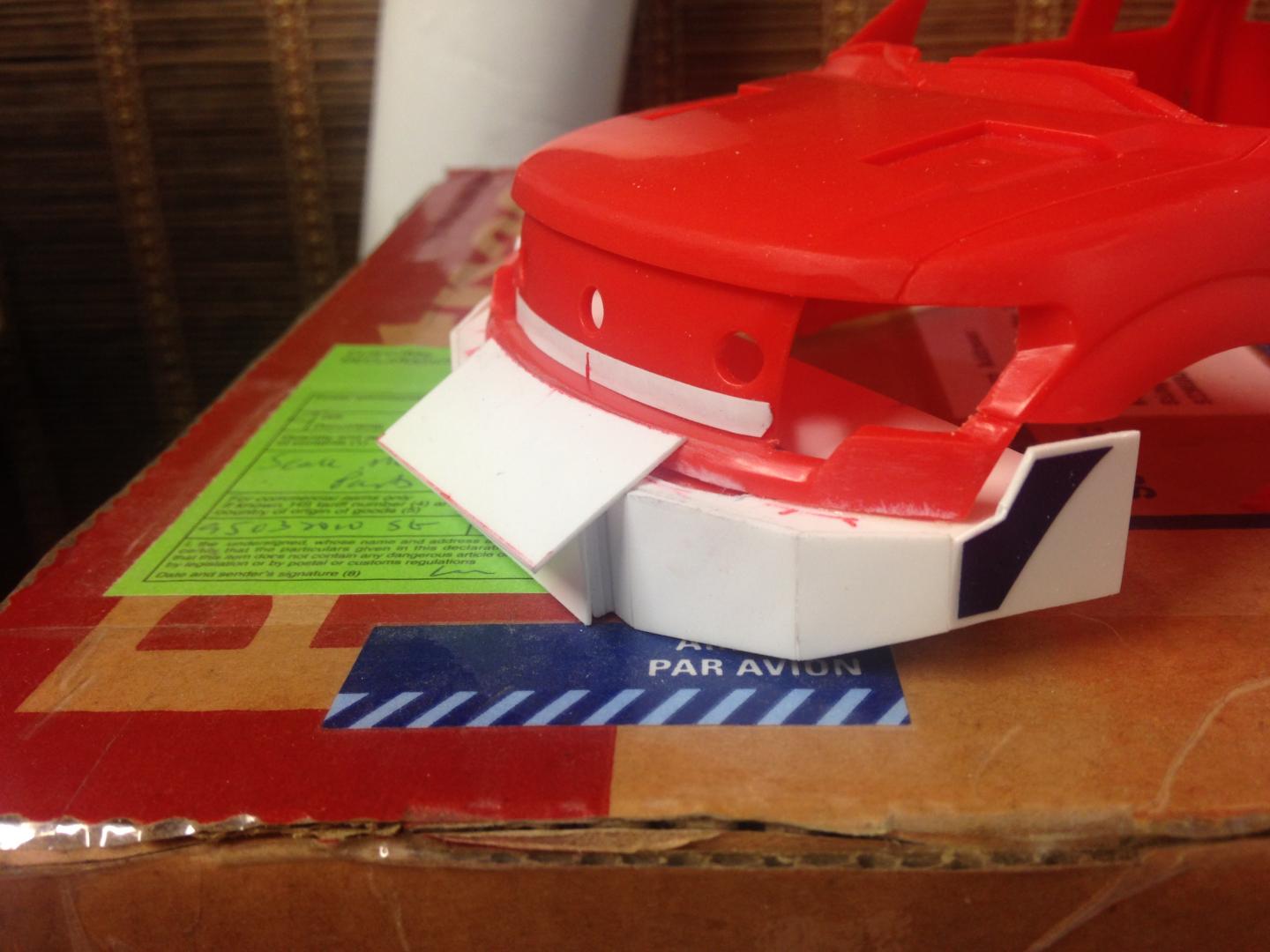

Made some more progress & its starting to look like a proper bumper now. I left it as a separate piece for as long as I could, but required gluing on last night.
Now I need to finish the "top" of the bumper & then can start trimming away all the excess on the back

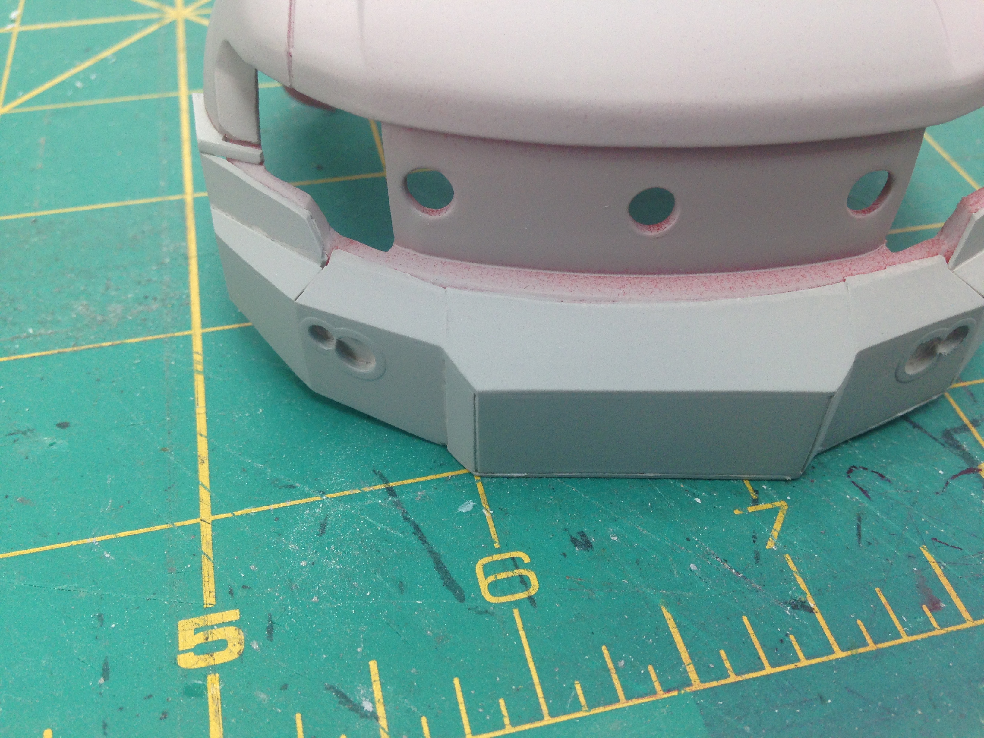

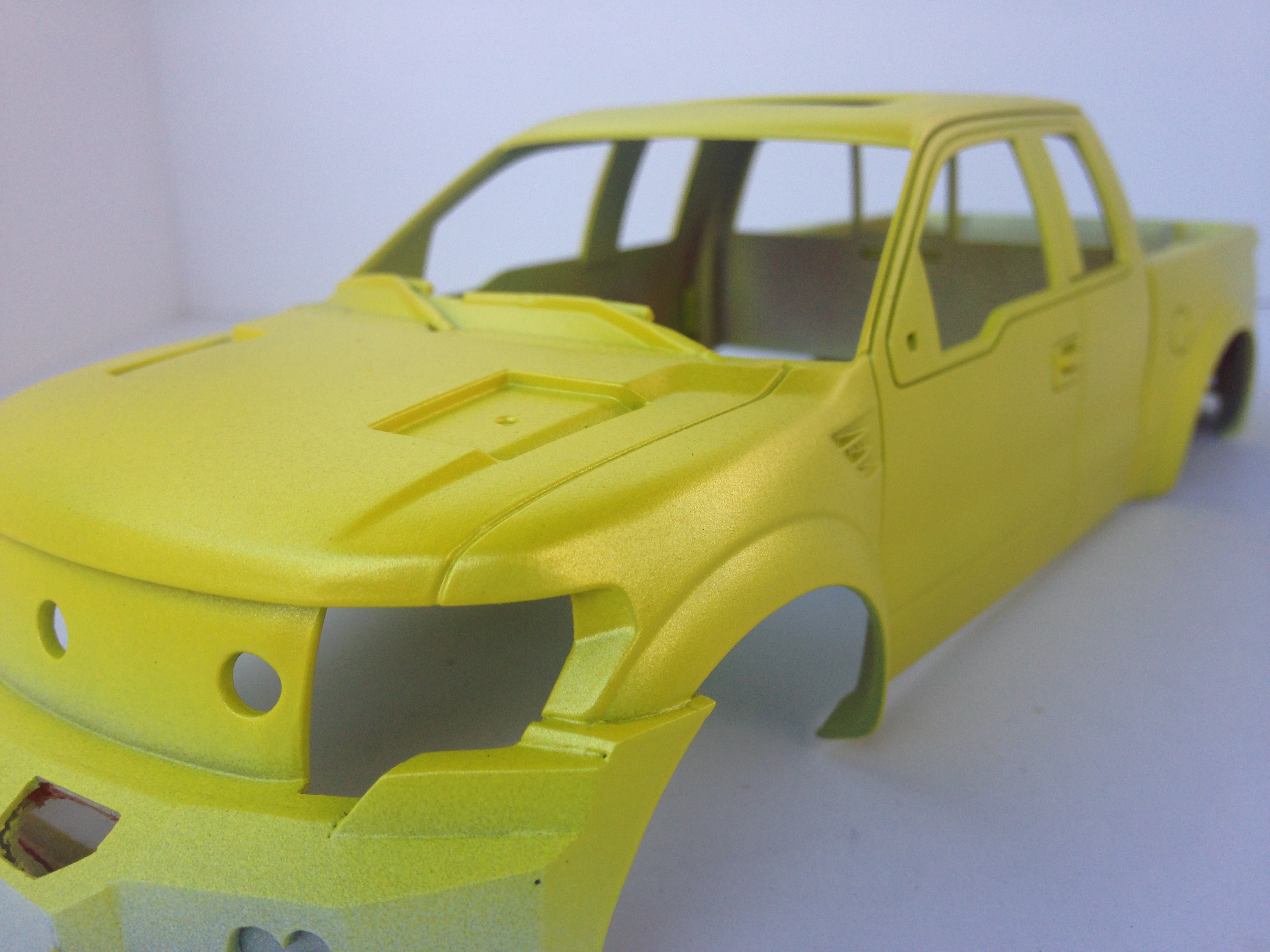

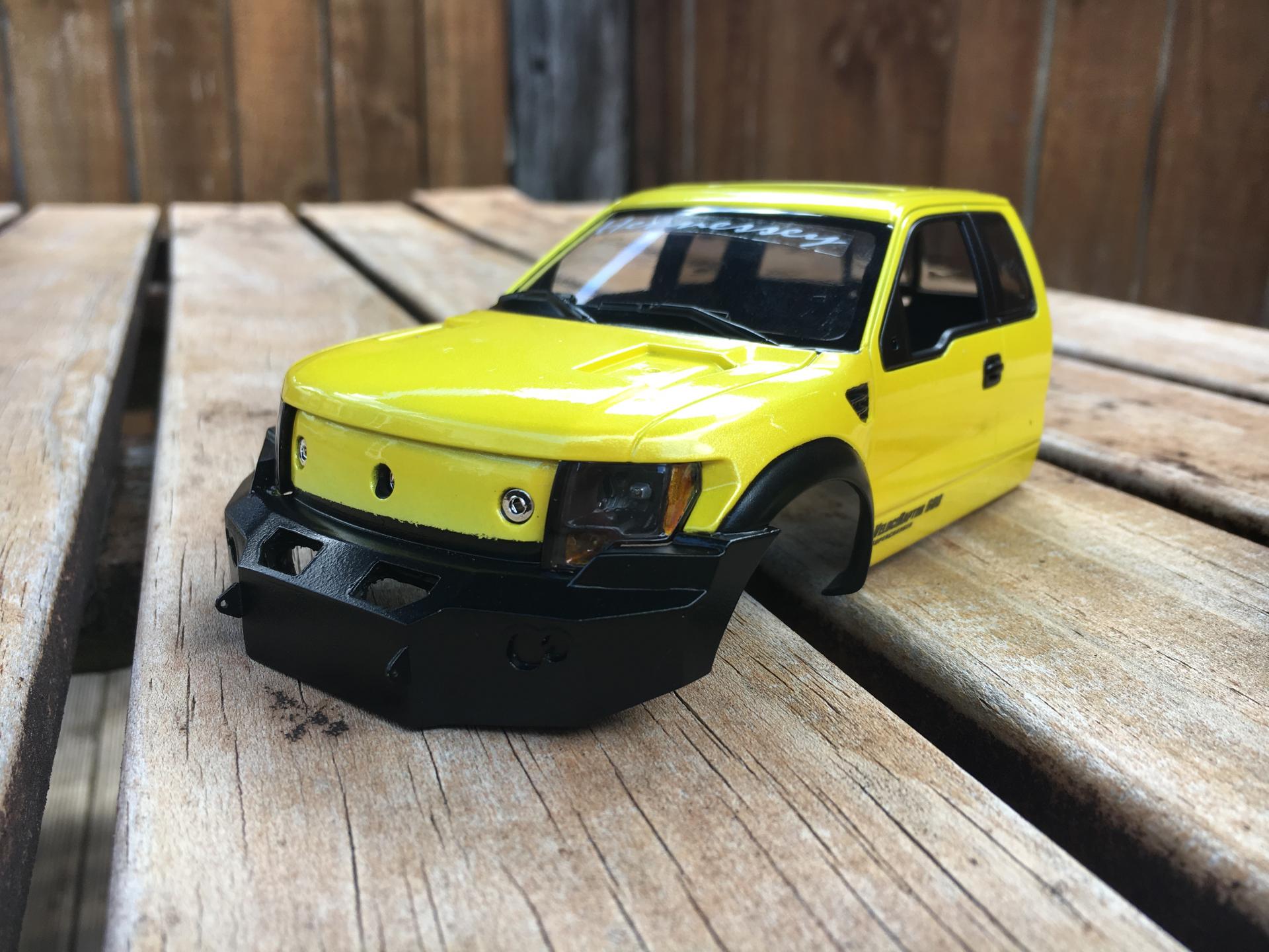

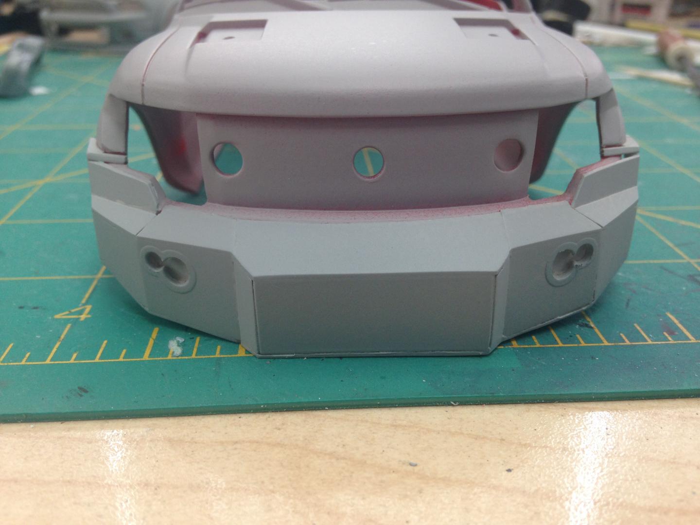

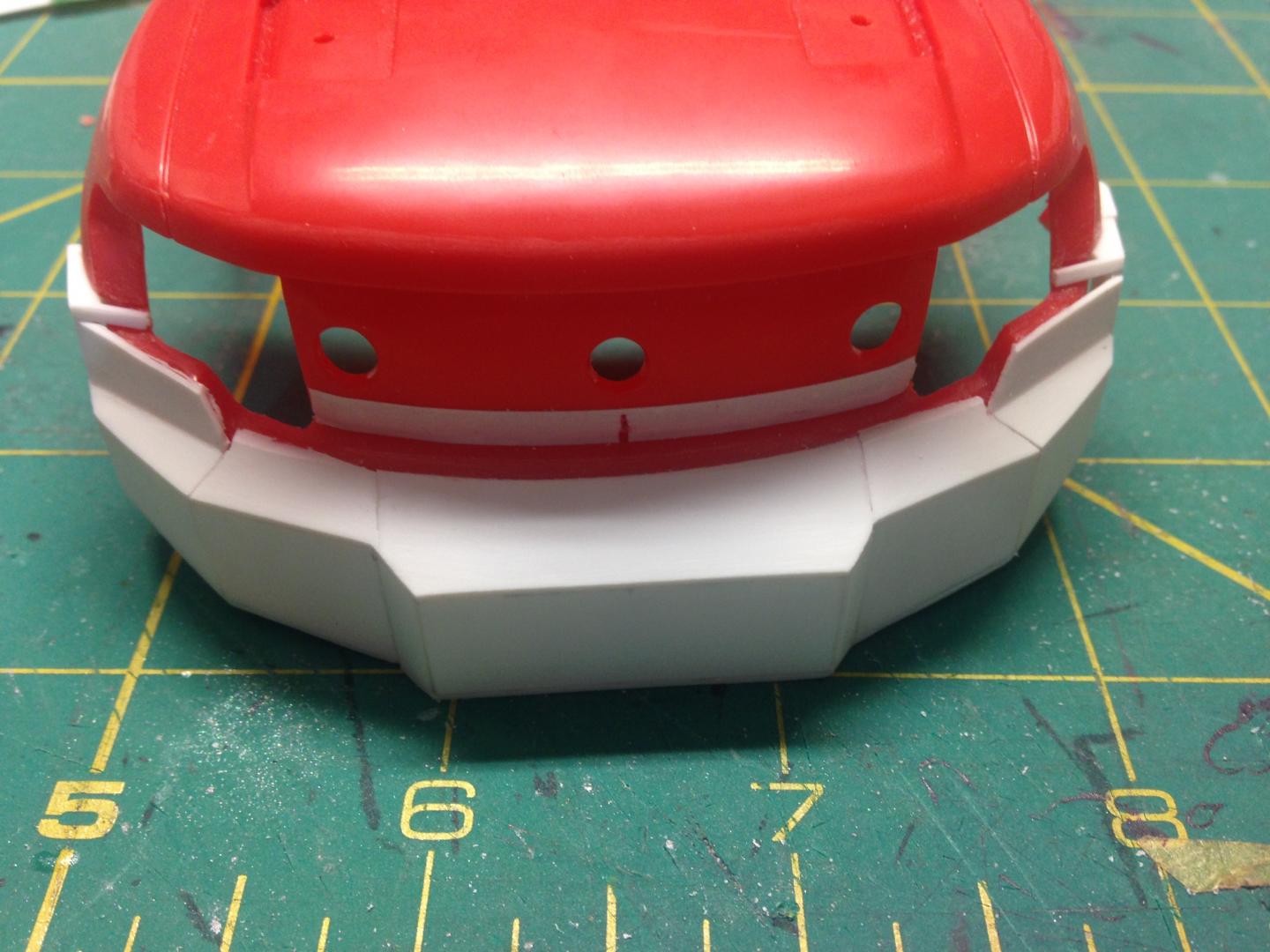

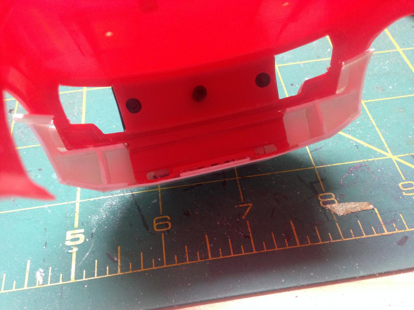

Ive finally finished the front bumper, going to prime it this weekend to check all the joints & then work on filling in the gaps.
Oh I do still have the lights to do & tow hooks. Pretty happy with how its come out so far, its slightly deeper than it should be (0.5mm deeper than stock bumper) but still looks pretty good.
Now onto the rear bumper which should hopefully be eaiser

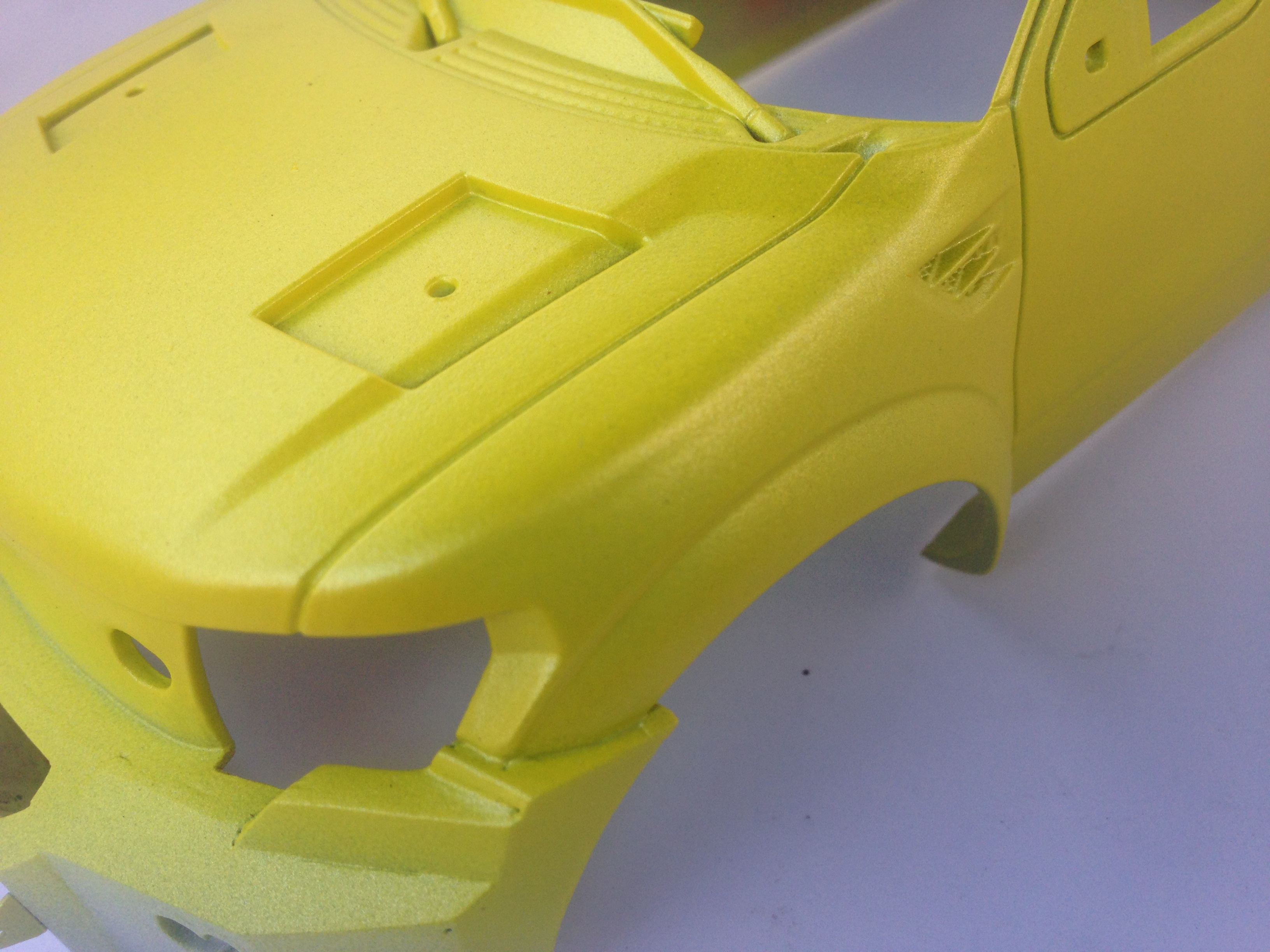

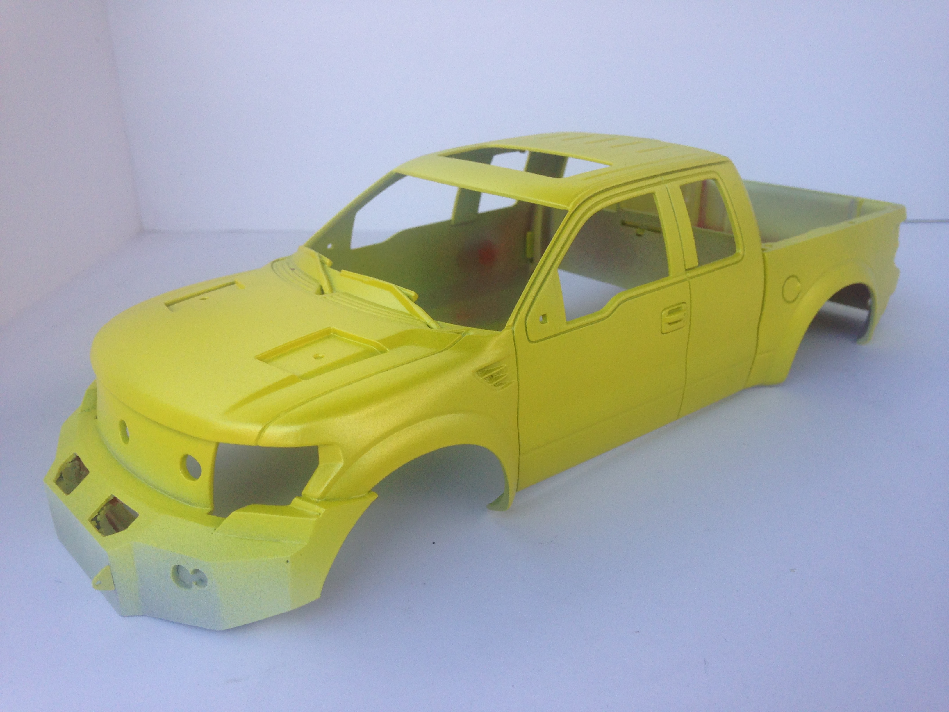

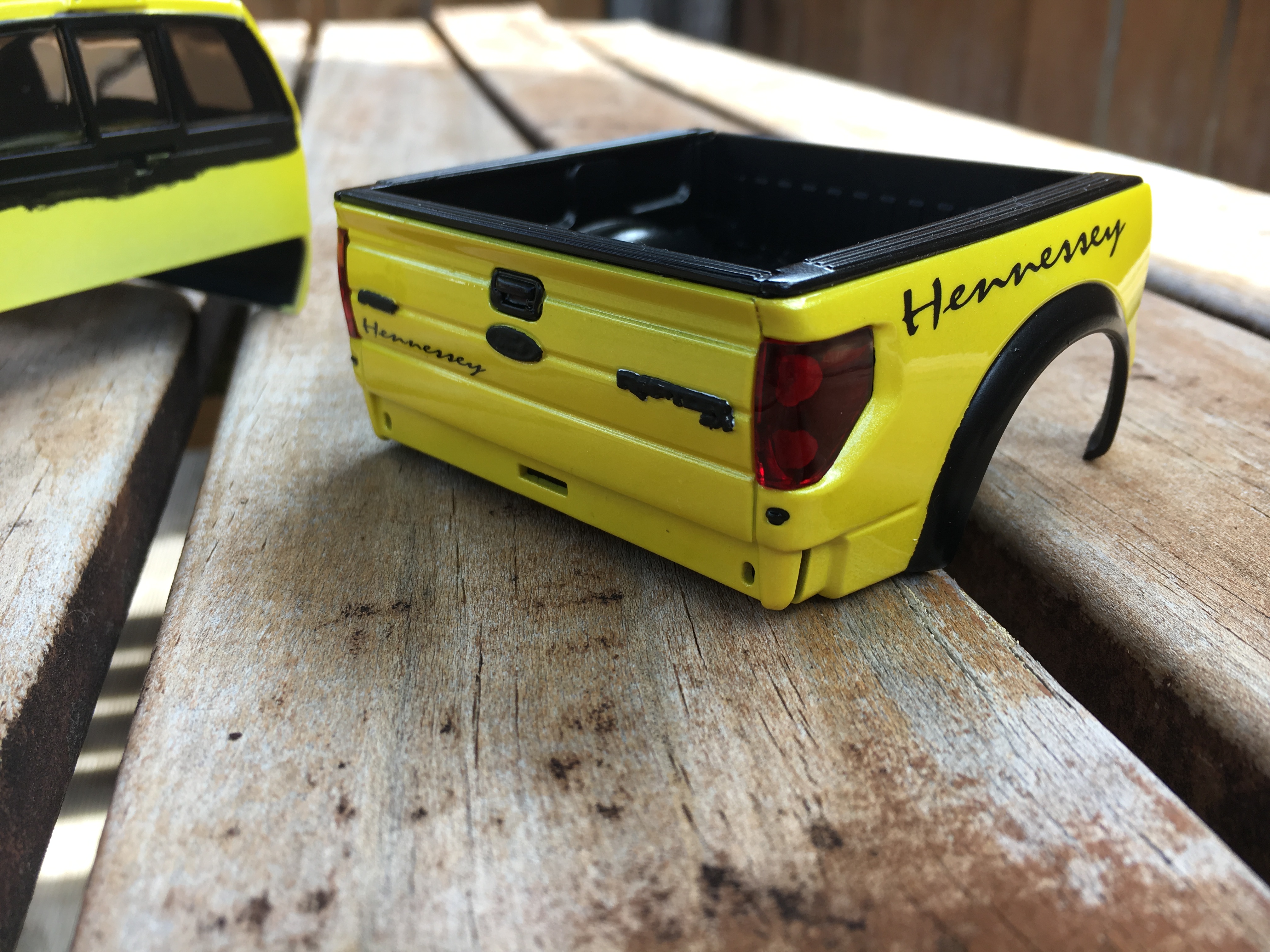

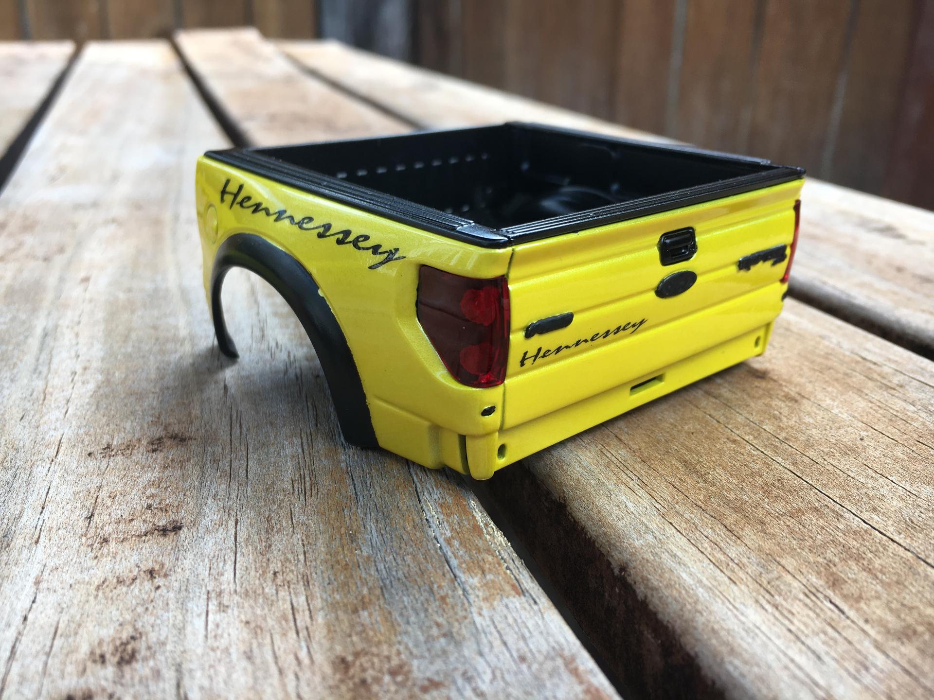

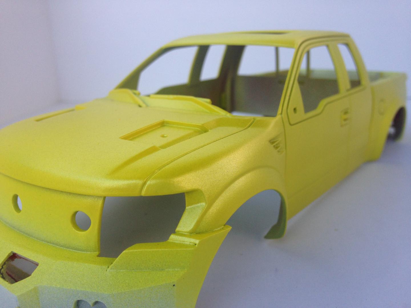

Made a fair bit of progress over my summer holiday, got the front bumper all smoothed out & painted the whole thing.
For the body colour I used Badgers Minitaire paints - Irridiated Yellow, plus I mixed in some Pearl powder, then custom decals & clearcoat.

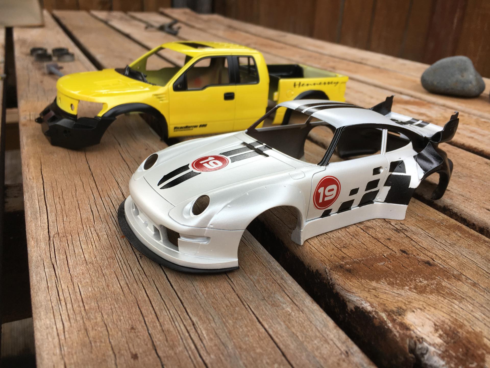

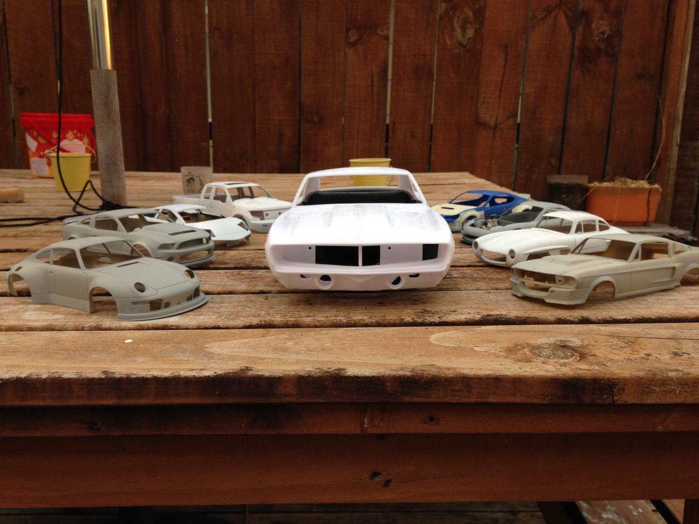

Matthijs -  yeah not much of a fan of out of the box builds, heres what I worked on over my summer holiday, painting the 9 models id spent the last few months modifying, out of the 9 i painted over xmas, only 2 are box stock (merc 300sl & Lambo)
Also added a Nismo R32 from Santa, that, the BRZ & the Foose Camaro still need final colour coats but otherwise most are ready for assembly.
I like to bulk paint my projects over summer, get the main parts painted & then put them in the box ready to be assembled through the winter.
Yes the RWB will get a thread of its own shortly, I used the C1 Models RWB kit which is good, I also used their rear 'flaps' set too, which was a major pain in the A$$!!! Glad i decided to attach to the body before I painted the body rather than after.
I'll get some better pics of the F150 tonight

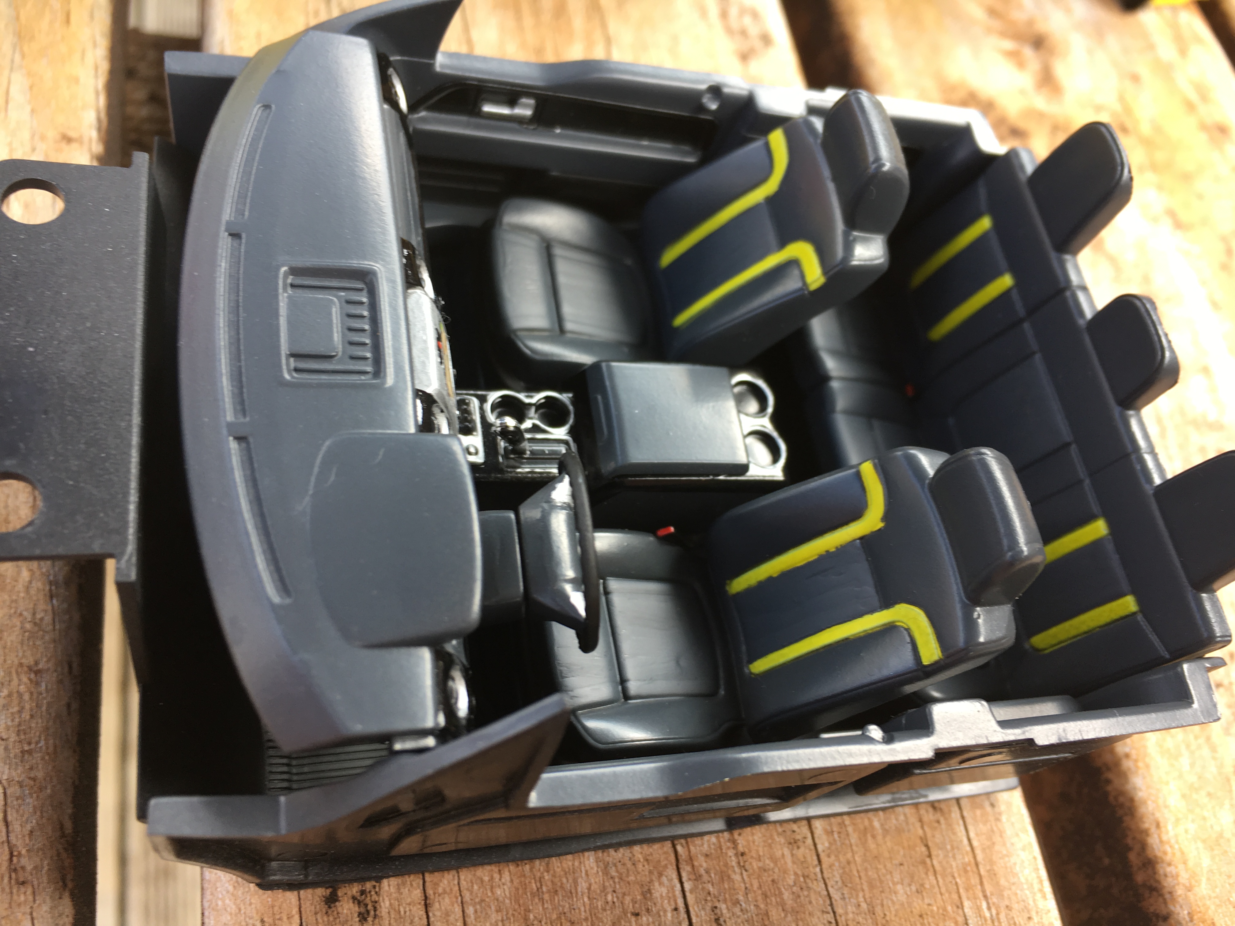

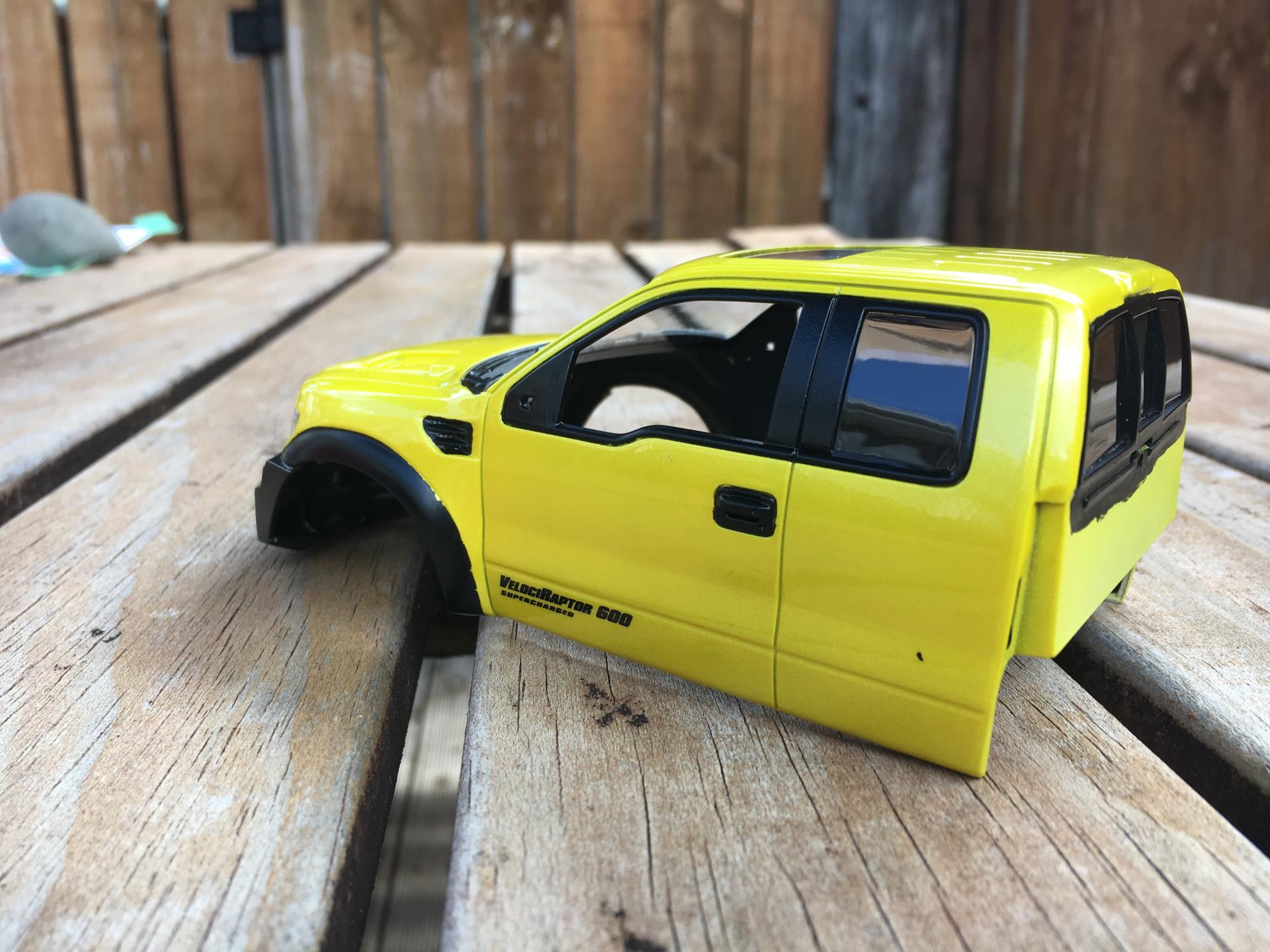

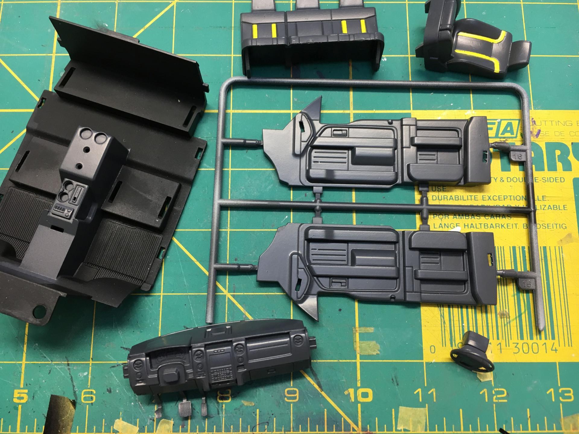

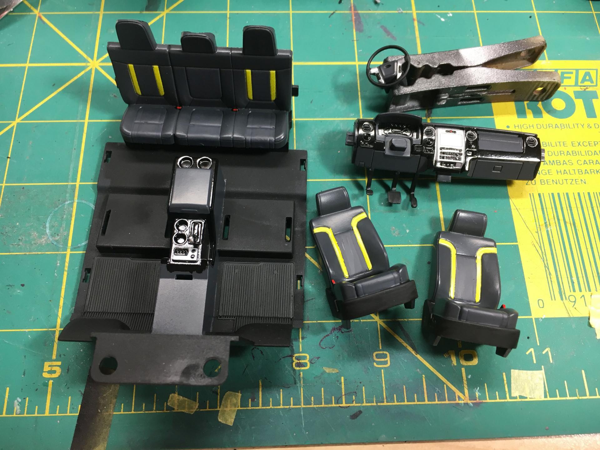

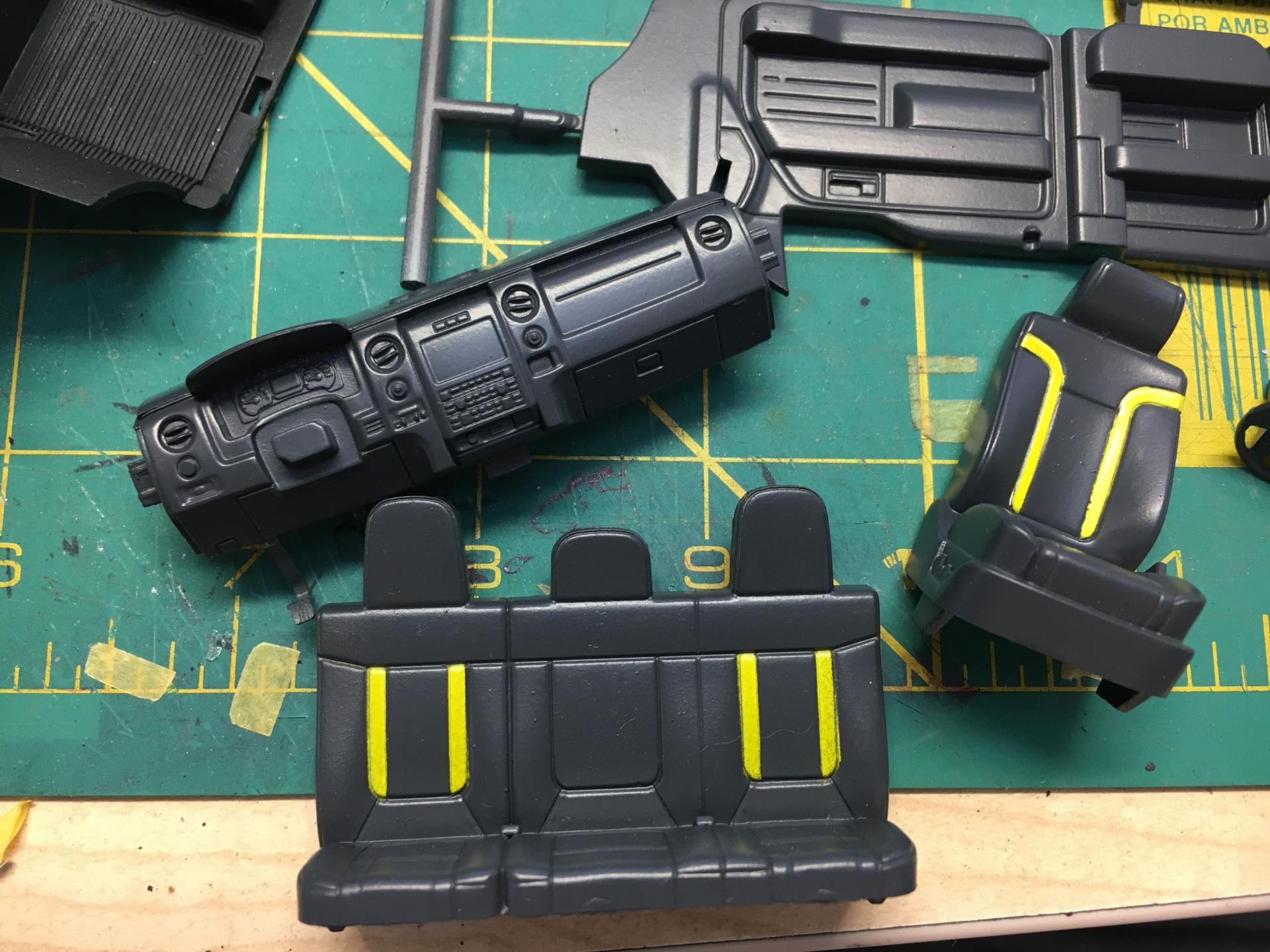

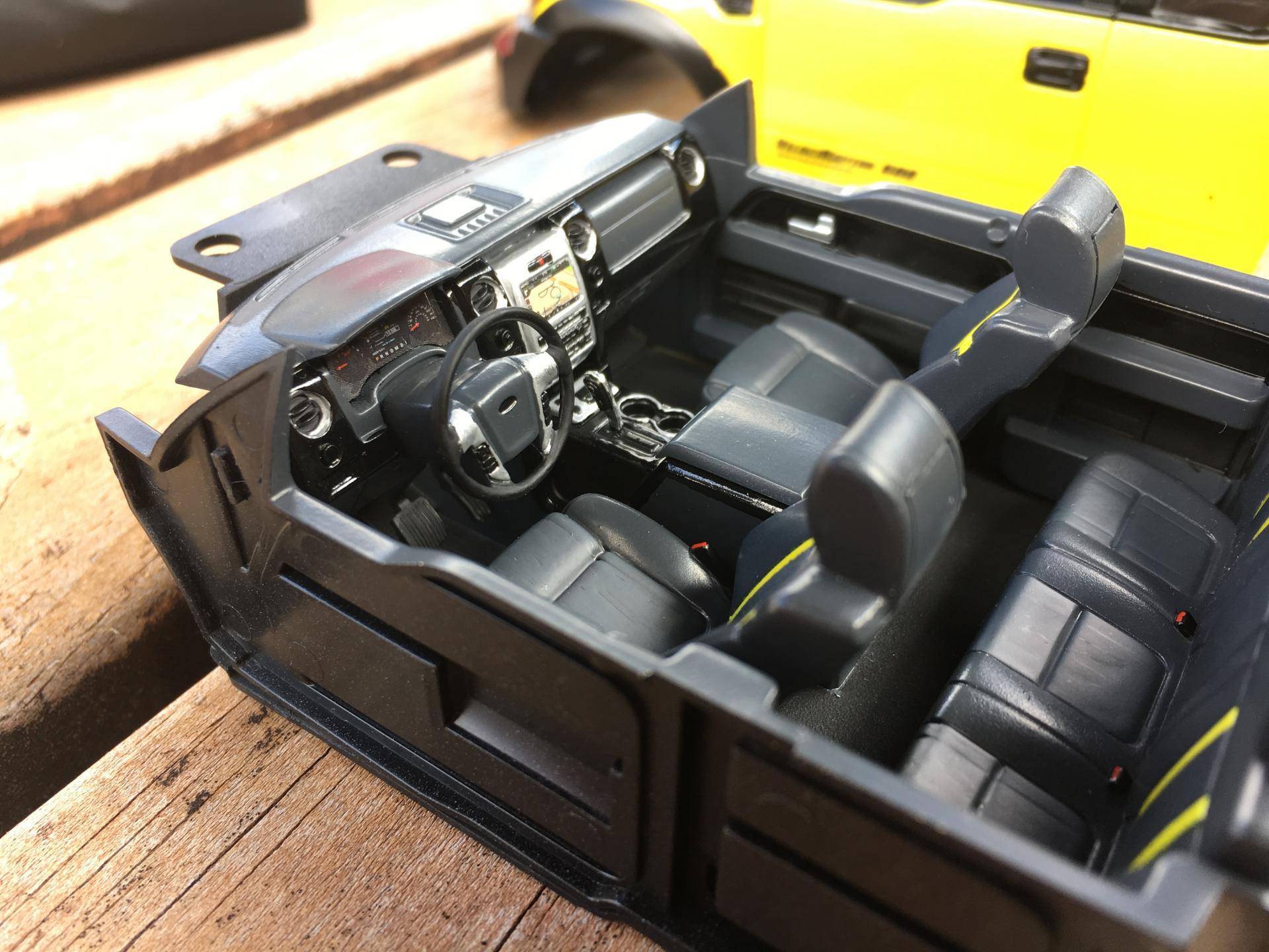

Heres a few pics of the interior, started out as Grey (I used Minitaire 'Coal', pretty much a dead match for Tamiyas German grey, the seat centres even have German grey on them (3rd pic only) & you can hardly notice any difference), detailed painted over a couple of hours. Googled images for the interior & found Ford did a Harley Davidson edition so I kinda copied that for the most part.
A
Edited by da_ashman

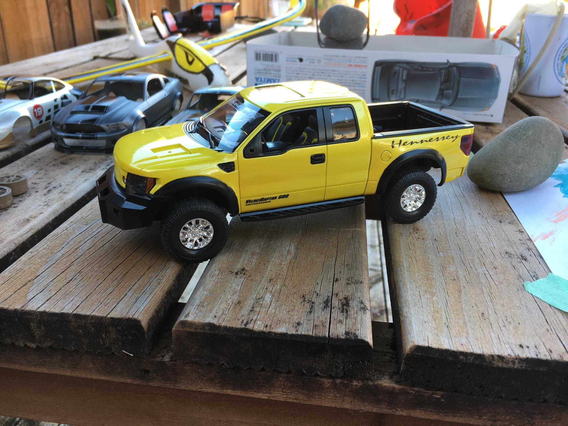

The Sun was shining over the weekend & managed to squeeze in some bench time between airbushing other projects. Got the interior assembled & installed with the glass, & then managed to mount the rear tray & fit the chassis.
IMG_9239.thumb.JPG.dc8ffa7ab372becbb7ab486f23cab94e.JPGIMG_9240.thumb.JPG.83ffa2511eb8cd748f5c31a98f556f4f.JPGIMG_9241.thumb.JPG.73d81dc18b40f0225c59b04753840091.JPGIMG_9242.thumb.JPG.fb495146c43ff87ba2393e6150ba455b.JPGIMG_9243.thumb.JPG.86a8b81fa22a144d1006d8abbe30fb04.JPGIMG_9244.thumb.JPG.845ec2498fbc71fbfcbeb8c1891c1d1d.JPG
Only a few things left to finish like how the hell I'm gonna mount the wheels plus the grill & vents & then a couple of touch-ups to do.

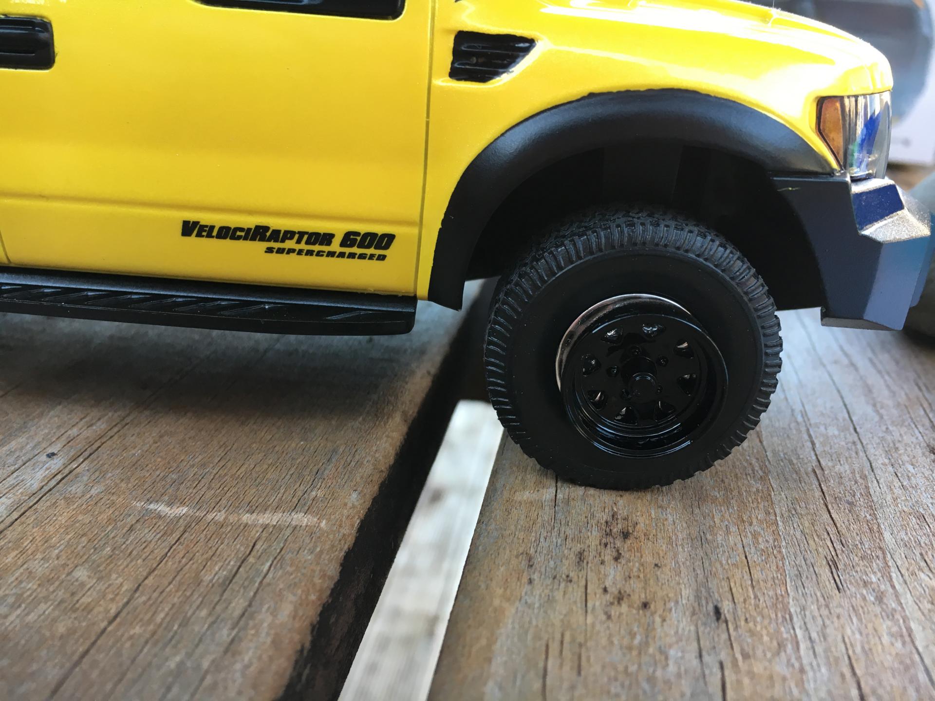

Couldn't resist a few pics with the kit wheels, think I might lower it a bit for a more aggressive stance.

Any tips on how to mount different wheels to this particular kit, Ive got flat resin wheels & the kit has only a rod thorugh the chassis...

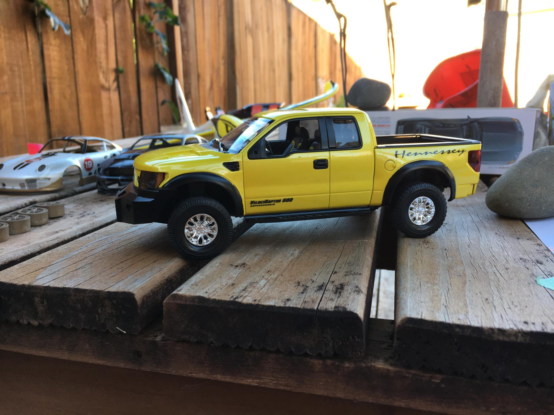

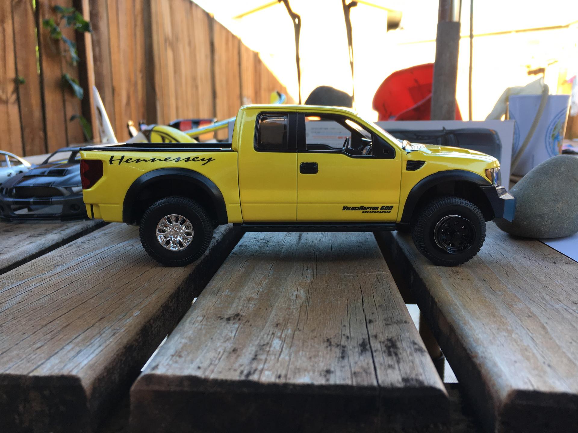

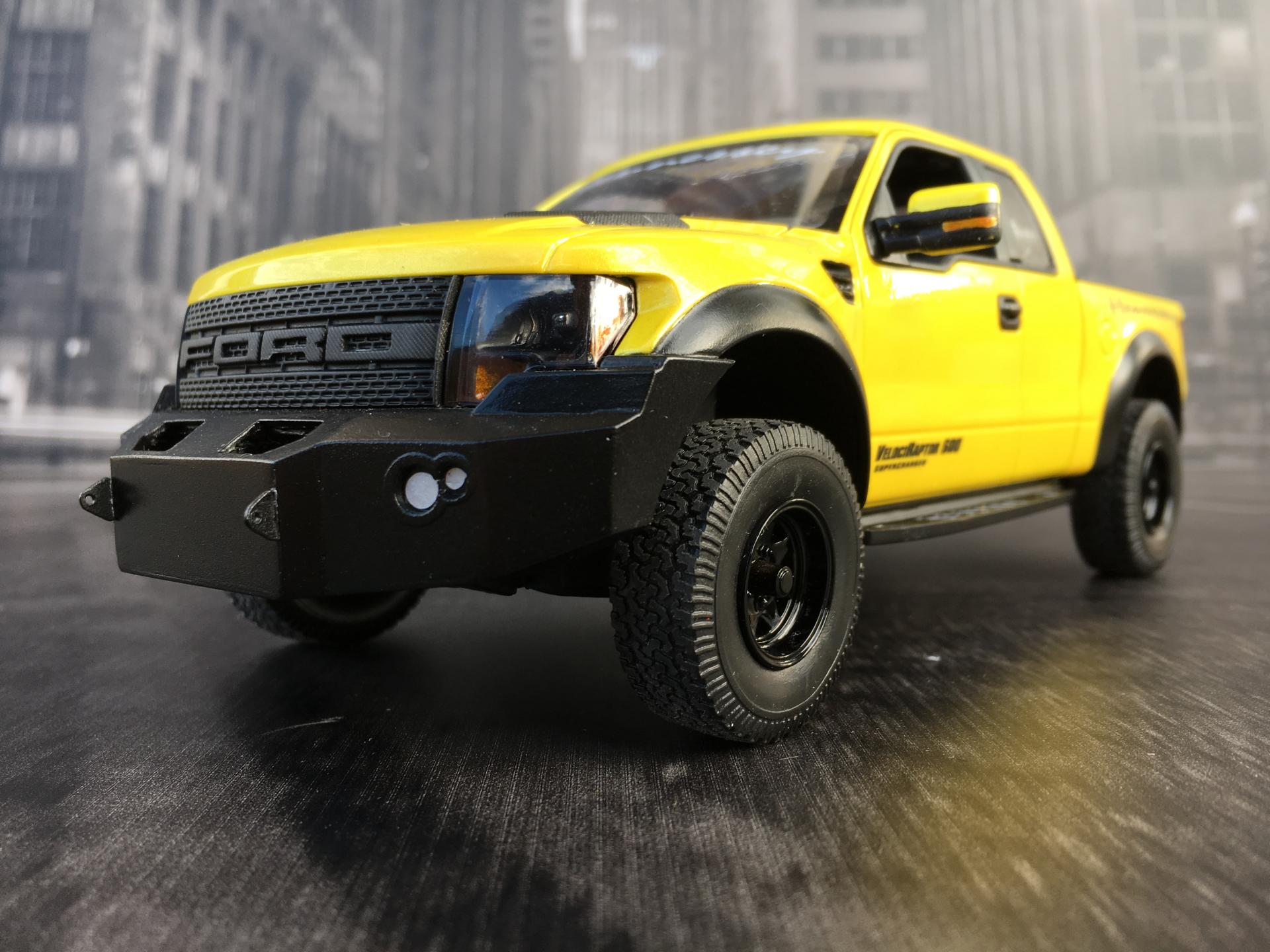

Managed to finish her off just before my model club meeting last week. The wheels were alot harder than i expected to change, needed them to be strong to hold this things weight, ended up using back half of the original wheel & then mounted the resin wheels to the front & trimmed to suit.
