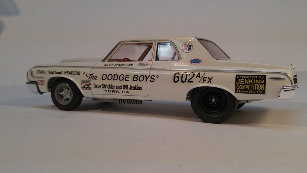

StevenGuthmiller Posted October 17, 2017 Posted October 17, 2017 On top of the "hot" factor, many times the metallic particles in the paint can be far too large for 1/25th scale. But a lot of guys like it. I use plenty of Duplicolor paints on my builds, but I usually refrain from using metallics. Solid colors, primers & clears all work very well for me. You are almost guaranteed some orange peel with lacquer paints, but that's where polishing comes in. This '60 Merc was painted using Duplicolor products almost exclusively & polished. Steve

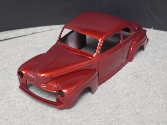

JollySipper Posted October 17, 2017 Posted October 17, 2017 I LOVE DupliColor products! It's pretty much all I'll use for bodies. I have my technique down to where I can get nice slick paint with it.......... This is all DupliColor, primer, color, and clear......
