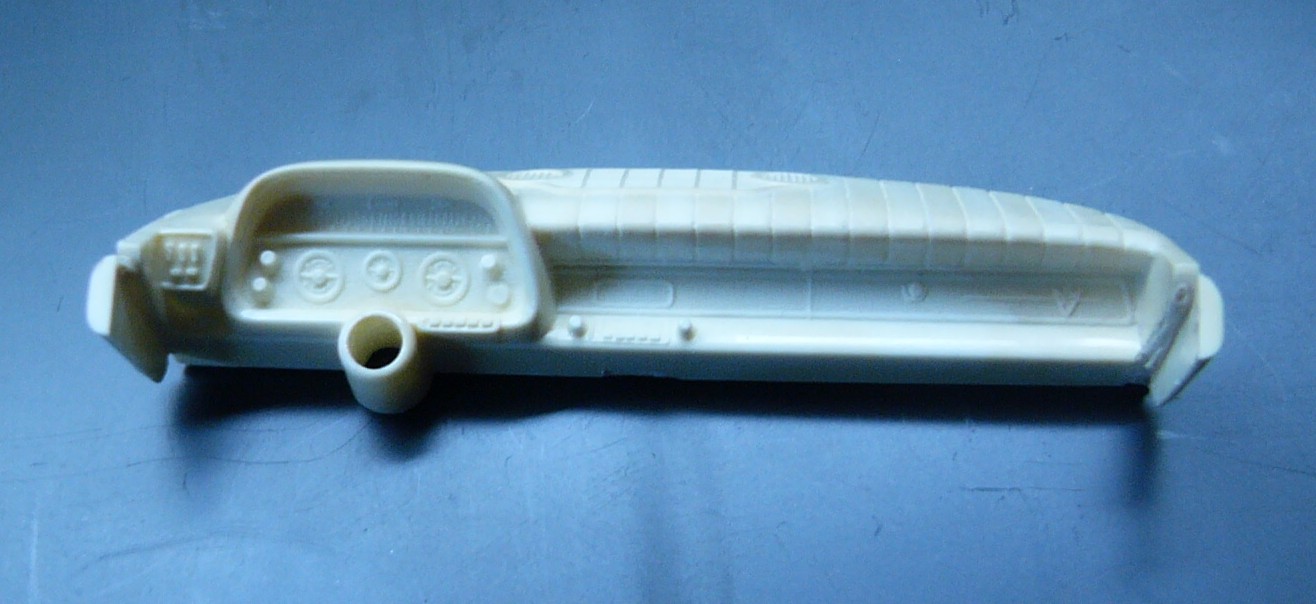

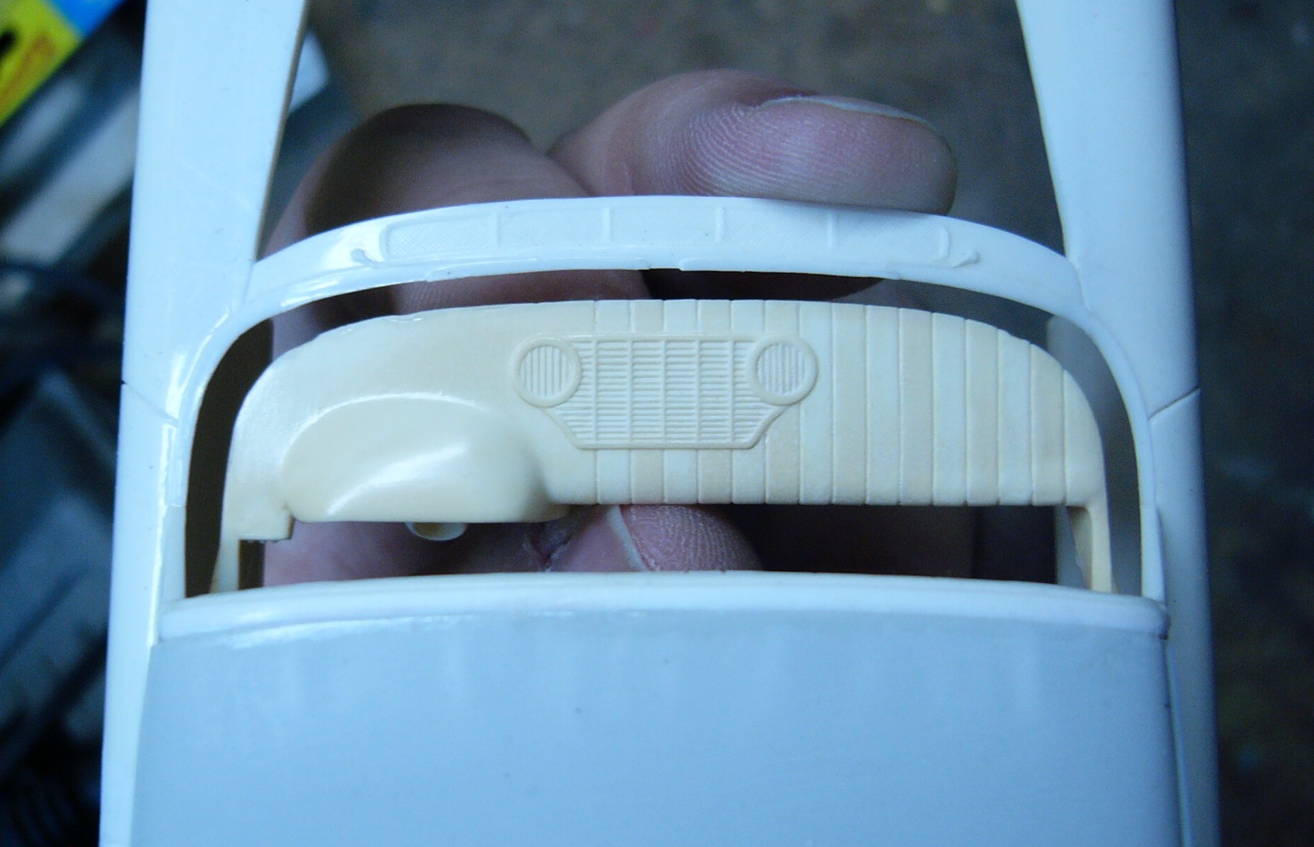

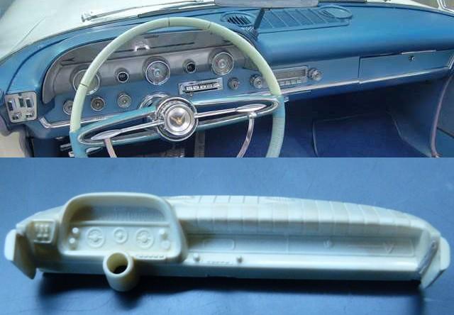

ChrisBcritter Posted October 23, 2017 Posted October 23, 2017 (edited) Here's the '59 Dodge dash (huge thanks to Ronn Pittman): And here's how it lines up. Obviously it needs some mods but it's the closest thing I've found to start with. Edited October 23, 2017 by ChrisBcritter
StevenGuthmiller Posted October 23, 2017 Author Posted October 23, 2017 Here's the '59 Dodge dash (huge thanks to Ronn Pittman): The trick is to find one! They're surely not growing on trees. Steve
ChrisBcritter Posted October 23, 2017 Posted October 23, 2017 Let me see if I can get a casting made from it.
