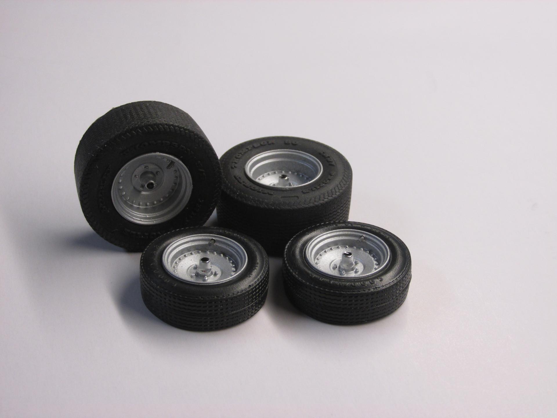

Ace-Garageguy Posted November 5, 2017 Posted November 5, 2017 I've seen clear and other paints shrink and peel off of chrome, so I've developed an anal-retentive technique to develop an "as cast" texture using one of Testors "metalizers". I first carefully mask any part of the wheel I want to remain chrome, with a high-quality fine-line tape. Most wheels usually have a polished or machined lip, and only the center is left as-cast. Then I carefully scrub the part I want to make a cast finish on with Comet (or some other abrasive cleaner) and a stiff brush, which roughens the surface just enough for good adhesion. Sometimes it's necessary to re-mask, sometimes not. Then I shoot a fairly wet coat of metalizer, again for good adhesion, and let it flash off completely. After that, I build up a texture by spraying successive dry coats from farther away. Quit when it looks right. Carefully de-mask. The FRONT wheel below was done that way as a test more than 5 years ago. Cast center, polished rim. No pe Wheels that are supposed to represent fully-machined or die-cast (as opposed to sand-cast) units, I simply strip first, scrub with Comet, and shoot wet coats of metalizer...usually 3. Let it dry thoroughly and buff. The front wheel below was done that way.

kmc3420 Posted November 14, 2017 Posted November 14, 2017 (edited) I've seen clear and other paints shrink and peel off of chrome, so I've developed an anal-retentive technique to develop an "as cast" texture using one of Testors "metalizers". I first carefully mask any part of the wheel I want to remain chrome, with a high-quality fine-line tape. Most wheels usually have a polished or machined lip, and only the center is left as-cast. Then I carefully scrub the part I want to make a cast finish on with Comet (or some other abrasive cleaner) and a stiff brush, which roughens the surface just enough for good adhesion. Sometimes it's necessary to re-mask, sometimes not. Then I shoot a fairly wet coat of metalizer, again for good adhesion, and let it flash off completely. After that, I build up a texture by spraying successive dry coats from farther away. Quit when it looks right. Carefully de-mask. The FRONT wheel below was done that way as a test more than 5 years ago. Cast center, polished rim. No pe Wheels that are supposed to represent fully-machined or die-cast (as opposed to sand-cast) units, I simply strip first, scrub with Comet, and shoot wet coats of metalizer...usually 3. Let it dry thoroughly and buff. The front wheel below was done that way. Bill, I assume you are using the non buffing metalizer from model master on the black car above? and the buffing metalizer for the 2nd silver car? Also are you using the metalizer sealer? Edited November 14, 2017 by kmc3420
Ace-Garageguy Posted November 15, 2017 Posted November 15, 2017 Bill, I assume you are using the non buffing metalizer from model master on the black car above? and the buffing metalizer for the 2nd silver car? Also are you using the metalizer sealer?I used the "buffing" product on both of them, actually.The '32 Ford wheel was sprayed "dry" to build up a texture, but not buffed.The special Halibrand wheel on Mickey Thompson's Challenger I was shot wet (just on the verge of running, to avoid getting any texture whatsoever) and buffed after being allowed to dry thoroughly.I usually do NOT use Testors sealer for their metalizers as, in my experience, it ruins whatever effect you've achieved and makes everything just look like silver paint.The "buffing" products will look good for a long time if you don't get your fingers on them during assembly (use gloves), and if the surface dulls slightly over time, if it's NOT sealed, it will respond to a careful re-buffing.Just so there's no confusion, the finish I developed for the body in the lower photo is an entirely different process.
kmc3420 Posted November 15, 2017 Posted November 15, 2017 I used the "buffing" product on both of them, actually.The '32 Ford wheel was sprayed "dry" to build up a texture, but not buffed.The special Halibrand wheel on Mickey Thompson's Challenger I was shot wet (just on the verge of running, to avoid getting any texture whatsoever) and buffed after being allowed to dry thoroughly.I usually do NOT use Testors sealer for their metalizers as, in my experience, it ruins whatever effect you've achieved and makes everything just look like silver paint.The "buffing" products will look good for a long time if you don't get your fingers on them during assembly (use gloves), and if the surface dulls slightly over time, if it's NOT sealed, it will respond to a careful re-buffing.Just so there's no confusion, the finish I developed for the body in the lower photo is an entirely different process. Thanks Bill. I will attempt to duplicate what you have done on my 68 truck wheels I'm building now.
