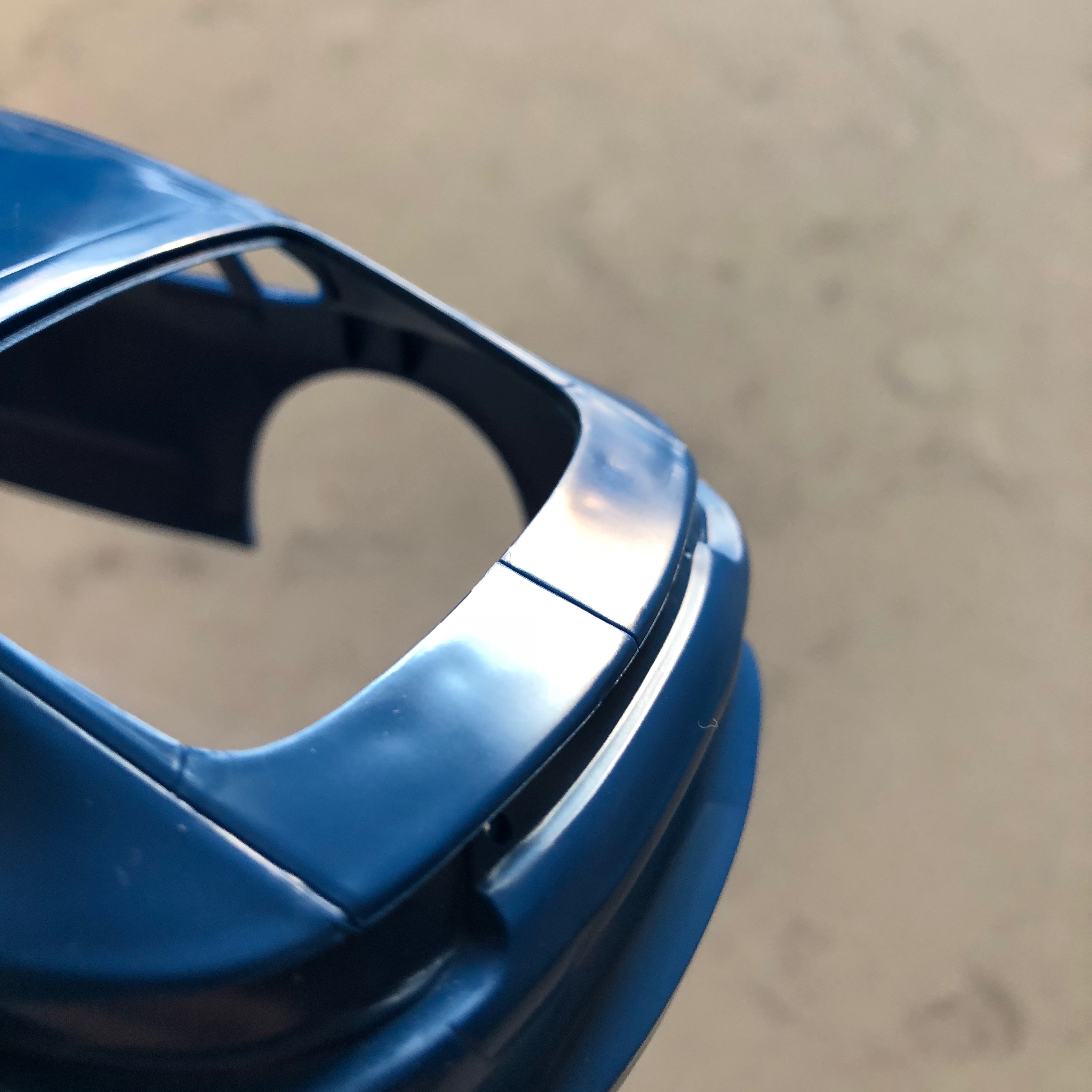

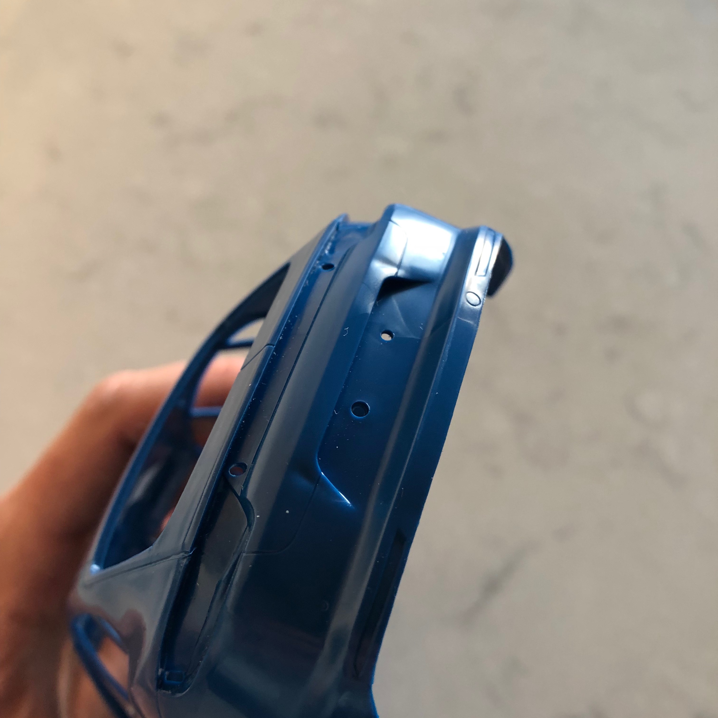

BVC500 Posted December 31, 2017 Share Posted December 31, 2017 (edited) To follow up on Peteski's review, the body molding is a step back for Revell. It looks more crude than recent offerings. There are sink marks on the roof (just above the hatch opening), rear bumper, just above the rear lights on the sides where the bumper meets the quarter panels, and 4 sink marks on the deployable wing. Also, the shut lines are very shallow - - the top of the rear hatch shut line is barely there, and it will be tricky to re-scribe. The rest of the kit looks nicely molded. Edited December 31, 2017 by BVC500 Quote Link to comment Share on other sites More sharing options...

BVC500 Posted December 31, 2017 Share Posted December 31, 2017 (edited) A couple more things about the body. 1) the fenders around the headlights are sloppy and will need to be smoothed out because they headlights are supposed to fit flush at the top of the fender, and the inboard character line is way too pronounced. I did a test fit and they are not flush at the top, which probably can't be corrected without shaving down the fender, but at least it can be minimized with some smoothing. 2) I think the shape of the rear quarter light is off. It's too rounded and not as sleek as the real car, which despite being a sedan, mimics the window shape of the 911. 3) Finally, the slope of the hatch back should not be one continuous line - it should change angles every so slightly at the base of the rear window so that it looks less like a hatchback and more like a sedan. I don't want to sound like a big complainer - I do enjoy cleaning up Revell's bodies as part of the build process - its just a favorite pastime to discuss kit flaws! Edited January 9, 2018 by BVC500 Quote Link to comment Share on other sites More sharing options...

peteski Posted January 1, 2018 Share Posted January 1, 2018 16 hours ago, BVC500 said: To follow up on Peteski's review, the body molding is a step back for Revell. To give credit were it is due, I quoted Daniel's (review) post commenting on his use of English language. As far as the sink holes go I'm no mold engineer, but as I understand, sinkholes are caused by too-thick of a cross-section of the item being molded. That is a mold design issue. Or possibly by not injecting enough liquid styrene. Quote Link to comment Share on other sites More sharing options...

BVC500 Posted January 1, 2018 Share Posted January 1, 2018 (edited) Look, the rear only has one parking sensor! It is also missing the parking sensors on the sides of the front bumper (has them on the bumper front). Edited January 1, 2018 by BVC500 Quote Link to comment Share on other sites More sharing options...
