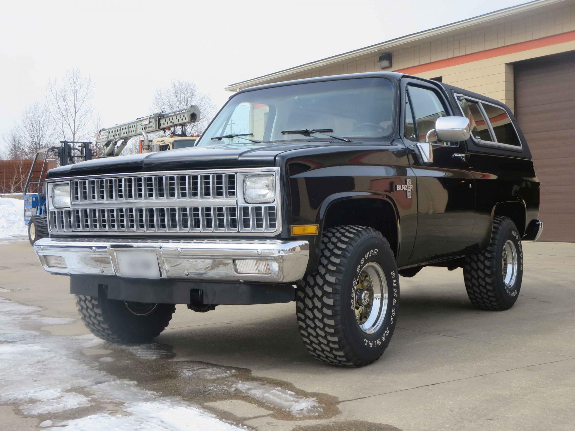

av405 Posted December 14, 2017 Posted December 14, 2017 Your resin grill is for a 1981-1982 model. Typically it was the lower-trim Custom Deluxe that had the single headlight grill. Most Blazers didn't have these so that grill is perfect.
