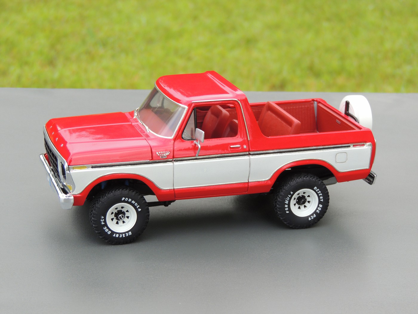

bogger44 Posted December 30, 2017 Posted December 30, 2017 Casey's method is exactly what I did when I added chrome trim for the deluxe two-tone on my '79 Bronco. I ended up doing it in three pieces. One long strip along the bottom, one for the vertical in the rear, and a short, wider strip for the small amount behind the rear marker light. Luckily there was no black on that trim on the 1:1 so it made it much easier. I'm not sure the best way to tackle that aspect of the trim you'll be replicating, that's a tough one and wish I could help some. When you're comfortable with adding the trim to the body, just make sure to take it nice and slow with patience, and success with follow.
