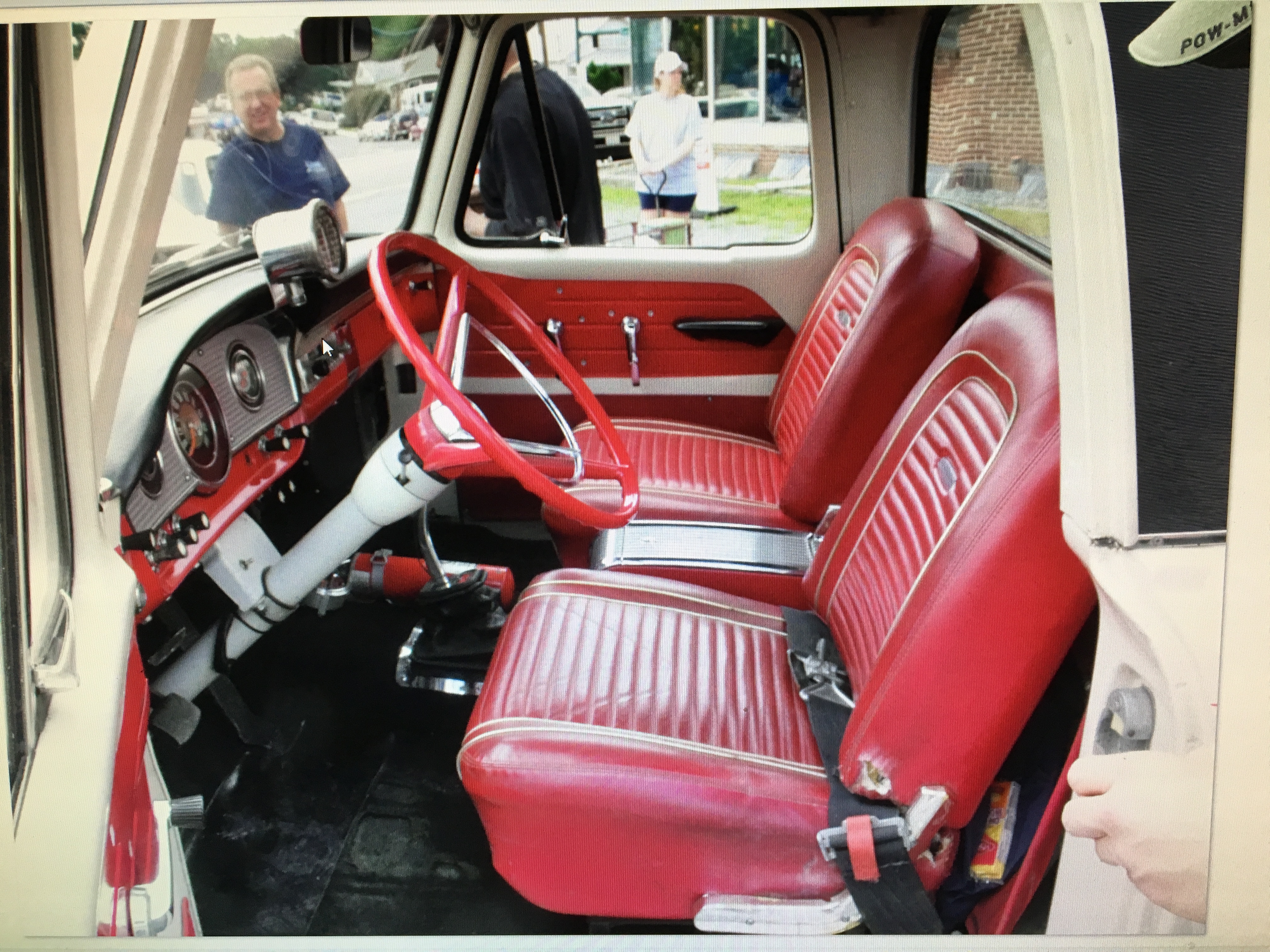

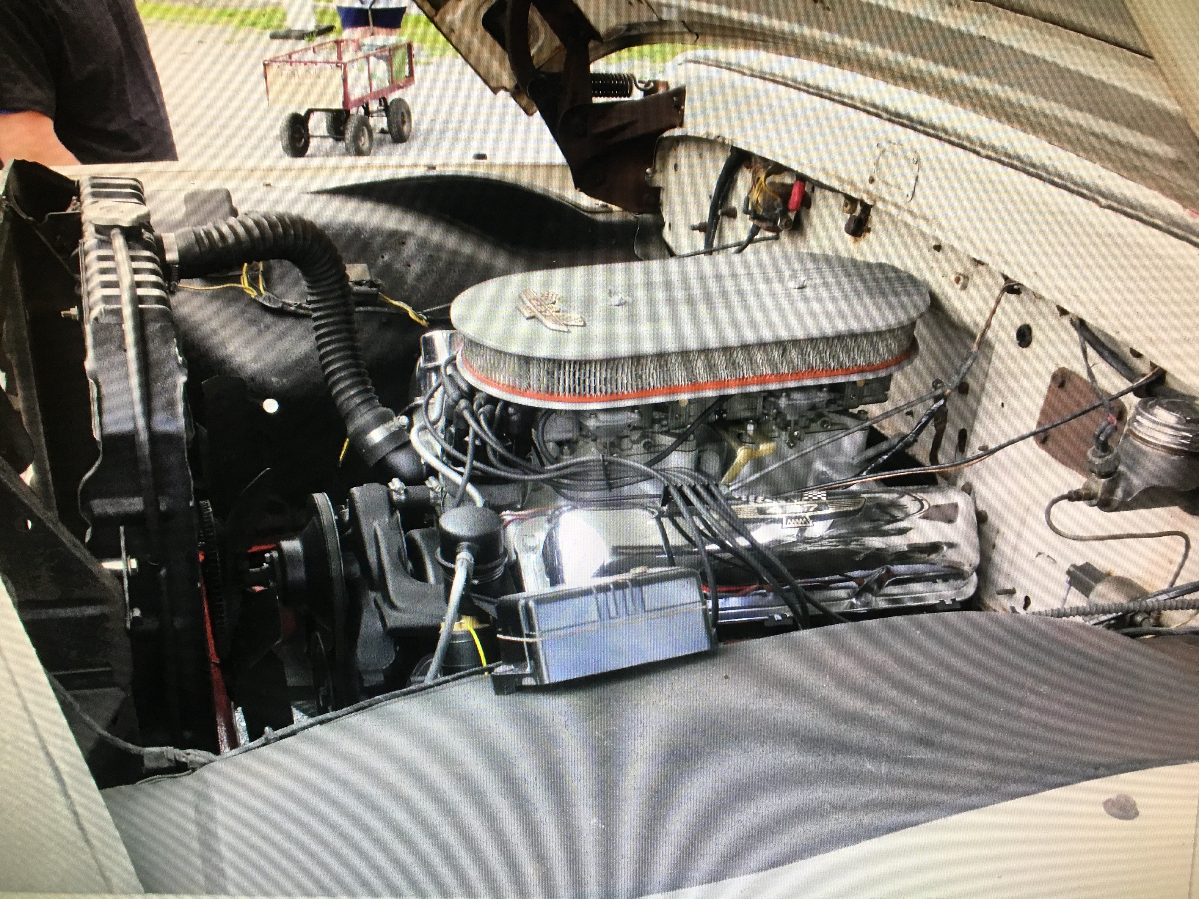

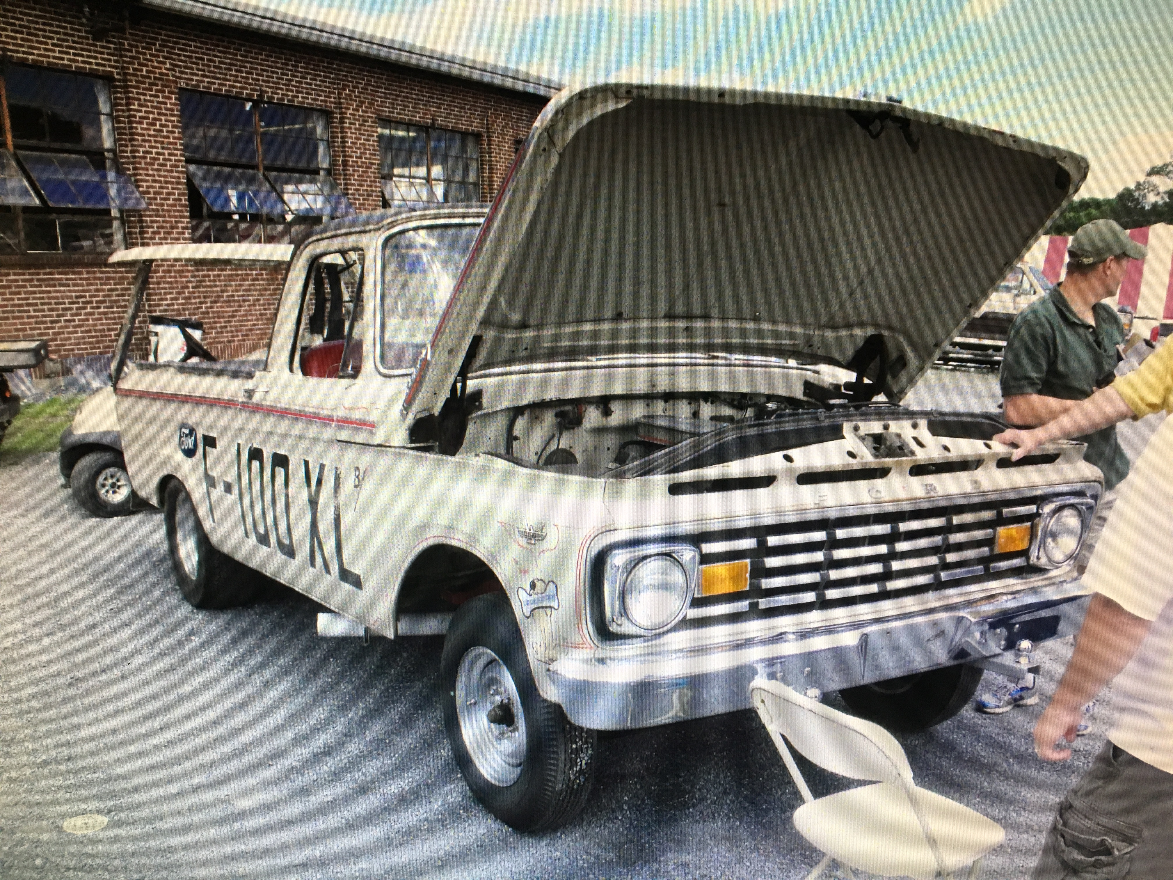

Mercuryman54 Posted January 8, 2018 Posted January 8, 2018 Here’s a few pictures I took of this truck at the All Ford Nationals in Carlisle, PA in 2012. Dennis
1930fordpickup Posted January 8, 2018 Posted January 8, 2018 I just noticed the vinyl top with the close up photos of the interior.
