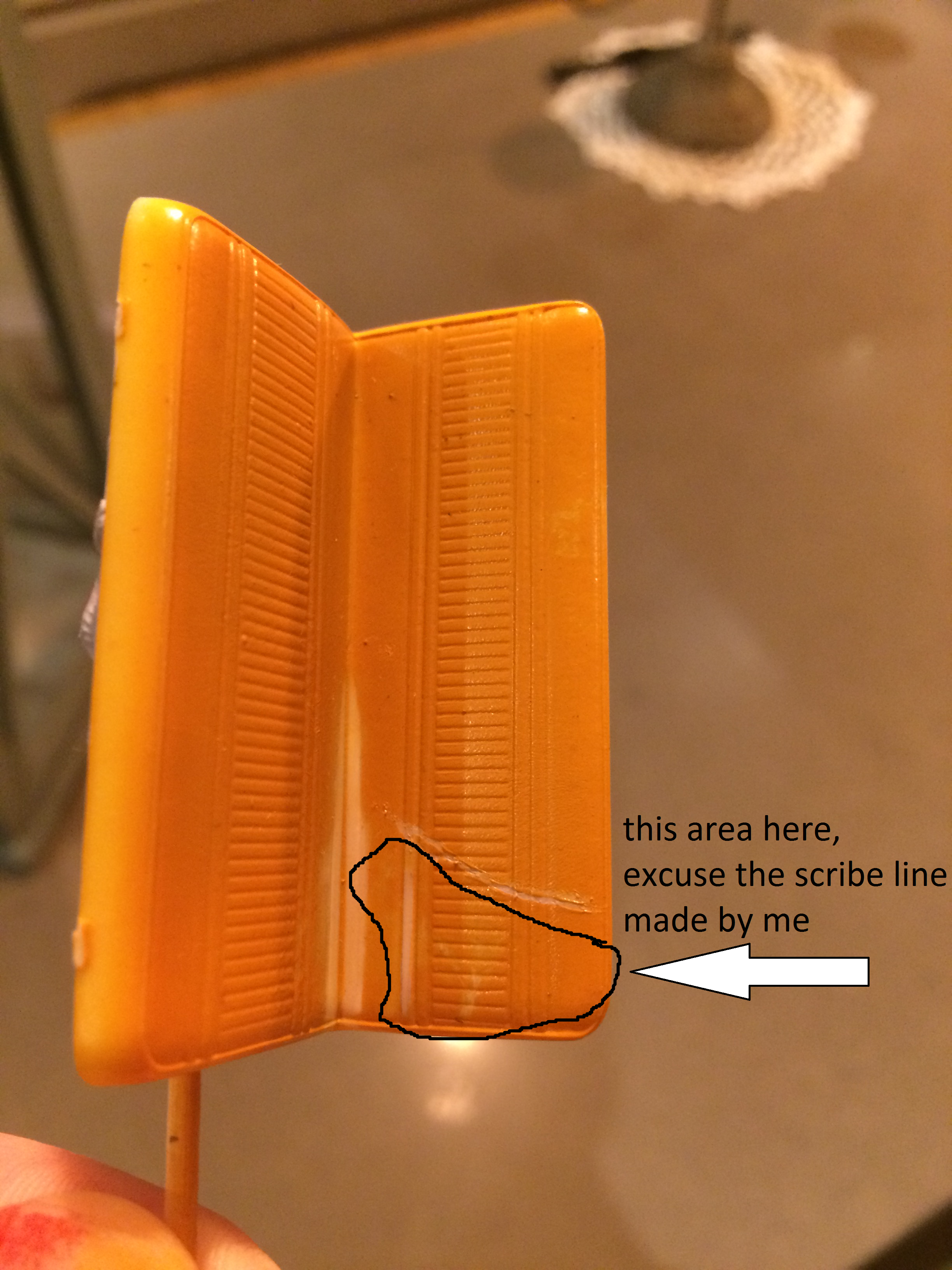

joeb99 Posted January 8, 2018 Posted January 8, 2018 (edited) Greetings all, so today i started a new model decided to paint in some zero paints colour matched orange. i started off by applyind two coats of zero light grey primer followed by 4/5 light coats of orange using airbrush by the way. after letting the paint dry for 30 mins i decided to go ahead with clearcoating using some tamiya TS-13 in a spray can. however almost immediatly the clear coat seemed to "eat away" at parts of the paint revealing the primer below. the clear coat did not dissolve all of the orange paint but is noticible in most places. i have not come across this problem before and i applied paint in light coats to get a smooth finish. My only thoughts would be to leave the paint to dry out for longer up to a week before clearcoating to make sure the surface is absolutely solid. any help or advice would be greatly appreciated. many thanks joe Edited January 8, 2018 by joeb99

joeb99 Posted January 24, 2018 Author Posted January 24, 2018 thank so for the response guys. after some recent practice i have managed to get the two paints to work together, the main issue is drying time of the colour, having left the paint to dry for about a week the ts13 works with the zero paint and doesn't eat into it. as long as you use plenty of light coats you should be ok. using 2 coats of primer and 4 /5 colour followed by a further 2 coats of ts13 worked fine
