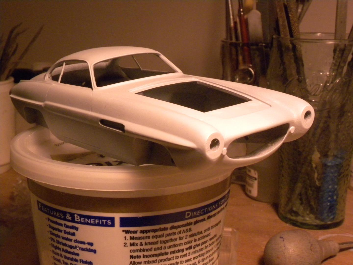

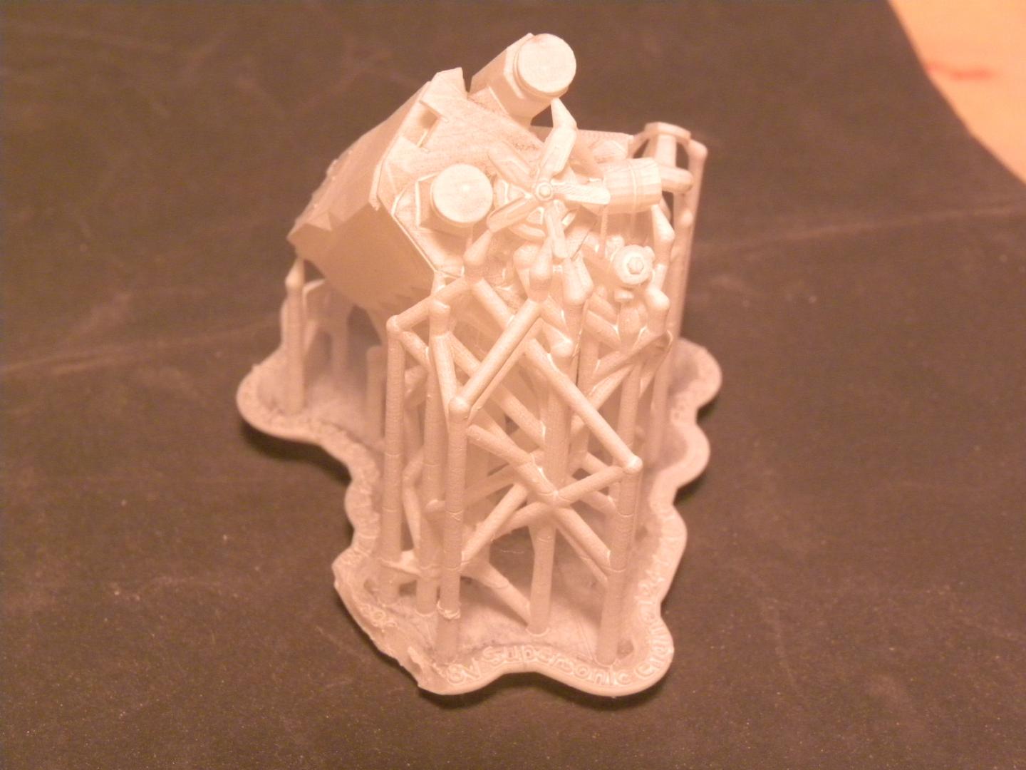

After a long design process, I have received from my 3d printer this body propped up by a framework of supports. Now the fun part begins.

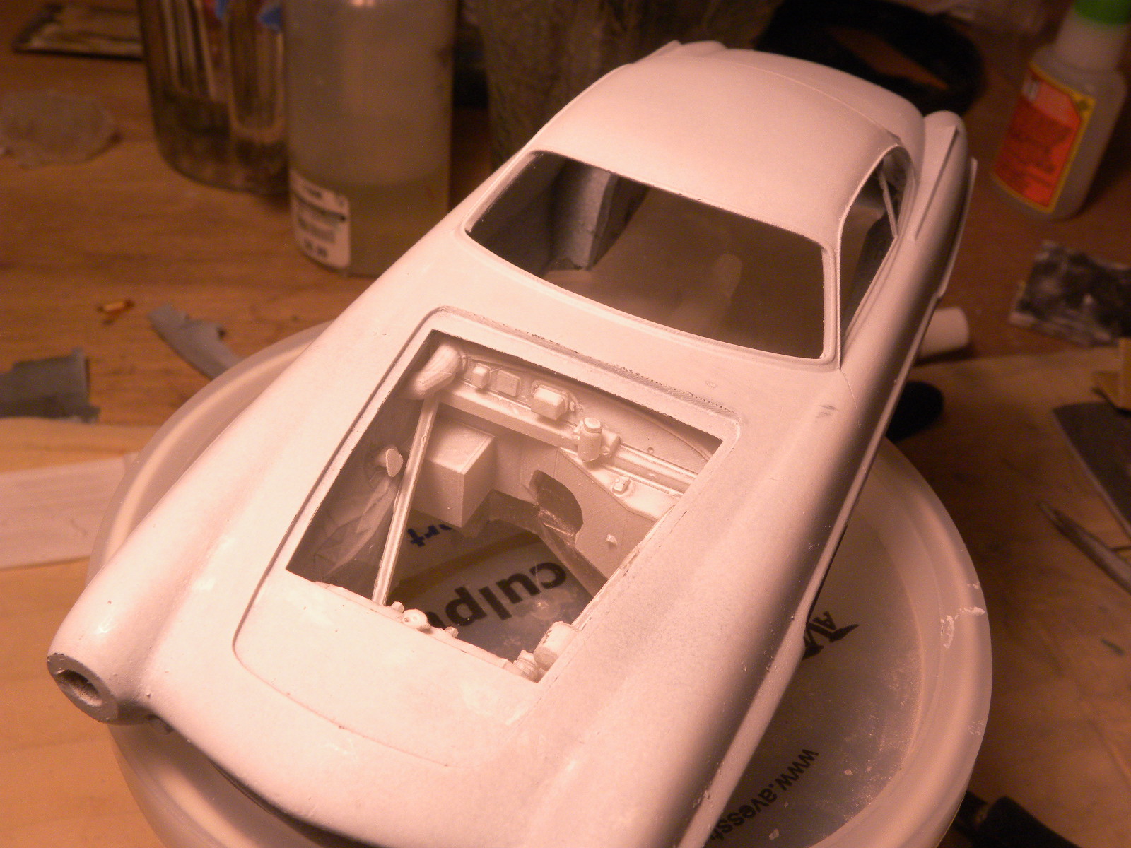

A coat of gray primer and a light sanding with 600 grit paper and the minimal layering is obvious. Easy finish work!

Beautiful body and the layering really appears minor. What are your plans for the chassis, interior, engine - basically what are your plans for the rest of the car?

Three coats of primer and light sanding and it's in good shape, not ready for paint, but close. The engine compartment snaps into place - that's all one piece. Other parts have required some filing around the edges.
That really is one of the smoothest bodies I've seen printed. Do you recall what the material is  (i.e. acrylic) and what the printing process is  (i.e. liquid plastic hardened with laser or powder sintered with laser)?
I can't wait to see the motor! I'm assuming that's also printed (?). I'd love to hear one of those in person - 2 liter, 70 degree V8 with max power at 6000rpm!

The type of printing is the resin hardened with a laser, it resembles acrylic. It may be acrylic? Talking with the 3d printer dude yesterday, he said I could avoid the supports connecting to the important parts of the engine by dividing it in half so the supports all come off the inner half, not the exhaust headers, manifold, etc. Might be a trick removing the supports and not taking something important with it.

The equivalent material from Shapeways is called "high definition acrylate", being a light cured liquid. The examples on their website show a support structure very similar to your parts. Since the application of the supports is fully automated, there's probably little that can be done to keep them away from delicate, "real" details so your printer's suggestion to split the engine into two halves is most likely the safest way to go.

Gotta say - this is a very striking car and you have really captured the essence of its lines and proportions. Very very well done, sir.
