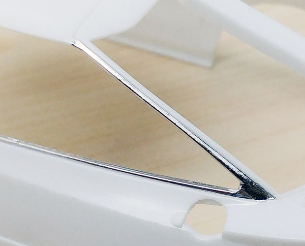

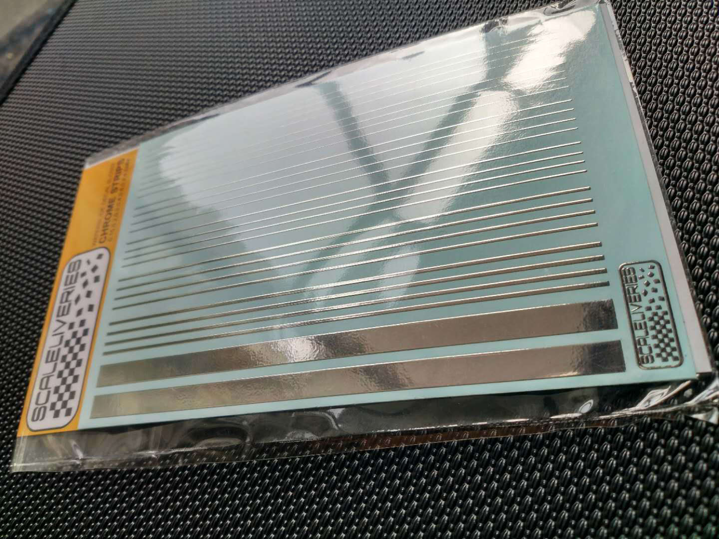

Scaleliveries Posted February 2, 2018 Posted February 2, 2018 Maybe this cab help https://scaleliveries.com/2018/02/02/borderless-waterslide-chrome-stripes-decal-for-all-scale/

espo Posted February 2, 2018 Posted February 2, 2018 That's an interesting product. 9 hours ago, Scaleliveries said: Maybe this cab help https://scaleliveries.com/2018/02/02/borderless-waterslide-chrome-stripes-decal-for-all-scale/ How does the thickness compare to Bare-Metal Foil ??
