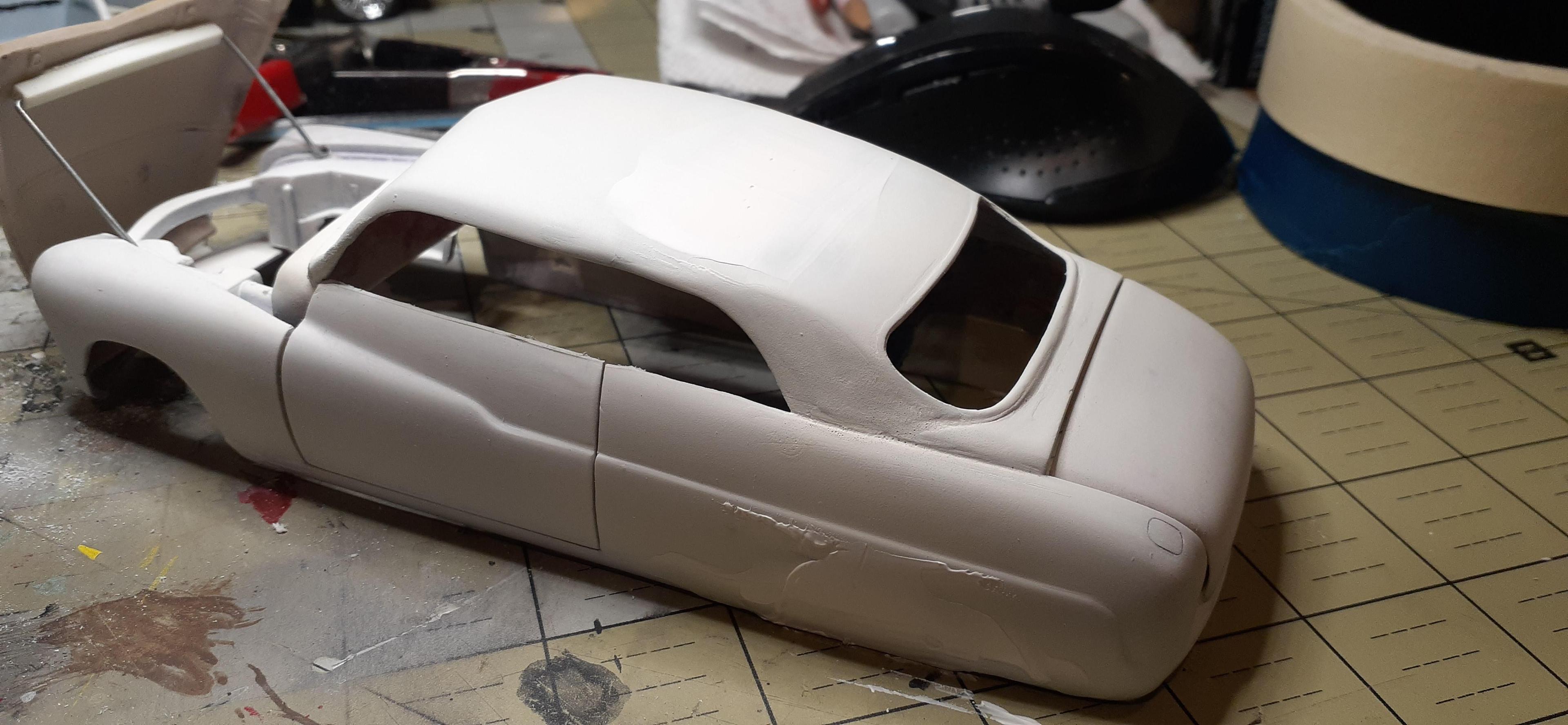

Slotto Posted January 28, 2018 Author Posted January 28, 2018 I have two of these bodies/ Here's the before profile Here's the after profile. Subtle but makes all the difference in the world. I wanted to make it look like it's moving while it's standing still. Almost ready for primer. So far I've cut open the doors, removed the window frames from the doors, shaved the door handles and locks, shaved all the trim, rain gutters and emblems, rolled the rear panel, shaved the wipers and lowered the back half of the roof and used the discarded window frames as the basis for the back windows. Stay Tuned...

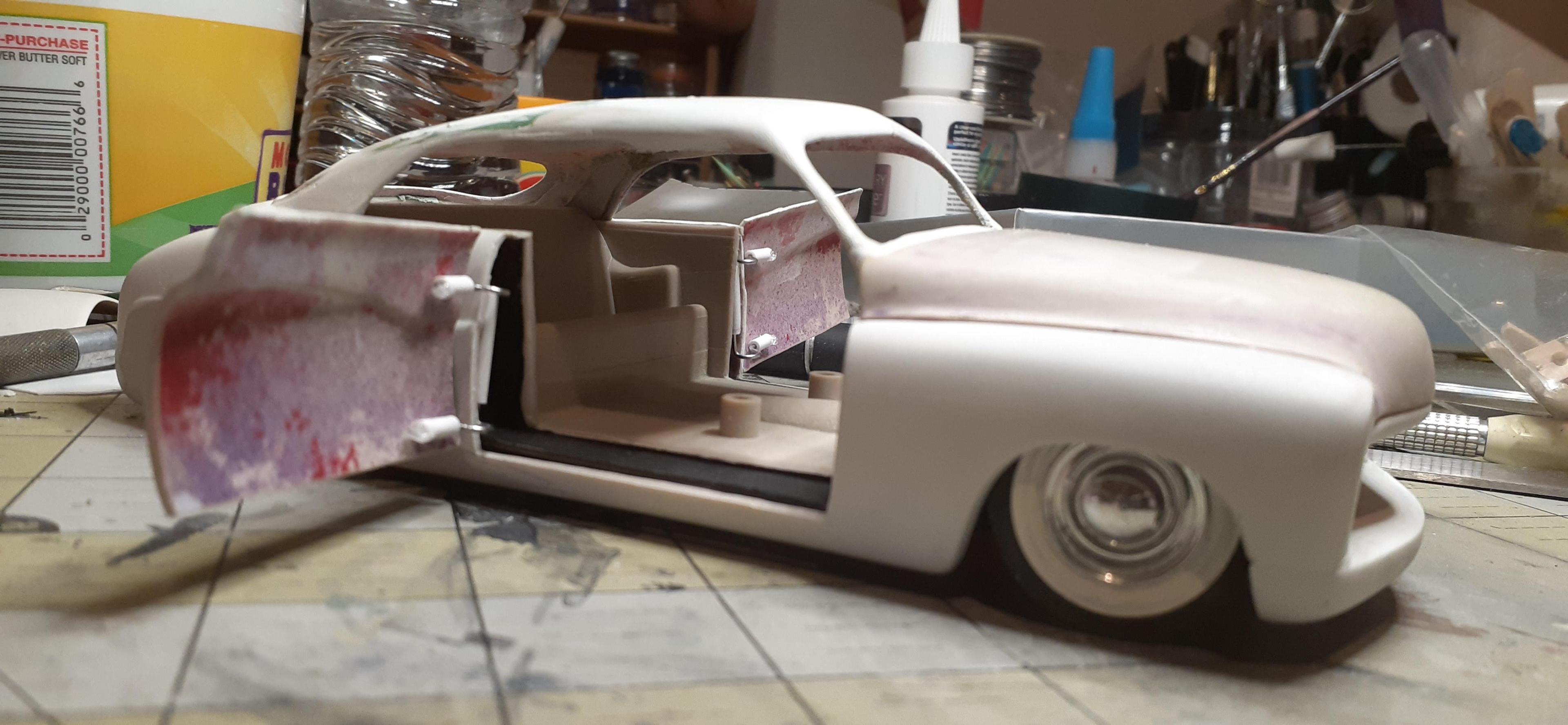

Slotto Posted February 7, 2018 Author Posted February 7, 2018 After much back and forth, I decided to add in the skirts. They are meant to be mounted to the outside of the fender. This didn't go along with my plans so I cut them to fit inside the wheel opening and still retain that cool reveal at the bottom of the skirt. Stay Tuned... 1
High octane Posted February 7, 2018 Posted February 7, 2018 Wow, that's some drastic work you're doing on that Merc, and I really like the suicide doors and front tilt hood also.
Slotto Posted December 6, 2022 Author Posted December 6, 2022 I might be resurrecting this old build. I picked up some new putty the other day. It's really creamy. Just what I need to slap in this roof. It has a slight dip the entire width that needs to be filled. 3
espo Posted December 7, 2022 Posted December 7, 2022 Wow, it's back. Forgotten all about this build. Look forward to seeing what you try next on this.
customline Posted December 7, 2022 Posted December 7, 2022 21 hours ago, Slotto said: I might be resurrecting this old build. I picked up some new putty the other day. It's really creamy. Just what I need to slap in this roof. It has a slight dip the entire width that needs to be filled. It's good to dig into those stalled projects and see them in a new light. ?. Have you considered using Bondo professional glazing putty (the two part type) ? It really speeds up the filling process and it doesn't shrink. Seems like just the thing for this job. 1
Slotto Posted December 8, 2022 Author Posted December 8, 2022 (edited) I hate doing body work. That's the main reason this one stalled. This putty isn't as great as I thought. It's kinda rubbery if you sand too rough and it does shrink when it sets up. I will most likely get some bondo. Thanks for the tip Edited December 8, 2022 by Slotto
customline Posted December 8, 2022 Posted December 8, 2022 1 hour ago, Slotto said: I hate doing body work. That's the main reason this one stalled. This putty isn't as great as I thought. It's kinda rubbery if you sand too rough and it does shrink when it sets up. I will most likely get some bondo. Thanks for the tip There are other brands that are as good or better but the Bondo stuff has worked fine for me. I learned about it on this forum several years ago. Never went back. The hobby stuff is OK for very minor filling but not chopping tops. I will also use the thick CA with a kicker for bodywork where strength is needed and cover with the Bondo. I use Mr. Surfacer for the really small stuff. I Didn't mean to turn your thread into a tutorial but some of that odd-colored filler you are using got me stirred up. Sorry. ? S 1

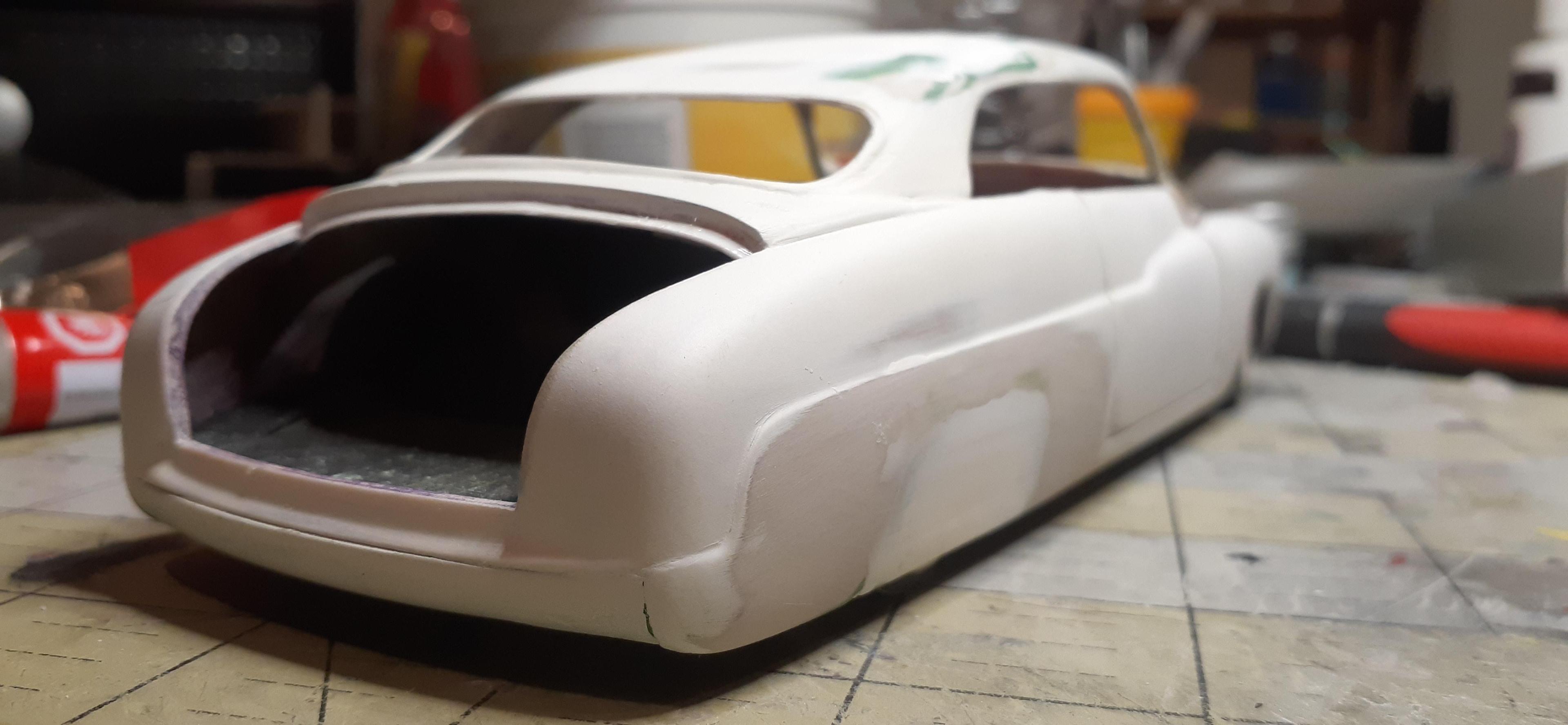

Slotto Posted December 17, 2022 Author Posted December 17, 2022 Taking a break on the filler. It's so frustrating take it off, put more on...its a vicious cycle. Finally got around to the door hinges and I'll be adding the trunk hinge today. 1
customline Posted December 21, 2022 Posted December 21, 2022 What would be the scenario for changing a flat on the rear if this was a 1:1 ? The skirts would appear to seriously inhibit that operation. Hydraulics?
