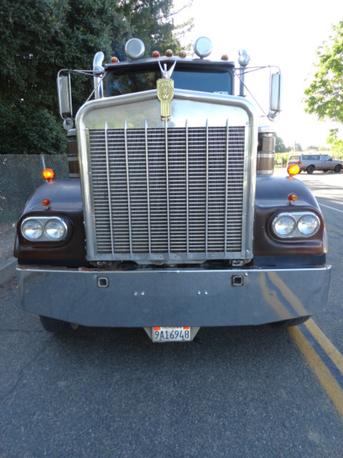

highway Posted January 30, 2018 Posted January 30, 2018 1 hour ago, mistermodel said: Some pictures of the truck clearly show gold emblems that were avalible in 73 for kw's 50th anniversary While it does appear at least in the first pic Snowman's truck does have a gold hood emblem according to IMCDB (Internet Movie Cars Database), the truck was not a 73 but a 72. http://www.imcdb.org/vehicle_10238-Kenworth-W-900-A.html On a semi (no pun intended) related note though the question pertains to another famous W900 and also to the gold emblems, I have notice binge watching "Movin On" that ALL of the Kenworth emblems are gold, the front hood emblem and also all the Kenworth scripts on the side of the hood and sleeper. Also, according to IMCDB, it was a 74 W900 VIT. http://www.imcdb.org/vehicle.php?id=42128&l=de Were all the gold emblems on this because of the 50th anniversary as mentioned or was it because the truck was done with the VIT trim?

KJ790 Posted January 30, 2018 Posted January 30, 2018 1 hour ago, highway said: While it does appear at least in the first pic Snowman's truck does have a gold hood emblem according to IMCDB (Internet Movie Cars Database), the truck was not a 73 but a 72. http://www.imcdb.org/vehicle_10238-Kenworth-W-900-A.html On a semi (no pun intended) related note though the question pertains to another famous W900 and also to the gold emblems, I have notice binge watching "Movin On" that ALL of the Kenworth emblems are gold, the front hood emblem and also all the Kenworth scripts on the side of the hood and sleeper. Also, according to IMCDB, it was a 74 W900 VIT. http://www.imcdb.org/vehicle.php?id=42128&l=de Were all the gold emblems on this because of the 50th anniversary as mentioned or was it because the truck was done with the VIT trim? All of the Kenworth emblems were gold on the '73 model. Kenworth debuted the 60" VIT sleeper in 1974. For the show Movin' on, they used two 1974 models and then they came across a 1973 leftover at a dealer that was spec'd the same except with a 36" sleeper. The studio swapped out the 36" sleeper for a 60" sleeper and painted it to match the other two. This is why some times the emblems are gold and sometimes they are silver depending on the scene in the show. As for Snowman's truck, I have a feeling a similar situation happened. In this picture you can see the gold emblem on the side of the hood, but the bottom of the emblem is also painted (most likely a quick movie studio paint job). The front grille emblem on a '73 model should be red and gold, but in some scenes of the movie it appears to be black and gold, so who knows if it is really a '73 badge or if it is a painted one. The marker light on the side of the hood was typical of a 1969-1970 model. I have a feeling these trucks were thrown together. The cab doors have the slower paddle style door handles, so the cab would be a '72 and up. If you just want something that will look good on a shelf, you could just get the AMT W925 kit and make a few tweaks to it. This kit really is a 1969-1971 model, but it would be pretty close. You can change the door handles, up-size the exhaust pipes to 5" pipes, and add a battery box to the passenger's side.
highway Posted January 30, 2018 Posted January 30, 2018 1 hour ago, KJ790 said: All of the Kenworth emblems were gold on the '73 model. Kenworth debuted the 60" VIT sleeper in 1974. For the show Movin' on, they used two 1974 models and then they came across a 1973 leftover at a dealer that was spec'd the same except with a 36" sleeper. The studio swapped out the 36" sleeper for a 60" sleeper and painted it to match the other two. This is why some times the emblems are gold and sometimes they are silver depending on the scene in the show. Thanks for the info KJ, I noticed the gold emblems on the earlier episodes I've been watching (Hulu has them marked as season 1 but I believe they were actually seasons 1 & 2 since there were 22 episodes in "Season 1") and the later episodes have the chromed emblems. Even though I know it doesn't have the correct torsion bar suspension I seen in a couple of episodes, I'm going to use this for Sonny's truck. By the way KJ, do you happen to make any 1/16th scale parts, especially tires and wheels?

Force Posted January 30, 2018 Posted January 30, 2018 11 hours ago, KJ790 said: As for Snowman's truck...The front grille emblem on a '73 model should be red and gold, but in some scenes of the movie it appears to be black and gold, so who knows if it is really a '73 badge or if it is a painted one. The one on the movie truck looks to be gold with black ribs and letters. Here is a couple of pictures of one of the movie trucks used for most of the outside shots. "Tod Engels" truck from the first scene in the movie also had a gold grille emblem, it's a bit hard to see but the background is gold and it seems like the ribs and letters could be chromed or maybe all gold. Here is another 1973 truck I found were the emblems are all gold. As for the Torsion Bar suspension, Auslowe in Australia has it in resin.
