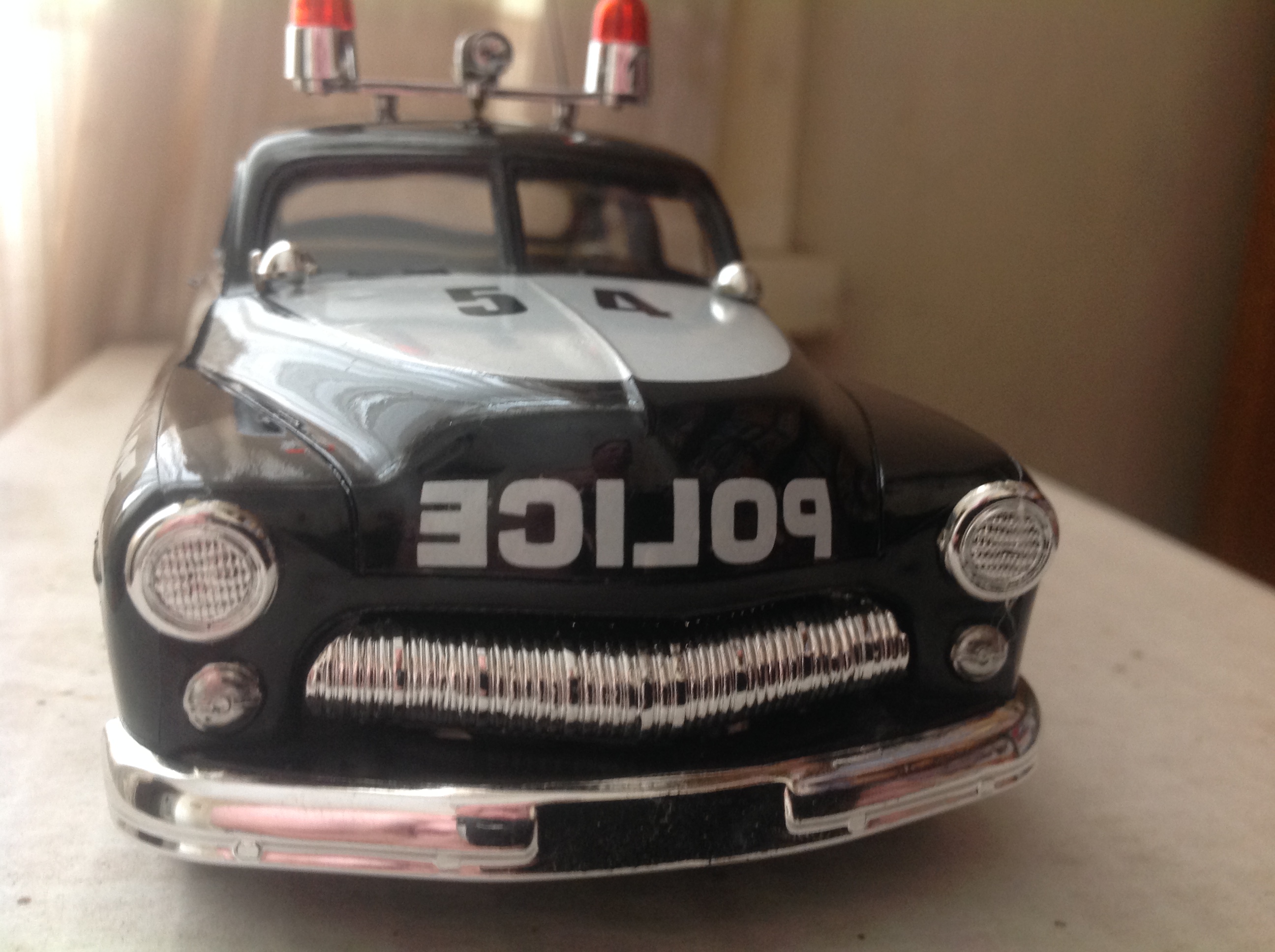

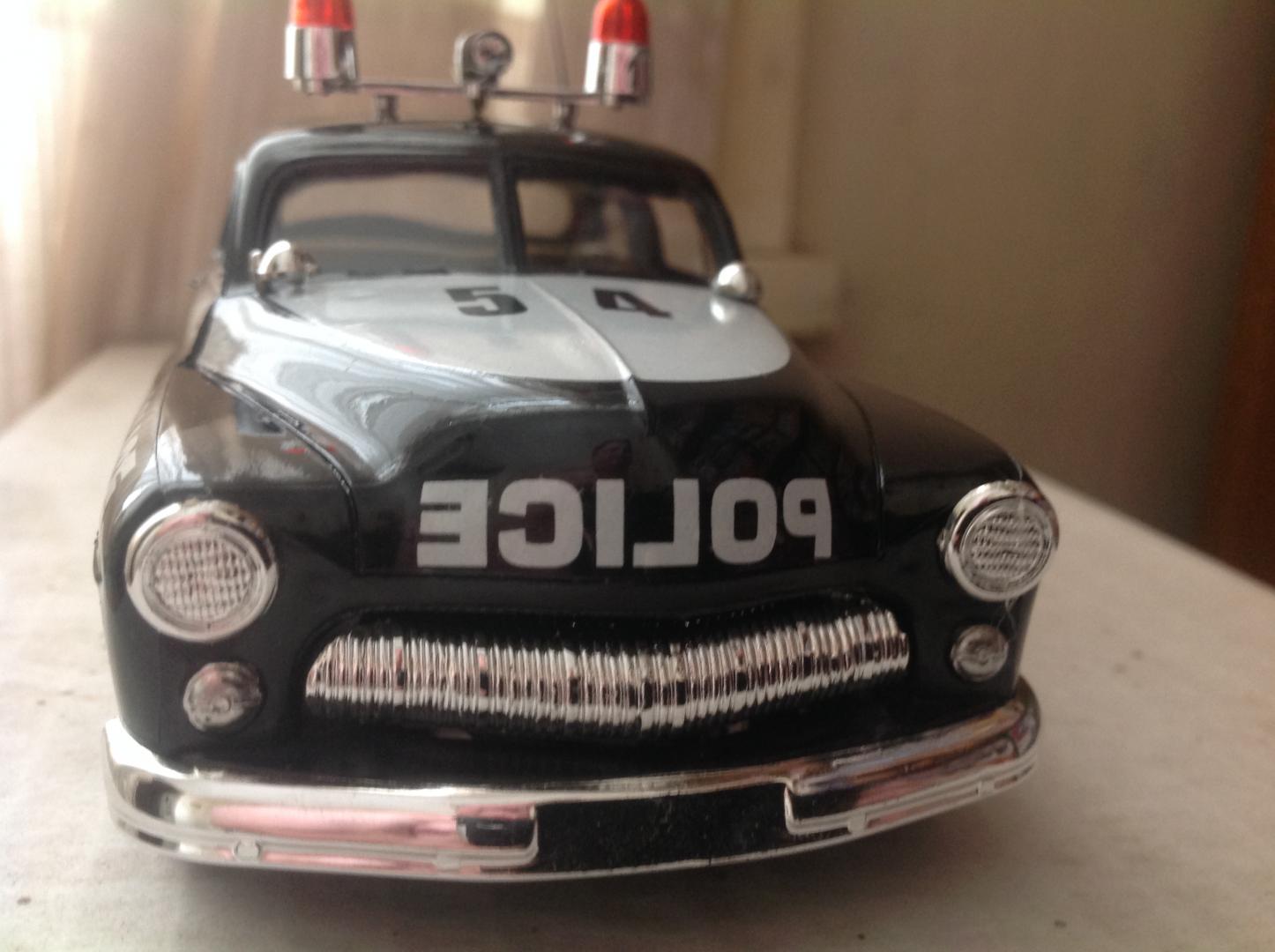

disabled modeler Posted February 4, 2018 Posted February 4, 2018 John...I have polished the bodies on them before but normally I do it to the old promos I restore...its not hard unless there is any body damage.or there scratched up. I never could post photos but have some I have done.

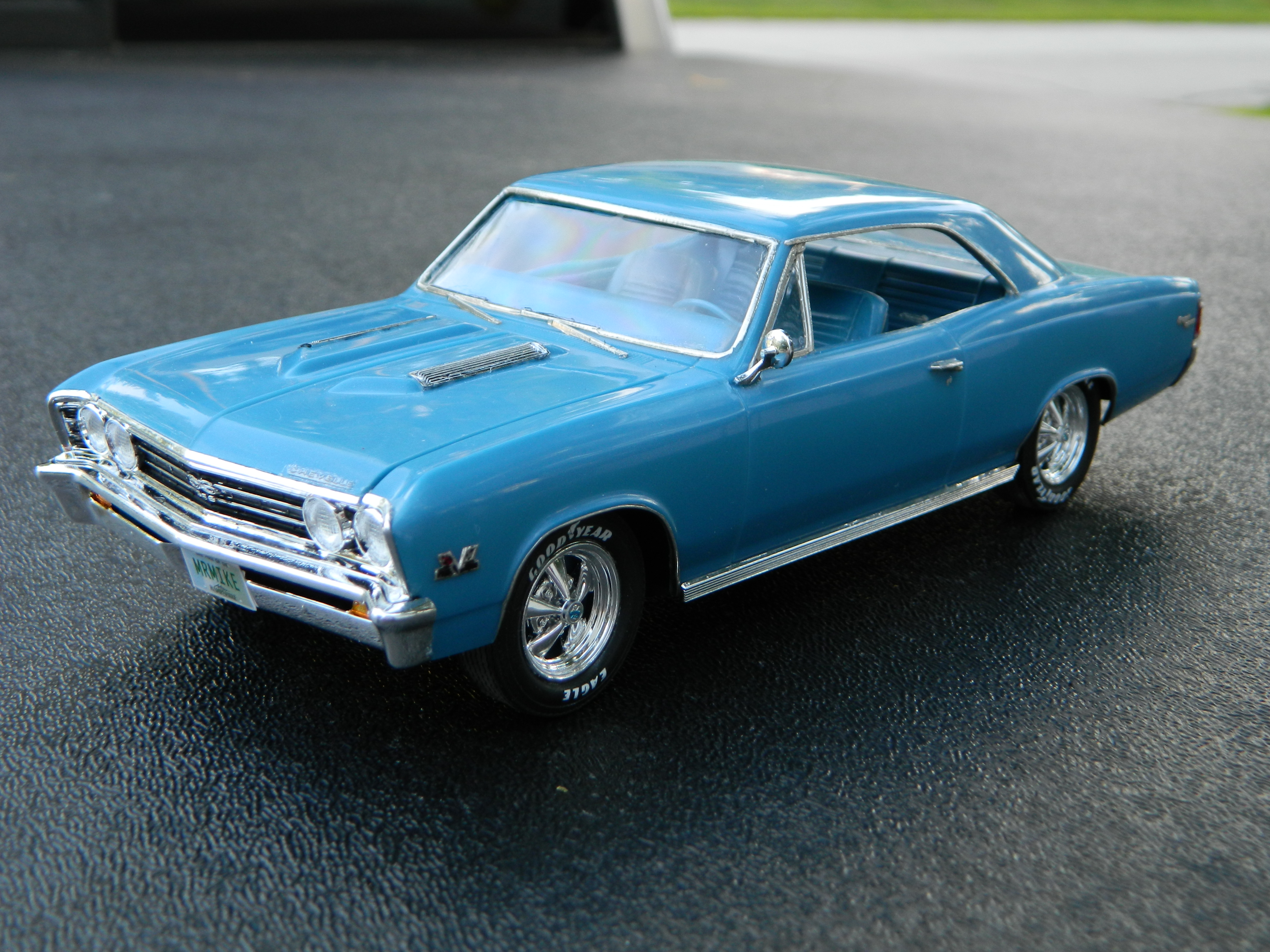

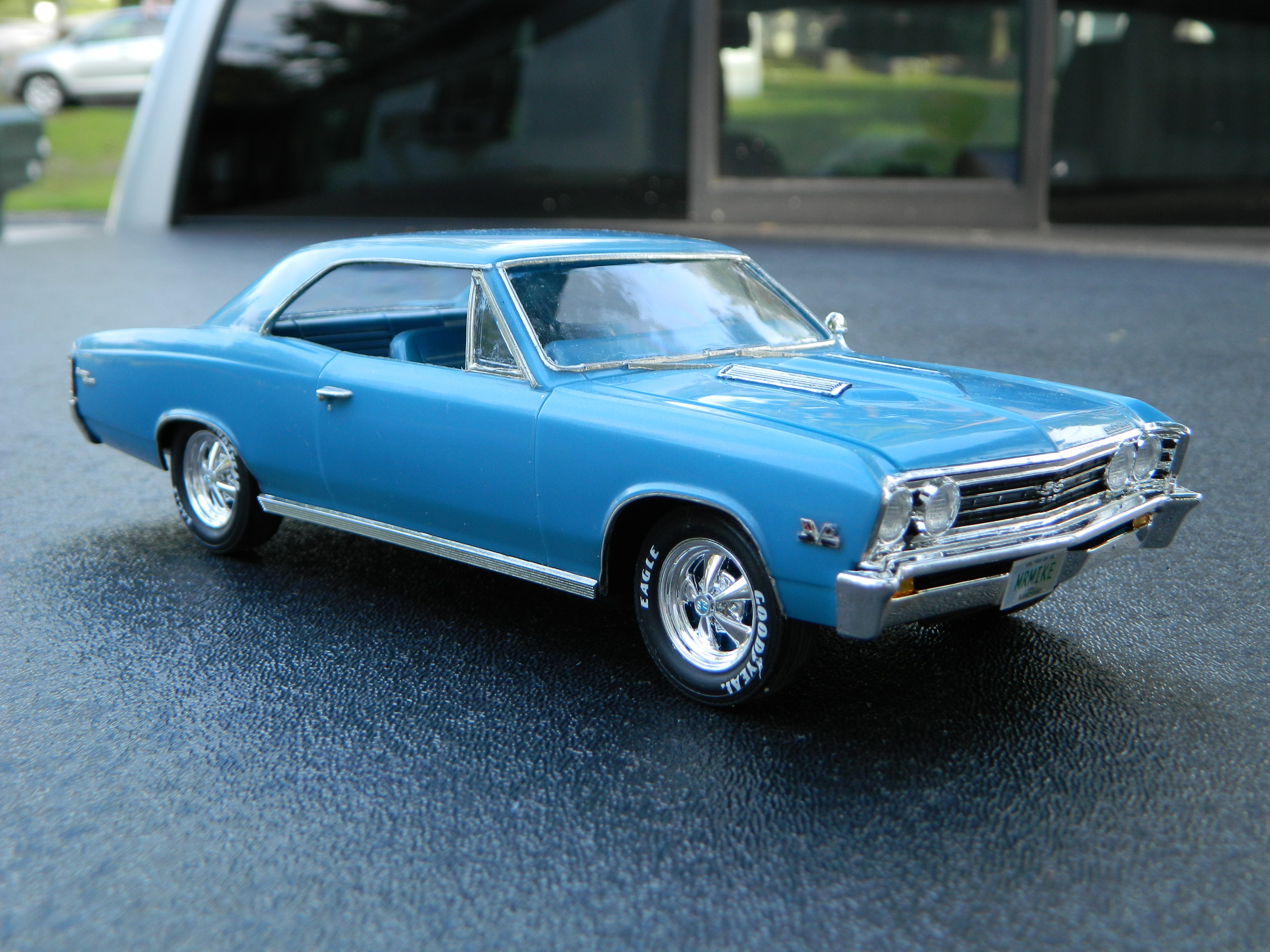

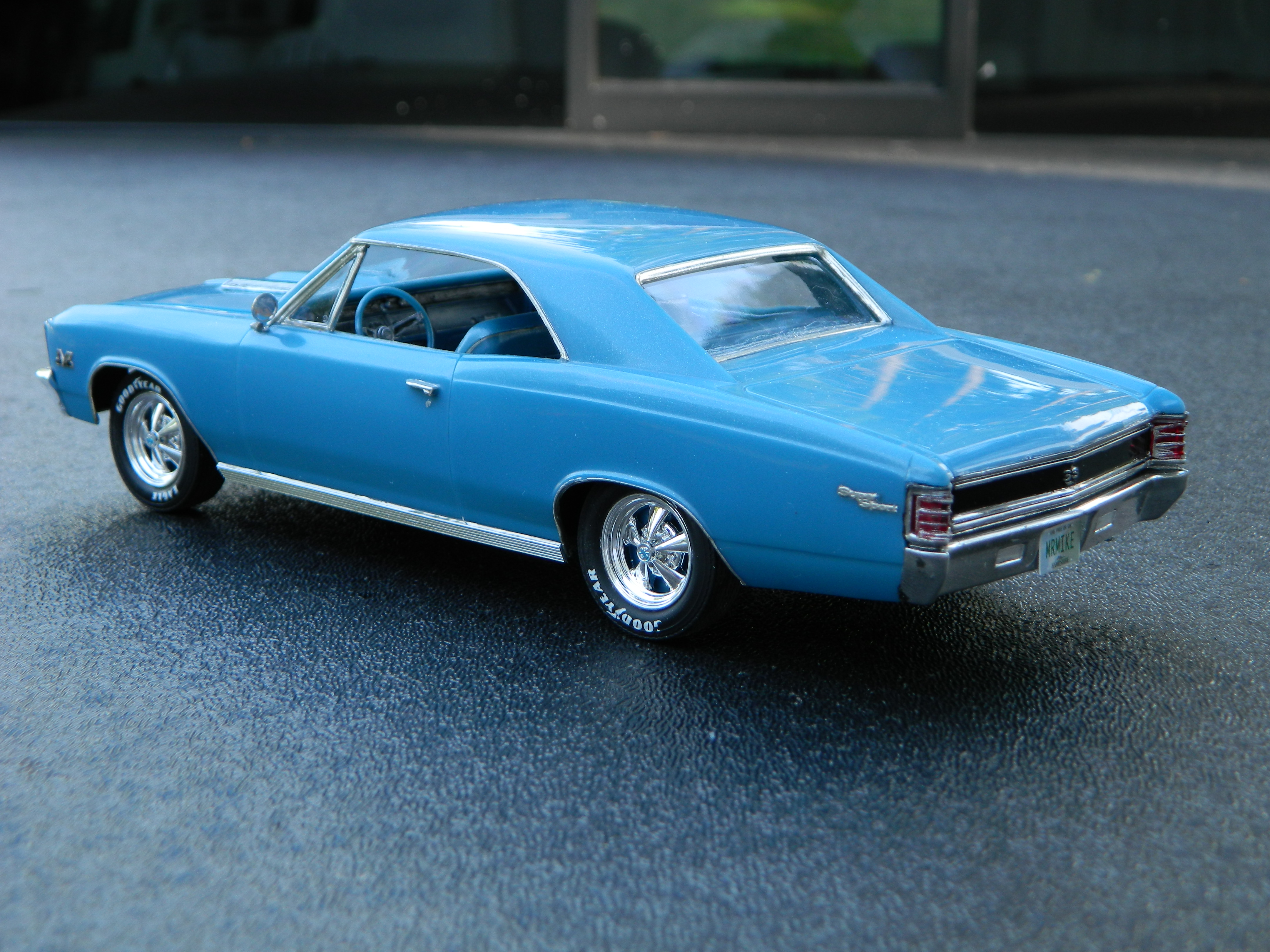

mrmike Posted February 4, 2018 Posted February 4, 2018 WOW! Such high praise John! Thank you! I have posted some pictures of that '67 Chevelle SS396 for you to continually be inspired to build yours. I used Meguiar's Scratch X 2.0 to polish my Chevelle. The shine is impressive! The only issue with the body is were the metallic plastic had joined in the mold leaving a line on the passenger door.

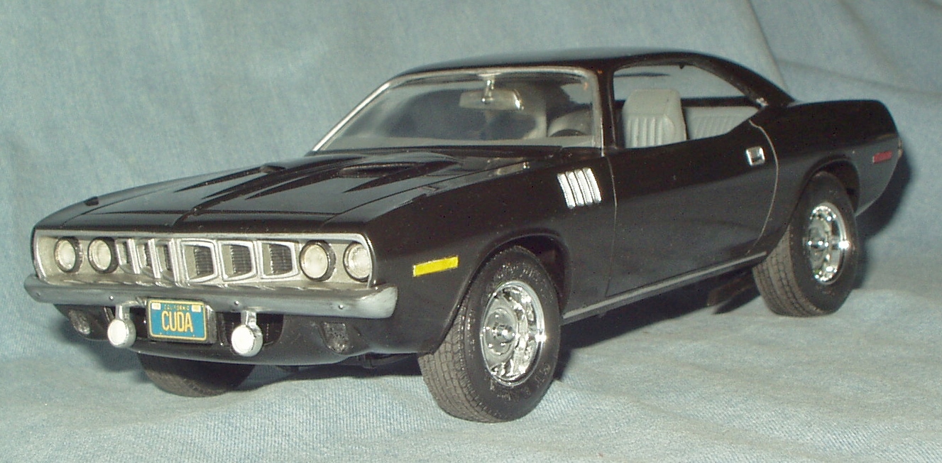

Snake45 Posted February 4, 2018 Posted February 4, 2018 A '67 Chevelle would be Marina Blue. LeMans Blue would be a '68-'69 Color. I start by scribing out all the door lines etc, and knocking down mold lines and the panel line "dams" with very fine sandpaper. I've never used any kind of special "plastic polish" products, just Wright's Silver Cream silver polish and Trim Nail sticks, both from Walmart. The nail sticks work great and fast but won't get into all areas on all models (and Walmart hasn't had them for several months now). I buy white felt squares in the crafts section and cut them into 1" strips and use those to apply and rub the Wright's. Final buff is with an old flannel shirt. Don't have time this morning to post a lot of pics, but lemme see if I can find a couple on my hard drive real quick for you.

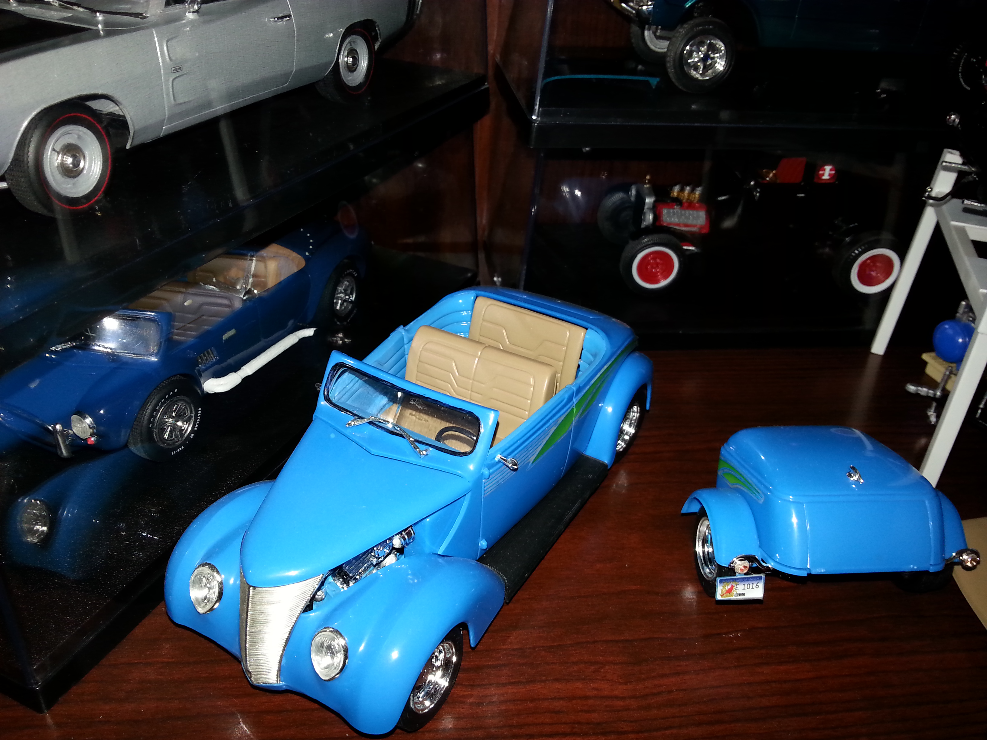

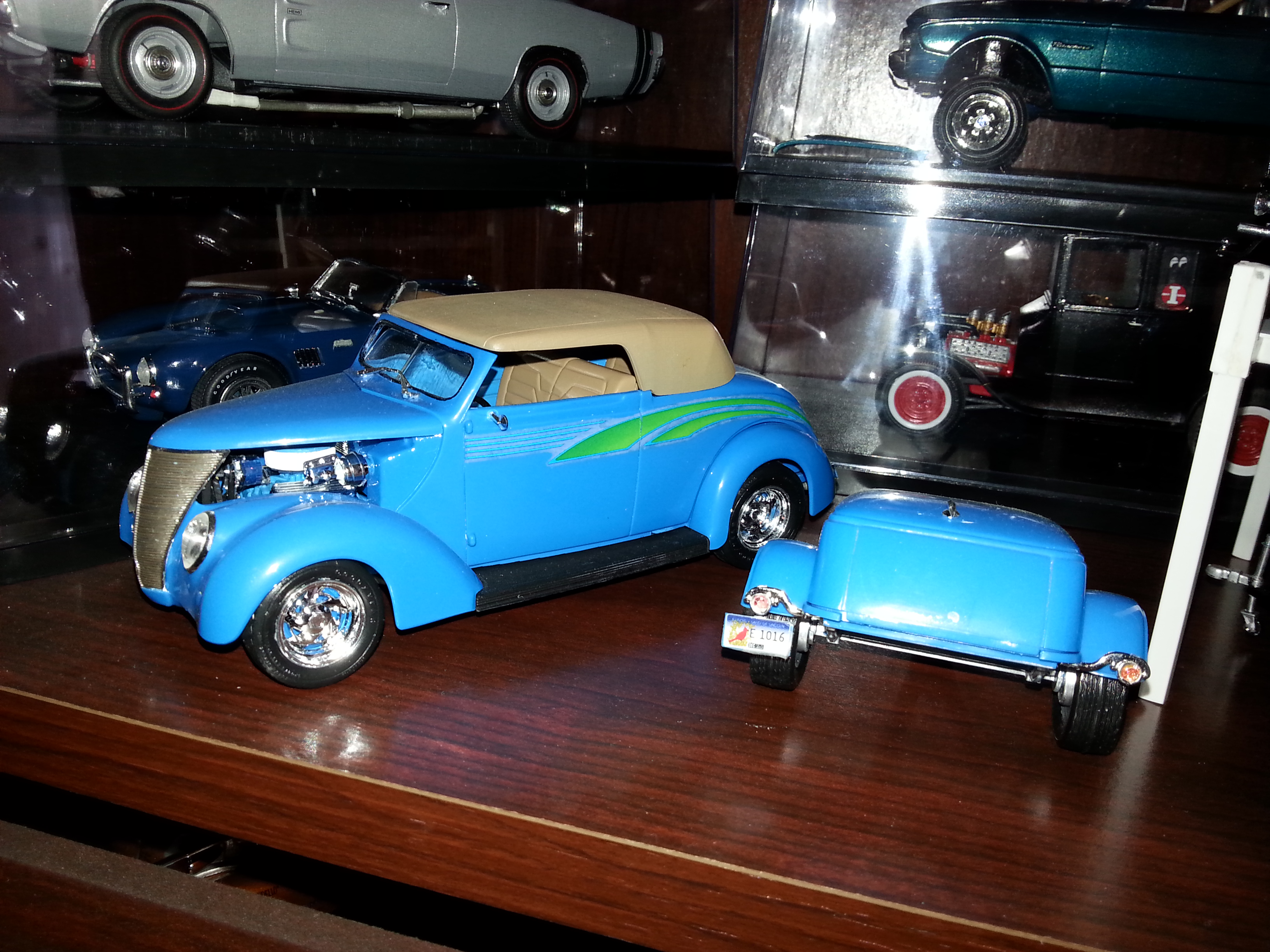

Johnt671 Posted February 4, 2018 Posted February 4, 2018 This is my first attempt at polishing a kit molded in blue. I liked the color so I gave it a try, and it worked out pretty good. I used Meguiar's Ultimate Compound.
Greg Wann Posted February 4, 2018 Posted February 4, 2018 These are really nice. Bare Metal Foil makes a plastic polish, you should give it a try. While their product seems very watery, it works really good.

1972coronet Posted February 4, 2018 Author Posted February 4, 2018 Thanks for the photos and tips , guys ! Mike : Your '67 SS-396 is one of my favourite builds of yours ; so nice and clean ! Snake : That '71 'Cuda is fantastic ! I love the way you fixed the factory flaw facia-to-fender joint ; excellent tip with the embossing powder ! John Romaine : That blue '37 is splendid ! Nice shade of blue . I also see a rather nice silver '68 Charger in the background with a trick looking exhaust ... Very cool ! The '67 Super Sport example that I have is wrought with swirls and the such ; however , I'm not going to let that interfere with my directive . Plans include a tasteful smattering of period-correct decals ( Likely , the Jenkins Competition decals from the AMT '66 L79 Chevy II , tastefully-placed in appropriate locations ) , chrome-reverse wheels on the rear (from the AMT '62 Catalina) , and lord knows what on the front . Keep those photos and tips coming , guys !

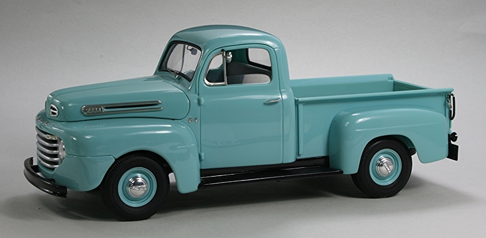

peekay Posted February 5, 2018 Posted February 5, 2018 Here's one I did a few years back. The kit plastic was unusually swirl-free and molded in a colour I liked so I went for it. I used 600 sandpaper to do the mold lines followed by sanding cloths - 4000 and 6000 - all wet. After that it was a lot of work with Novus 2 polish. (Today I would use Tamiya coarse polish before the Novus.) At one point I smeared plastic glue onto the body, which would have meant re-painting, had I painted it. But it came out fine with more of the above. Hosted on Fotki
Snake45 Posted February 5, 2018 Posted February 5, 2018 15 minutes ago, peekay said: Here's one I did a few years back. The kit plastic was unusually swirl-free and molded in a colour I liked so I went for it. I used 600 sandpaper to do the mold lines followed by sanding cloths - 4000 and 6000 - all wet. After that it was a lot of work with Novus 2 polish. (Today I would use Tamiya coarse polish before the Novus.) At one point I smeared plastic glue onto the body, which would have meant re-painting, had I painted it. But it came out fine with more of the above. Hosted on Fotki That's a fine, fine looking model, and I never would have guessed it's polished plastic--which is of course the real test. Get some Wright's Silver Cream and you can toss both the Tamiya Coarse AND the Novus #7.
Atmobil Posted February 5, 2018 Posted February 5, 2018 2 hours ago, peekay said: Here's one I did a few years back. The kit plastic was unusually swirl-free and molded in a colour I liked so I went for it. I used 600 sandpaper to do the mold lines followed by sanding cloths - 4000 and 6000 - all wet. After that it was a lot of work with Novus 2 polish. (Today I would use Tamiya coarse polish before the Novus.) At one point I smeared plastic glue onto the body, which would have meant re-painting, had I painted it. But it came out fine with more of the above. Hosted on Fotki That looks really great and many times better than the boxart model with its white wall tires and chromed bumper. Great job on polishing the plastic.
ChrisBcritter Posted February 5, 2018 Posted February 5, 2018 (edited) That looks excellent - and no worries about burying the details under the paint! Got a Monogram '40 Ford pickup I'm doing the same way. One thing I'll have to deal with is smoothing out the roof; the molded pleated headliner seems to have left some slight ridges on the outside. Edited February 5, 2018 by ChrisBcritter
