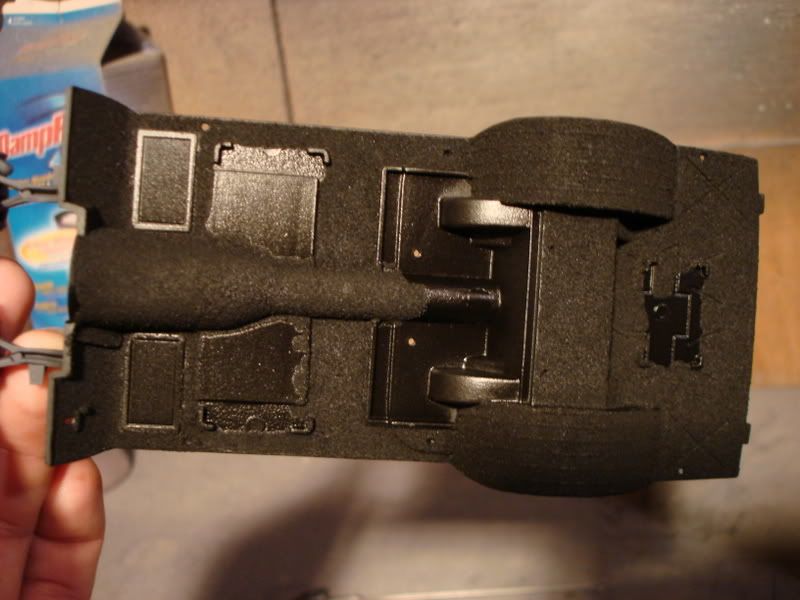

MrObsessive Posted July 11, 2008 Posted July 11, 2008 (edited) Here's a very mini tutorial I lifted from a post I did months ago when I was building my '59 Buick. Other folks may do it a bit different, but this is what works for me............ The floor needs some flocking..............I had no copper colored flocking, and it was really nasty and stormy here today, so no trip to the hobby shop! I figured if all else fails.........go with black! I like to paint my sections one square or so at a time......this will ensure that everything comes out even and not mottled looking. After I paint the section, I very gently pat down the flocking and then blow off the excess. I recommend if your sensitive to flocking dust.................wear a respirator! This is what I use to "sift" the flocking.......a simple kitchen strainer! Costs about $1.50 in the store. I recommend you find one that has a tight mesh................otherwise the flocking will come out in clumps and add to your frustration! Okay, she looks all nice and even.............maybe a touch up here and there, but the front seat will cover up most of the floor. This'll be set aside for a spell to dry thoroughly. Lately, some guys have been using "Embossing Powder" which come in all sorts of colors, and can be found at an Arts and Crafts store. You can apply it the same way as above, but some folks have used Elmer's glue instead of paint. HTH! Edited July 11, 2008 by MrObsessive
JamesW Posted July 11, 2008 Author Posted July 11, 2008 Thanks for ALL the tips. I thought that was the way to do it. Still tinkering with detailing. (Never done a FULL detail model, and because my Hearse cost me so much, I want it to be flawless) Thans again.
