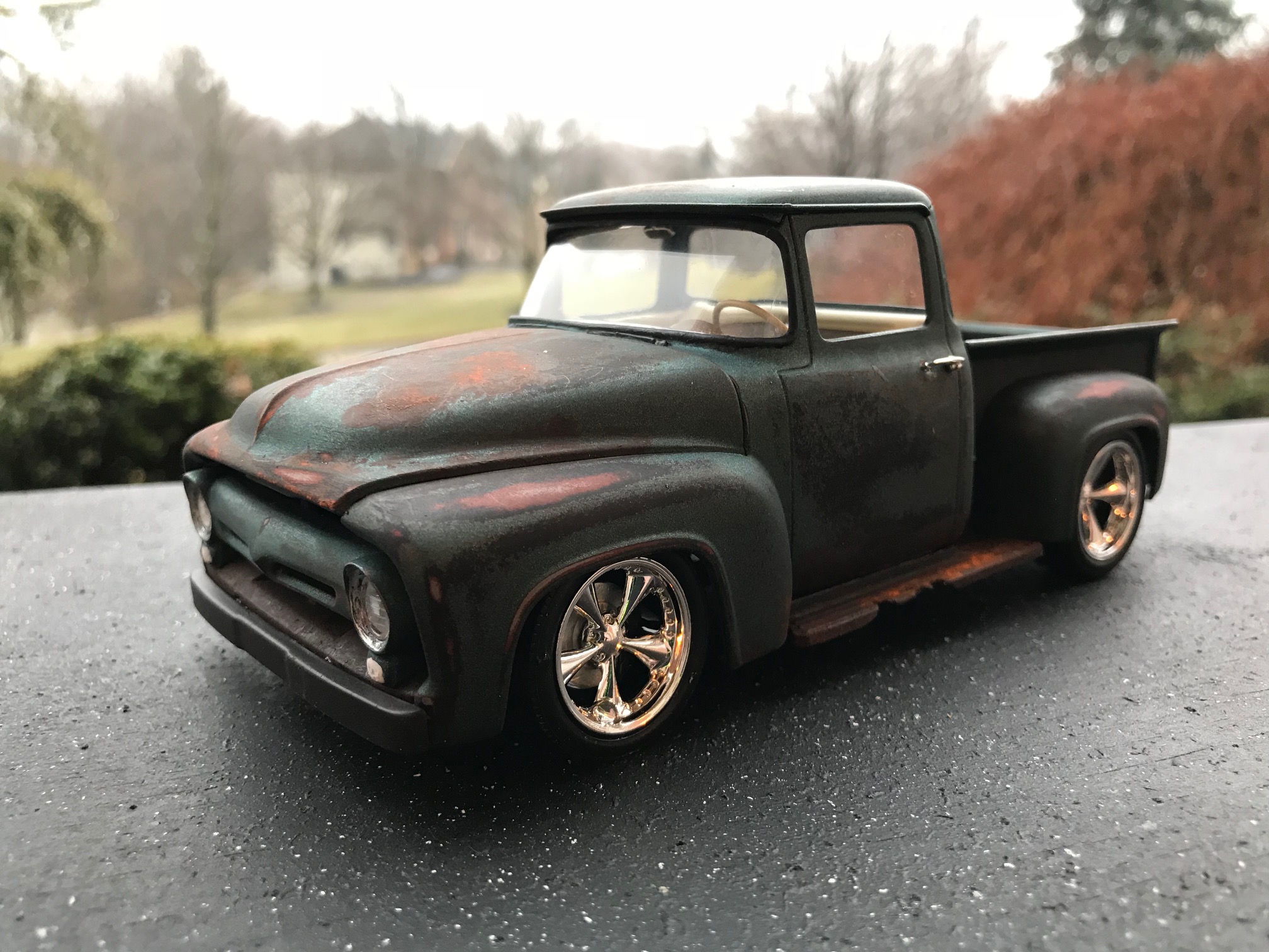

This year I got the bug to build this Foose FD-100 Ford pickup.

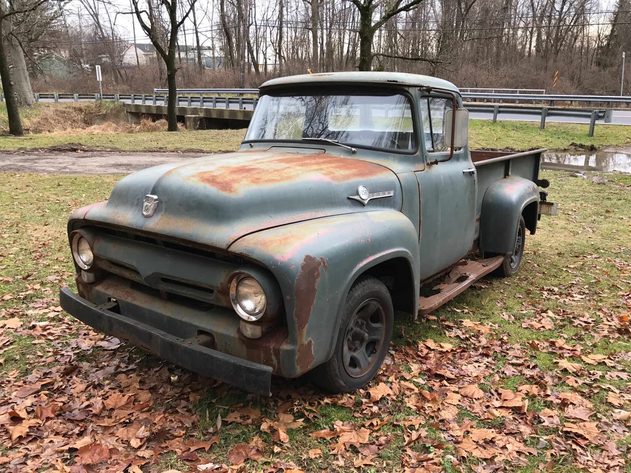

This truck sits a few blocks from my house and the voices in my head agreed to build this with the Foose kit.  Falling back on my weathered sweet spot!

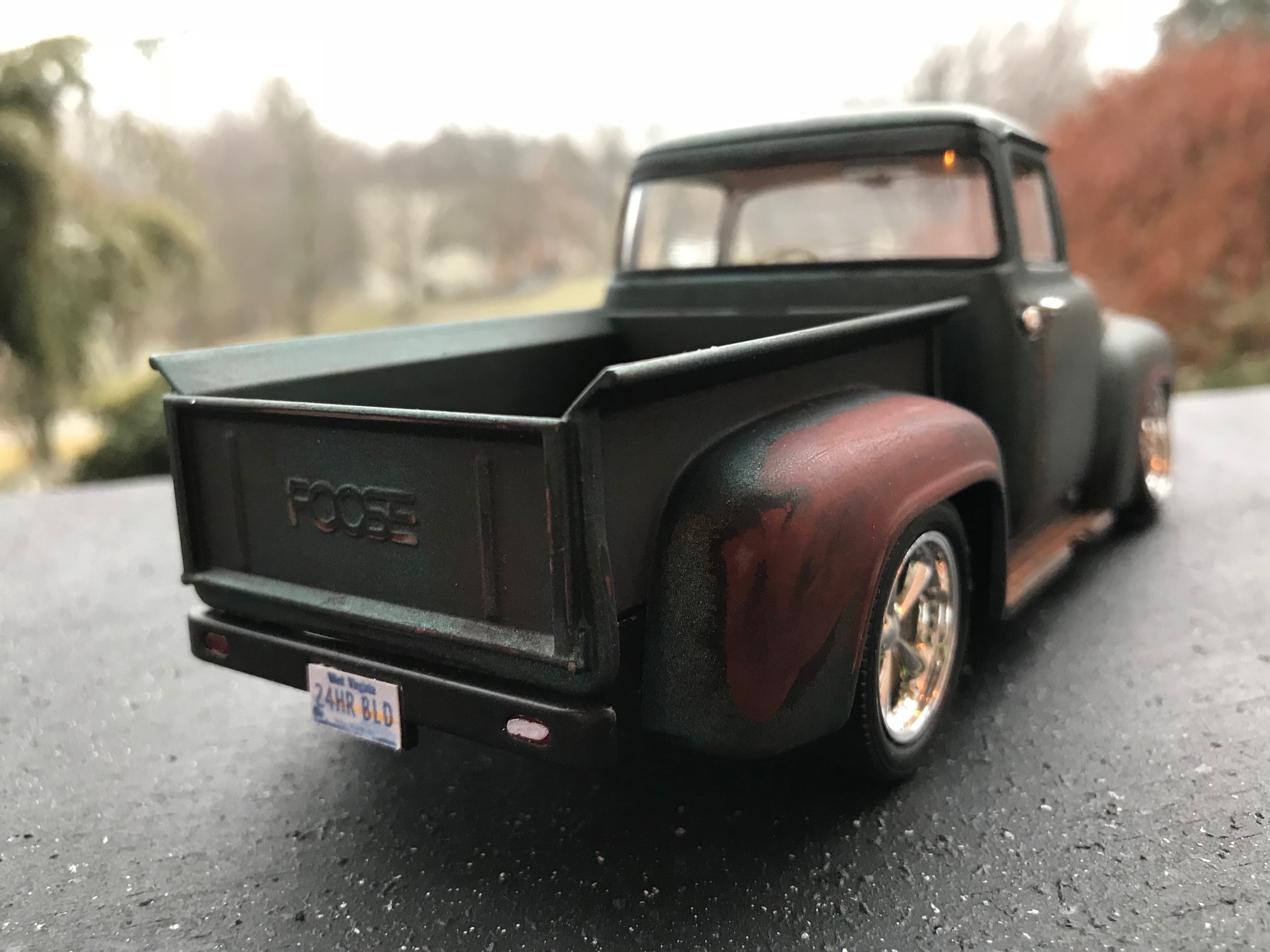

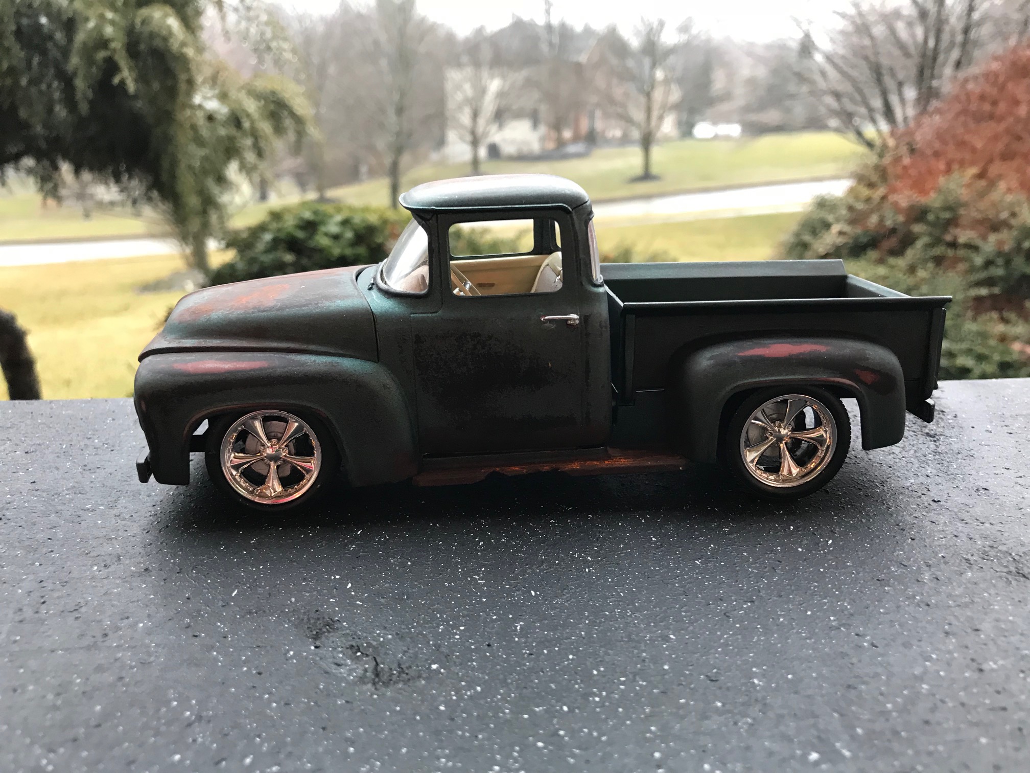

And this is where we ended up at 11:45 on Sunday morning!  It was a great time, that went very quickly.  I took a break for nourishment and communications every few hours.  That kept me going.
The idea was to build the modern Foose rod with the patina of the 1:1 truck.  One of the things that cost me a lot of time is that there are five colors of paint stacked up. The body started in primer gray, followed by primer red, flat black and several coats of two greens.   With an hour or two between colors.  That's needed so when I wet sand in a circular motion, the colors emerge.  I was wet sanding in the middle of the night!

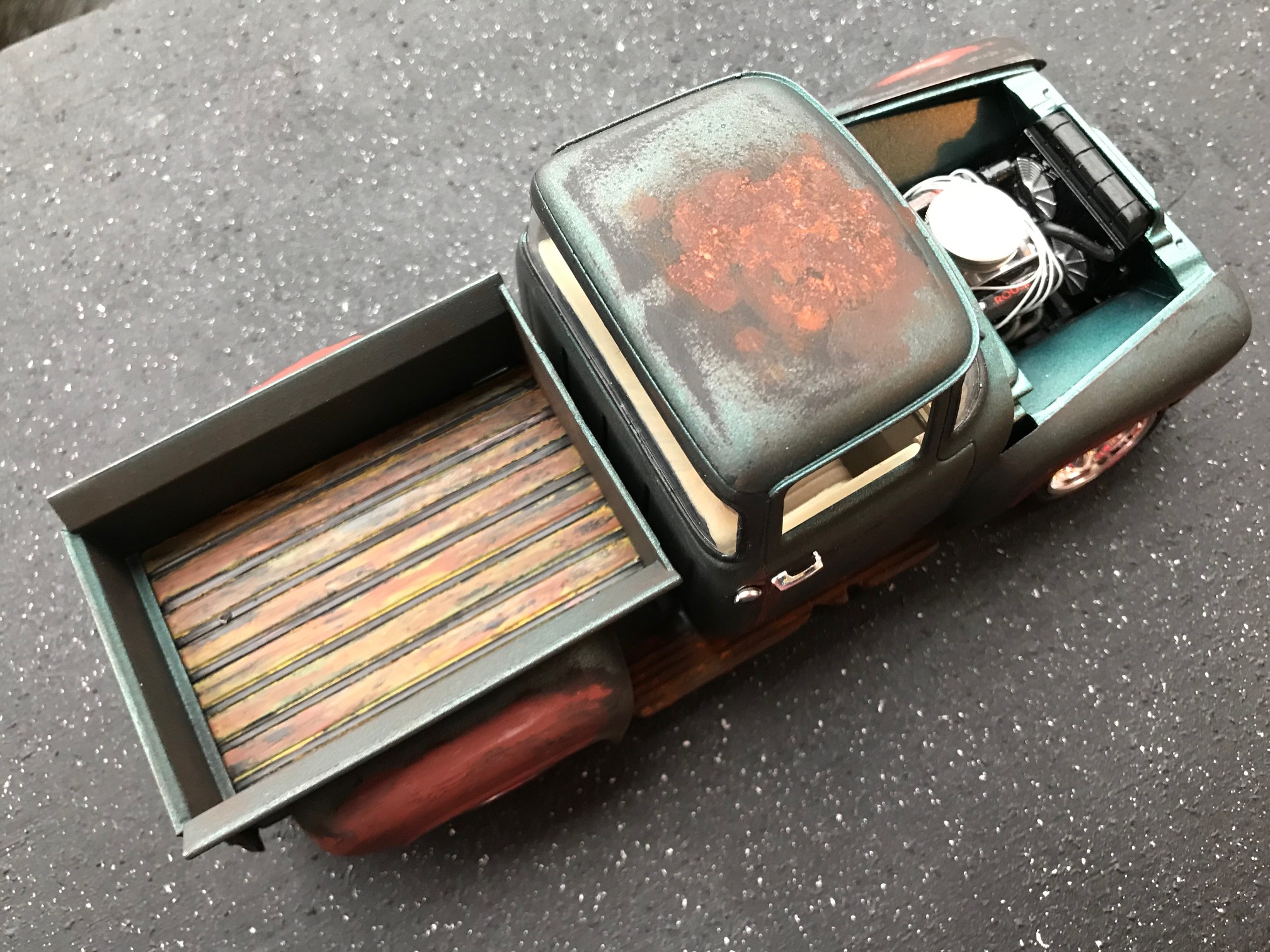

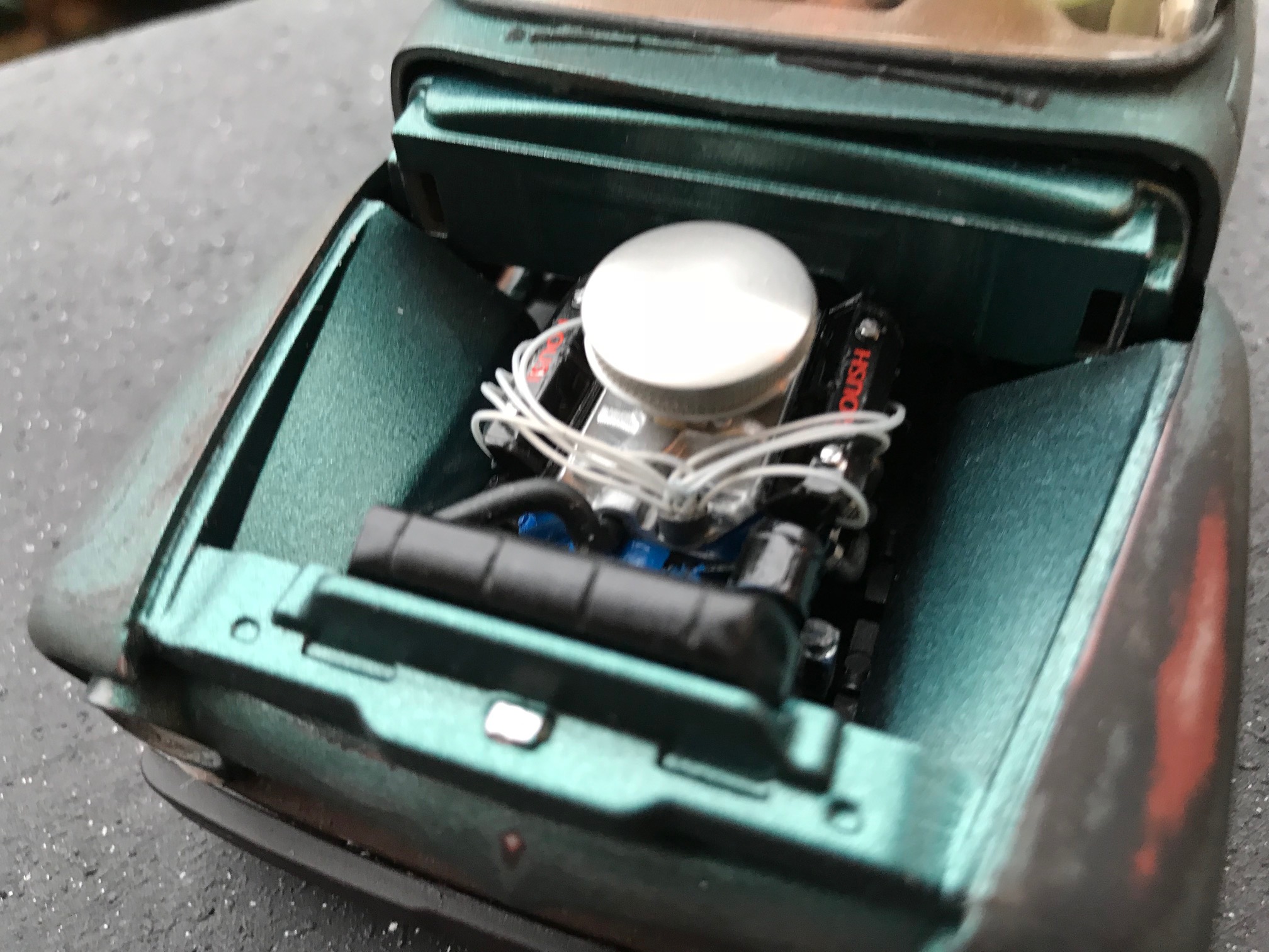

The Foose kit's engine was built along with a bit of wiring and an aluminum air cleaner I had for years.

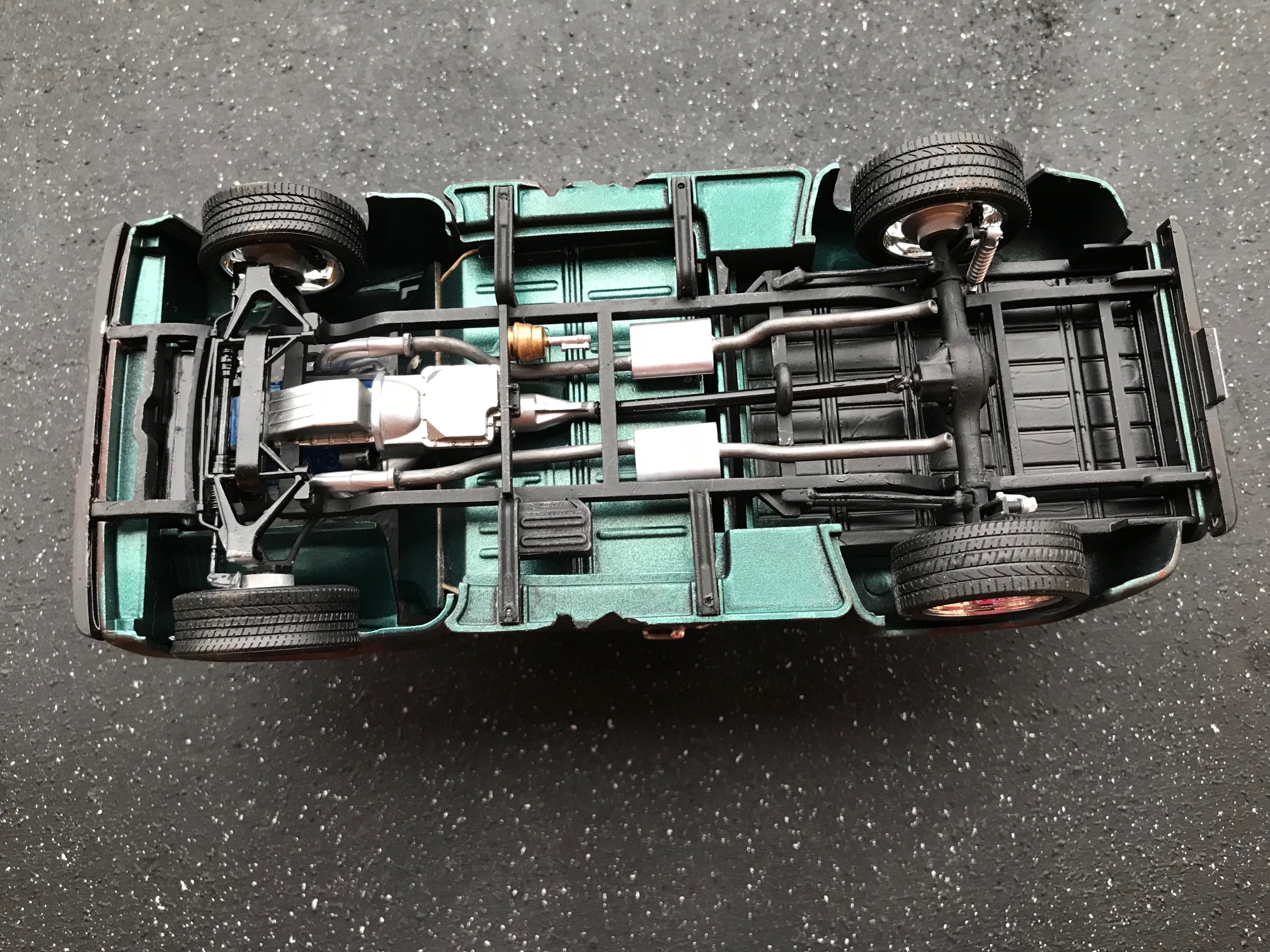

The underside is again a modern Foose car.

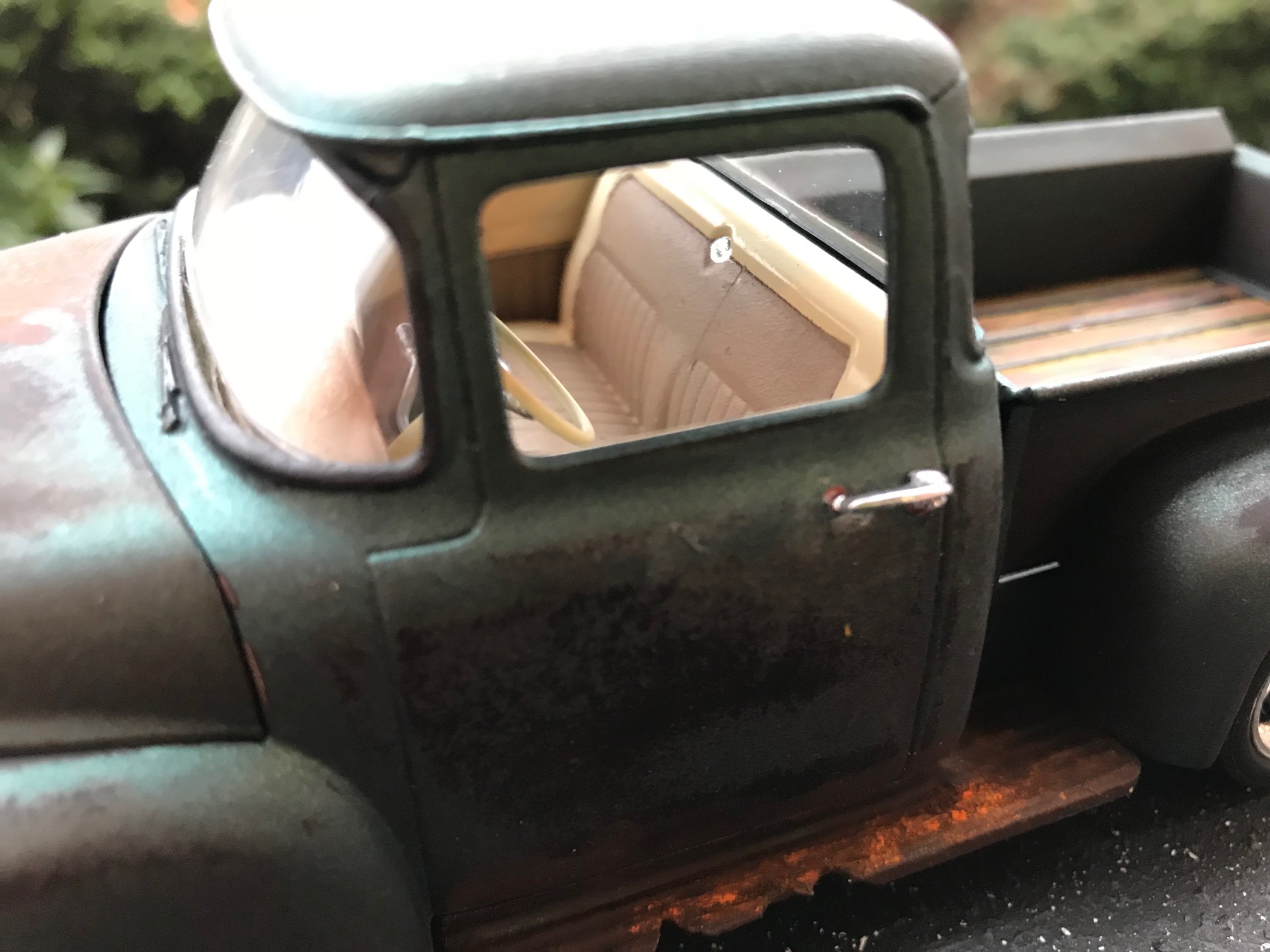

The interior was right from the kit, but two toned in my own colors. I did create a headliner since there wasn't one.  The kit itself was pretty well engineered. The glass literally snapped in place.
Around 9am I decided to mask off the bed strips and paint wood grain!  As beat as the 1:1 truck looks, it had new wood in the bed.

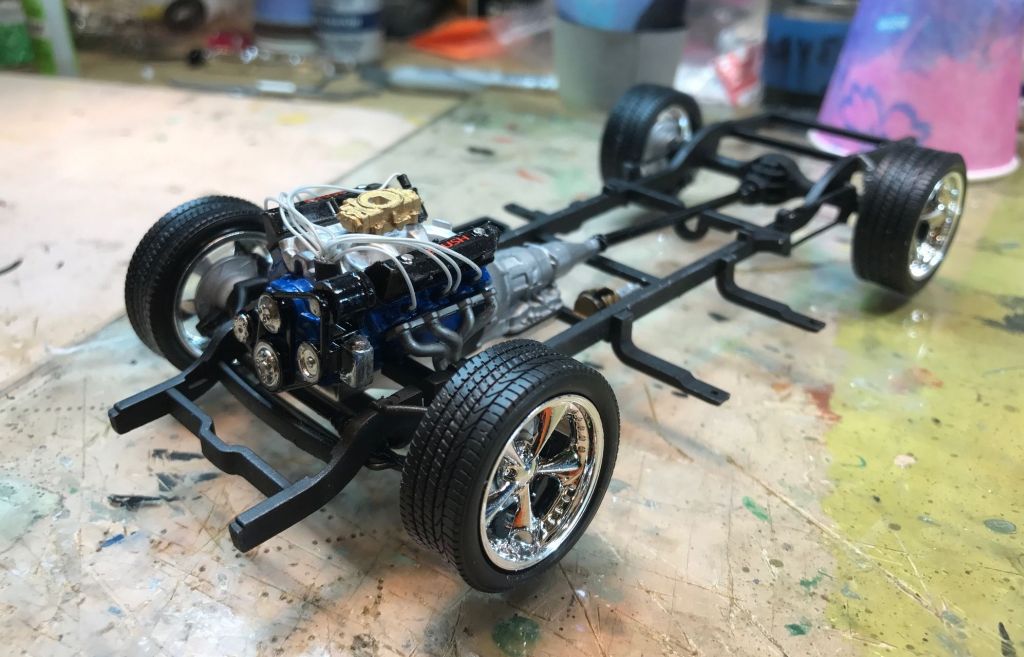

Here's a 2am progress shot.  I had the chassis up on wheels and drivetrain installed!  The kit did have one flawed wheel and one misformed tire. One of my recommendations to other builders in this event is to have a second copy of the kit.  I didn't this year!

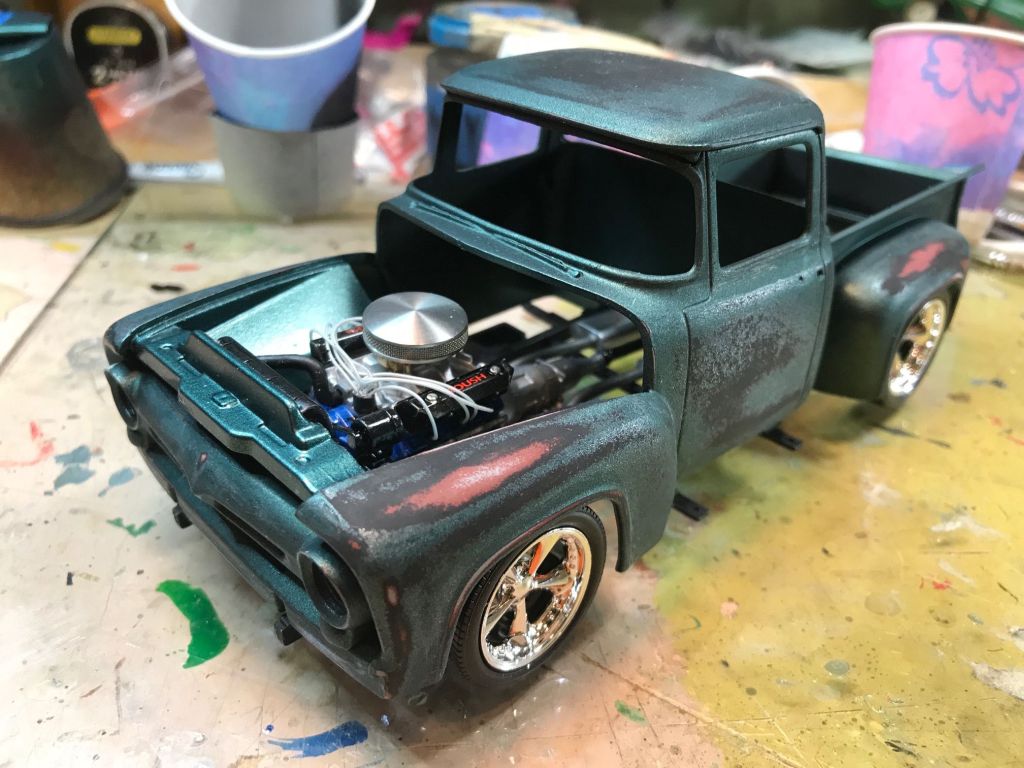

And a fit test at 6am. Note that this is right as the wet sanding dried, and the rust hadn't started yet!
