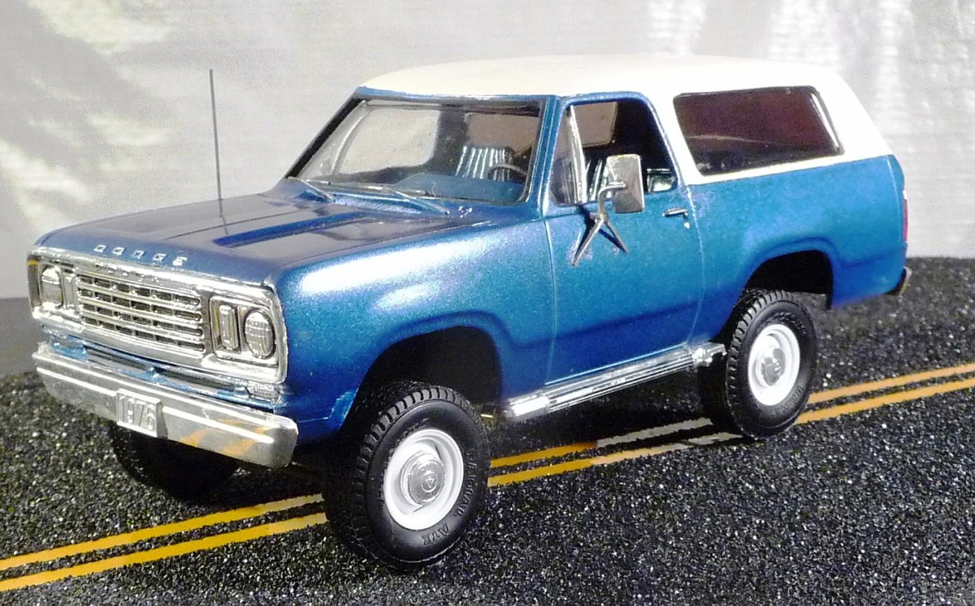

om617 Posted August 31, 2018 Posted August 31, 2018 Made my own based upon the Revell. Better than no Ramcharger.

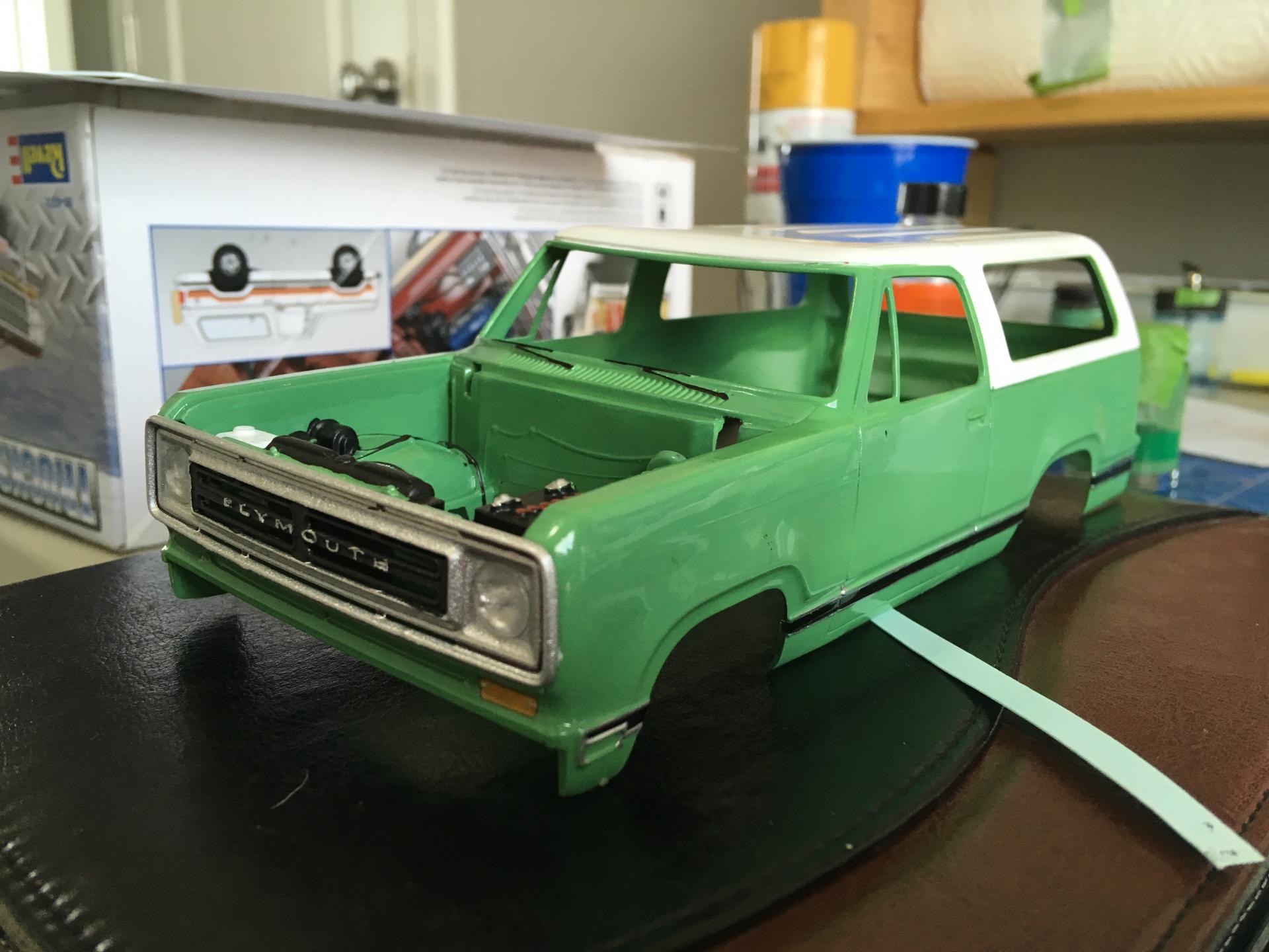

Oldmopars Posted September 10, 2018 Author Posted September 10, 2018 Well, I am making progress on this one. Here is the truck with the Plymouth grill in it. I would have to say, don't bother with the headlights. The Shapeways Frosted Ultra Detail is way to frosted to male good headlights. I tried to polish them, hit them with Future, clear, etc. Nothing worked. I just used some from another kit I had. The hood is not pictured here but it is done. I had to use a lot of filler to get the printed lines to not show through the paint. I also added under structure to it to keep it from a reversed curve. All in all I am thrilled with the parts and will buy them again. Rico does fantastic work. I am only pointing these things out so that anyone buying them does not expect that they are like kit parts. They are not injection molded, but printed in layers and this does cause problems. As of right now, you can not print "optically clear" parts, or print without layers. It in the nature of the beast.

camaro69 Posted September 11, 2018 Posted September 11, 2018 @ Scott: Thank you very much for these informations. Maybe you could tell us which headlight lenses you used. In case of the hood your prototype was without the underhood structure. That´s why I really appreciate your positive feedback. After your first message I added the underhood structure so it should be better now. BTW your grille looks fantastic. I really like how it turned out. Is it already glued in? If yes which glue did you use? @Dan: Thank you too. I´m really happy if you are satisfied with my parts. Best regards, Rico
Oldmopars Posted September 11, 2018 Author Posted September 11, 2018 8 hours ago, camaro69 said: @ Scott: Thank you very much for these informations. Maybe you could tell us which headlight lenses you used. In case of the hood your prototype was without the underhood structure. That´s why I really appreciate your positive feedback. After your first message I added the underhood structure so it should be better now. BTW your grille looks fantastic. I really like how it turned out. Is it already glued in? If yes which glue did you use? @Dan: Thank you too. I´m really happy if you are satisfied with my parts. Best regards, Rico I have not glued in the grill yet, I still have a lot of details to do on the rest of the truck first, it was just sitting in there. As for the headlights, they were left overs from a Italari kit, either a Scania 143 or a Iveco Stralis. They were in my parts box. They were clear with no detail on them, so I carefully scratched them one way then turned 90 degrees on some rough sand paper to give them some cross hatch fluting. However it did not show up well because I used some clear Elmers glue and the details went away. I also used Molotow Chrome behind them. The next one I do, I may use BMF on the grill to give it a more Aluminum look. I painted this one and it looks good, but could be better with BMF, it will just be hard with all the details.
