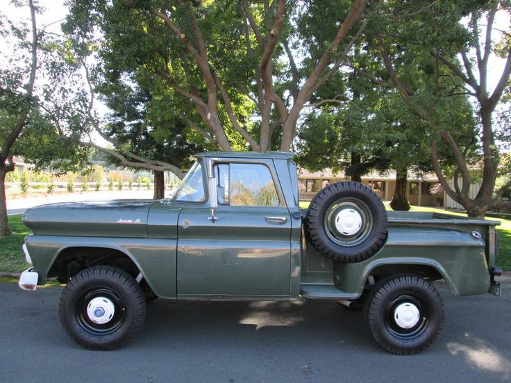

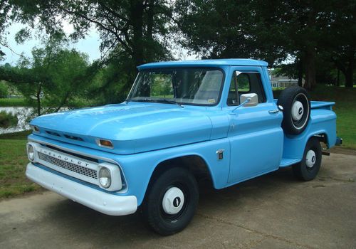

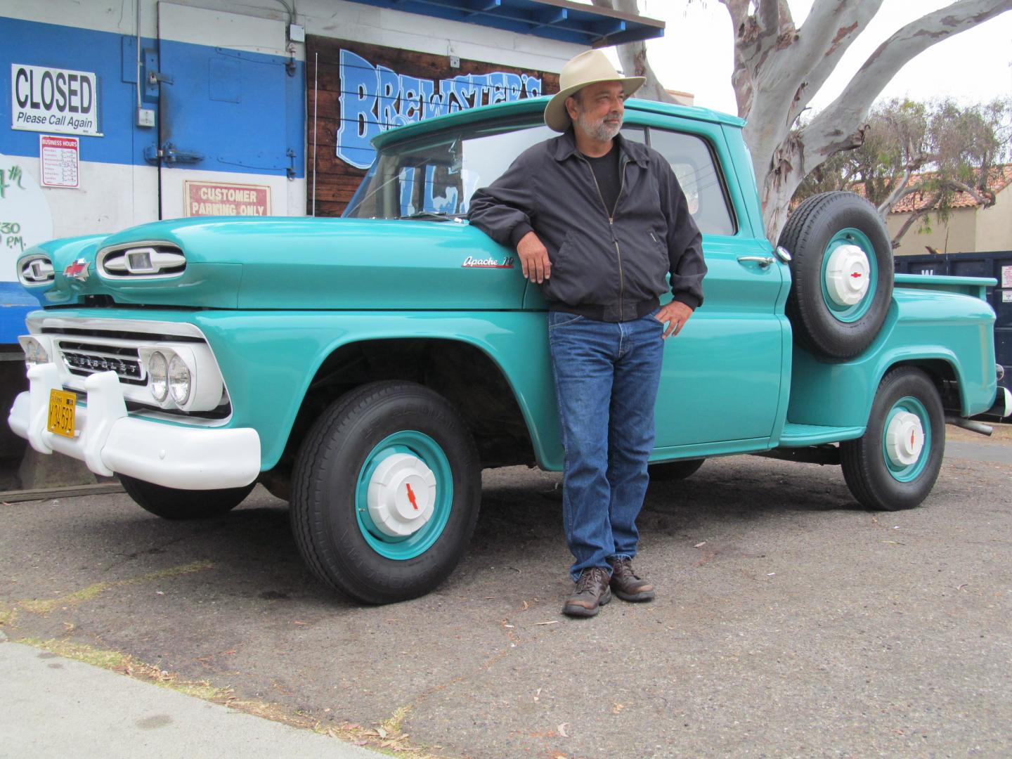

Casey Posted February 11, 2018 Posted February 11, 2018 I wasn't able to find anything on the web regarding any specific differences between the '55-'59 and '60-'66 Chevy/GMC Fender Side beds, but are they the same basic beds? How about the rear bumper on both year ranges? I'm guessing bumpers were optional, and chrome plated bumpers would only be available on Custom level trucks (I did look at the 6066gmcguy 'site http://6066gmcguy.com/gmcid1.html )? The attached mage of the red/white truck shows what appears to be a chrome plated bumper from a '55-'59 (same as what would be found in the AMT Fender Side '55 k, I think), but is that "correct" for a '60-'66? Also, was the fender mounted spare tire an option for Fender Side trucks? I don't think I've ever seen the specific fender for that option offered as an aftermarket resin part, but if the AMT '55 Fender Side bed is a near direct swap onto the AMT '60...
mikemodeler Posted February 11, 2018 Posted February 11, 2018 (edited) According to LMC, they are the same fenders for the stepside bed from 55 (second design) to 66. There was a different fender for the exterior spare option. Rear bumpers are different for 55-59 vs. 60-66. Edited February 11, 2018 by mikemodeler
