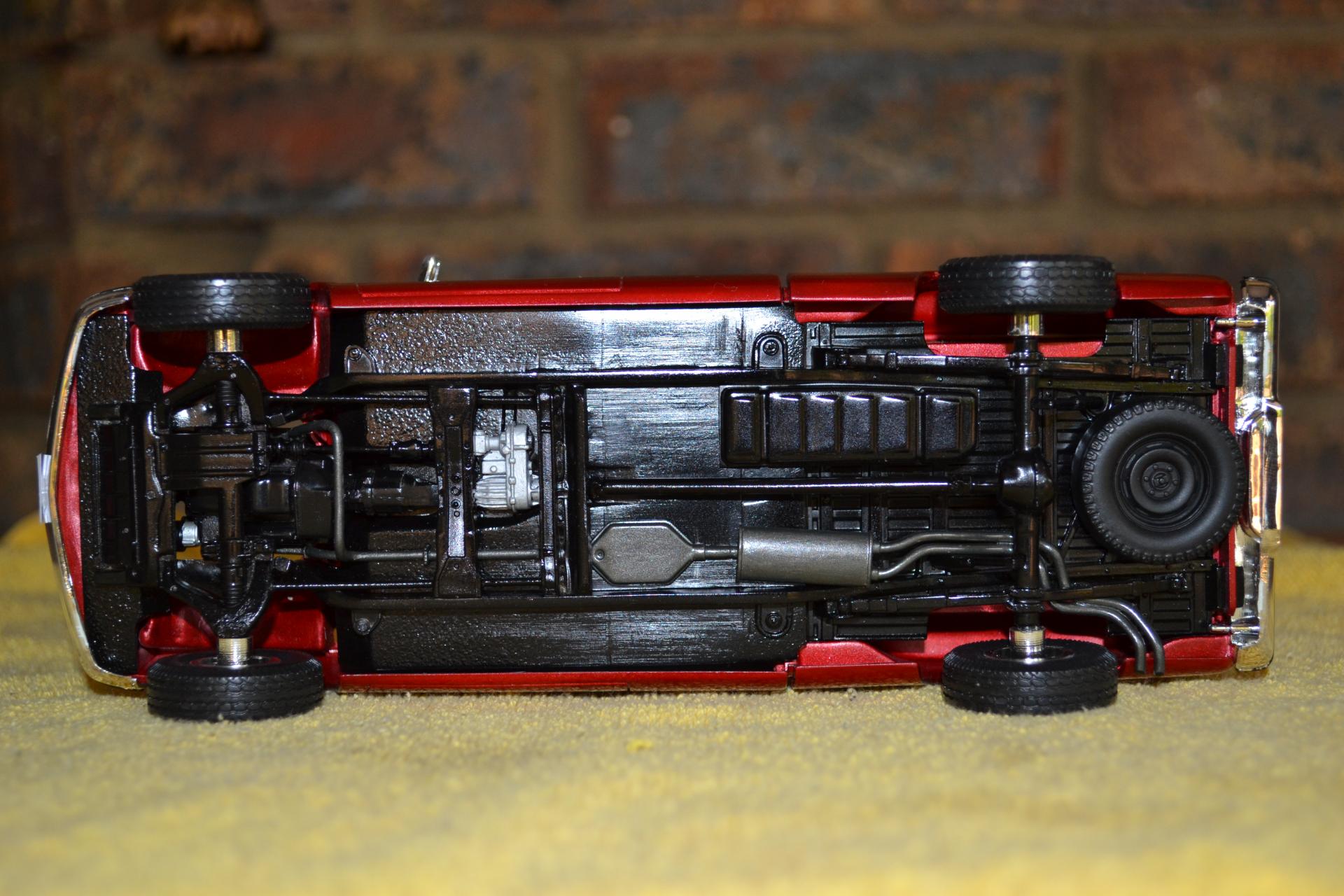

ChrisR Posted February 13, 2018 Posted February 13, 2018 Perry's Resin used to have a 4x4 conversion based on the Tahoe. Here are photos of my 4x4 with the Tahoe wheels as well.

ChrisR Posted February 15, 2018 Posted February 15, 2018 5 hours ago, milo1303s said: What came with the conversion the whole floor plate? There are no pics of what you get on Perrys resin site not thats it expensive for 6 bucks but still wanna know what I'm ordering . Thanks everyone for the replies It was the complete front suspension, torsion bars, cross member and transfer case. As Anton mention above sadly Perry's Resin is no longer in business. If you could get hold of a Tahoe chassis you cut out the parts required.
