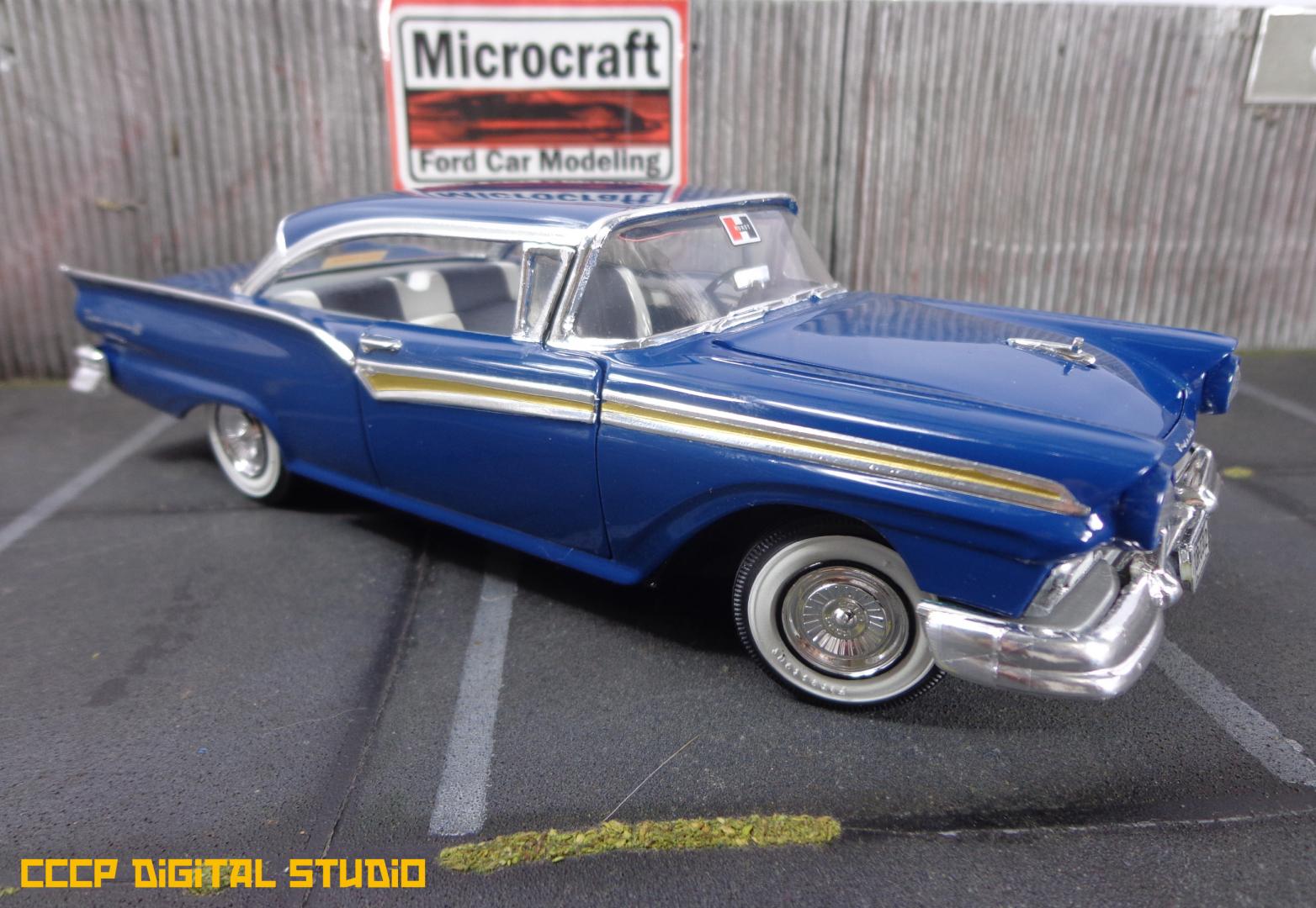

Lovefordgalaxie Posted February 12, 2018 Posted February 12, 2018 Tamiya TS-15 Blue over the kit's blue plastic.
