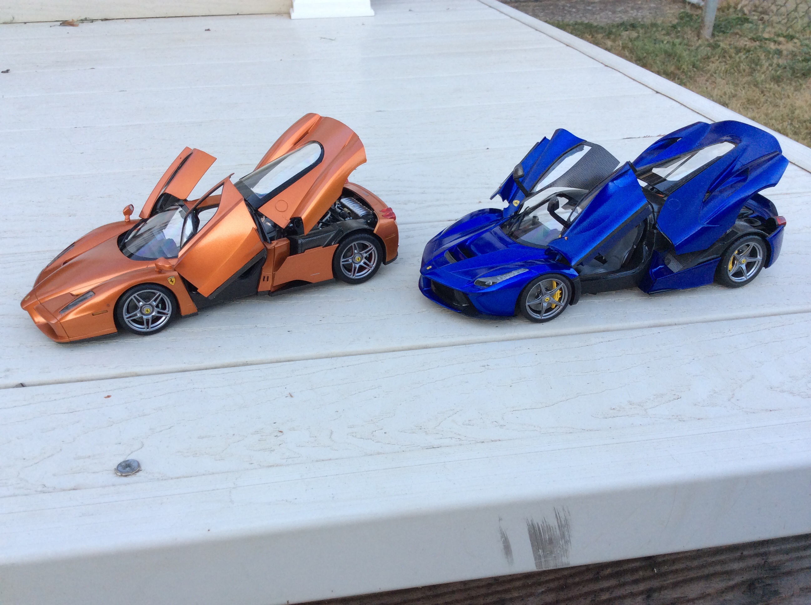

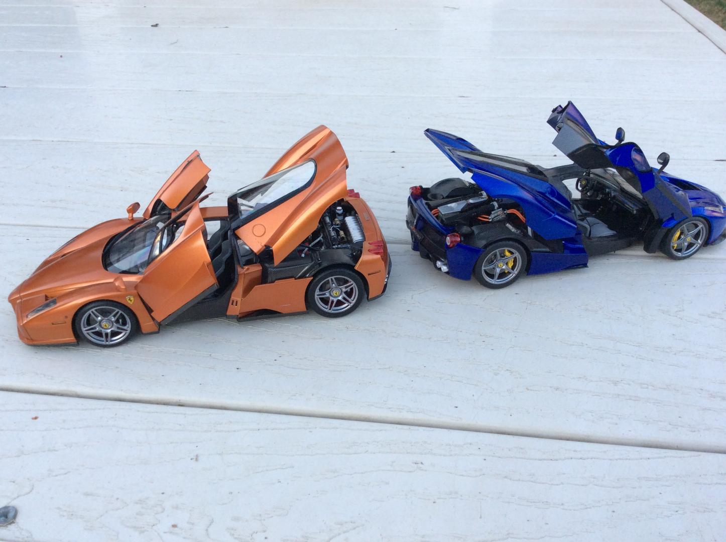

Gt fan Posted February 15, 2018 Posted February 15, 2018 I use Tamiya silver leaf for a base coat. It is thinner than the primer. The blur Ferrari has two coast of silver base coat with three coats of blue. The orange ferrari has a gold base coat with metallic orange on top. Painted the same way. The clear is MR Hobby super clear
Monty Posted February 16, 2018 Posted February 16, 2018 6 hours ago, Jim N said: Couple of real cool Ferraris Tim. I agree. Both look great, Tim. Would you mind telling me which exact blue paint (mfr & p/n etc) you used?
Gt fan Posted February 17, 2018 Posted February 17, 2018 I use Tamiya paint all the time. The blue can is painted as followed Tamiya silver leaf 2 coats this is the base coat and the primer . The kit is molded in red. The silver is thin and lays down very well. The Tamiya number is TS-30. The blue is Tamiya racing blue. I sprayed this in 3 coats. Every coat was left to dry 1hour or over night. The second coat of blue was left to dry over night. The Tamiya number is TS-51 Car was then cleared with Testors wet look clear. Two coats of this. I hope this helps. I more info is needed just let me know. cheers

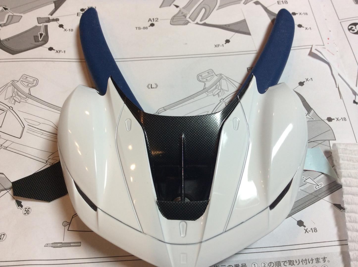

Gt fan Posted February 17, 2018 Posted February 17, 2018 This is Tamiya bright white over a silver leaf base coat
