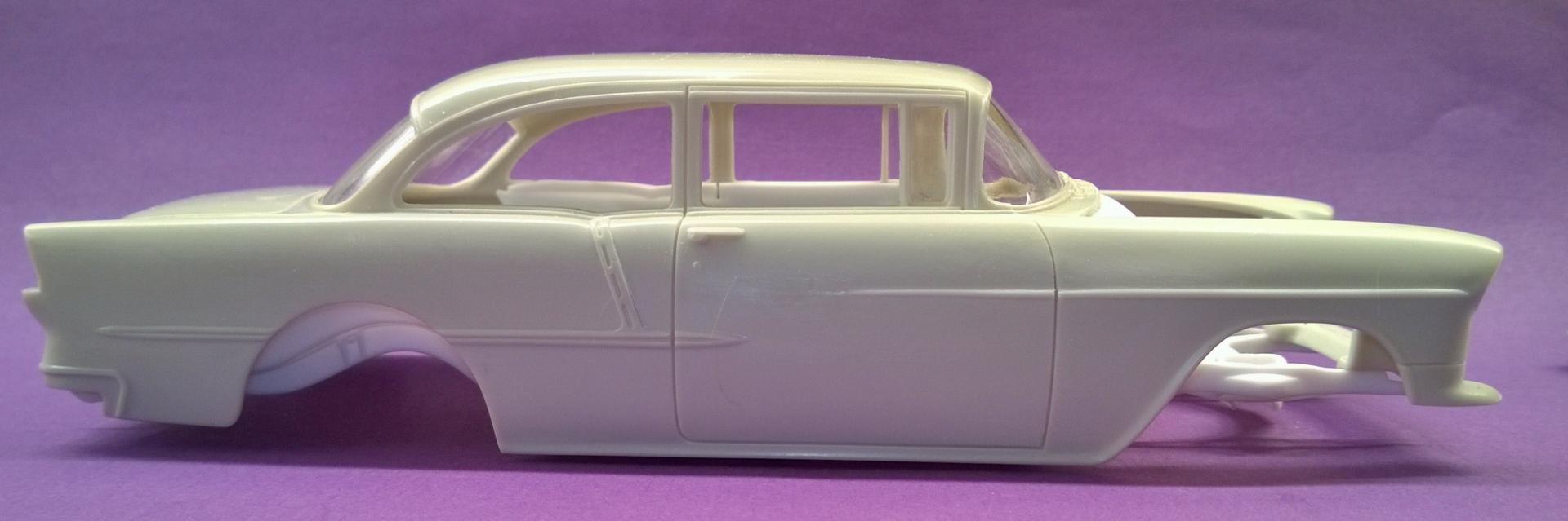

I acquired a modern era 1/25 Revell '55 Chevy Bel Air Hardtop to build the red car in foreground, but decided to use an AMT '55 Bel Air Sedan to build the yellow car. When you can only see 30% of the car, who's to say it's not a Sedan? :P I didn't really want to build two of the same kit, and I prefer the Sedan body, so it was an easy decision to start with the yellow car as a Sedan.
The AMT Bel Air Sedan has some issues right out of the box, namely the hood is a bit too narrow:
Not ideal, but easily corrected by adding some stryene strips to the edges, then sanding everything to the proper contour. The right fender edge (where it meets the hood) isn't straight on the body, either, so a bit of work with a square file helped clean that up a bit. I should've used thicker strips at the hood edges, as the fender-to-hood gap is much improved, but could be better:

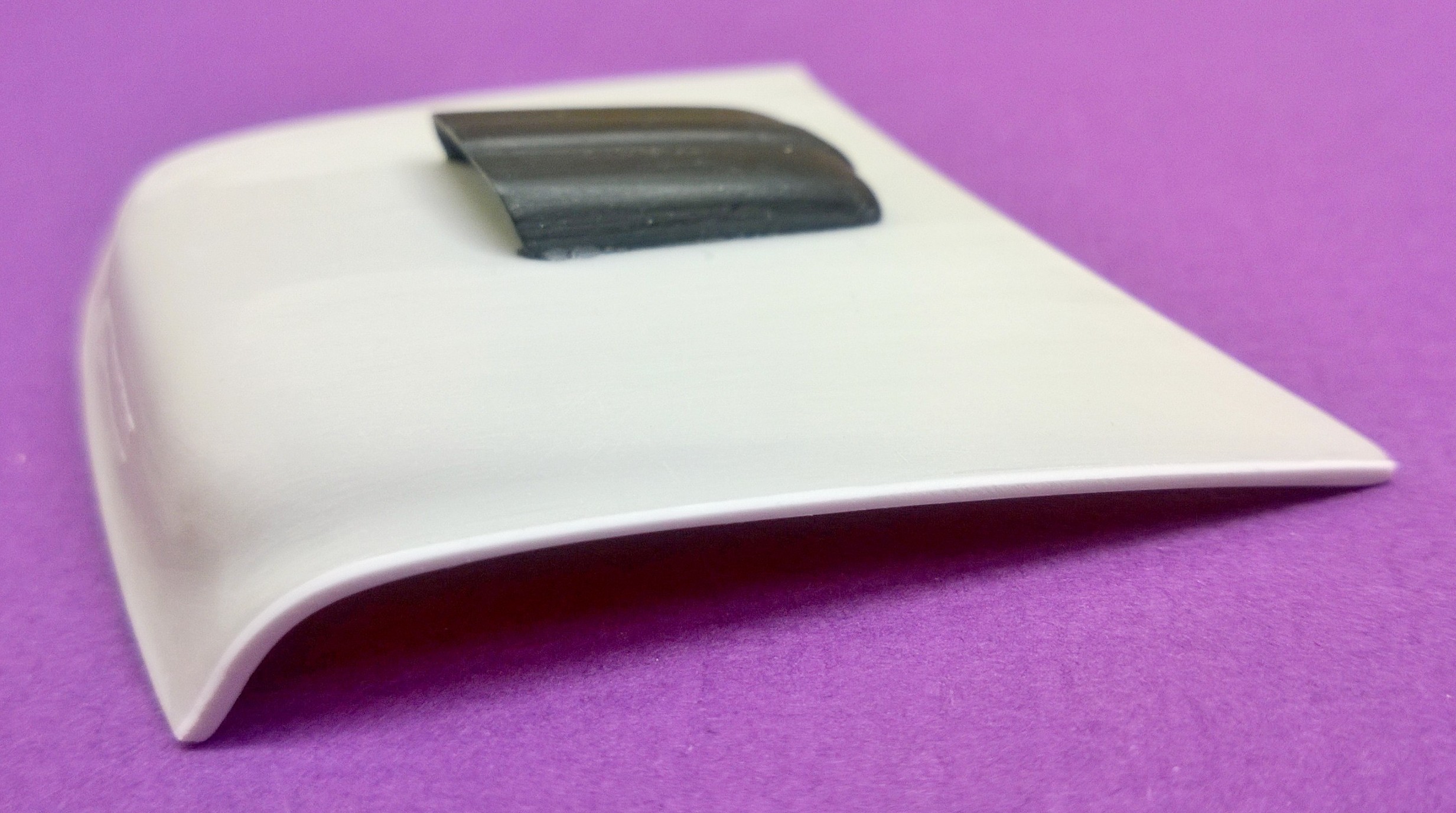

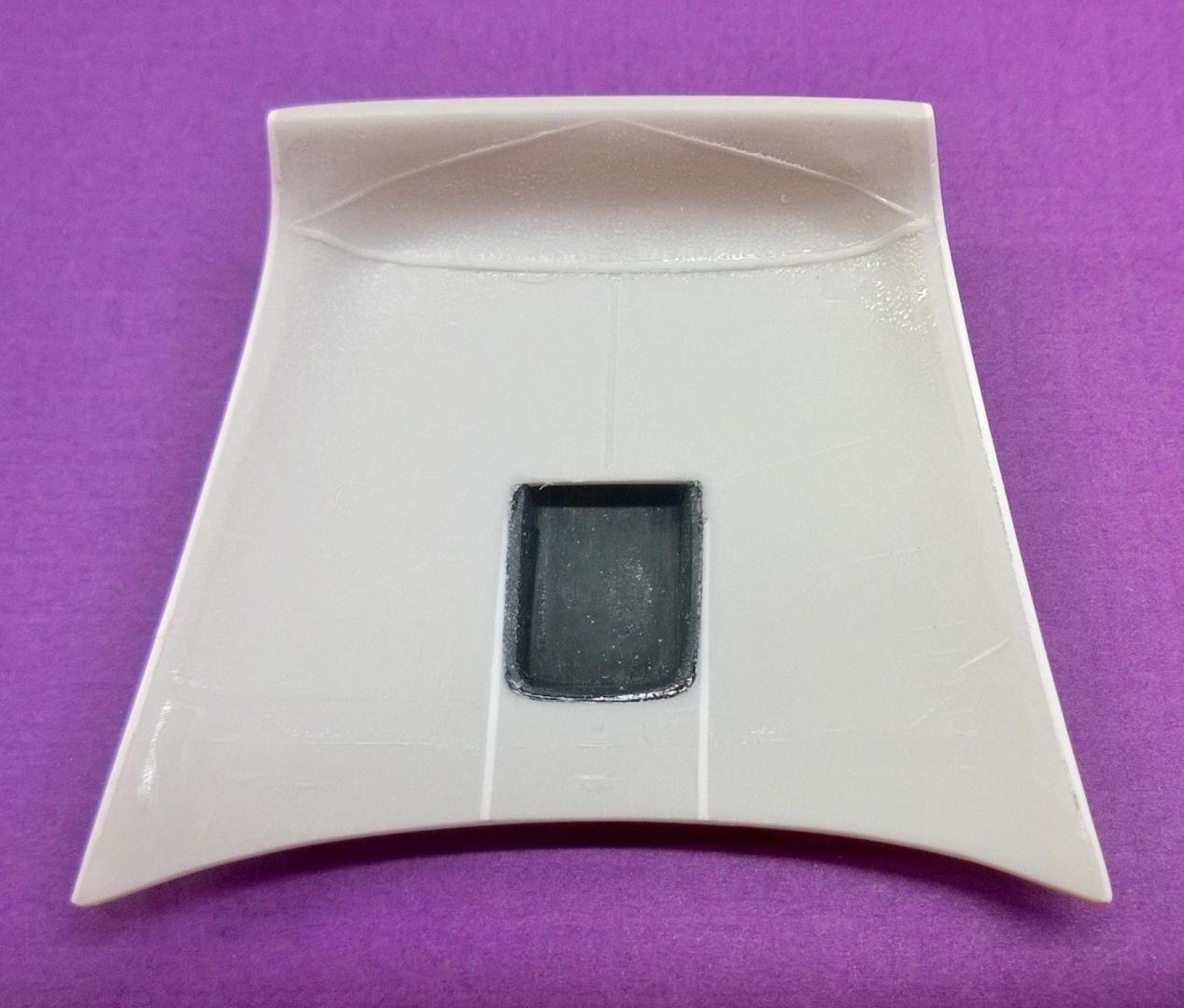

While I was working on the hood, I knew I wanted to add a small, semi-unique hood scoop, since the yellow box art model wears one. After digging out the vintage scoops in my parts box, I found one I liked, which turned out to be from the Monogram '39 Chevy coupe kit (thanks to Bob Taber for identifying it). The scoop has a small flange at the bottom, which made marking the hood, cutting the hole, and cementing the scoop into place much easier:

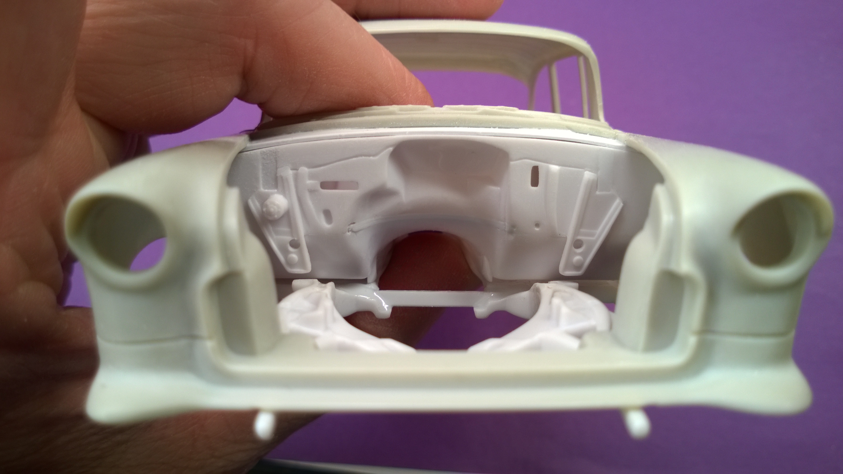

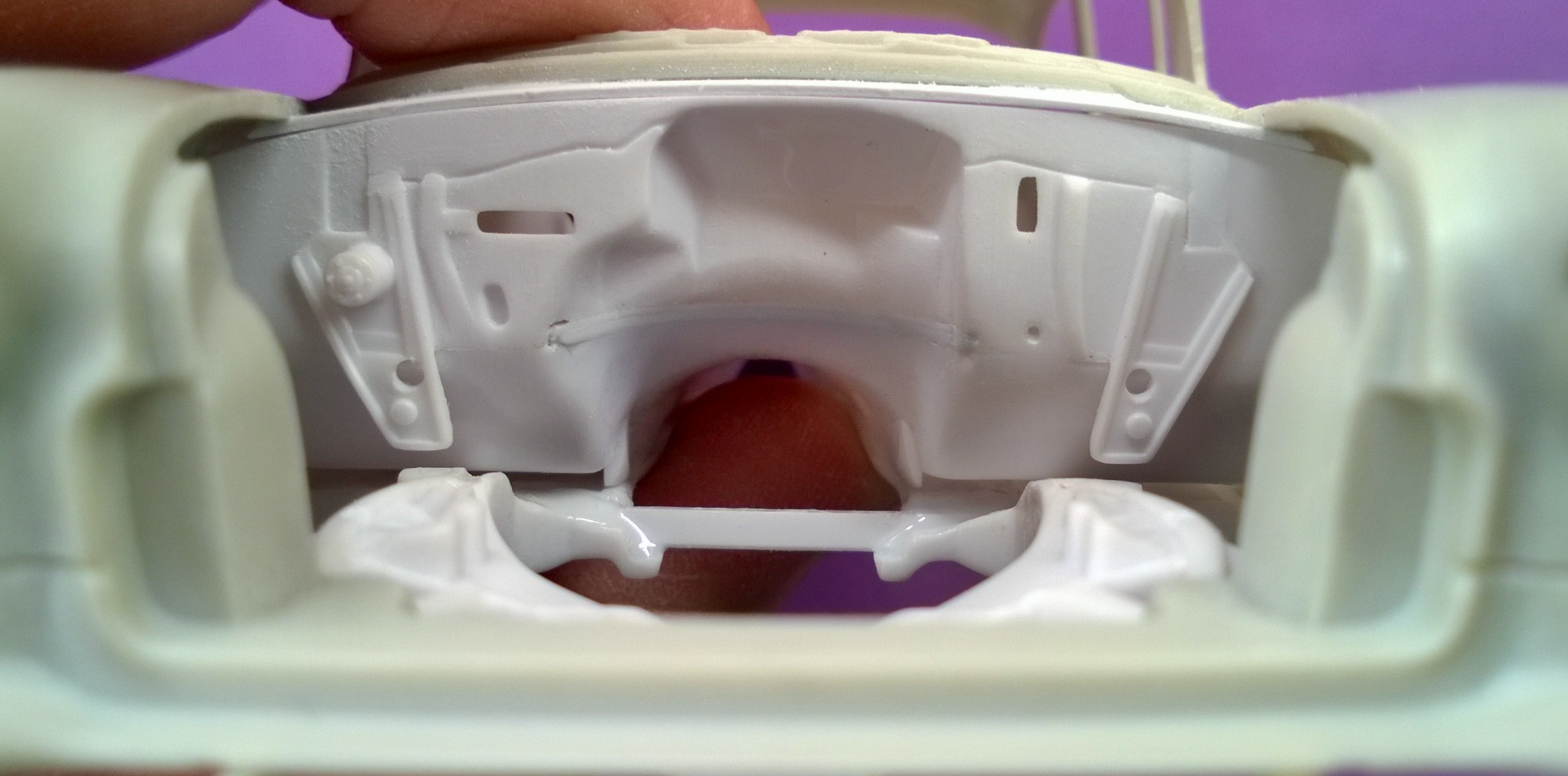

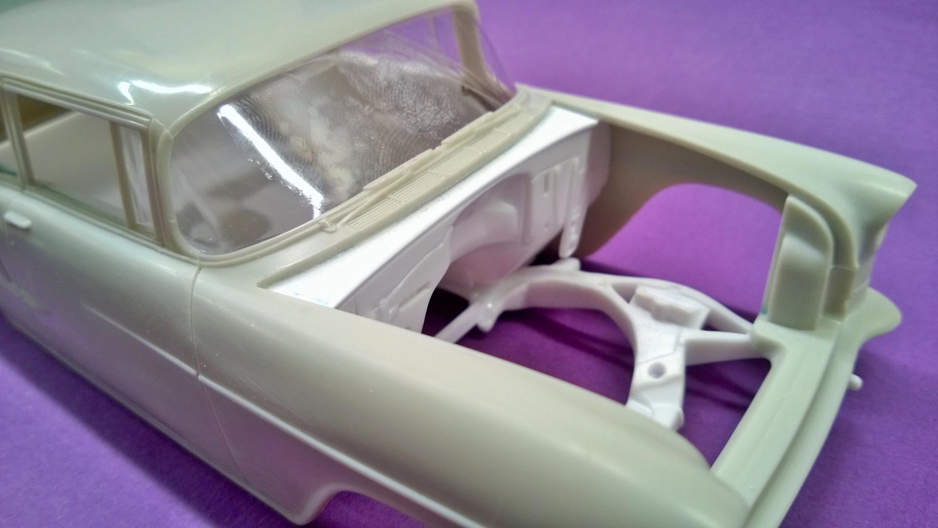

The underhood area of the AMT Sedan is not great, and really look like hot garbage compare to the more modern Revell kit, so it was determined the owner of the yellow car decided to remove the inner fenders, so I did what I had to do in the name of accuracy. ^_^  I figure these two cars are still streetable, but trending towards strictly strip use, so a short trip from garage to strip would be tolerable with no inner fenders. Plus, it saved me some work, and I could put that effort toward improving the firewall and radiator support areas. The firewall was fully removed, and a Revell firewall (the '57 kit includes both '55 and '57 firewalls) piece substituted. I'm using the '57 Utility Sedan's interior floor as it's very basic and has no rear seat, again saving me some work. I'll cover the interior work in a later post, but for now, the firewall was cemented to the interior floor piece, reshaped in some areas and filler pieces added in others to get a solid rough shape with no gaps. Still lots of work to do on the firewall and engine compartment, but nothing too complicated. The below shows the progress so far, and also tips off my engine choice (thanks to Paul Gardner for supplying the 409), but more on that later:

Thanks, I have had it for many years, and when you find a part that just looks "right", you keep it for that some day project. :) I'm actually planning to use the Super Duty 421 Pontiac V8 from the AMT '62 Catalina in the red car, so both cars should have similar power-to-weight ratios, end up in the same Gas class, and run head to head.

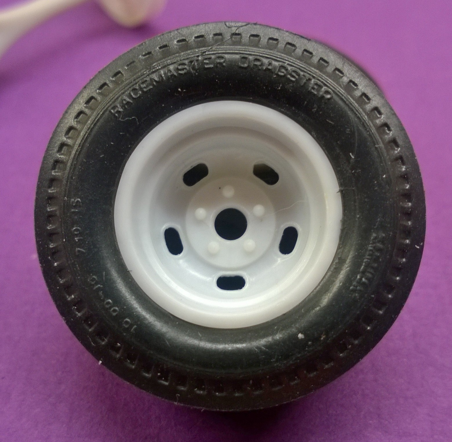

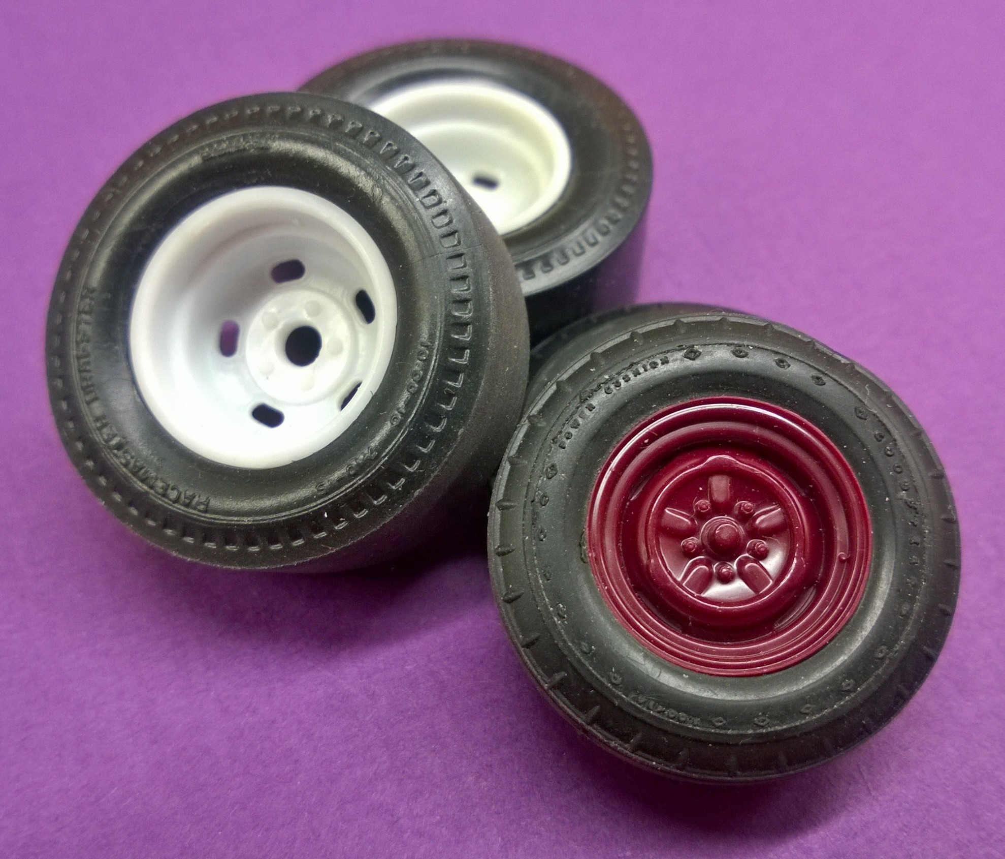

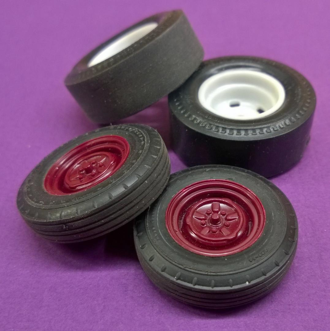

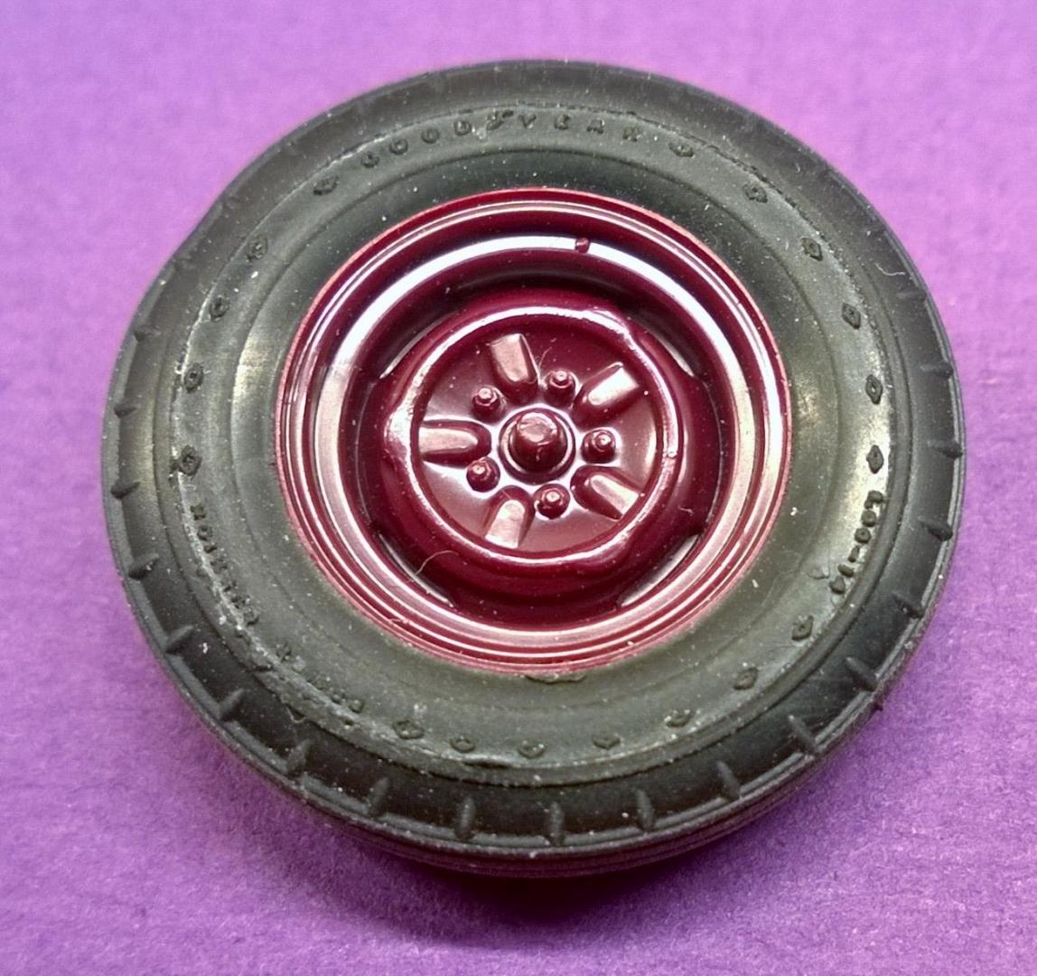

Wheels and tires: M&H Racemaster pie crust slicks from the Revell Tony Nancy Roadster/Dragster double kit and the 5-window Halibrand wheels from the Roadster. Front wheels are the front wheels from the Revell '64 Ford T-bolt with parts box tires (not sure on the source, possibly Lindberg '64 Belvedere?):

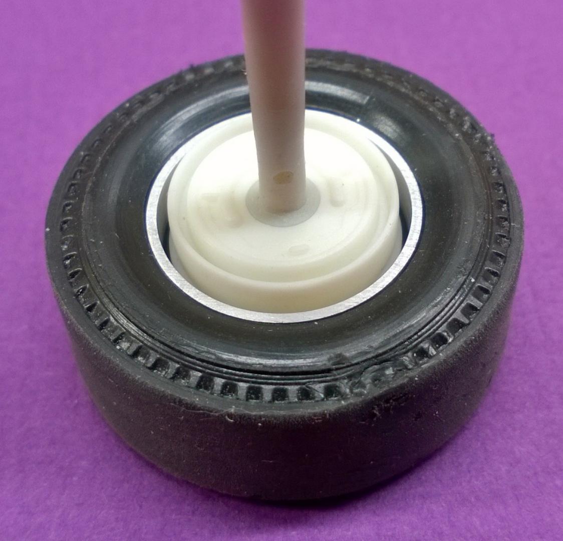

The rear halves of the rear wheels needed to be thin enough to allow the brake drums to clear, so I ended up turning a pair of rings on the lathe to get enough clearance:
I turned the O.D. (wheel lip) of the wheel backs/drum brake backing plate pieces down on the lathe, but the drum's wall is still a bit too thick and the gap between the drum's I.D. and the backing plate's O.D. is still too large. I'll have to live with it. -_-

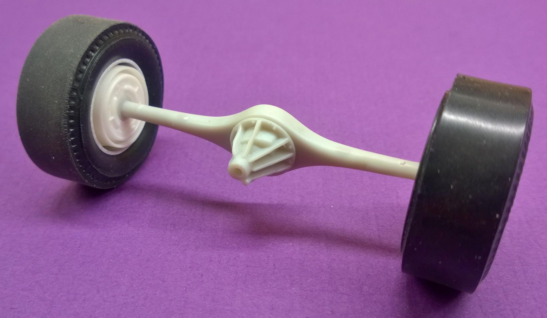

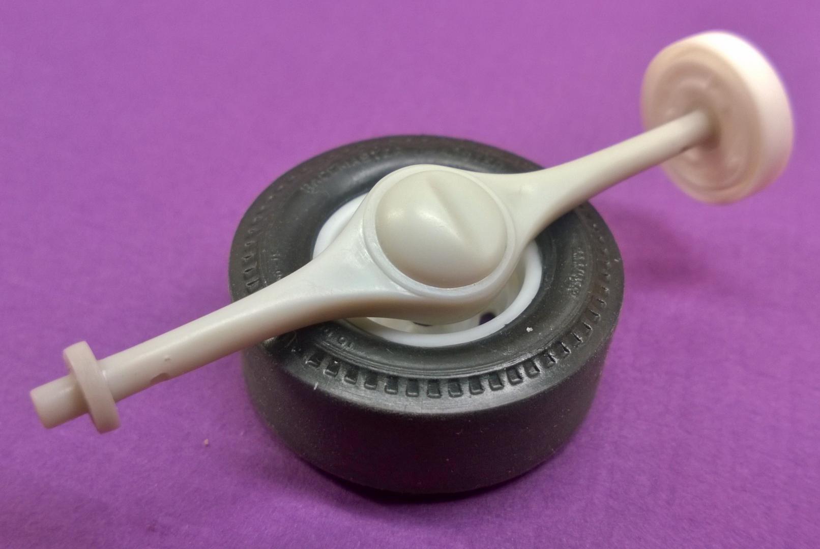

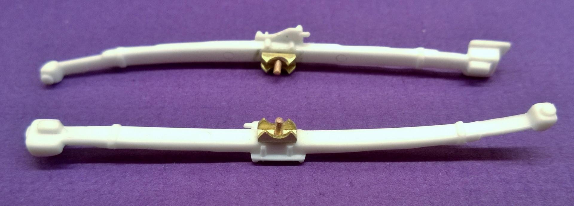

I'm using the AMT '62 Pontiac Catalina' rearend because it was (and still is) a common upgrade able to handle more power, and the part in the AMT kit is nicely designed and detailed, too, so a win-win. The stock control arm brackets all need to be removed and the flange ends turned down to fit inside the brake backing plates' holes, but it's a nice starting point:
I made up some brackets from brass u-channel so I could positively locate the rear ale tubes on the leaf springs, and added an alignment pin to each, as plenty of test fitting awaits:

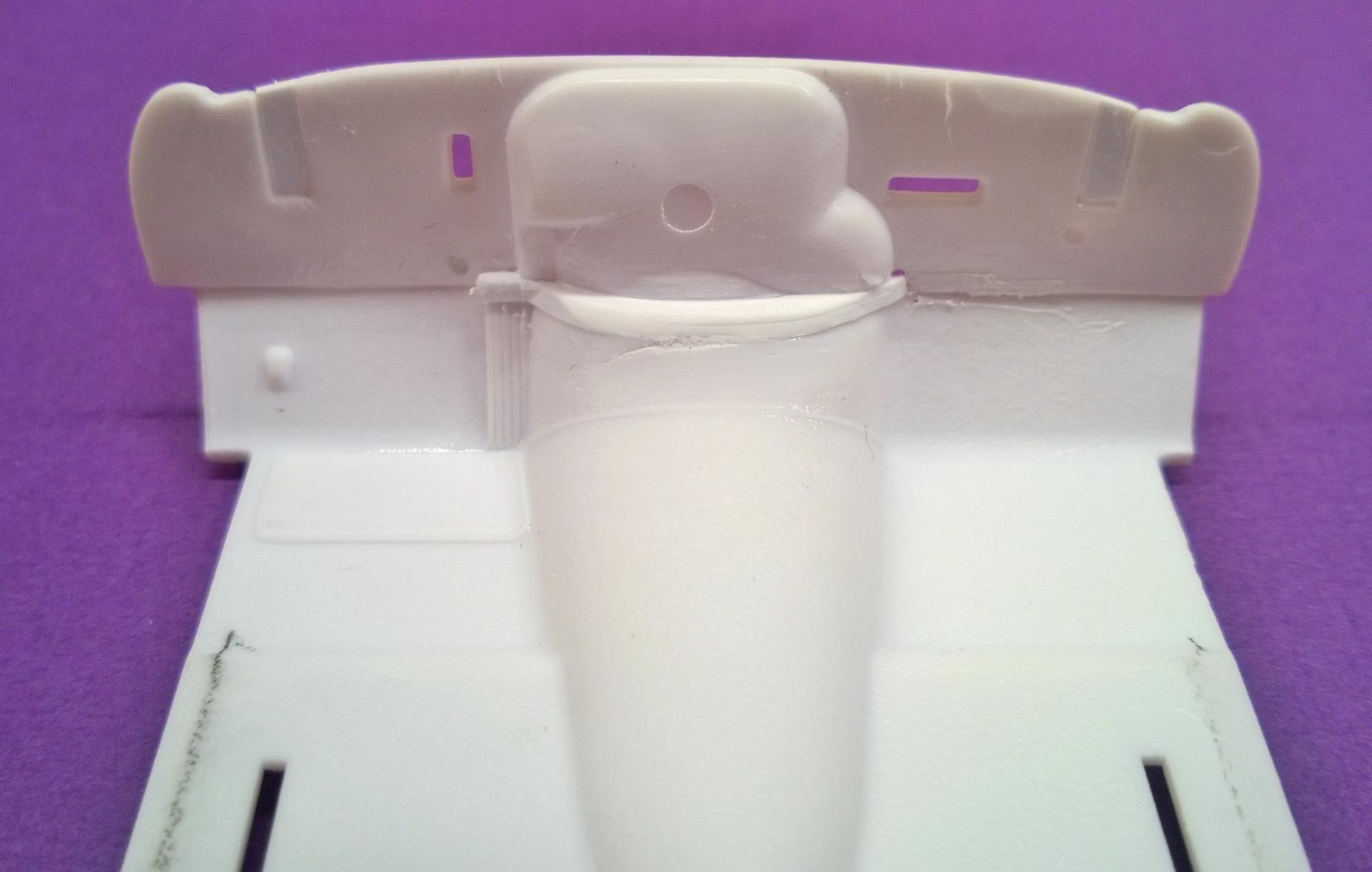

Additional look at the underside of the hood, which has decent bracing detail:
Better(?) shot of the hood scoop in it's final position:

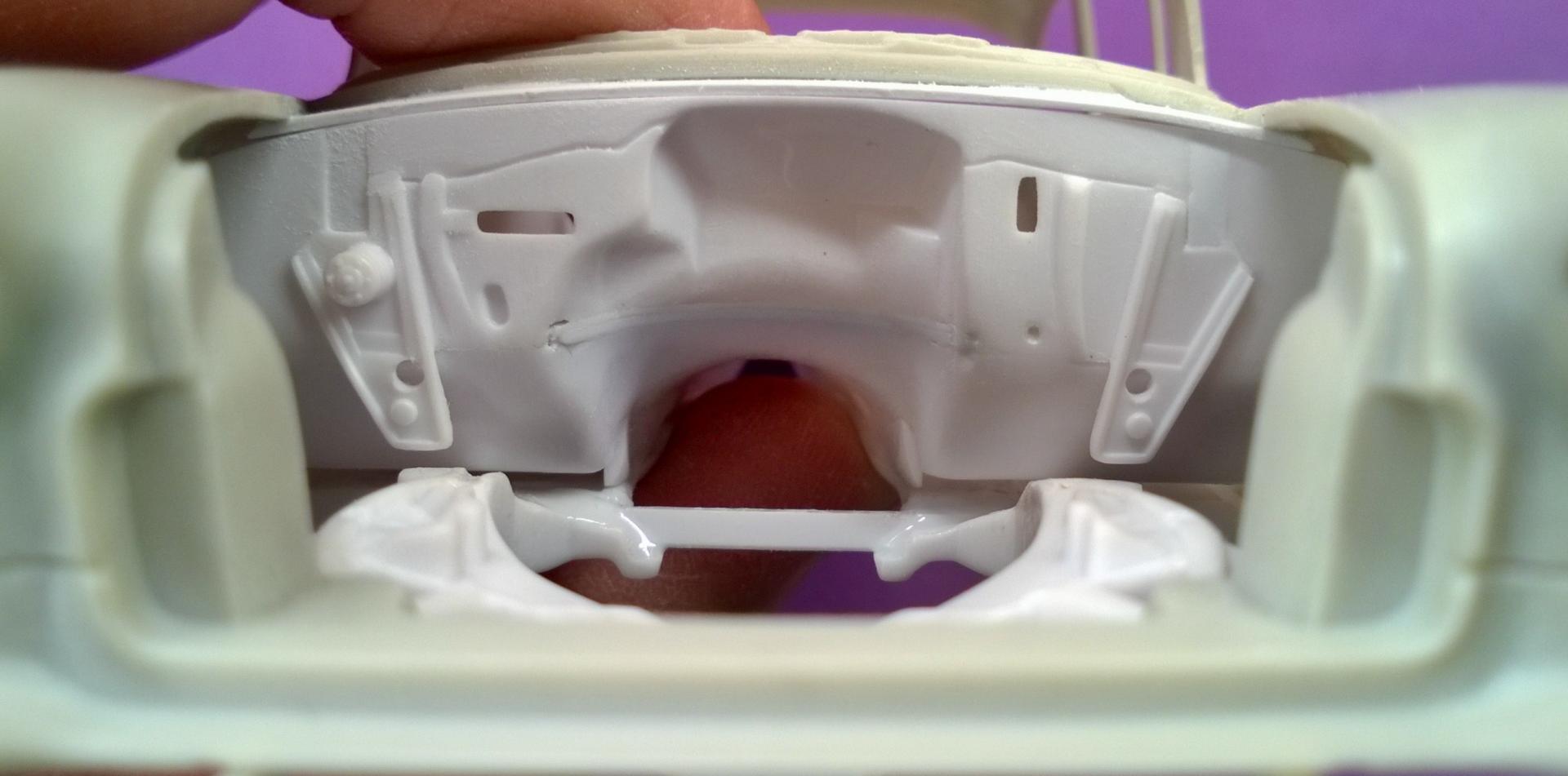

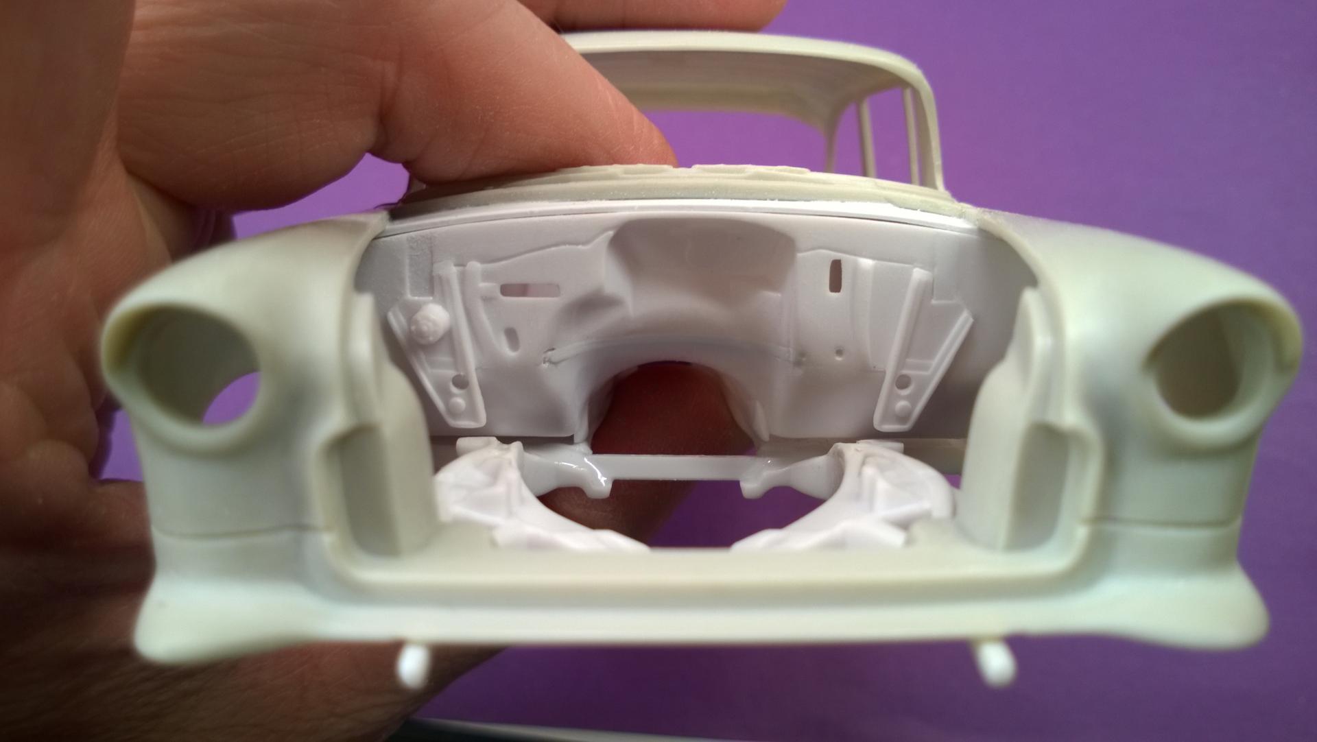

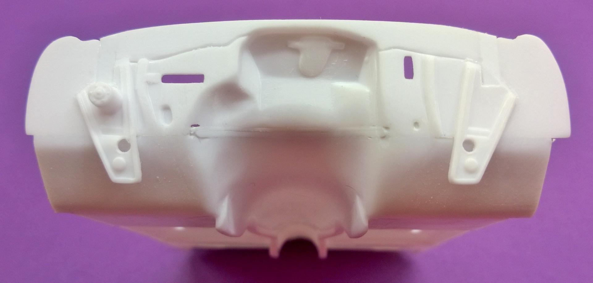

Firewall detail shots, showing the patches I added to make up for the differences between the '57 floorpan/toe kick area and the '55 firewall. The interior side should be mostly hidden, so it won't need to be perfect. The engine compartment can be fudged a bit as the ball peen hammer "clearancing" method may have been use to gain a bit more space for the 409 V-8:
WP_20180215_081.thumb.jpg.d89313c96cd0c2f930cf2f22a5820cf3.jpgWP_20180215_083.thumb.jpg.6886d47675305d1c941243ebcd98b19a.jpg
I removed some material from the edges of the floorpan, too, but I'm still working on getting the '57 interior panels and '55 dash to all fit together nicely.
Looks great!! As far as the ball peen approach to the firewall, I've been there. I once had to slightly "modify" the fire wall of a 55 (with a hammer) to make a H.E.I. clear.
Thanks Brian (and everyone else, too :)). I did a lot of poking around on the H.A.M.B. and Tri-Five.com before starting this project, and I was concerned about firewall clearance using the 409 engine, not wanting to use a modern, smoothed firewall. I will be able to get away with moving the radiator to the front of the support panel, leaving just enough clearance for the fan...more on that later, though. ^_^

Wheel/tire combo is very nice.
Thanks. The Revell slicks are showing their age and have some molds flaws which aren't ideal, but I should be able to hide them for the most part. I debated using the Halibrand rear wheels as they seem to be a bit too high dollar for a car like this, but they do have the period look, and the Tony Nancy kit contains two sets of rear wheels and tires, so...done. :D
I've always liked the steel wheels from the T-bolt kits, and wanted to run steel wheels up front on both cars per the box art, so that was easy. Turns out the front tires aren't from the Lindberg '64 Belvedere kit, so still trying to source those. One sidewall on each tire has the lettering printed out of register, but I can turn those to the inside. Not sure how realistic the straight implement style tread is on these, but they look good to me and the wheels are a nice snug fit inside them, too.
I used the Goodyear Power Cushions on my Dragonsnake build.  Don't know the kit source either, I picked them up in a tire lot on ebay.  Scenes Unlimited has them however.
https://scenesunltd.com/collections/tires/products/t25-goodyear-atlas

I whittled away at the top edge of the firewall so it would conform to the shape of the new top edge, but I have a little more work to do until the fit is just right. I still need to make something on the back/underside where the two pieces meet so they can be permanently, and neatly joined.

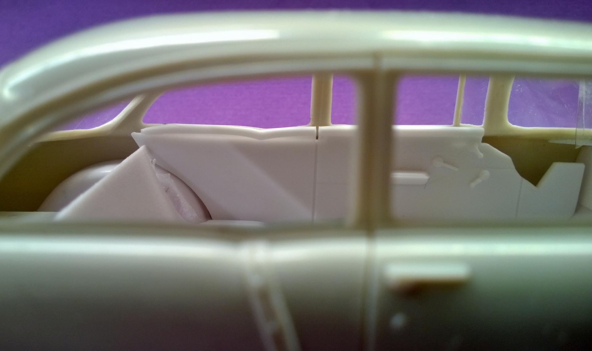

I also worked on the '57 150 Utility Sedan interior door and quarter panel pieces, shortening them a bit and re-contouring the upper edge a bit to match the AMT body. I still need to integrate the narrower AMT Bel Air dashboard, but I may end up replacing it with the Revell '55 dash if necessary. After test fitting both, it looks like the AMT Sedan windshield and rear window will play nicely with the Revell '57 interior parts, but they are a bit on the thick side. The Revell '57 Sedan windshield and rear window may be substituted and new rear quarter windows made, or I'll thin down the AMT pieces a bit...TBD.
