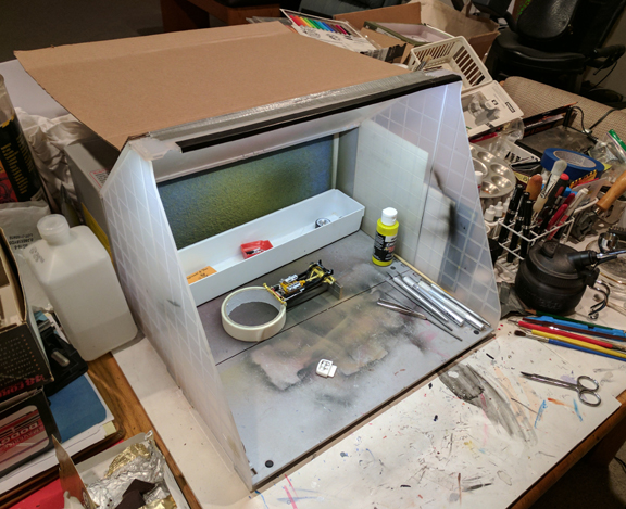

Harpo Posted February 17, 2018 Posted February 17, 2018 (edited) I've got the Master Airbrush Booth from Amazon, I'm very happy with it. I only shoot acrylics so it works fine indoors. I added an LED strip light to the top, and a cardboard cover you can swing down when not in use. Edited February 17, 2018 by Harpo
