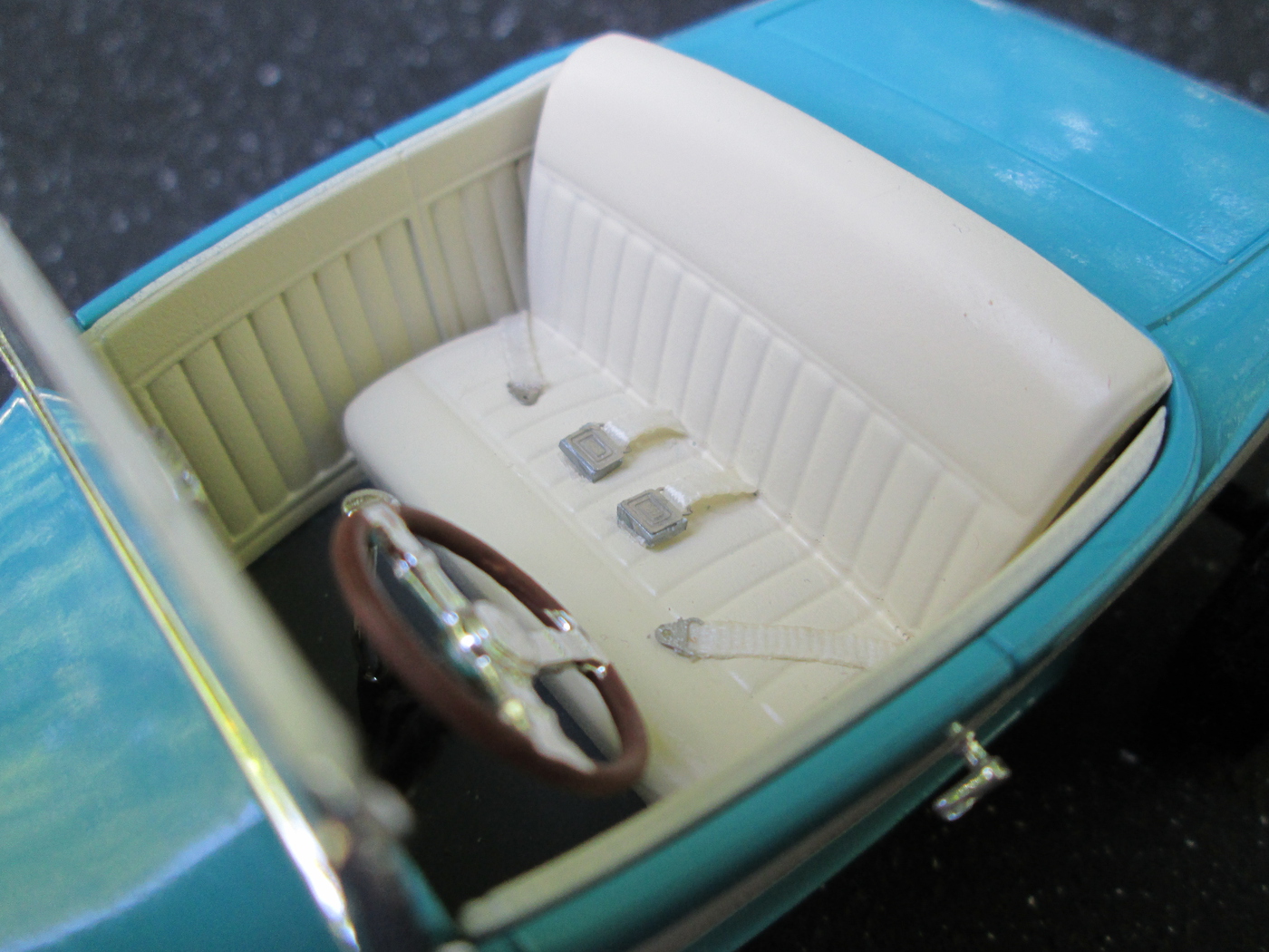

Tom Geiger Posted February 25, 2018 Posted February 25, 2018 The correct ribbon for seat belts is 1/16" width. I had checked the usual sources like Michael's, Joann's and Walmart and none of them had anything smaller than 1/8". Hobby Lobby wasn't around then so I didn't look there. So I went on eBay and found these. I bought a roll of black, brown, gray and white. I figured the white could be tinted to other colors as needed. This lifetime supply of seat belts was around $10 (my 65 Chevy Pickup) I'll give you two ways to make your buckles. You know those tacky plastic seat belts older kits came with? They may have usable buckles. Some of them are very thick, so carefully sand the backs down to a reasonable thickness. Then cut them off the belts, paint and use with the 1/16" ribbon. I always like to give my seat belts some character by gluing them down at angles that indicate use. (my 29 Ford Pickup) Again, another one using old kit belt ends. (My 29 Ford Roadster) Here's one using photo etch buckles. A bit more realistic results. One big tip- photo etch is really too thin for belt buckles (the female end). I use Evergreen strips the right thickness to add the necessary depth. Glue the buckle to the plastic strip, then cut the edge of the strip to match the photo etch part. Sand edges smooth, then color with silver paint, or best yet your Molotov chrome pen. For those of you who are going to try to cut the belt out of a wider piece of ribbon, ribbon will shred if you attempt to cut it. In order to be successful here, take some white glue, thin it out and cover the back side of the ribbon with it. The glue mixture will soak in. Once dry you can cut it without shredding. For those of you who will make belts out of masking tape, first spray the sticky side with Testors Dull Cote. It will neutralize the glue like it was never there. Hope this is helpful!

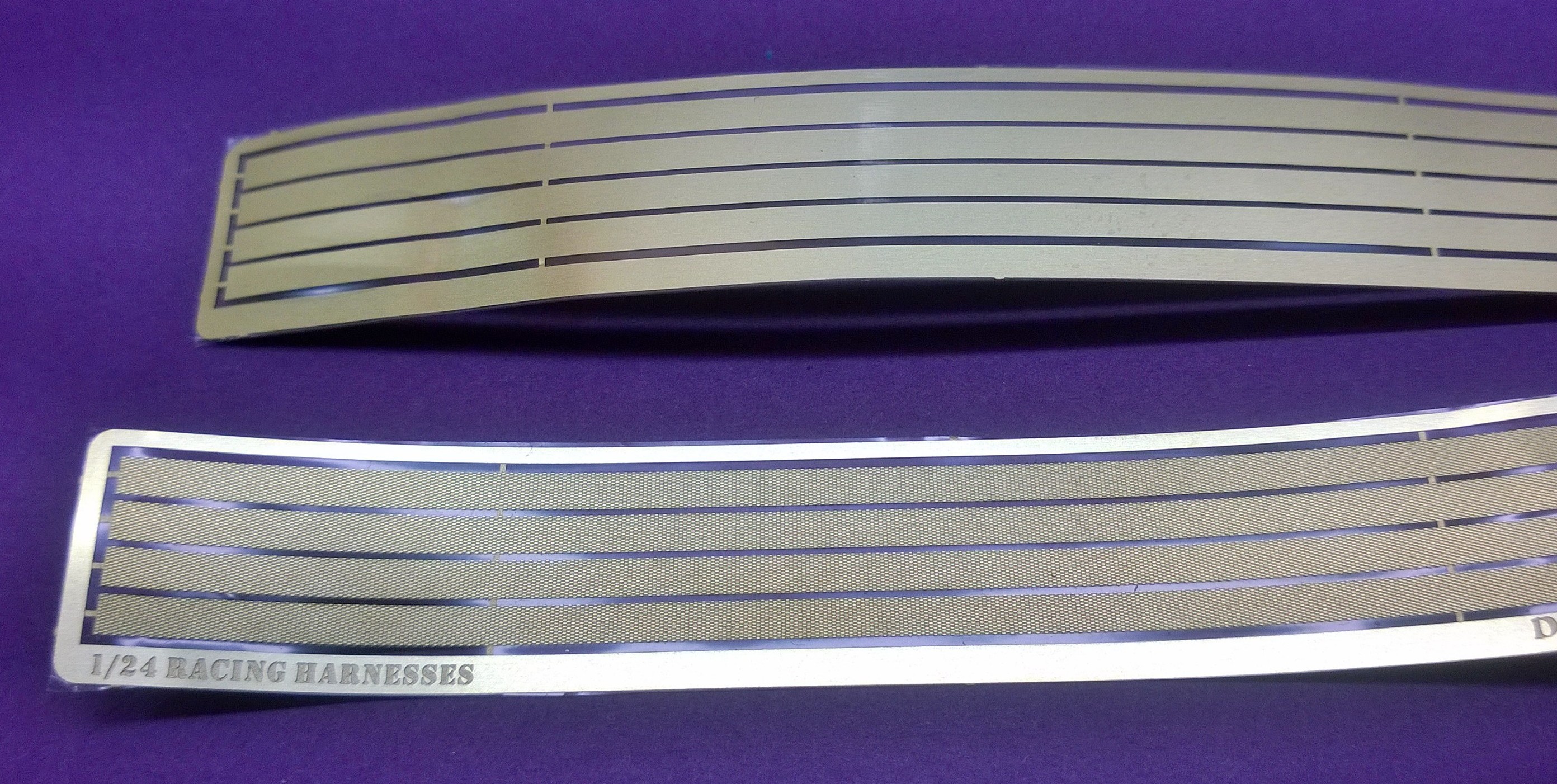

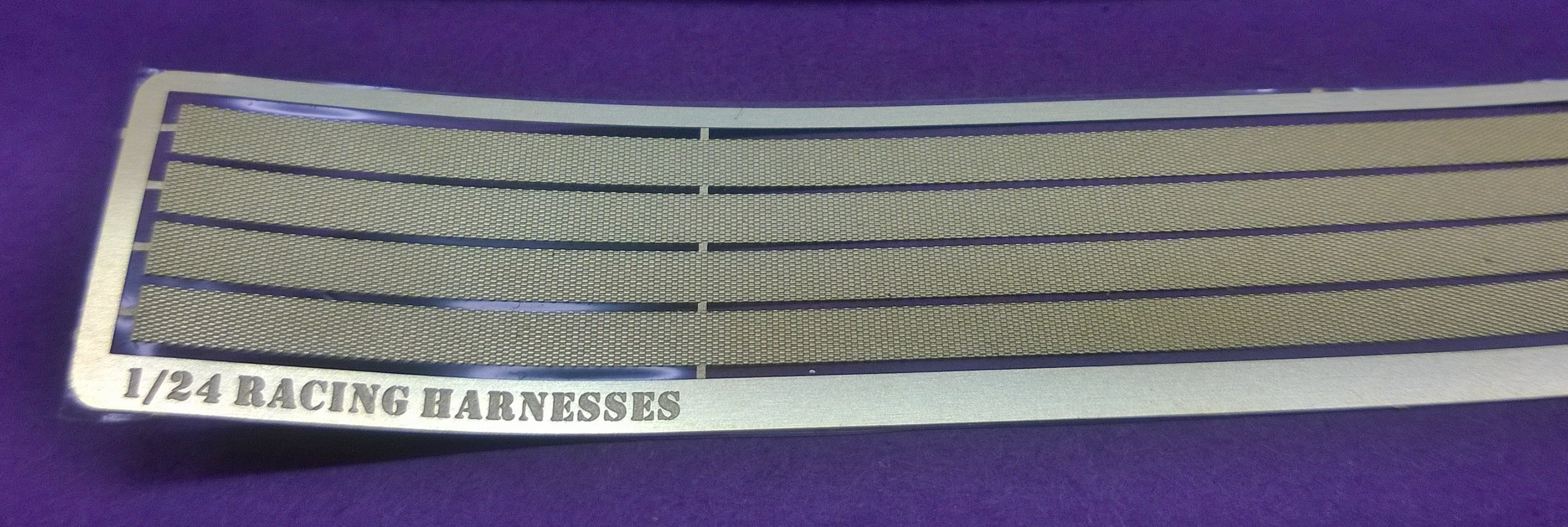

Casey Posted March 3, 2018 Posted March 3, 2018 You might also want to look into photoetched brass seat belt material which can be painted. Sounds counterintuitive to use something solid to replicate something made of fabric, but the texture/weave of a real seatbelt is so tight an fine that it's difficult to replicate in scale. You need something with subtle texture so the belts don't appear smooth, but not something where the texture/weave is too coarse making them look out of scale. I picked these p/e brass racing harnesses up on eBay last year but have yet to use them. I added a piece of clear packaging tape to the back (to prevent bending while being stored) as they measure .005" thick (with the tape), so probably closer to .003" thick for the belts alone. I saw these within the last few weeks on eBay, and I think they came from either Japan or China:
