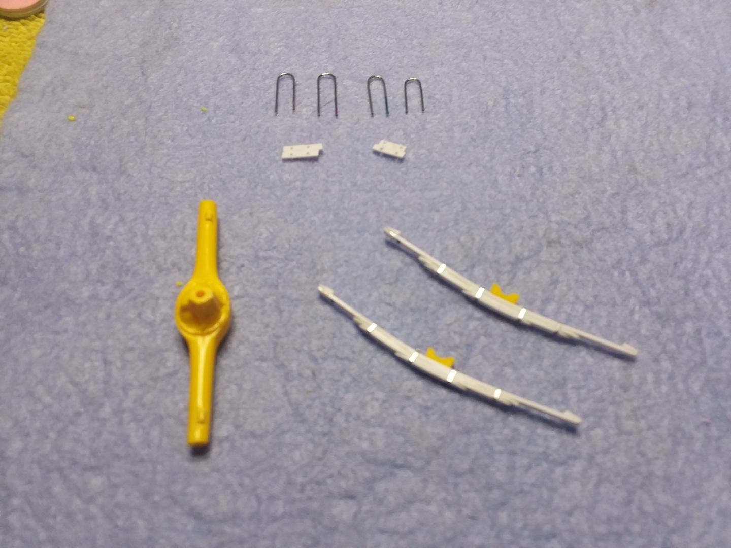

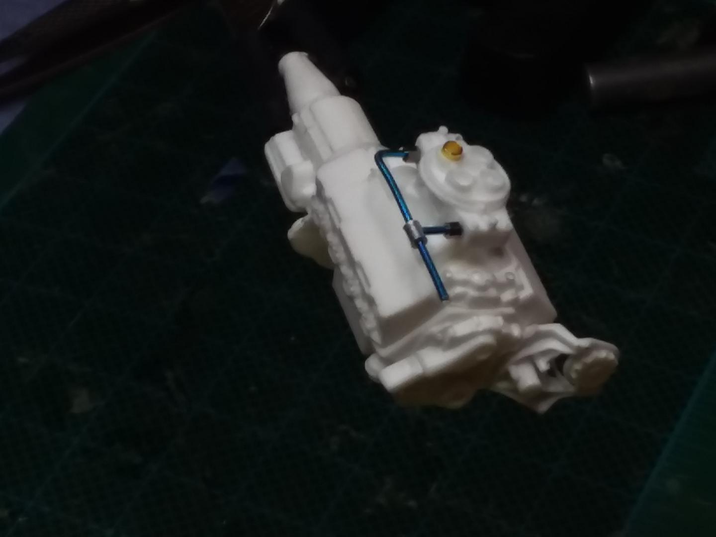

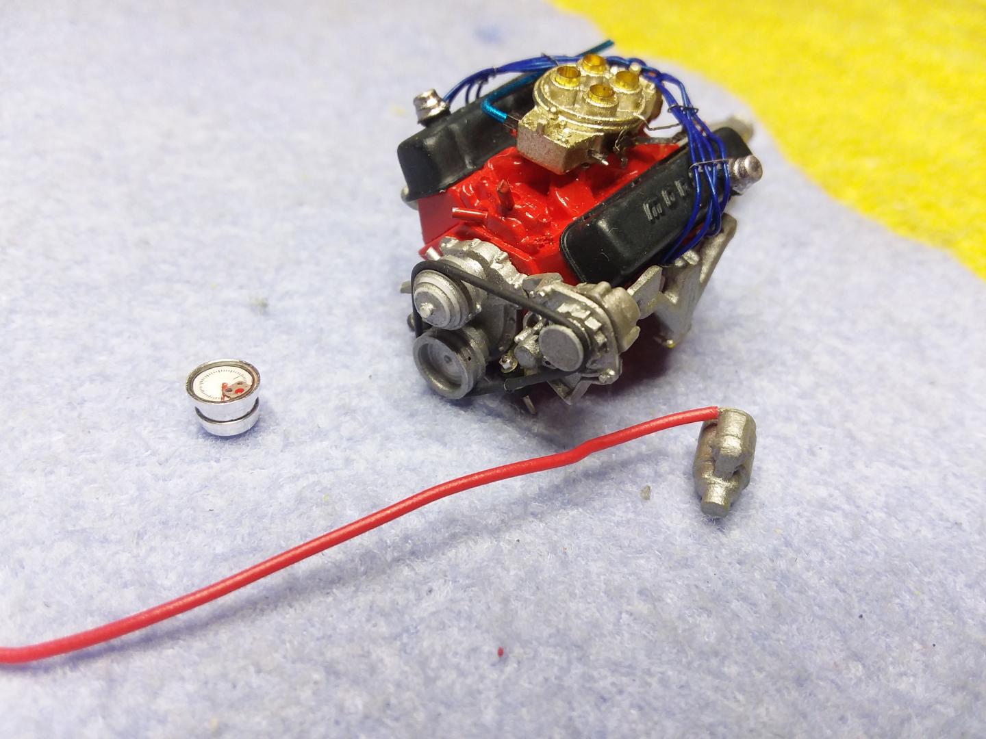

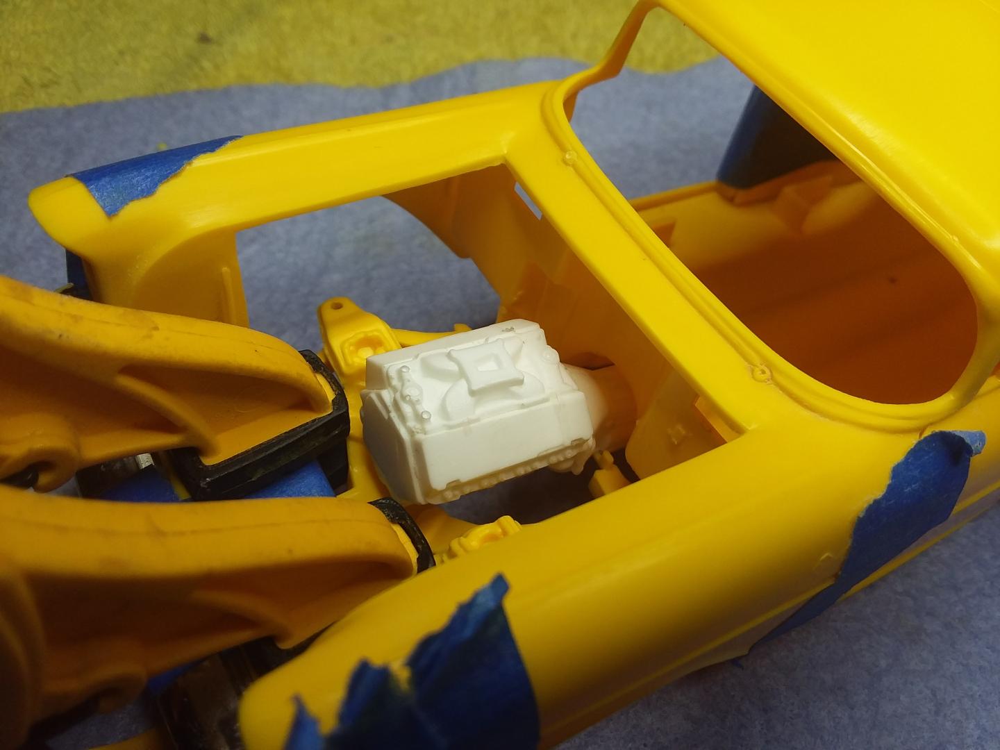

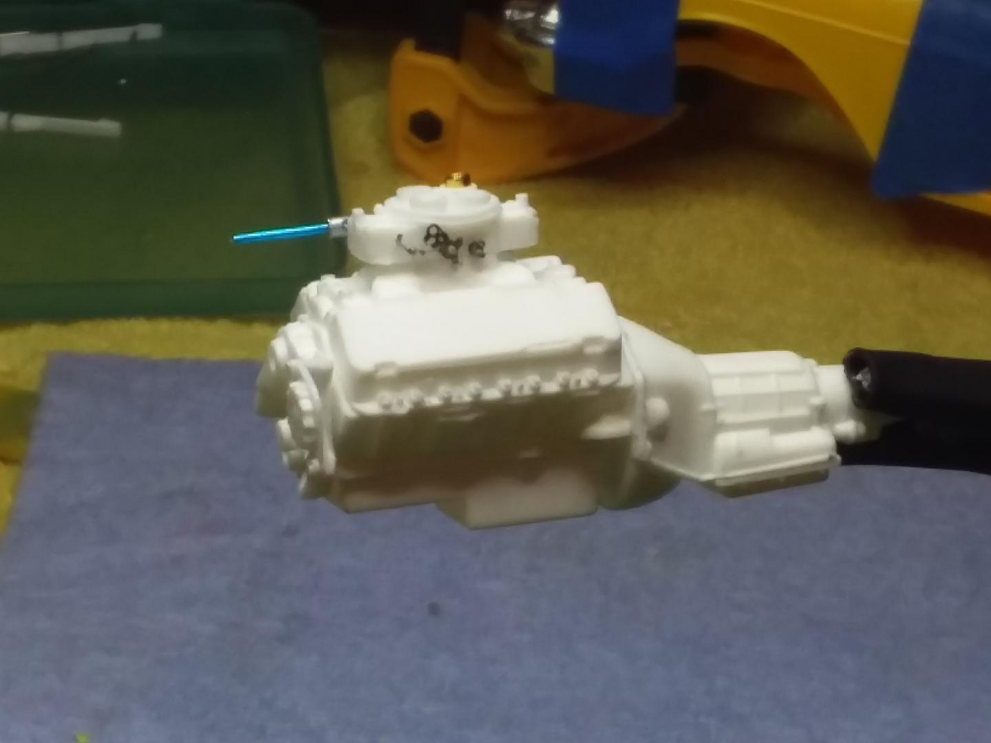

freddy_fo Posted March 4, 2018 Author Posted March 4, 2018 Cold miserable weekend so a good time to dig into the build. I built the leaf springs for the rear using evergreen styrene strips .030 x .080 for the bottom two and .020 x .080 for the top two. Used some parts trees from a detail masters metal etched distributor kit for the baling. Ordered a 400 CI small block from BNL resins and am getting that ready for paint. Used some canopy glue to temporarily join the transmission to the block so I could test the fit in the car and it looks like it will work well. Did some detailing on the carb as well using the detail masters carb linkage kit and the fuel line kit that BNL also supplies.

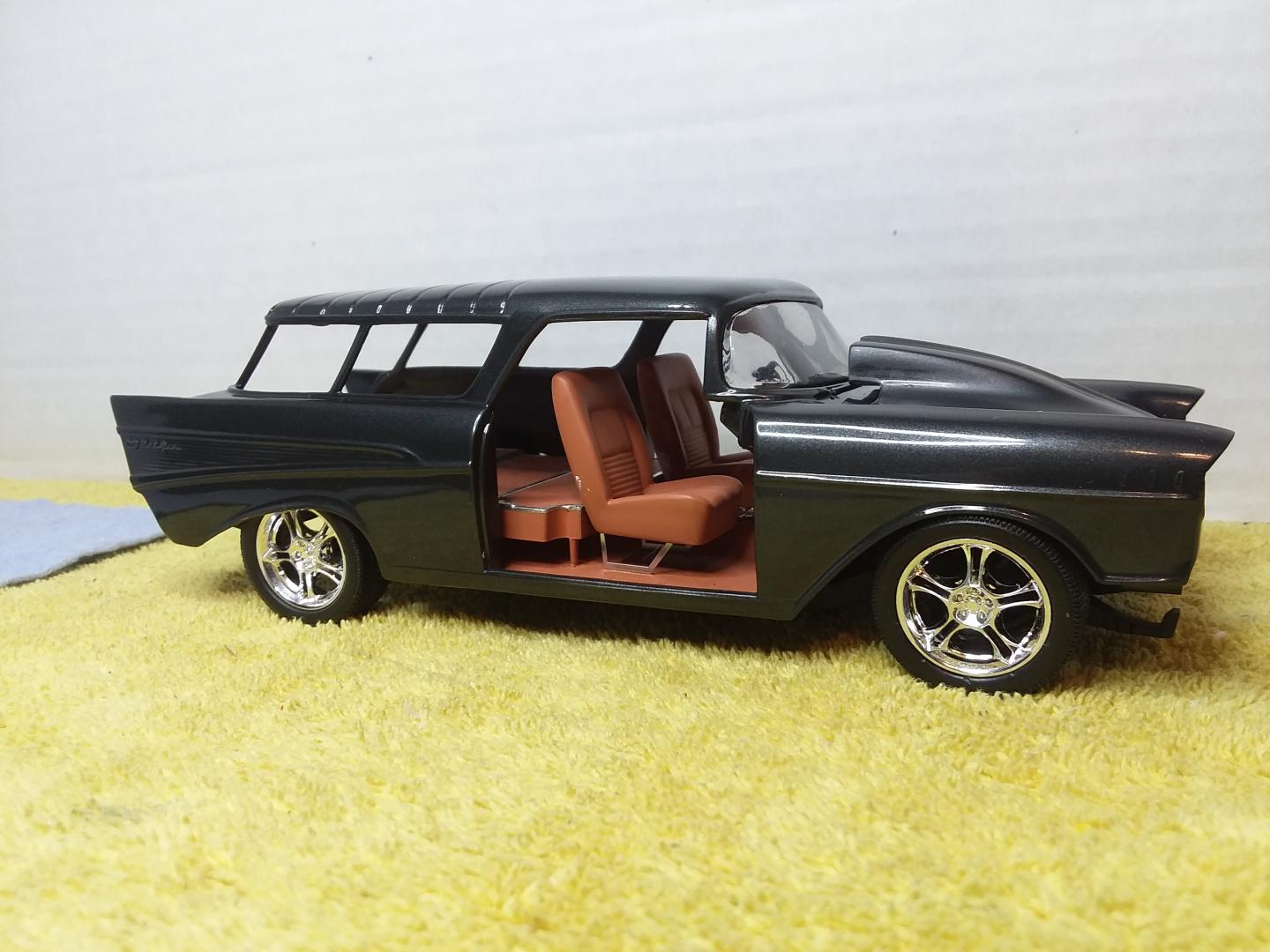

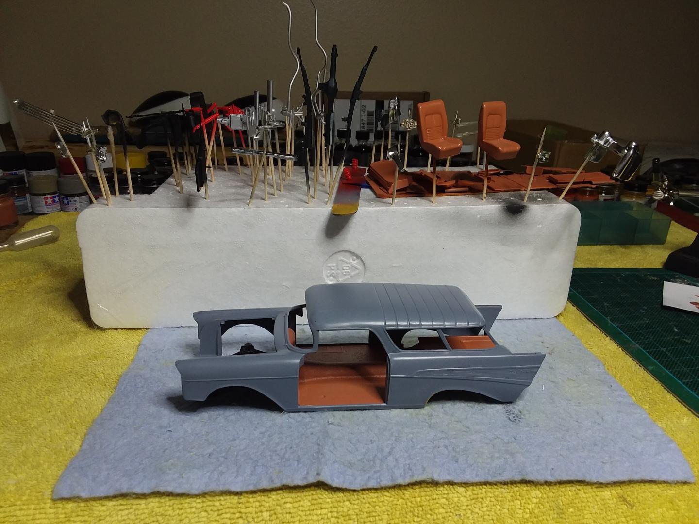

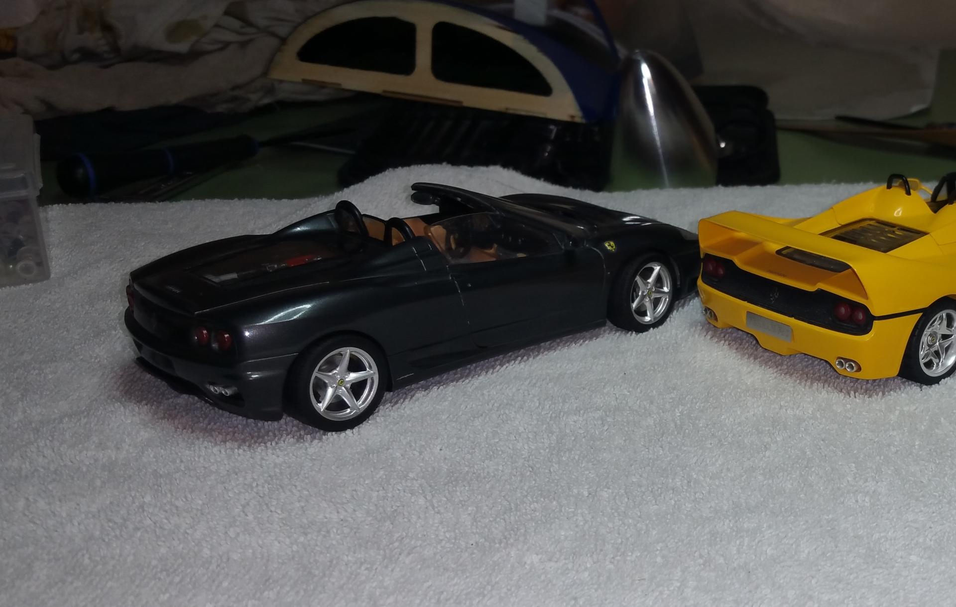

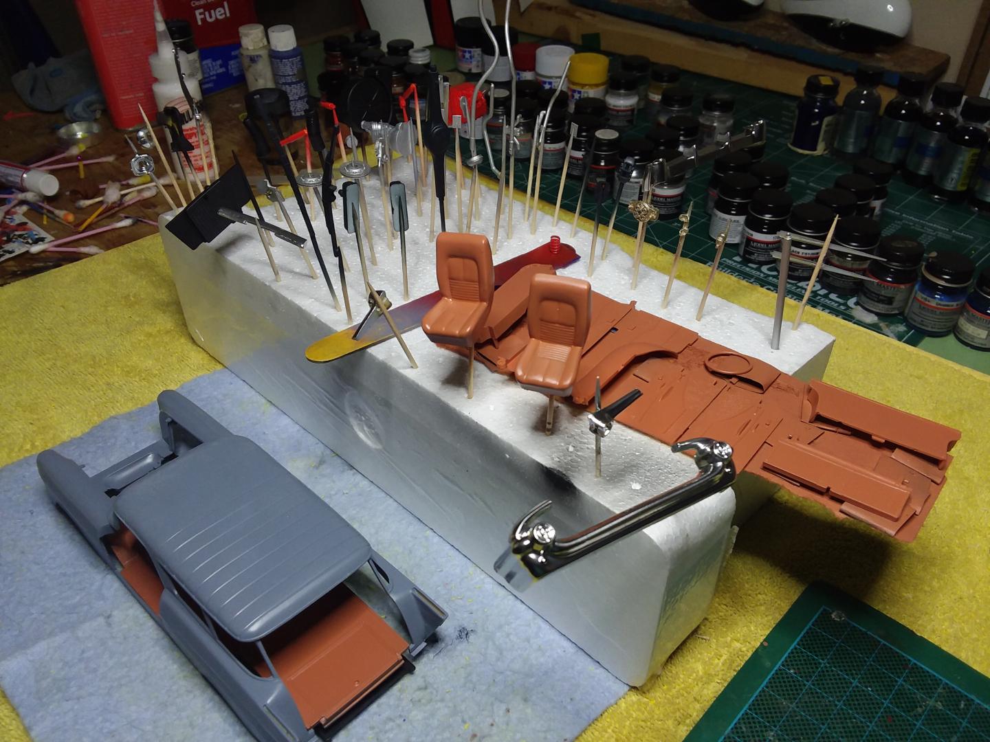

freddy_fo Posted March 11, 2018 Author Posted March 11, 2018 Weather warmed up just right for shooting paint so that is what I did this weekend. Primer on the body showed up a few flaws so I need to do a little work there and hopefully be ready to shoot the body color next weekend. I still need to paint the interior panel insets once the brown dries. Thinking a light tan should work and planning on doing the insets on the bucket seats (pulled from a 68 camaro) the same. I also stripped the original chrome and re-shot with molotow chrome. Looks more like polished aluminum but I'm good with that so I'll keep it. Final base body color will be graphite metallic like I used on my Ferrari 360 spyder.

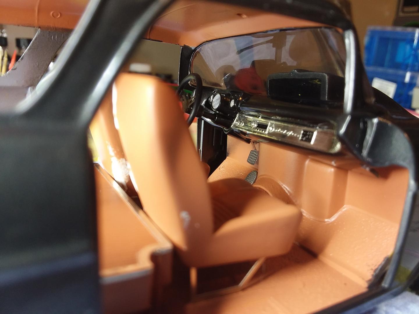

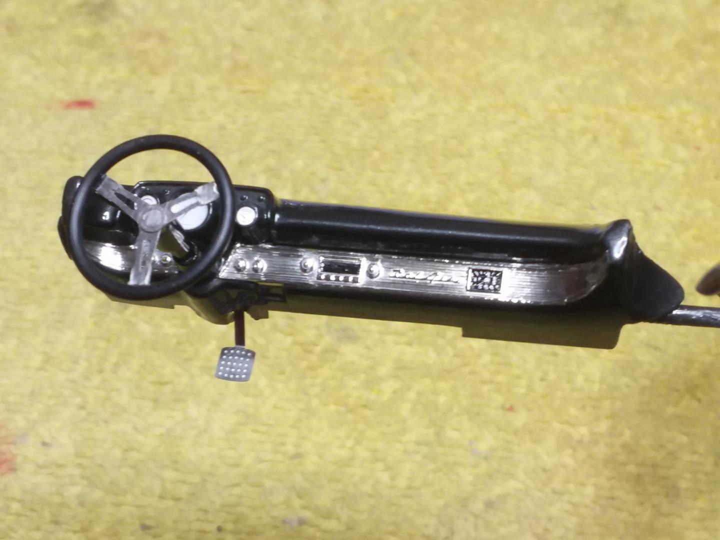

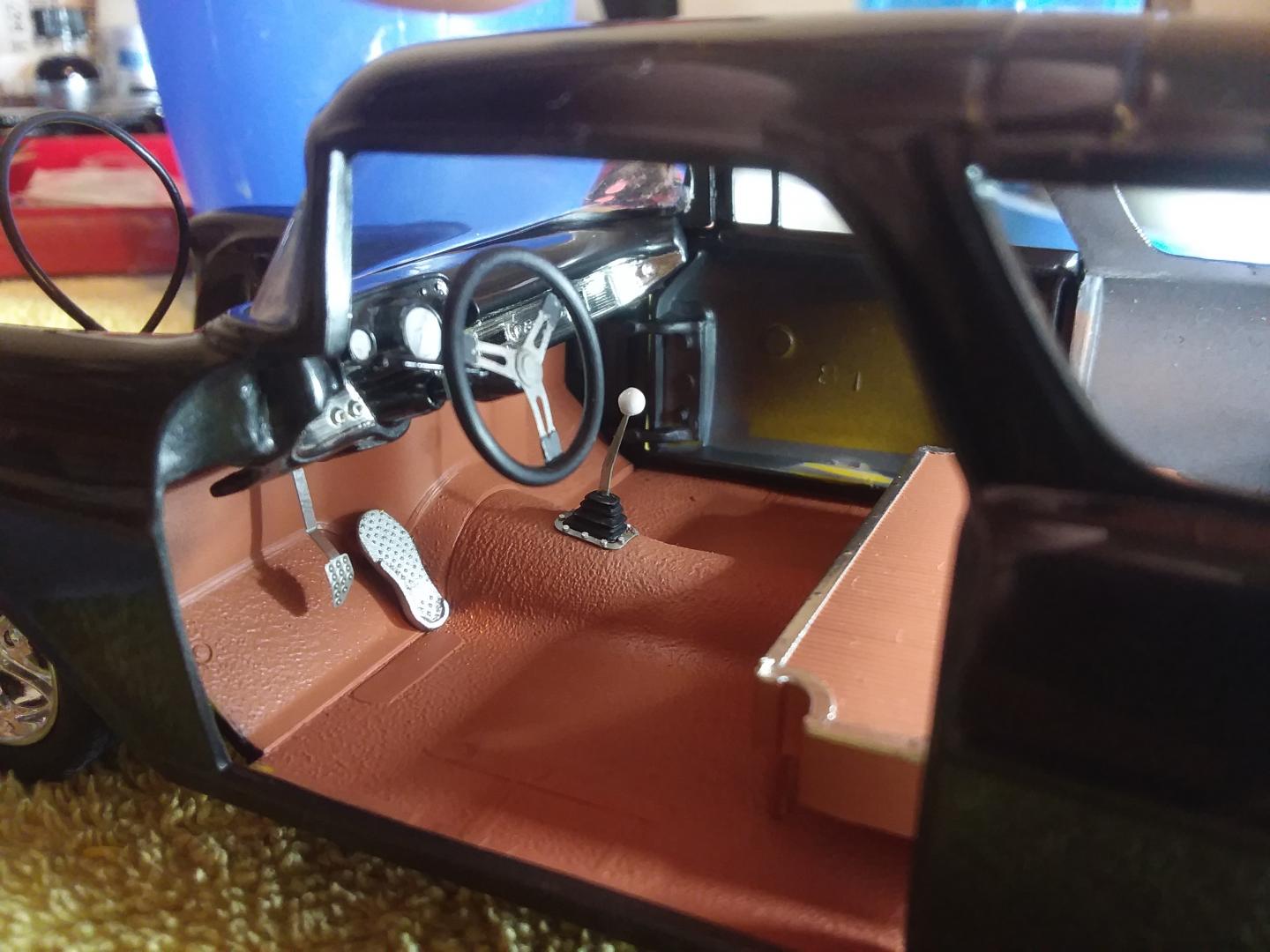

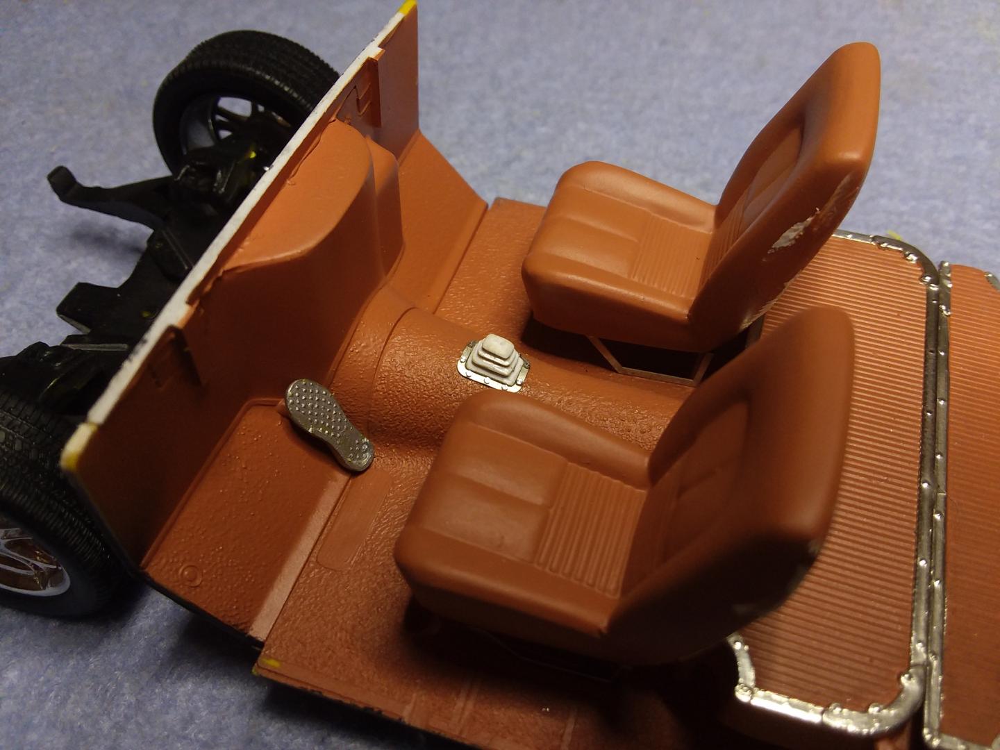

freddy_fo Posted March 19, 2018 Author Posted March 19, 2018 (edited) Some more progress. The dash required a bit of work. Was hoping to use the one that came with the 57 couple but it was too wide to work with the functional doors on this model so I built up the thin spots/holes around the gauges with epoxy and fortunately the natural surface tension of the uncured epoxy almost did a perfect job filling in the holes and keeping the contour. I had to drill out the fuel and temp gauges then shape a plastic dowel to go in the holes then applied decals. Was hoping to show a mounted tach but as I was working on the mount from a detail masters kit I walked away while almost done and when I came back the tiny little bugger was not where I remembered placing it. Somewhere in the carpet now I'm sure so moved on to other things. Got the body base coat painted and applied foil to the trim pieces in the interior. Found the perfect bucket seat mounts from leftover parts of a revell 250 gto detail kit. Woo hoo! Then I needed a boot to go around the detail masters hurst shifter kit so I scratch built one by layering gradually smaller and beveled rectangles from a .030" inch styrene sheet. Engine almost ready for install. Dash temporarily glued into place with canopy glue normally used for RC airplanes but works great for glueing windows on models. I'm going to have to swap out the brake pedal with another I have that has a longer arm to get it lower and more to the left as this one sits almost over the gas pedal. These are the wheels that came with the newer revell california 57 chevy. Edited March 19, 2018 by freddy_fo

espo Posted March 19, 2018 Posted March 19, 2018 Outstanding interior detailing. I'm going to steal your shift boot idea. That looks better than what comes in most kits.

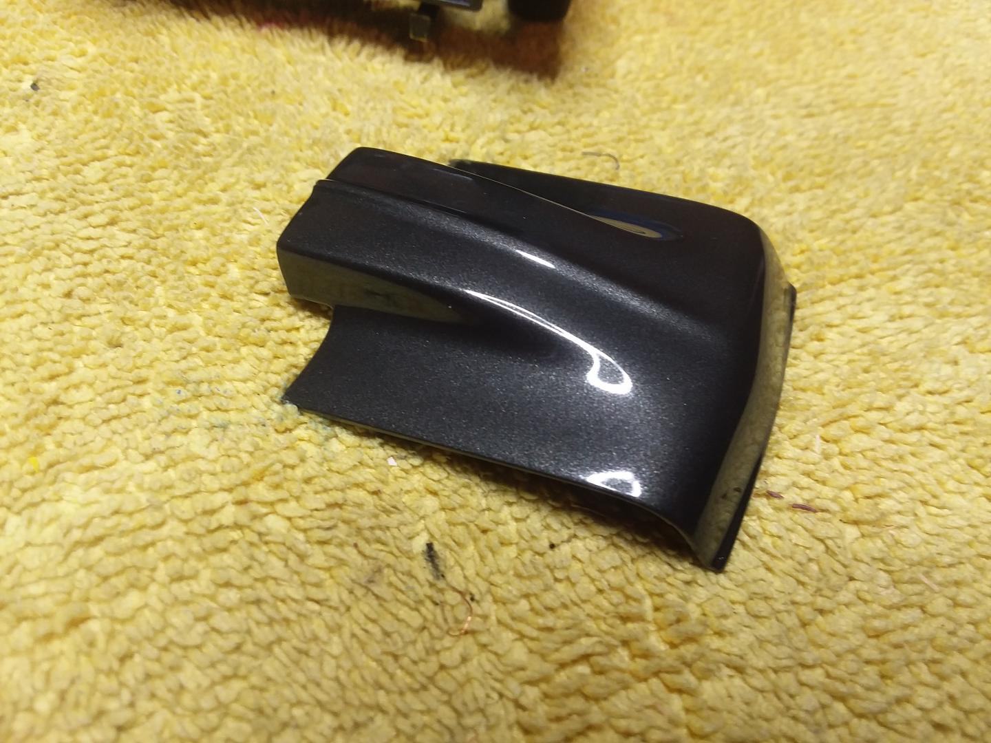

freddy_fo Posted March 19, 2018 Author Posted March 19, 2018 Thanks for the nice words. Funny now that I review my pics I start to find some little nagging issues I didn't catch in person. Need to thin the walls of the hood scoop to start and that seam in the passenger floor looks pretty substantial. For the latter I think I'll fix that with some floor mats I didn't want to sand down the seam and remove the carpet texture but that is how the seam lines up on the top when the bottom side is lined up. Should have made the top line up and sand the underside but to the naked eye it's barely noticeable.

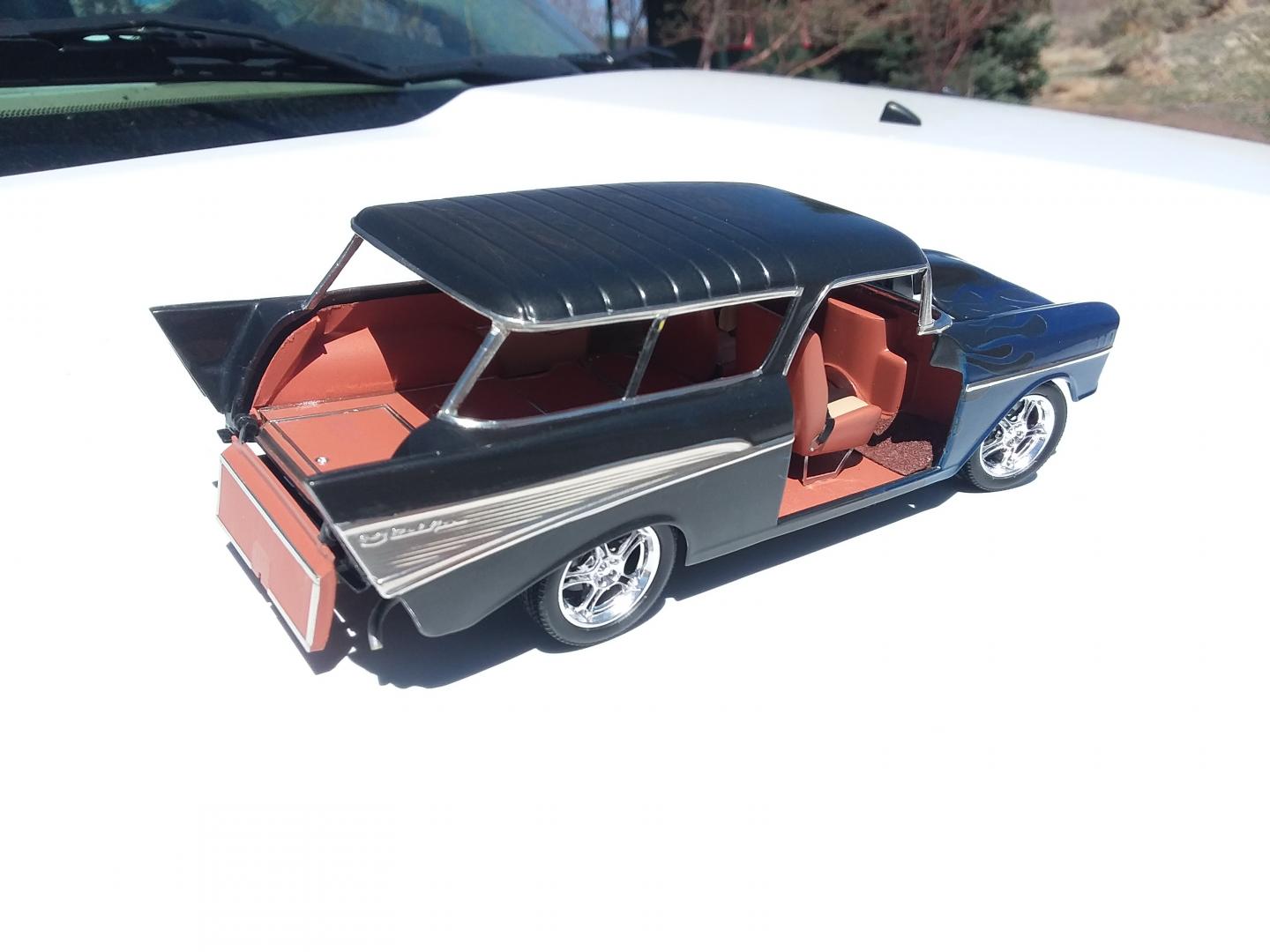

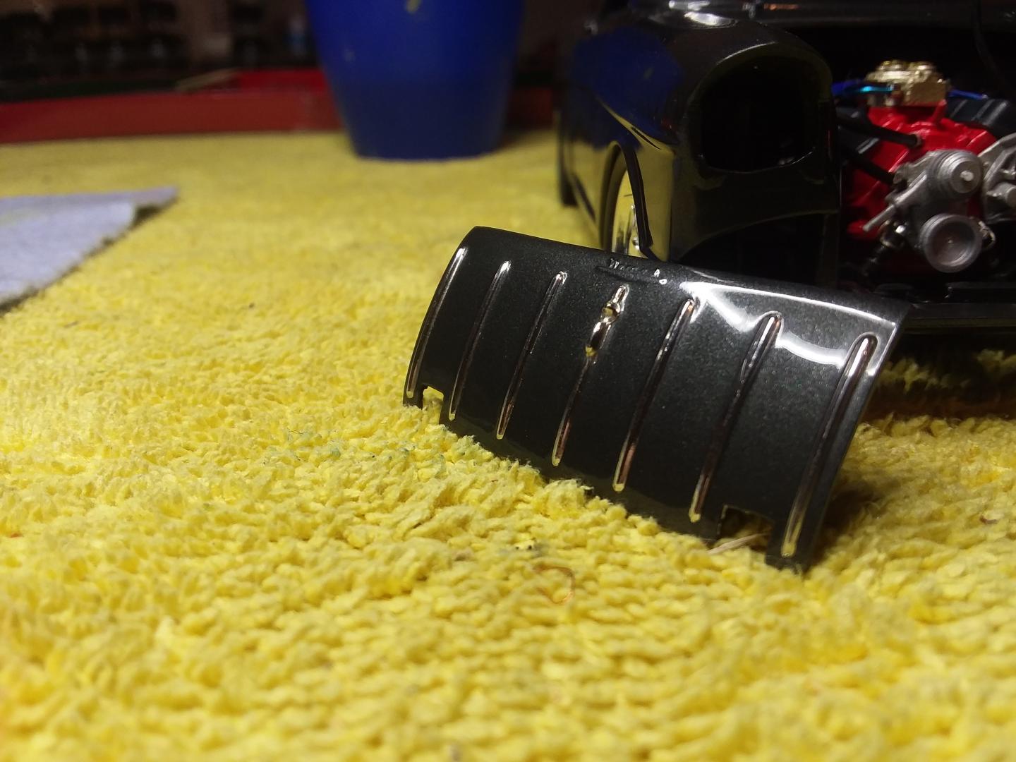

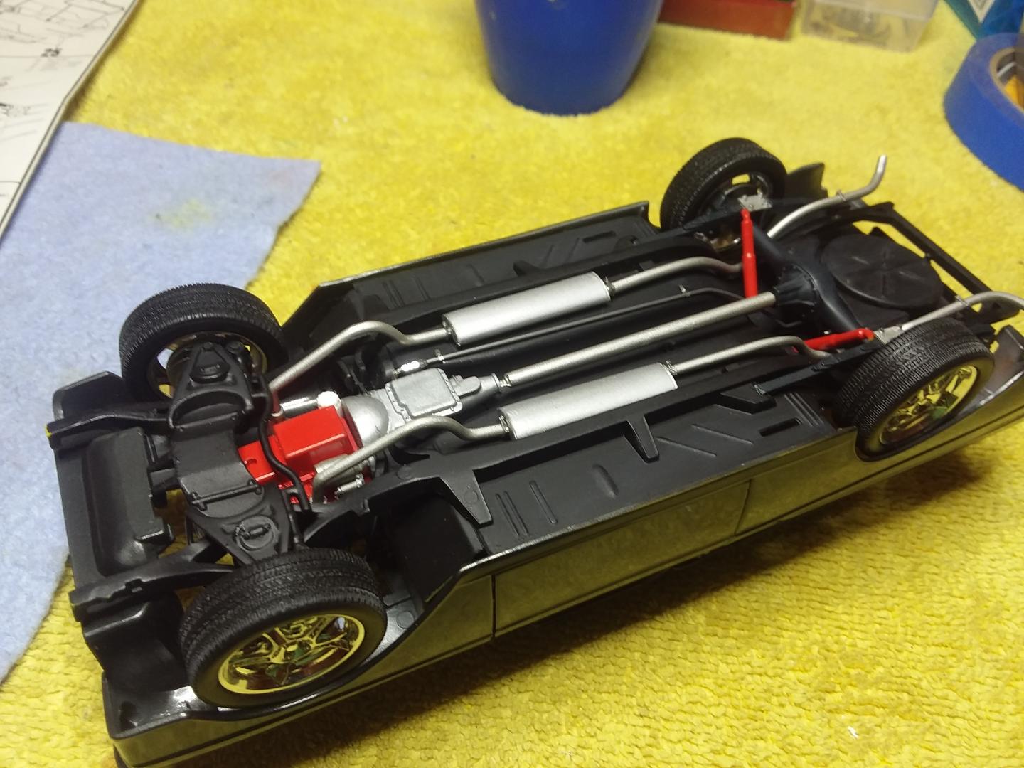

freddy_fo Posted March 23, 2018 Author Posted March 23, 2018 A little more work done. Underside is pretty much done. I took liberties with the fuel line since it's a custom build. Final base coat on the hood. Two weeks it and the body should be ready for the flames. Wrapped up the shifter and found a better brake pedal from my leftover metal etched parts. Experimented with foil on the tailgate and super pleased with the result. The only downside is the nomad emblem like a lot of the other emblems wasn't molded well. I wish someone made metal transfers... google search proved fruitless for me. I can save the V but the nomad part may be more effort than it's worth. So now on to painting the seat insets, and fabbing up some floor mats.

freddy_fo Posted March 25, 2018 Author Posted March 25, 2018 Thank you everyone for the nice words. David, I have a 1mm molotow pen but it's still too big for that emblem job. Some of the lettering almost blends into the body where it is only bumps. I've foiled the area and dropped paint over it to see if it will darken up the valleys and it looks a little better but still not great. Need to head to the art store to see if I can find a super fine paint brush to help with that. Ruben, I saw a couple of the skip fiesta versions come up on ebay while I was looking for mine. None there at the moment but I'm sure one will pop up eventually.

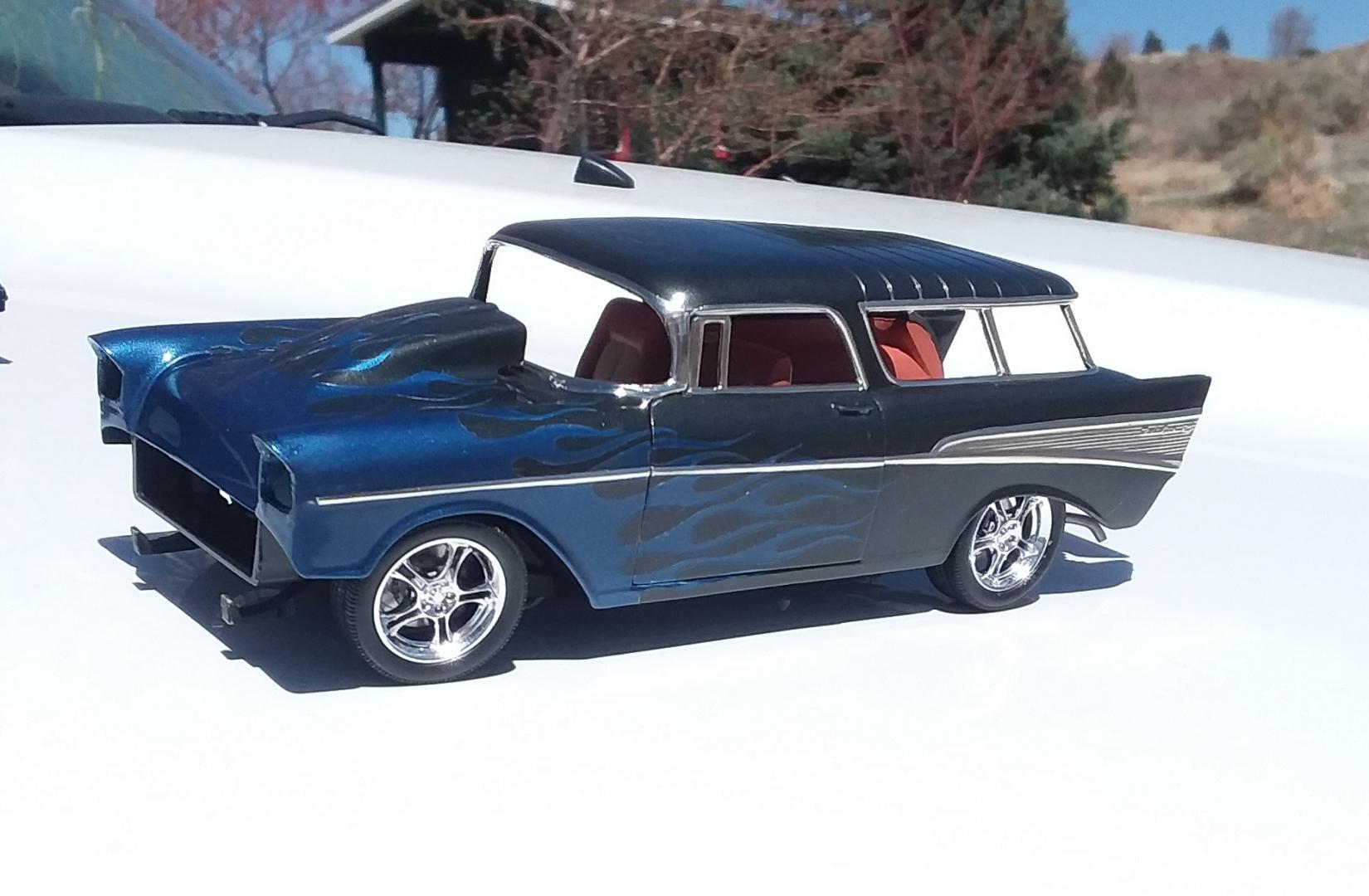

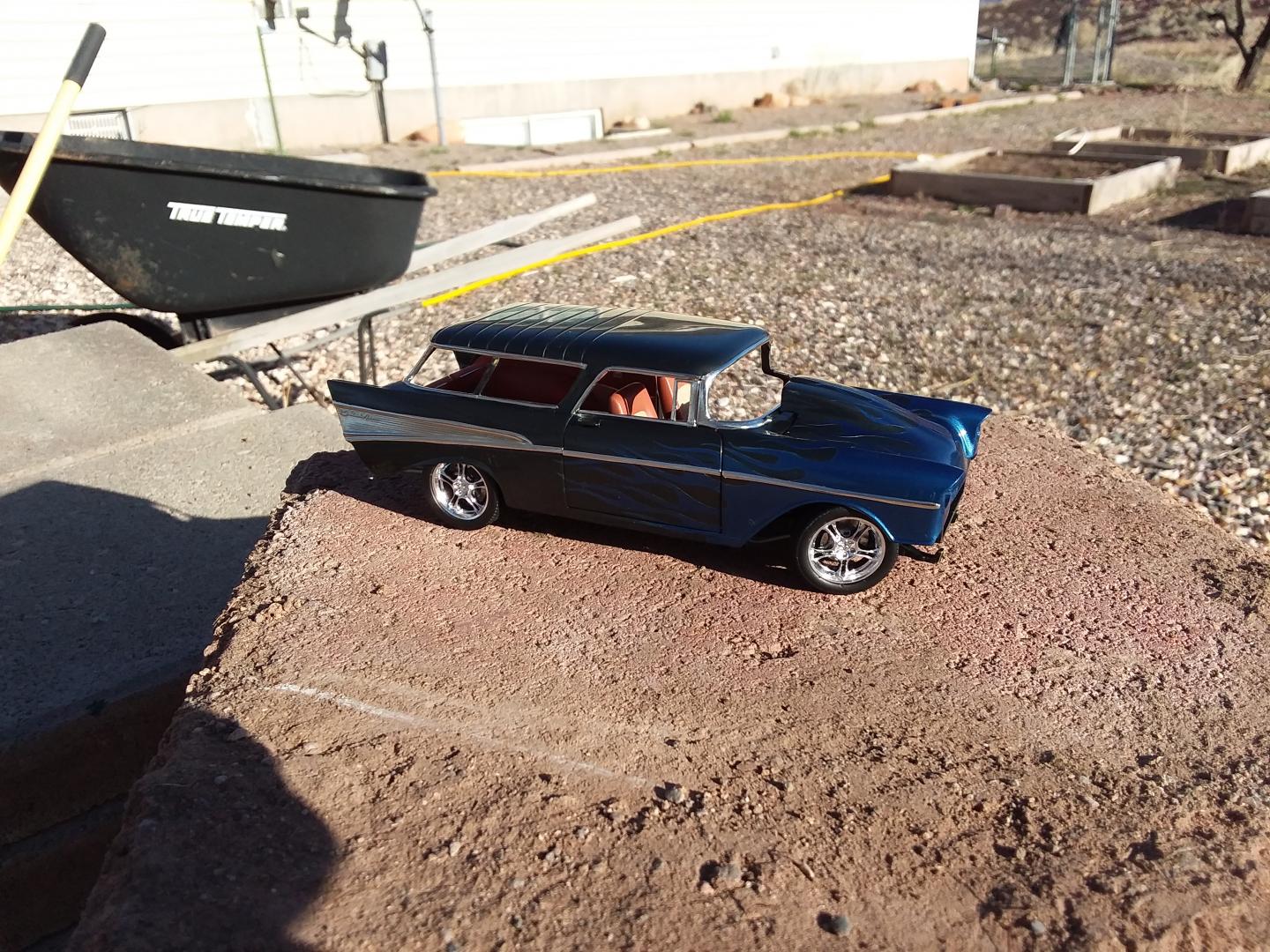

freddy_fo Posted April 11, 2018 Author Posted April 11, 2018 Just an update. Paint finish is pretty raw as I scrubbed it with 12000 grit pads and have a few more foil/paint touch-ups before I apply the clear coat. I'm on the fence as to whether I did the right thing with the flames. I really liked the charcoal finish all the way around and the blue flames/front end isn't quite what I was hoping for. Maybe a few more weeks of staring at it and I'll come to like it. A little nervous about final assembly. The frame is twisted and going to take a few glue sessions to get it aligned. I think the first best step is to glue the rear inside panels to the body so that the tailgate is aligned. Then once that is dried/set align, glue and clamp the front of the frame to the body and finally the rocker panels to the pan. The molotow chrome I applied to the bumpers and other plastic trim pieces did not work out well. After 1 month of drying they still dulled to the touch so I've stripped those and am going to try the alclad method.
