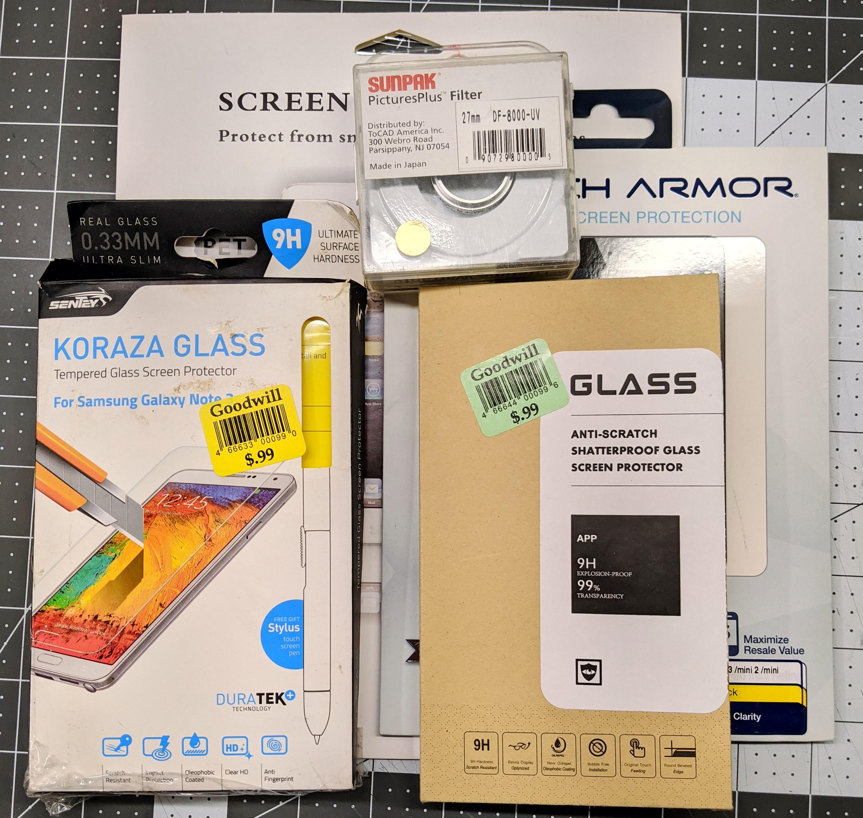

Casey Posted December 12, 2020 Posted December 12, 2020 (edited) On 12/3/2020 at 12:16 AM, peteski said: Some good info there, but unfortunately Photobucket "ate" the photos from last couple of pages. True, but some images are still viewable, and the words remain, too. Really the best technique I've seen shared here on the forum, so worth a read IMHO. Adding on a bit to this topic, I have one long term project which will require both new windows (where the base kit included none) and replacement windows, where the kit supplied parts are too out of scale, so I keep my eyes open when I shop thrift stores (charity shops for U.K. members ?). I have collected a few different styles and sizes of screen protectors for future use as scale window "glass", as seen in the attached image. One piece even has slightly curved edges on two opposite sides, which might come in handy for a specific application. With handheld devices becoming outdated and obsolete rather quickly, you can bet the screen protectors they were designed to protect are cheap as chips on the secondary market now, too...and we know auto modelers are a frugal bunch. tl/dr: keep your eyes and mind open. Edited December 12, 2020 by Casey
