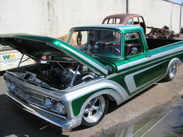

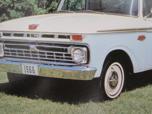

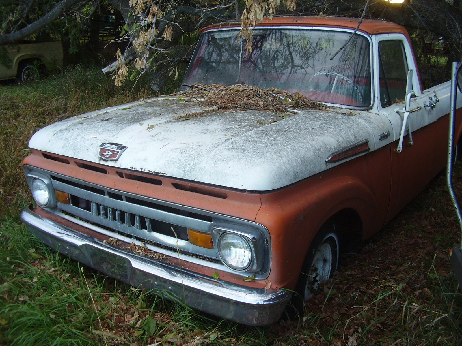

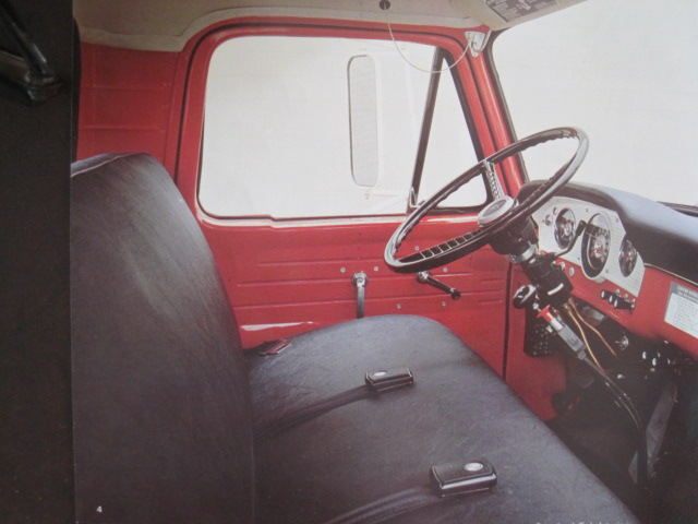

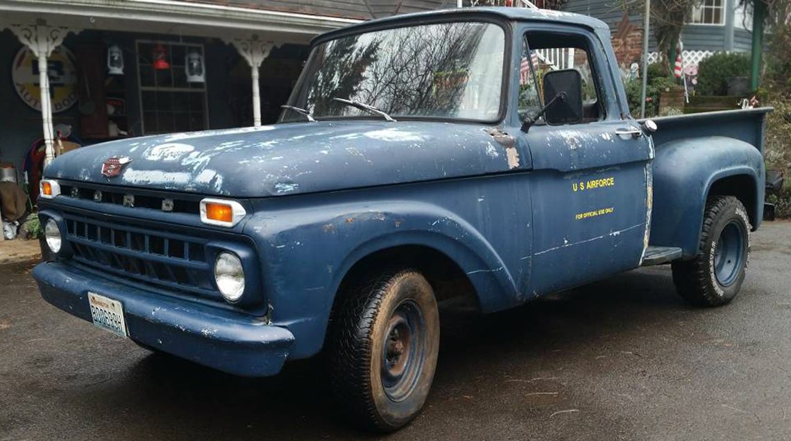

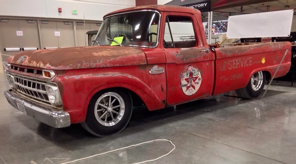

mk11 Posted March 6, 2018 Posted March 6, 2018 (edited) Figured we could use a reference for this Ford truck styling cycle that would be a help for those building or rebuilding the vintage AMT trucks or the currently available resin kits. Or maybe even just to supply some eye-candy for the old truck fans... If you have quality pics, bring 'em on... '66 F100 Ranger Custom Cab '66 Ranger Custom Cab '65 F100 '61 Mercury unibody big window mike Edited June 9, 2018 by mk11 1

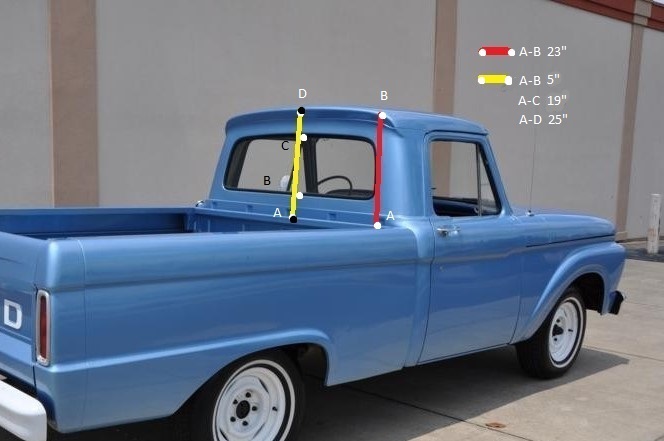

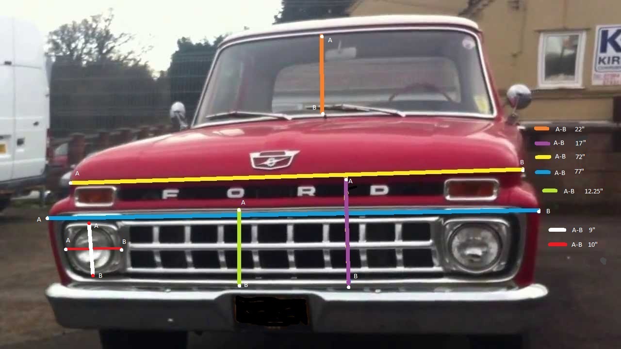

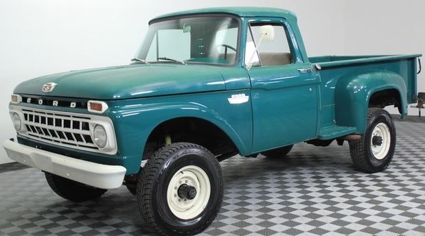

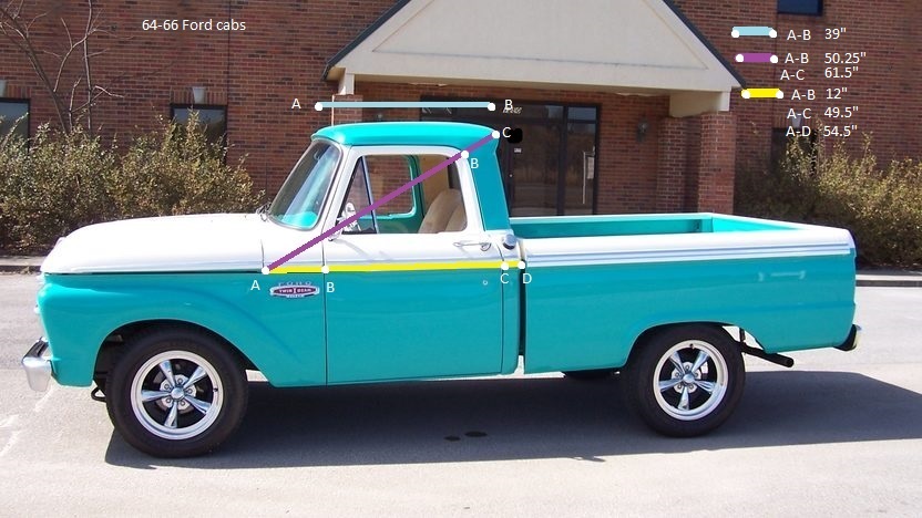

mk11 Posted March 6, 2018 Author Posted March 6, 2018 (edited) '66 F250 4x4 Some measurements I've taken to both check the accuracy of the amt cab and to possibly help with modifying the old amt unibody into a regular cab. Note that the '64-'66 cabs are taller above the rain gutters than the '61-'63 cabs. mike Edited November 14, 2018 by mk11 1

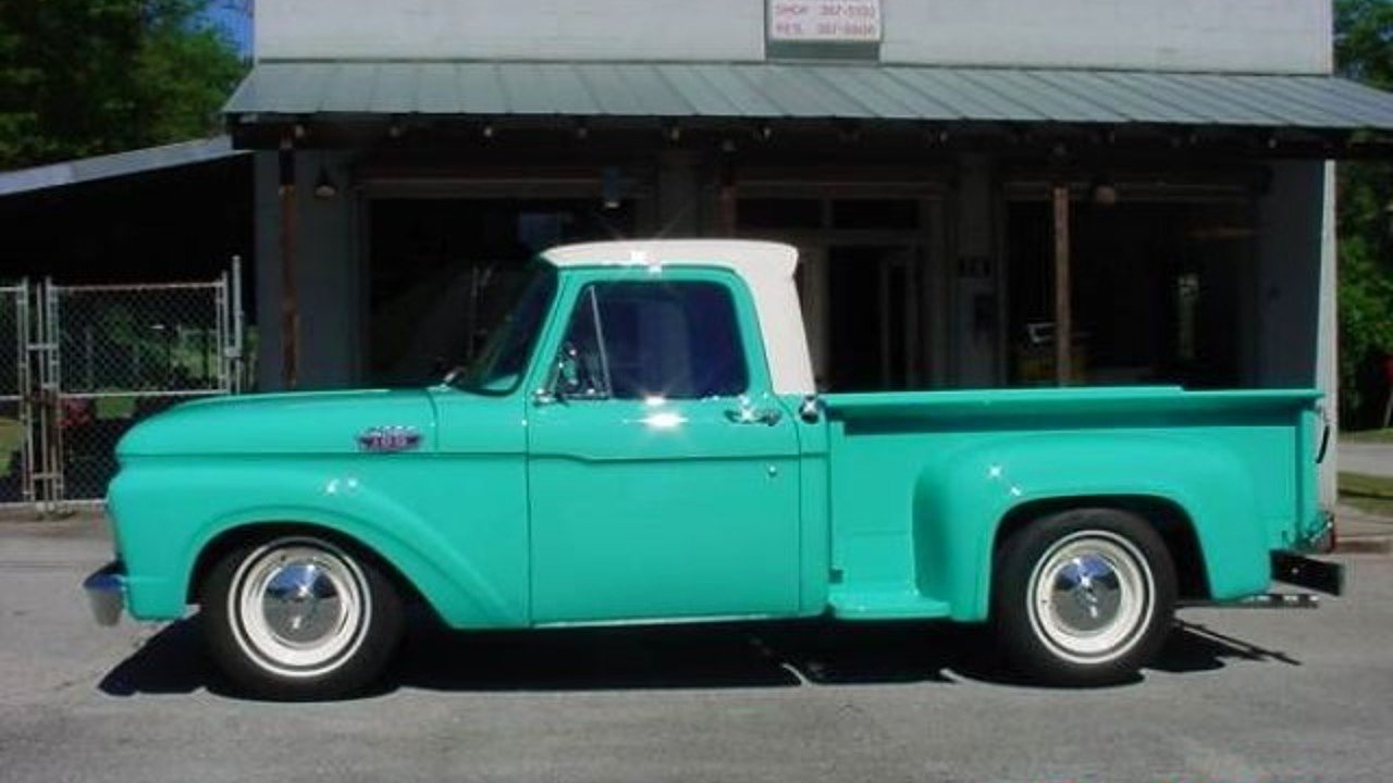

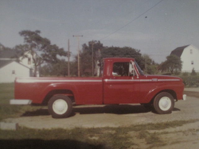

leafsprings Posted March 11, 2018 Posted March 11, 2018 (edited) An AMT 1964 F100 would have been nice back in the day but, obviously would have required a lot of retooling. The '66 is similar bodywise..The '62-'63 styleside can be built combining the Dan models '62 Ford cab or Motor City '63 Ford pickup cab and the bed of the AMT 1960 Ford pickup. All F 350's ( bottom photo 1 ton ) and most 4x4's came with larger cut out front fenders ( the bottom scallop line is cut out of the standard fender). IMO, the AMT '53 Ford is the best donor for a 6' flareside (stepside). Hopefully the 8 and 9 ft Flaresides will become available someday to really add to the variety of build ideas. Edited August 19, 2018 by leafsprings 1

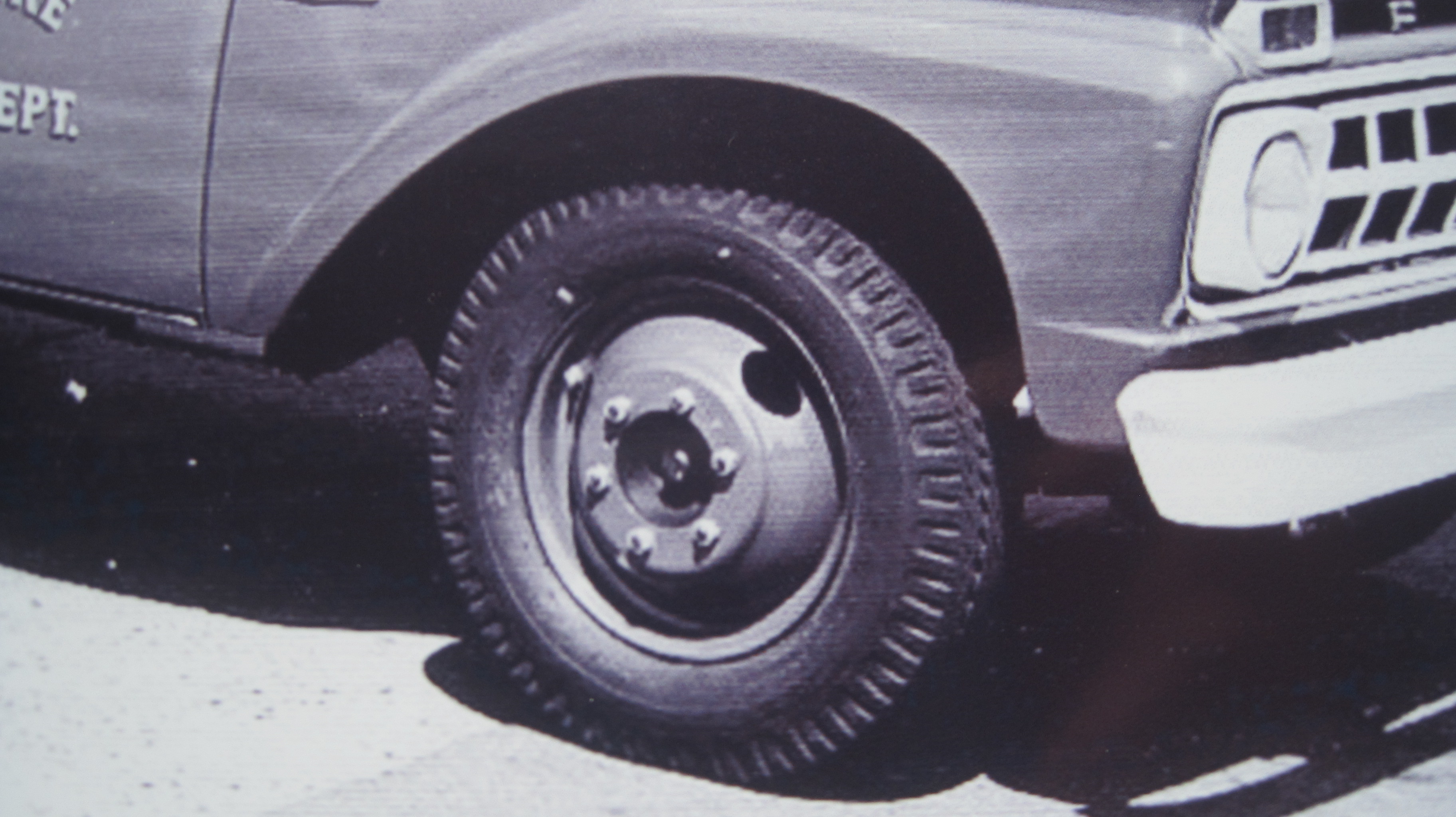

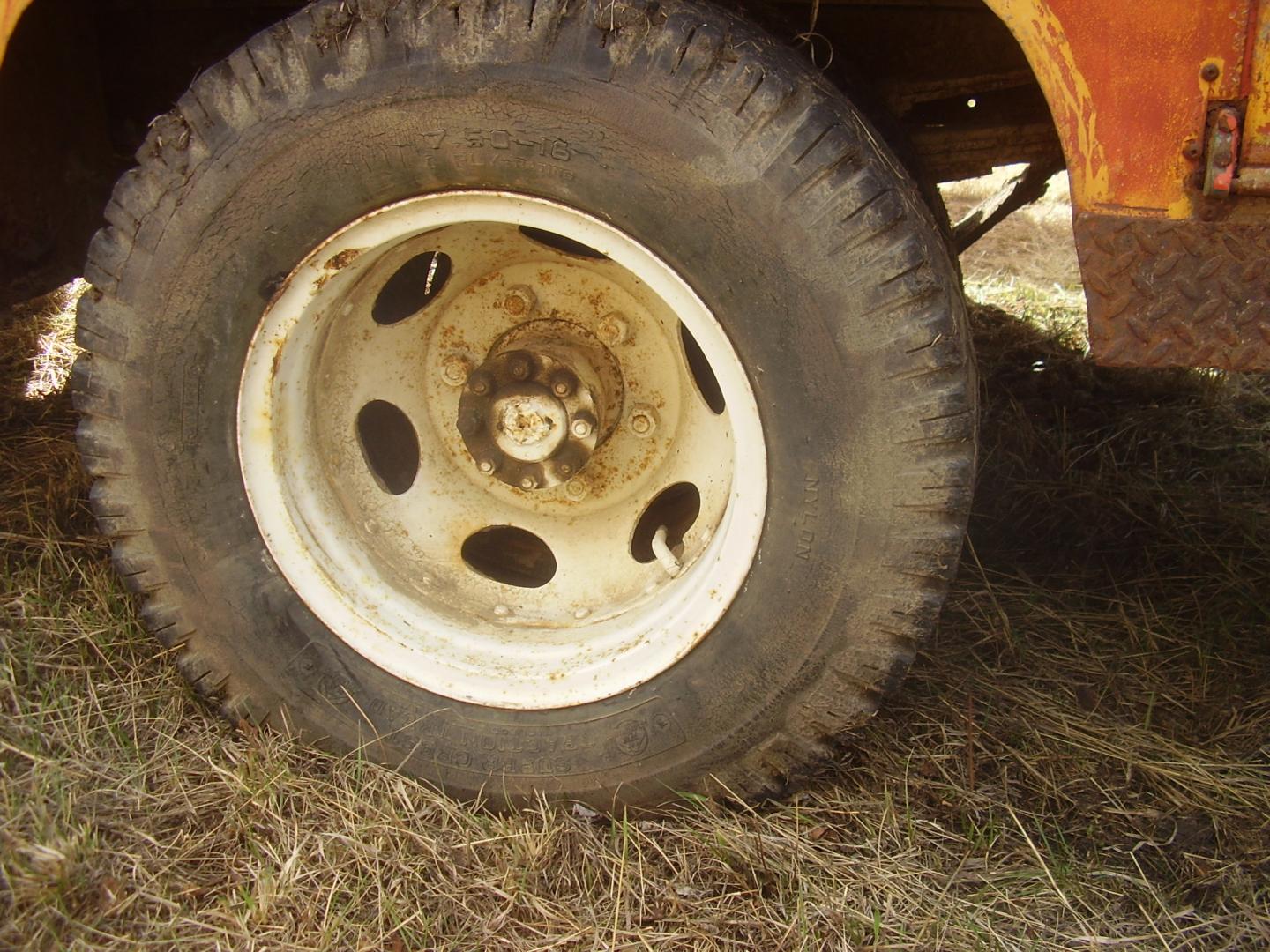

Ace-Garageguy Posted March 11, 2018 Posted March 11, 2018 Anybody know the diameter of those heavy 6-bolt wheels? I see them on a lot of medium duty older Fords.
Day 2 Muscle Posted March 11, 2018 Posted March 11, 2018 1 hour ago, Ace-Garageguy said: Anybody know the diameter of those heavy 6-bolt wheels? I see them on a lot of medium duty older Fords. Well I've seen 16, 16.5, 17 and others. Also in the 62-63 Ford Shop man. F-100 thru F-400 are considered "light duty" trucks.

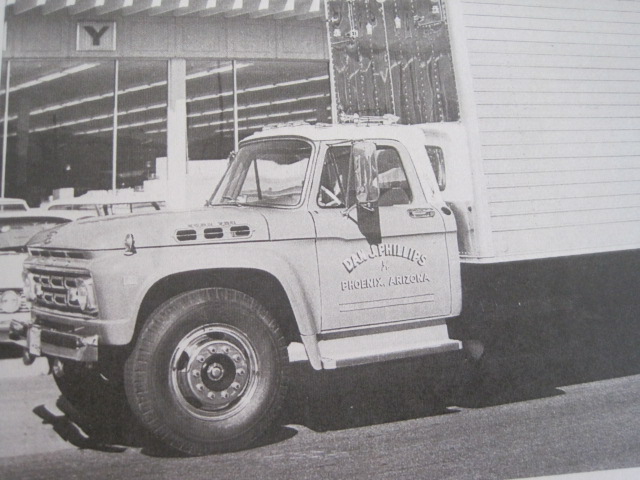

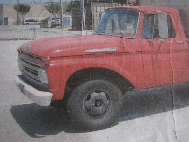

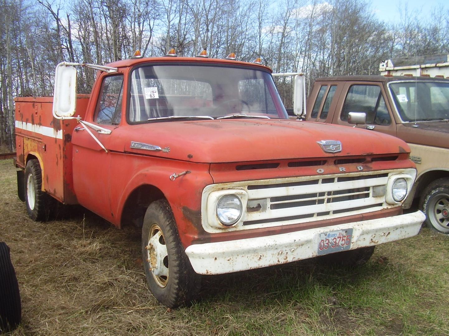

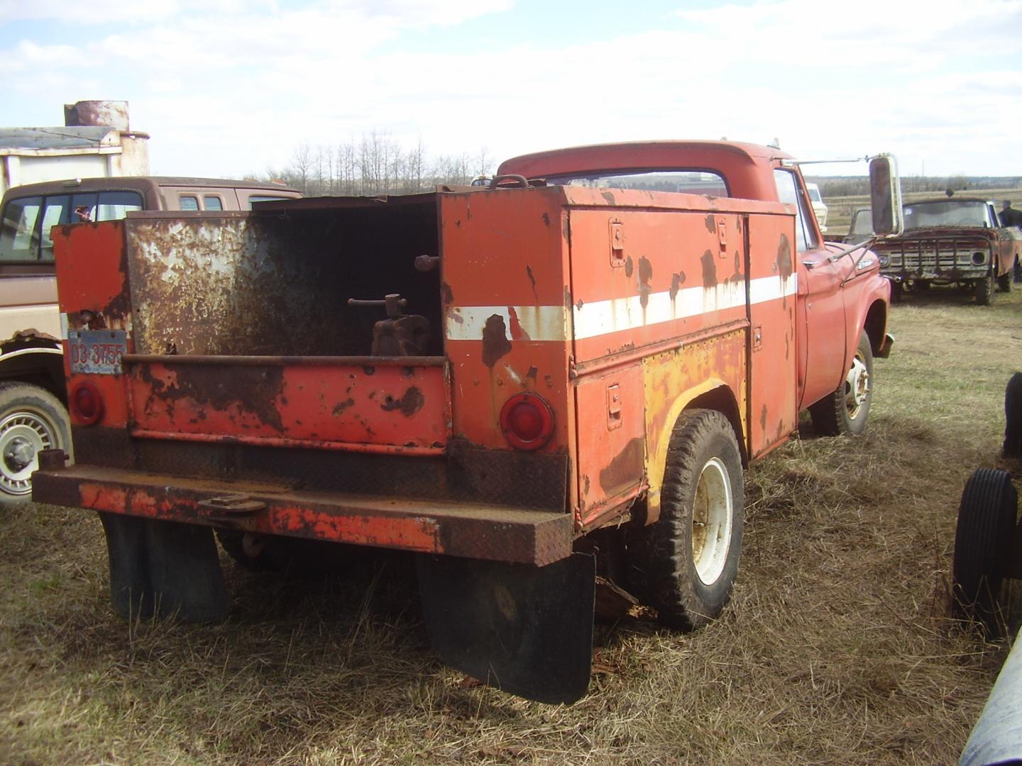

Ace-Garageguy Posted March 11, 2018 Posted March 11, 2018 (edited) 46 minutes ago, Day 2 Muscle said: Anybody know the diameter of those heavy 6-bolt wheels? I see them on a lot of medium duty older Fords. Well I've seen 16, 16.5, 17 and others. Also in the 62-63 Ford Shop man. F-100 thru F-400 are considered "light duty" trucks. 1961 F600 below. I assume this is medium duty? Heavy 6-bolt wheels? I'm not being argumentative. I know very little about real (not pickup) trucks. Just trying to learn what's correct for what. Edited March 11, 2018 by Ace-Garageguy 1
Day 2 Muscle Posted March 11, 2018 Posted March 11, 2018 Don't have any info on the fifties. And like most others, I've always thought the larger trucks were med. duty also, but according to Ford only the 500, 550, 600 were med. duty. Guess its time to do some deep searching .

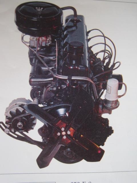

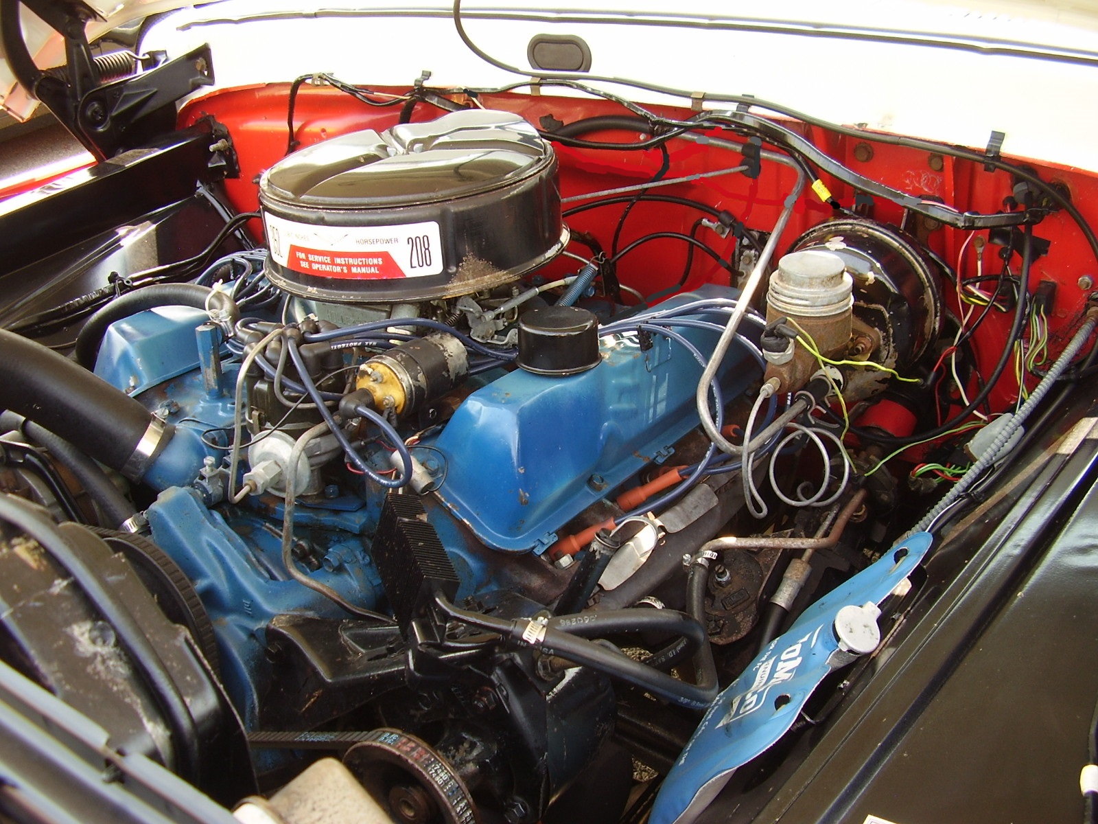

mk11 Posted March 13, 2018 Author Posted March 13, 2018 (edited) Over at http://www.fordification.info/, Keith is busy adding '61-'66 data to the wealth of information on his '67-'79 Ford sites. Brochures, tech info, schematics and all kinds of cool stuff like a page explaining the unibody and interesting evolution in box styles... http://www.fordification.info/tech/wrongbed.htm. Good info like this showing the 4x4 wheel usage- 5 lugs on F100 and eight lugs on F250. The six lug wheels were used only on the F350 and up. '66 352 V8 mike Edited November 13, 2018 by mk11 1

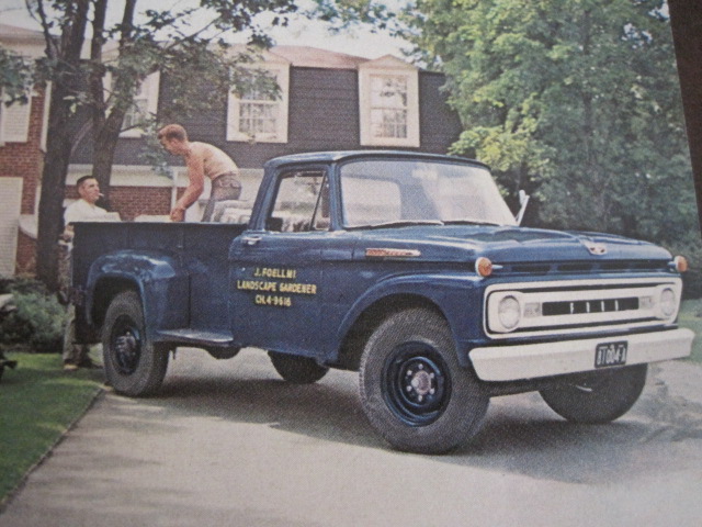

leafsprings Posted March 13, 2018 Posted March 13, 2018 (edited) On 3/11/2018 at 11:17 AM, Ace-Garageguy said: Anybody know the diameter of those heavy 6-bolt wheels? I see them on a lot of medium duty older Fords. This wheel is the most common wheel found on '61-'66 F 350's, its a 2 piece 16". The optional wheel was the solid 17.5". All F 350 came with the 6 lug pattern. Edited September 1, 2018 by leafsprings 1 1
leafsprings Posted March 13, 2018 Posted March 13, 2018 (edited) On 3/11/2018 at 1:11 PM, Ace-Garageguy said: 1961 F600 below. I assume this is medium duty? Heavy 6-bolt wheels? I'm not being argumentative. I know very little about real (not pickup) trucks. Just trying to learn what's correct for what. The F 600 shown is considered a medium duty truck. The beefier end of the medium duty line was the F 700 and F 750 (same sheet metal styling). The most common wheel size on F 600 was 2 piece 20". Optional was the 22.5" solid. The F 750 ( black and white photo) used the common 10 lug Budd or spokes in 10.00-20. Edited August 19, 2018 by leafsprings

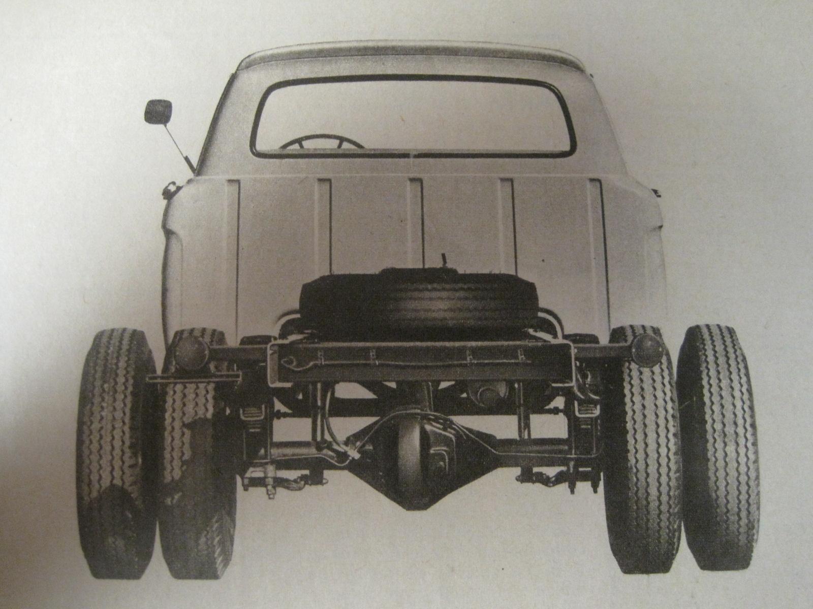

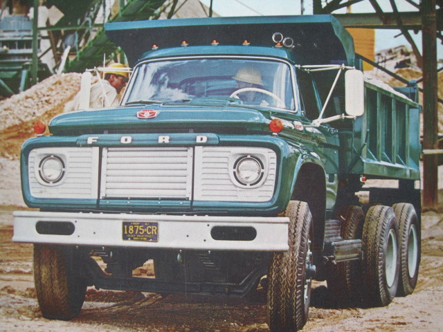

leafsprings Posted March 13, 2018 Posted March 13, 2018 (edited) The heavy duty conventional used the larger front end, but basically the same cab. Dan models offers an excellent heavy duty Ford cab identical to this one. Interestingly the cab styling on the heavy duty trucks continued to the 1969 year model, while the medium duty styling ended in 1966. To get an idea of the weight capacities involved on a heavy duty T 950 below, the max GVW is 62,000 on the straight chassis, a 12, 15 or 18K front axle and 38 or 44K rear axles Edited August 18, 2018 by leafsprings 1
Ace-Garageguy Posted March 13, 2018 Posted March 13, 2018 29 minutes ago, leafsprings said: This wheel is the most common wheel found on '61-'66 F 350's, its a 2 piece 16". The optional wheel was the solid 17.5". All F 350 came with the 6 lug pattern. 24 minutes ago, leafsprings said: The F 600 shown is considered a medium duty truck. The beefier end of the medium duty line was the F 700 and F 750 (same sheet metal styling). The most common wheel size on F 600 was 2 piece 20". Optional was the 22.5" solid. 6 minutes ago, leafsprings said: The heavy duty conventional used the larger front end, but basically the same cab. Dan models offers an excellent heavy duty Ford cab identical to this one. Interestingly the cab styling on the heavy duty trucks continued to the 1969 year model, while the medium duty styling ended in 1966. Thanks, thanks, and thanks. Most helpful.

leafsprings Posted December 22, 2018 Posted December 22, 2018 No that the release date comes closer, a few more reference details are in order. In 1966 Ford standardize engine colors in cars and pickups for all engines Ford Blue. However, before this, engine colors were different depending on engine. In 1965, the 352 V8 in pickups was all black except for gold valve covers and the 240-300 6 from my research was all black. 1

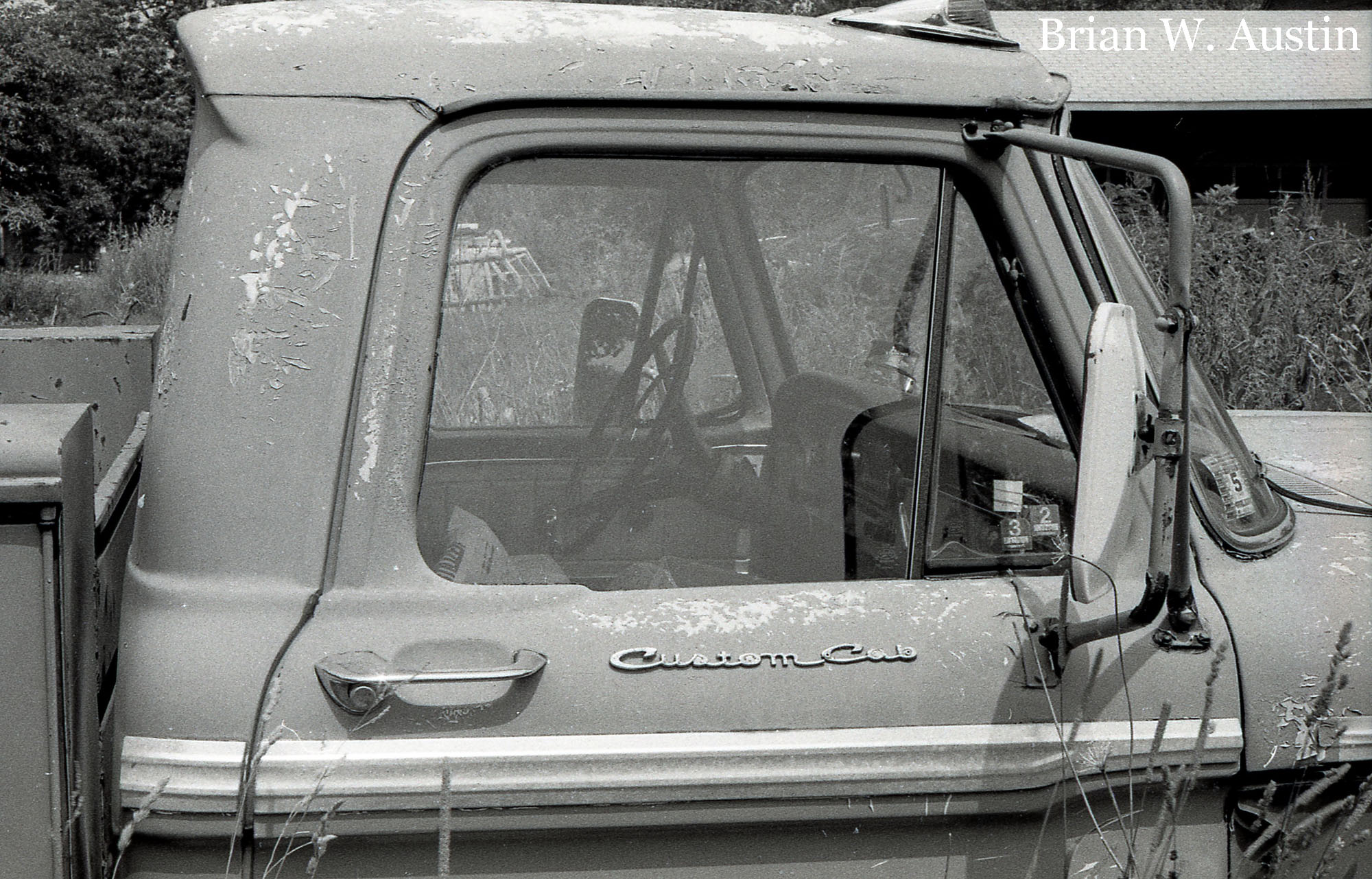

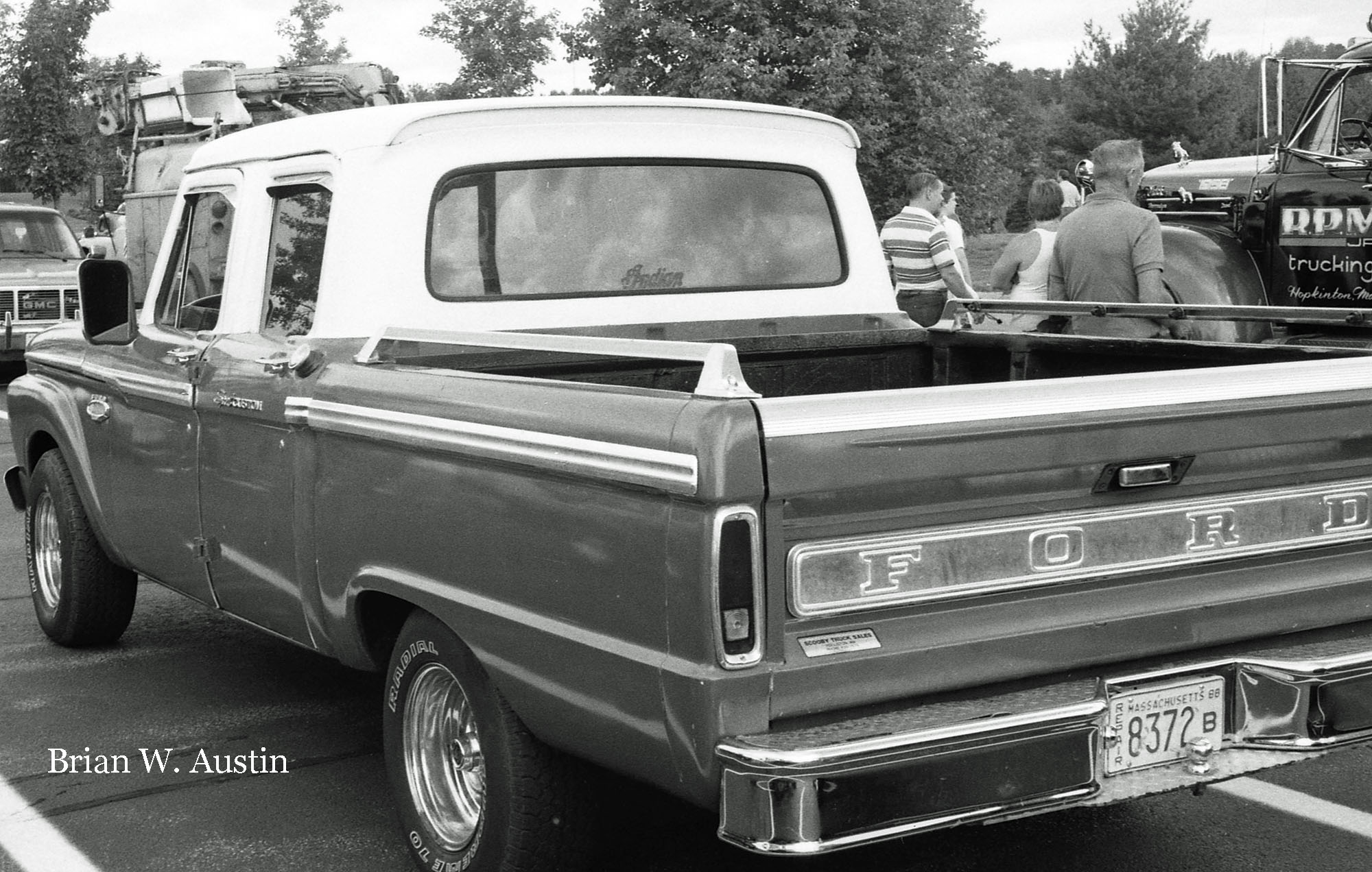

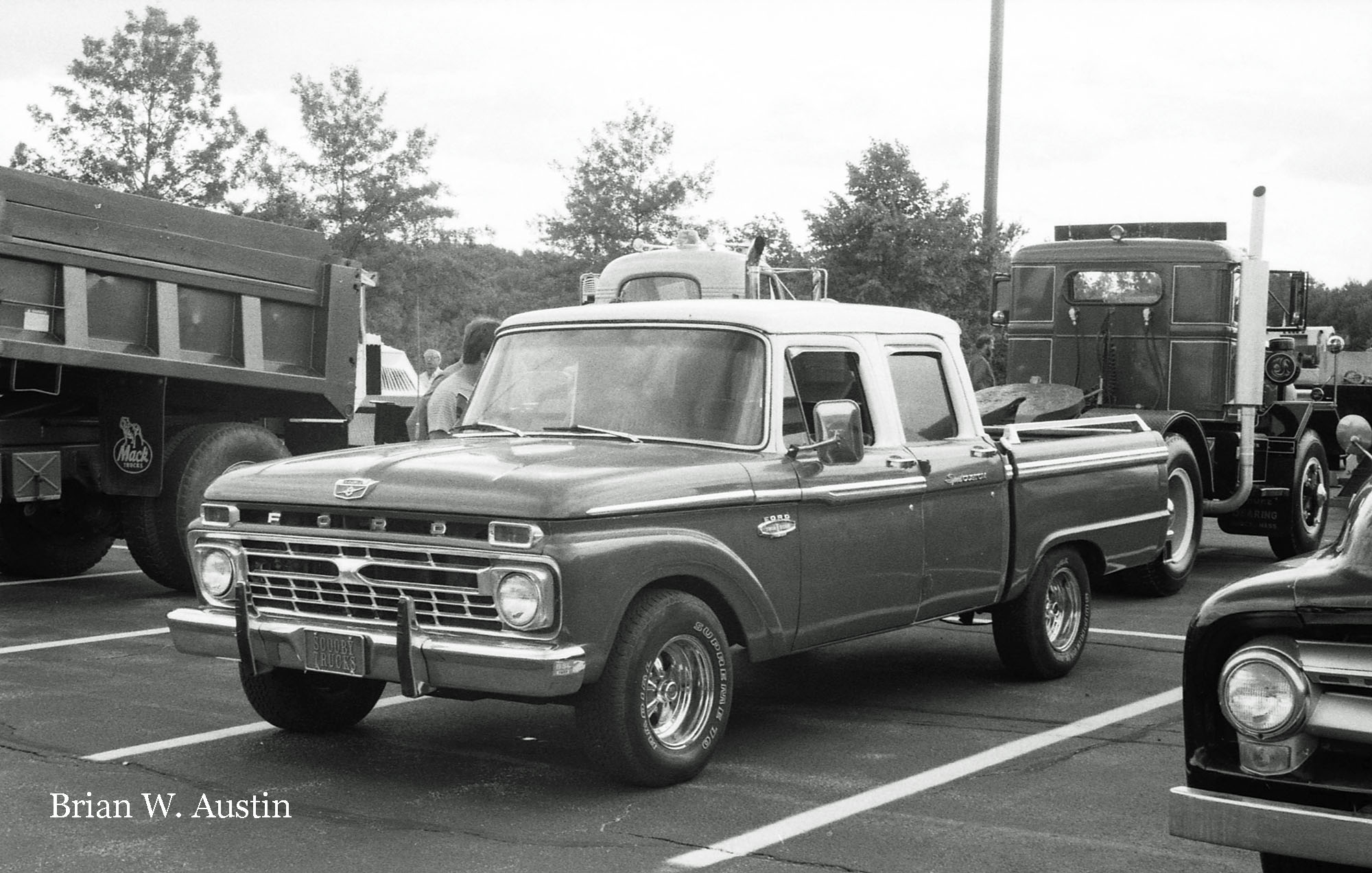

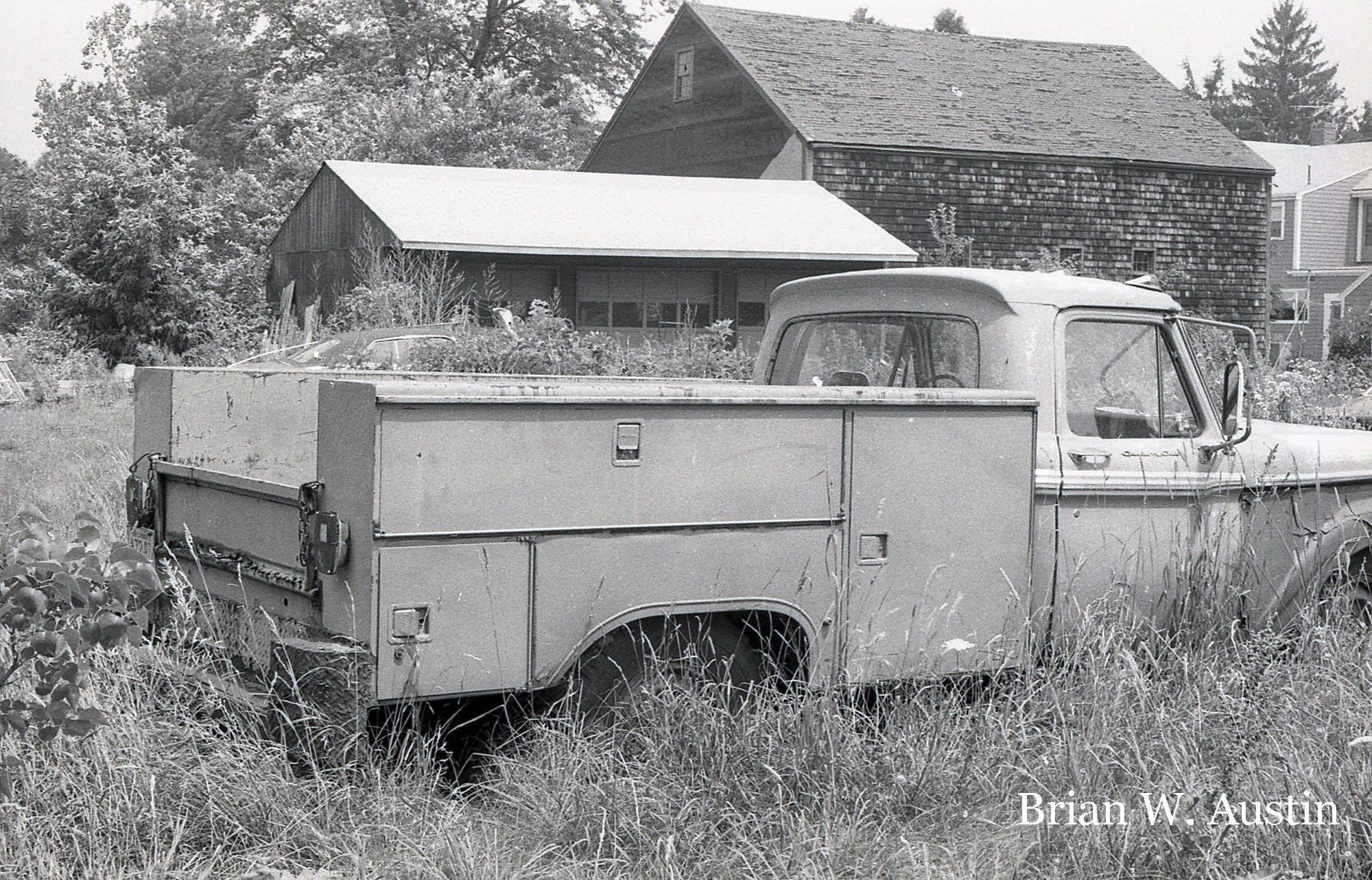

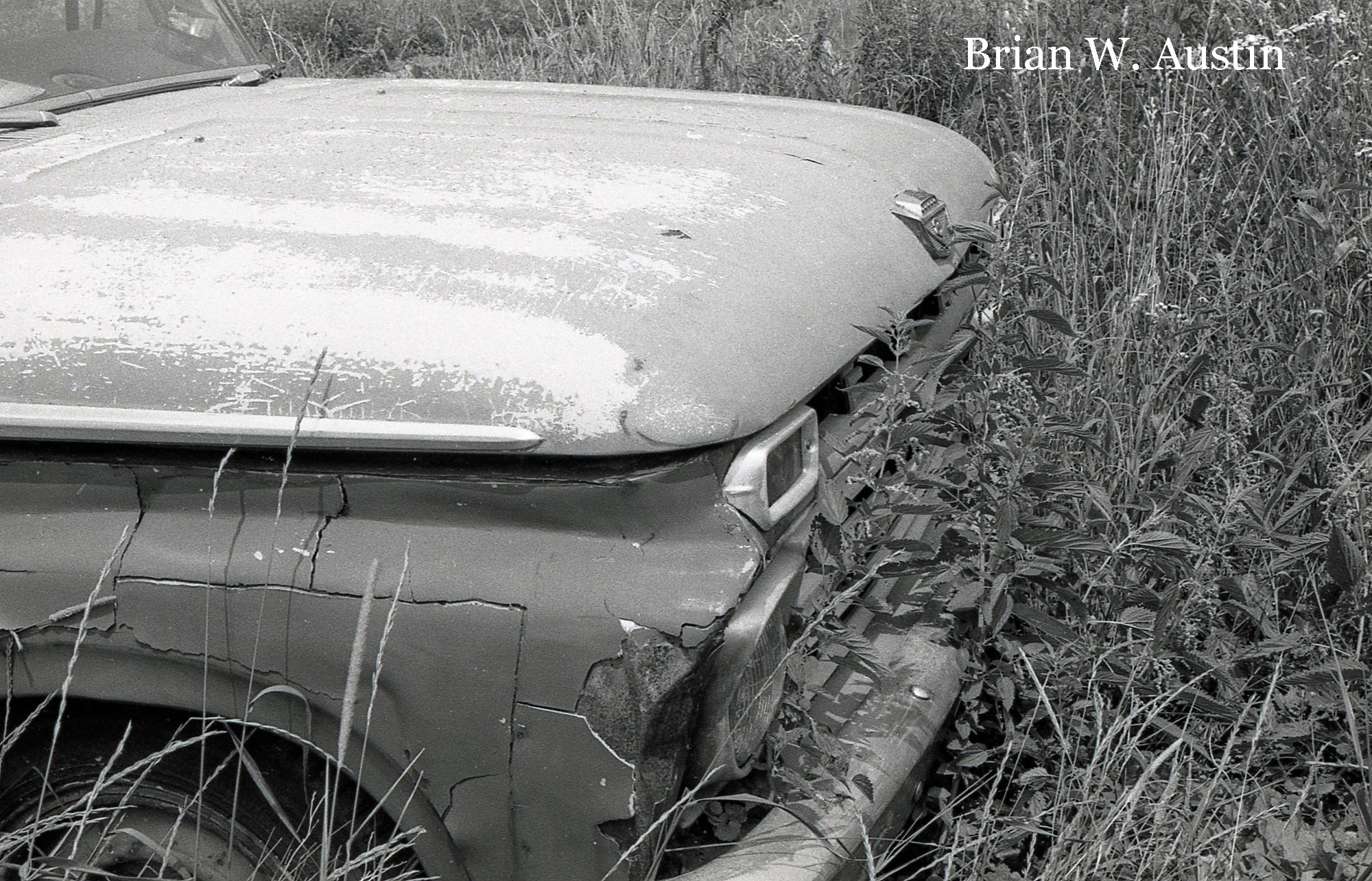

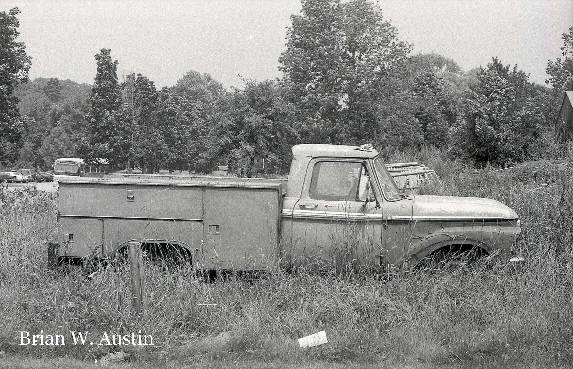

Brian Austin Posted June 4, 2019 Posted June 4, 2019 Australian Ambulance http://automotoclassicsale.com/node/2821 Here's another, in better shape: 1
mk11 Posted June 6, 2019 Author Posted June 6, 2019 Very interesting, Brian. Looks like some kind of a unibody conversion with regular cab doors.

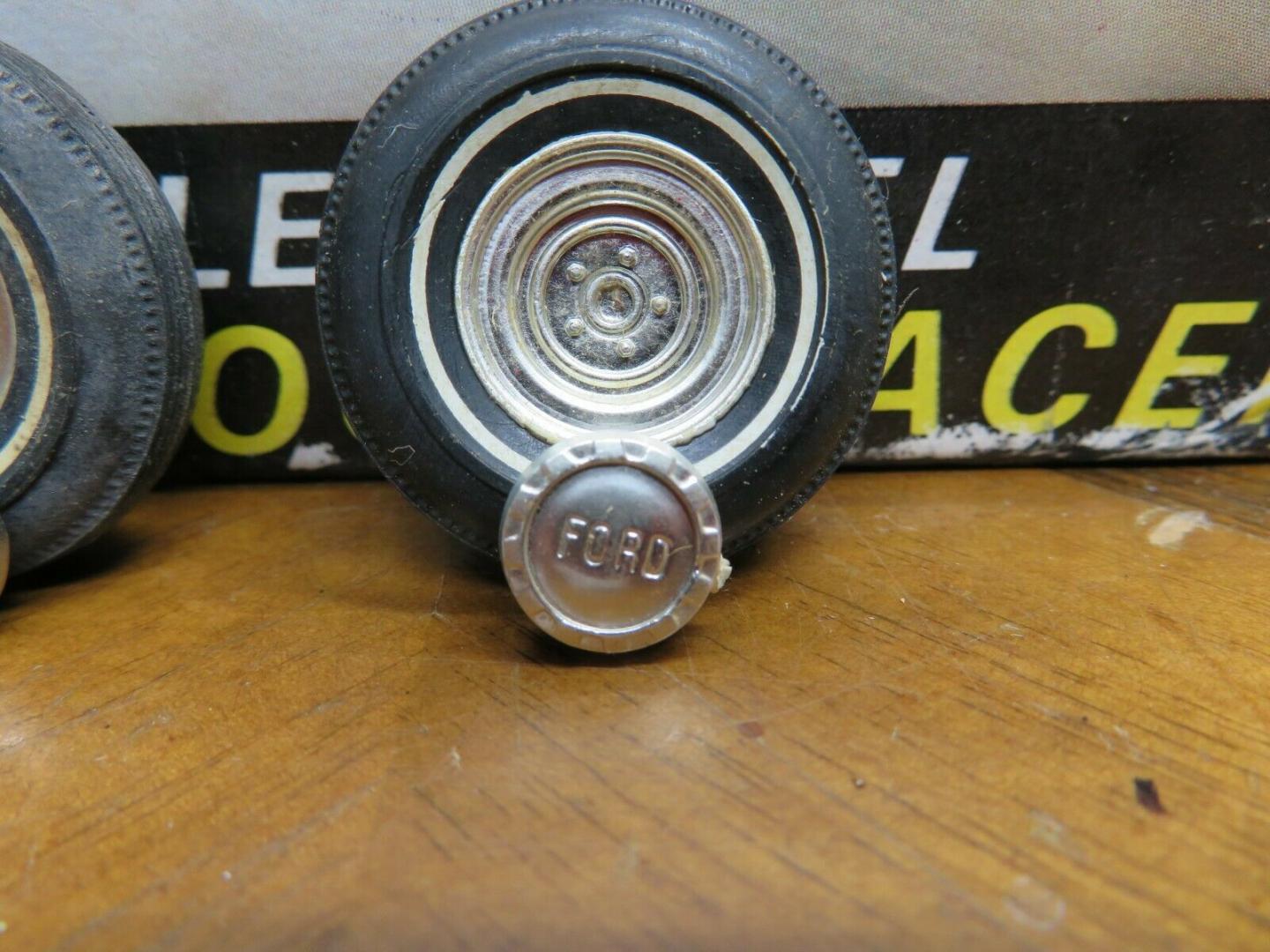

mk11 Posted July 8, 2019 Author Posted July 8, 2019 (edited) I'm told these hubcaps came in the '63 amt kit. Hope someone picks these up in resin... Edited July 8, 2019 by mk11 1
