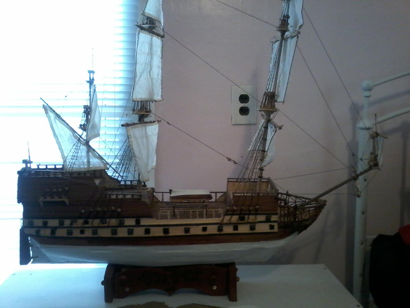

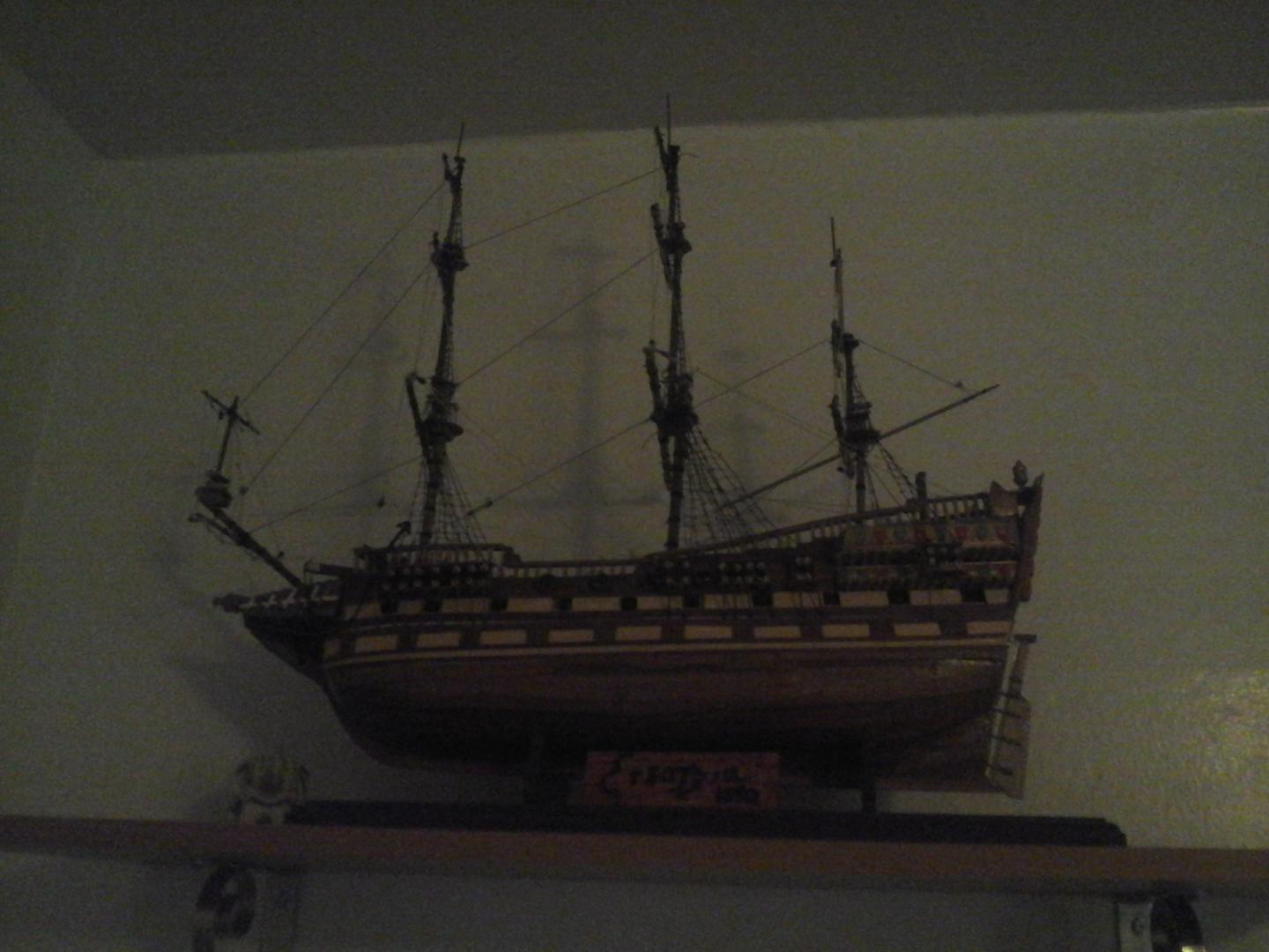

philo426 Posted March 18, 2018 Posted March 18, 2018 Yes they can be a challenge abd require a lot of man hours to complete but the results are well worth it!
cobraman Posted March 20, 2018 Author Posted March 20, 2018 Yours looks good. Not sure I want to tackle one that complex for my first build.

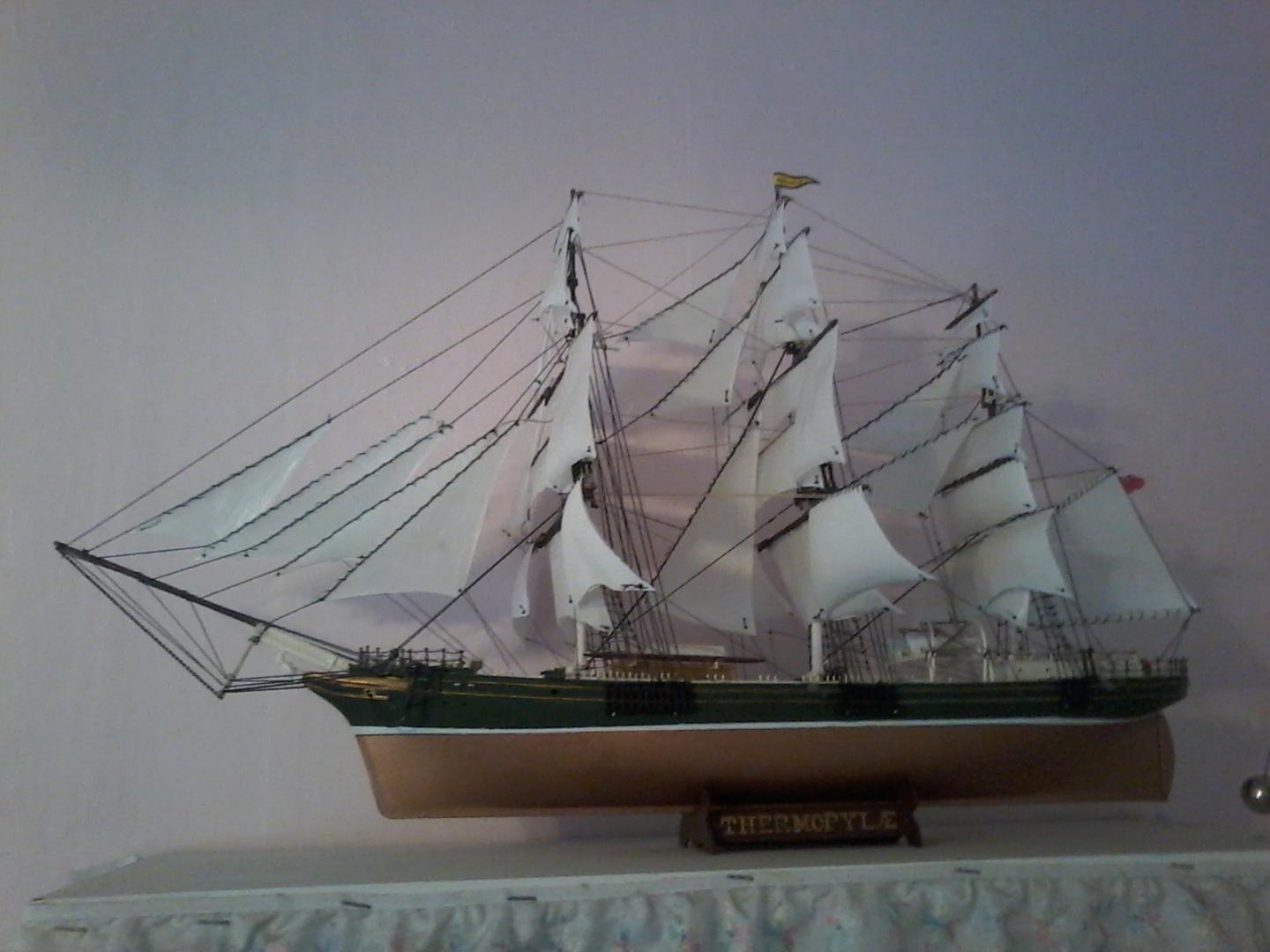

philo426 Posted March 20, 2018 Posted March 20, 2018 If you want to try pladtic,this Revell Thermopylae is nice!

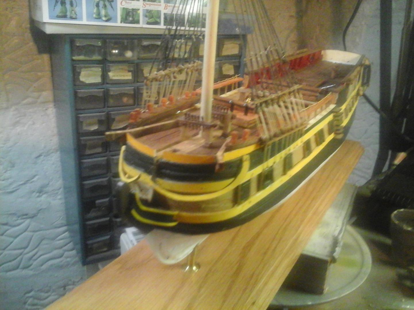

philo426 Posted March 22, 2018 Posted March 22, 2018 I soak the ends of the planks in water for a few hours and then bend the planks around a stain can with mini clamps and allow themto dry.Works well even for a bluff bow like this one which is a fairly extreme bend.
