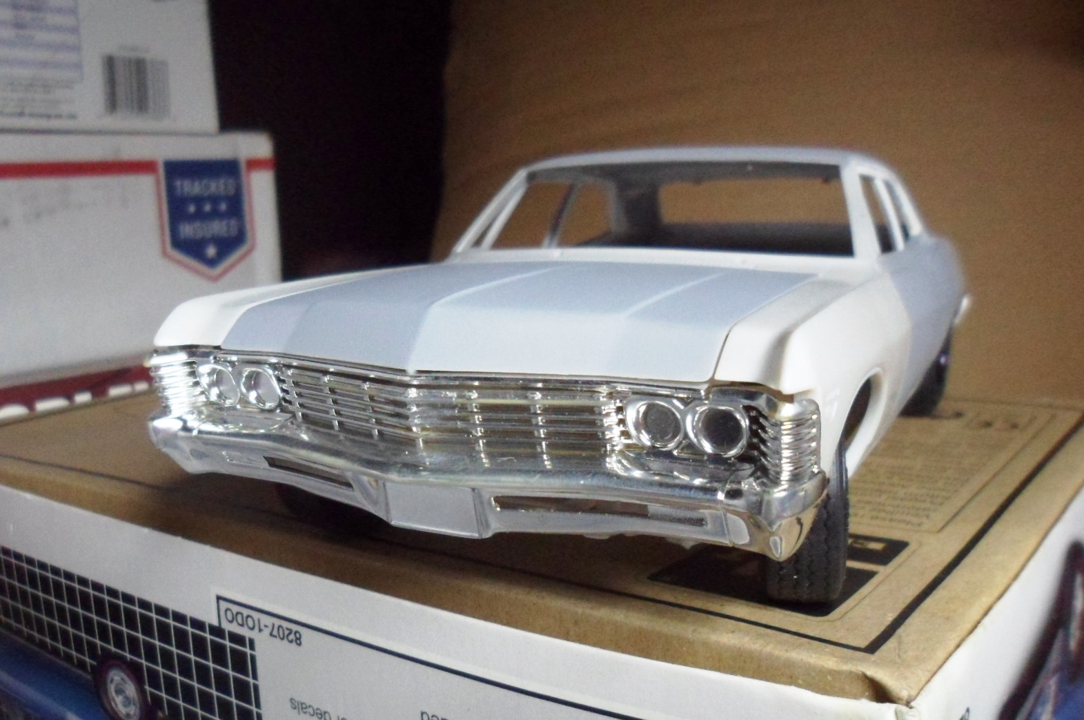

This takes a bit of doing in that whilst the donor kit is readily available in the 67 Impala SS, it is a fastback and only a 2door to boot.  The basic wheelbases are the same between 2-4drs but there is different sheet metal work and termination points on the door tops. The original kit had a very long sloped roof out to the end of the trunk.  A conventional "C" pillar had to constructed along with lowering the trunk deck height to sedan like levels.   More pics to come but this is the start..
The first pic is from the kit box showing the car's SS (SuperSloping) fastback roofline.  That had to go and a  new sedan conventional C-pillar built. Yes, it was a PITA.:blink:

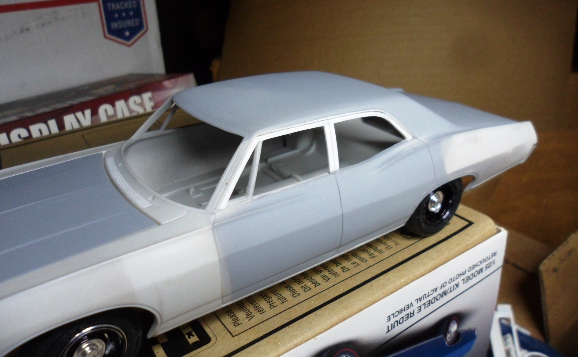

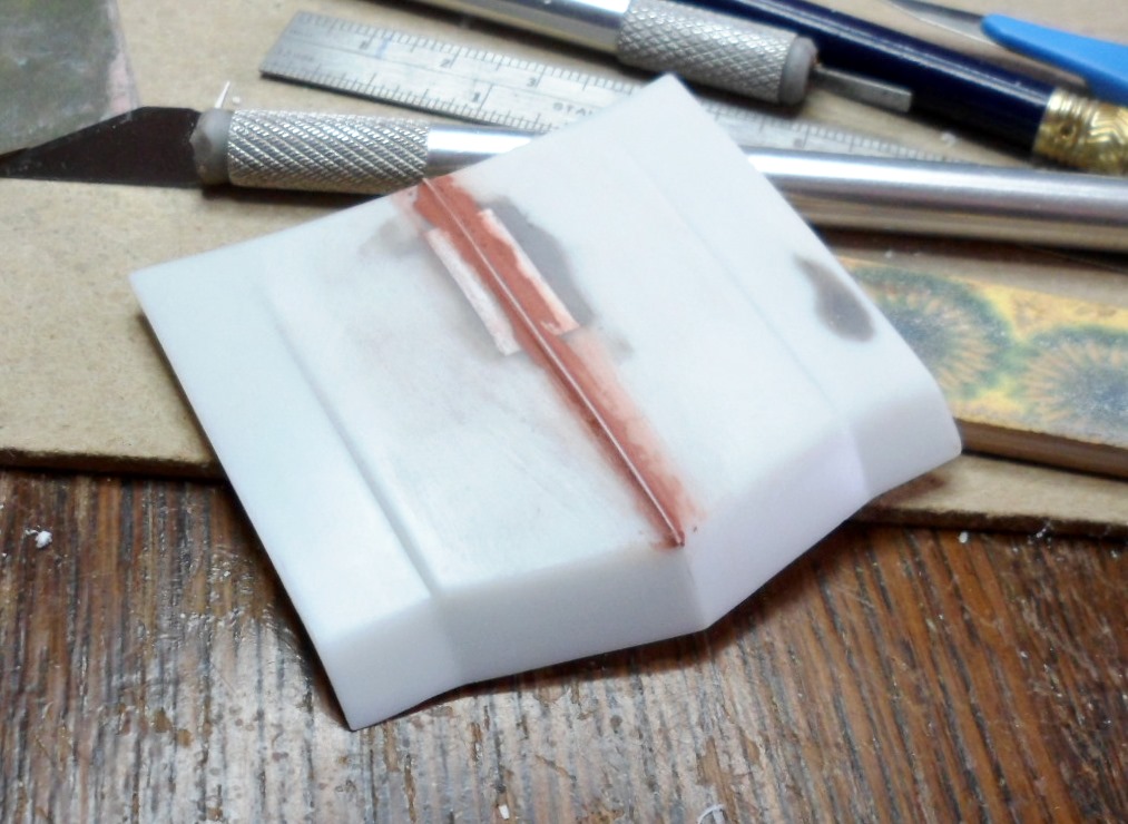

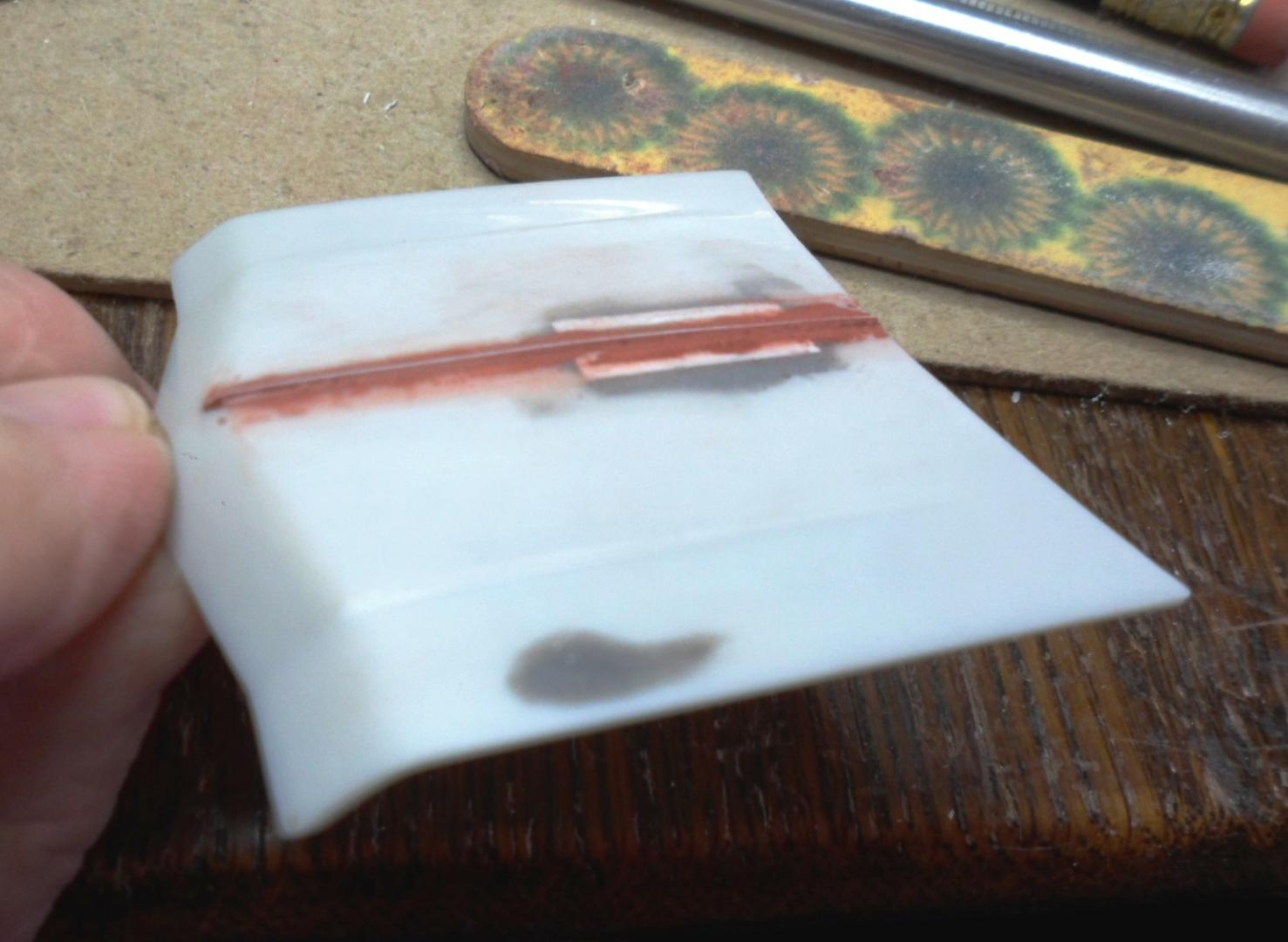

Notice the tops of the doors had to be raised up level to match a new flatter upper roof dripline.  A lot of conversions I have seen have left that precipitous drop in door level of the 2dr and just moved on. One was on a STATION WAGON.  Anyway, you can see the styrene addition below in white at door tops.

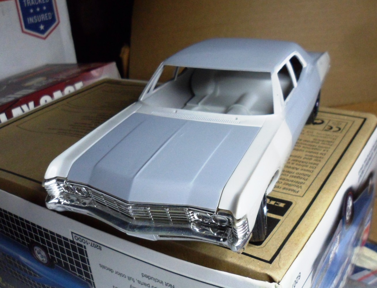

Filling it in..

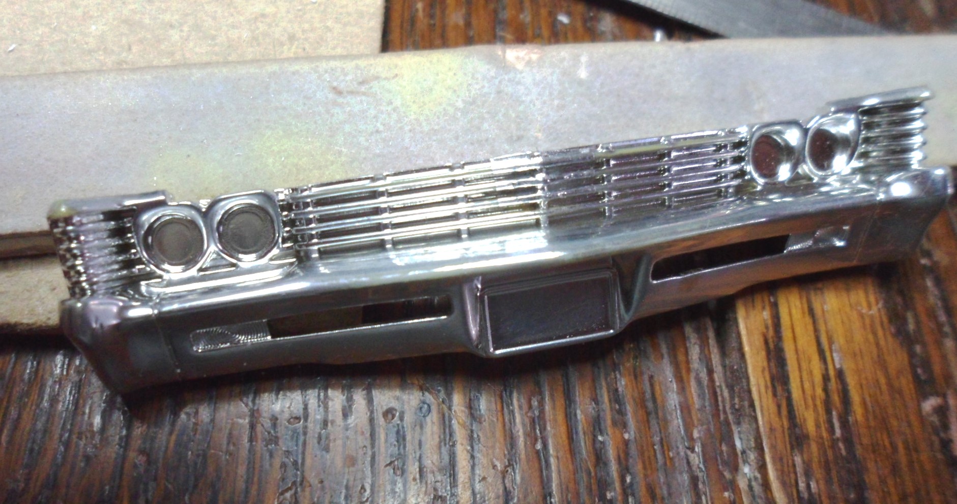

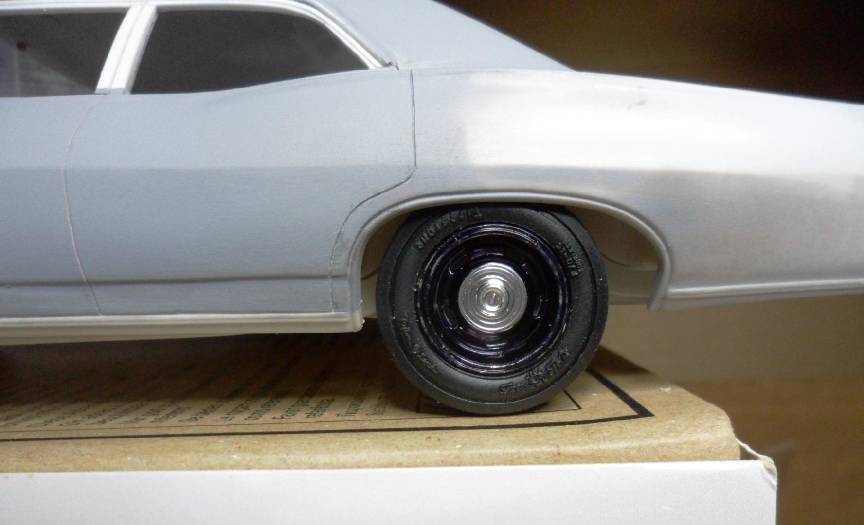

Since I am not too hot at captioning the pics as they go I will just say that the following pics show the progression as such: Grille modified from a 'SS 427" center badge to a plain Biscayne grille by carefully removing plastic and leaving to proper amounts in place to show the proper grille lines. The bare plastic was then covered with a small piece of BMF to get it match for the time being the rest of the chrome.  Then the hood had to be modified from the big SS bumped up one with louvers to a simple hood with a centerline crest.  And finally, I placed it all together for a look-see, and put it's feet on after I ground out the backs to open up the rally 5-slot wheels.
Here we go.  Welcome to my world. Please keep your hands inside the car at all times. :P

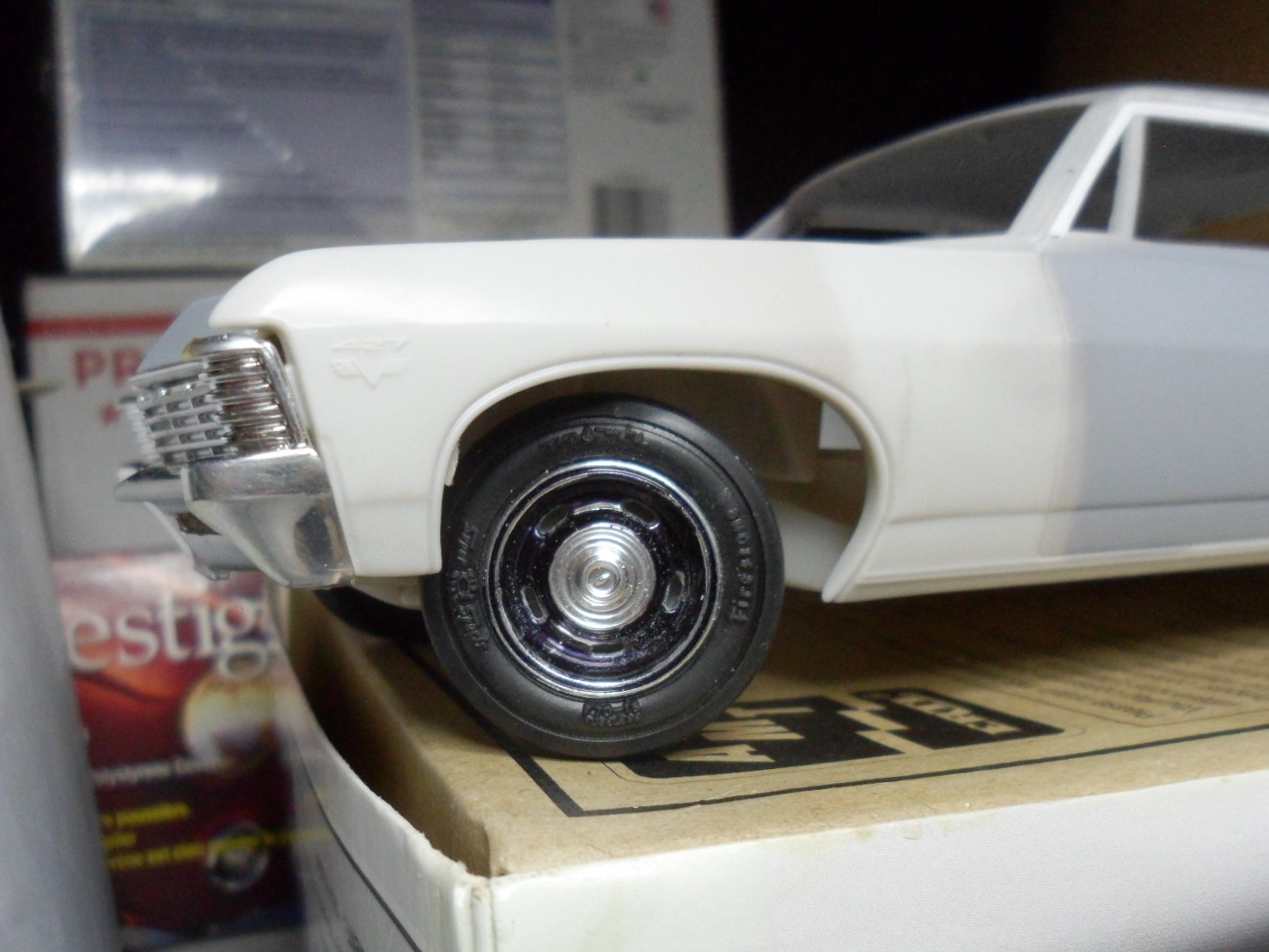

Great looking work on the Grill and Hood. Your door lines look perfect. Very impressive conversion on this body.
Thanks guys!  I just noticed I haven't installed the door handles.  I built them last night and they will install tonight.  also need a door RV Mirror.
