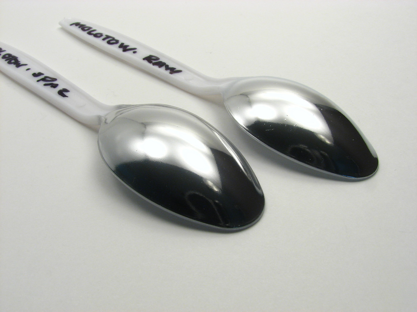

Zoom Zoom Posted March 18, 2018 Posted March 18, 2018 Molotow is so good I'll never use Alclad or Spaz Stix chromes ever again; Alclad black chrome is excellent though. Molotow airbrushed in wet coats, allowed to dry for a day or two, coated by Spaz Stix ultimate clear coat is pretty awesome. It's not as "perfect" as plated chrome, but still a huge improvement over the old standards. And plated chrome often looks too shiny. See for yourself; Molotow sprayed w/o clear, and Molotow sprayed w/a protective coat of Spaz Stix Ultimate Clear:
