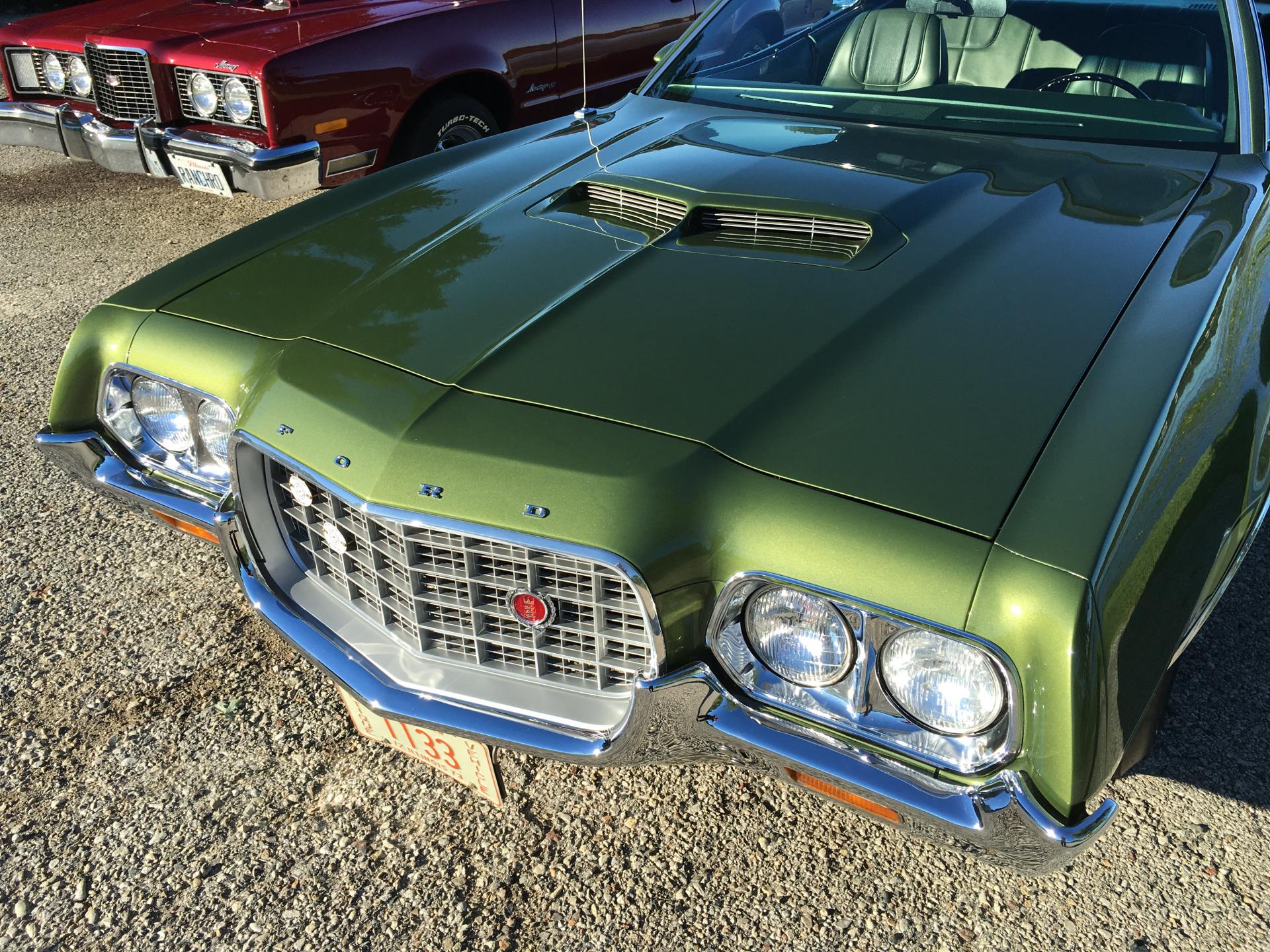

Oldcarfan27 Posted April 3, 2018 Posted April 3, 2018 Ok, so rumaging through my stash I found a perfect unused Johan 72 Torino race car body. This is a completely stock Gran Torino Sport fastback body with all the trim, door handles, side markers etc. I want to bash this body with the chassis and interior of a Starsky and Hutch kit, which fit almost perfectly. Here's my dilemma... The hood from the Johan kit does not include the G.T.S. scoops on it. Anybody have any ideas where to find something that I can use for it? I thought about the scoop from a 71 Torino GT, but that's not really close enough. The 72 parts are green in these photos. I also found out the interior door panels of the 72 Gran Torino Sport fastback are different than the standard door panels of the notchback Torino. Any ideas what I can use to duplicate these? The rest of the Starsky and Hutch kit should work for my needs. Because this body is undamaged, I don't want to cut it up to match the standard hood and door panels. Although if I can ever come across another complete 72 body I'd like to make a standard notchback someday. Or, does anybody have an old Johan snap kit Gran Torino Sport hood and interior they can spare? Thanks for any help you can give me.

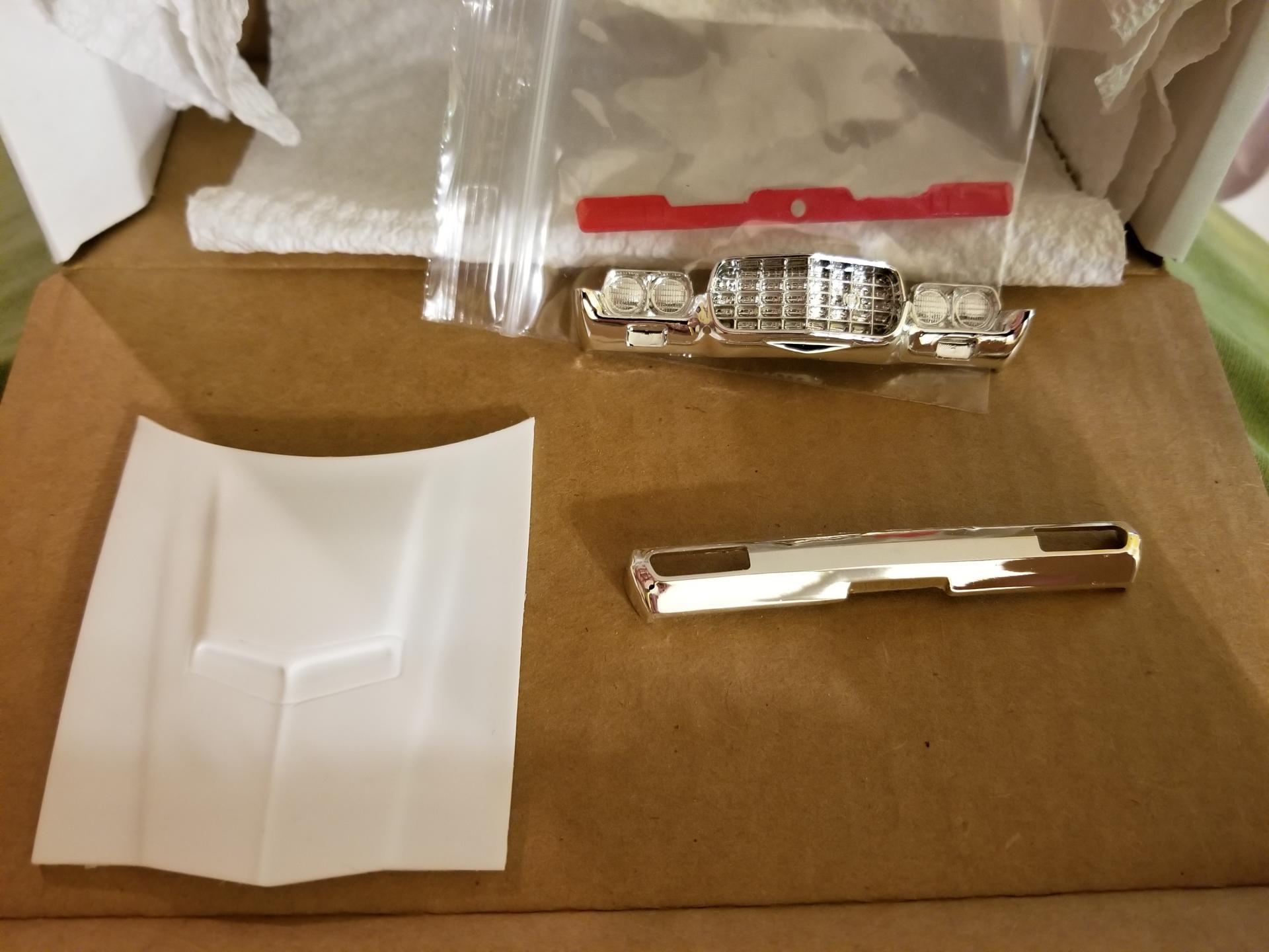

Fat Brian Posted June 5, 2018 Posted June 5, 2018 On 4/3/2018 at 10:55 PM, Oldcarfan27 said: Thanks for the tip, guys. I'll give them a call. I just my stuff in and wanted to show you what it looks like.
Can-Con Posted June 5, 2018 Posted June 5, 2018 They look good. I have a couple kits from them so I'm not surprised though. Nice to see the plating being available too.
Fat Brian Posted June 6, 2018 Posted June 6, 2018 2 hours ago, Can-Con said: They look good. I have a couple kits from them so I'm not surprised though. Nice to see the plating being available too. Yeah, and I didn't even ask for it, they just came that way. For $4 I expected bare resin and got plated, I couldn't be happier.
