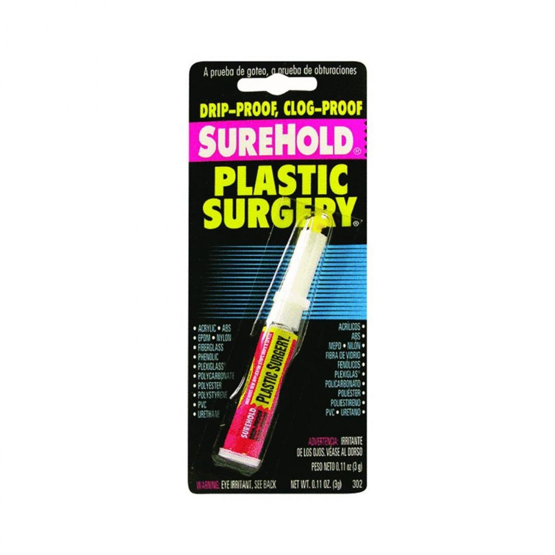

crowe-t Posted April 4, 2018 Author Posted April 4, 2018 I have Surehold Plastic Surgery Super Glue. Ir works on most plastic including acrylic. It might be too brittle like most CA glue and fog the clear acrylic. I can tape over the acrylic which should protect it from the vapor as it's curing.
Art Anderson Posted April 7, 2018 Posted April 7, 2018 (edited) On 4/4/2018 at 12:18 PM, crowe-t said: I was thinking the same thing. Super Glue will most likely fog the clear rod. NOT if you get, and use the excellent CA glue accelerator from Bob Smith Models (available in most hobby shop RC departments, as well as online from Bob Smith Models, and Great Planes or Horizon Hobby). The big plus? This stuff has no adverse reaction to raw styrene, nor any sort of paint I've ever used on a model project. Art Edited April 7, 2018 by Art Anderson
crowe-t Posted April 10, 2018 Author Posted April 10, 2018 I found this stuff from Bob Smith Industries. It's odorless CA. I contacted them and they said it works on clear acrylic, clear acetate and clear styrene and won't fog them. http://www.bsi-inc.com/hardware/super_gold_plus.html
