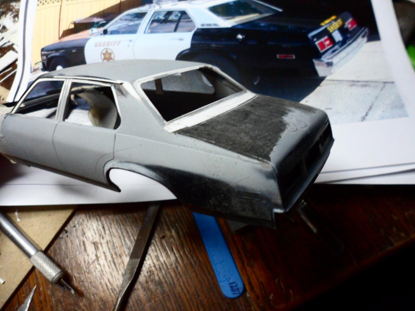

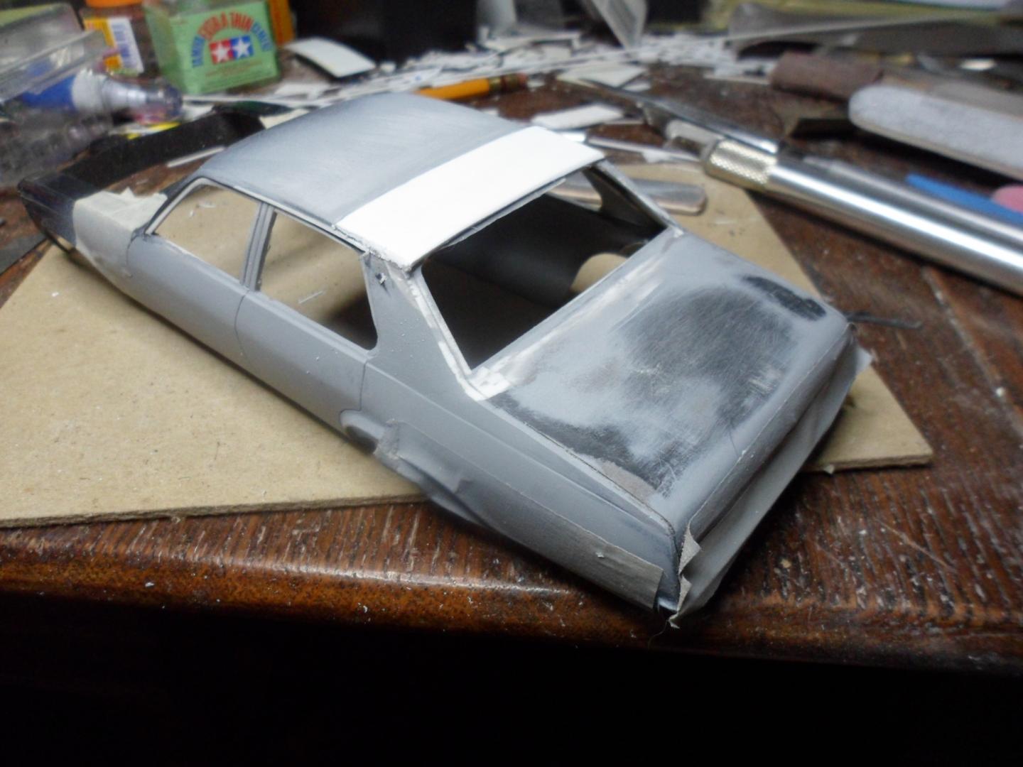

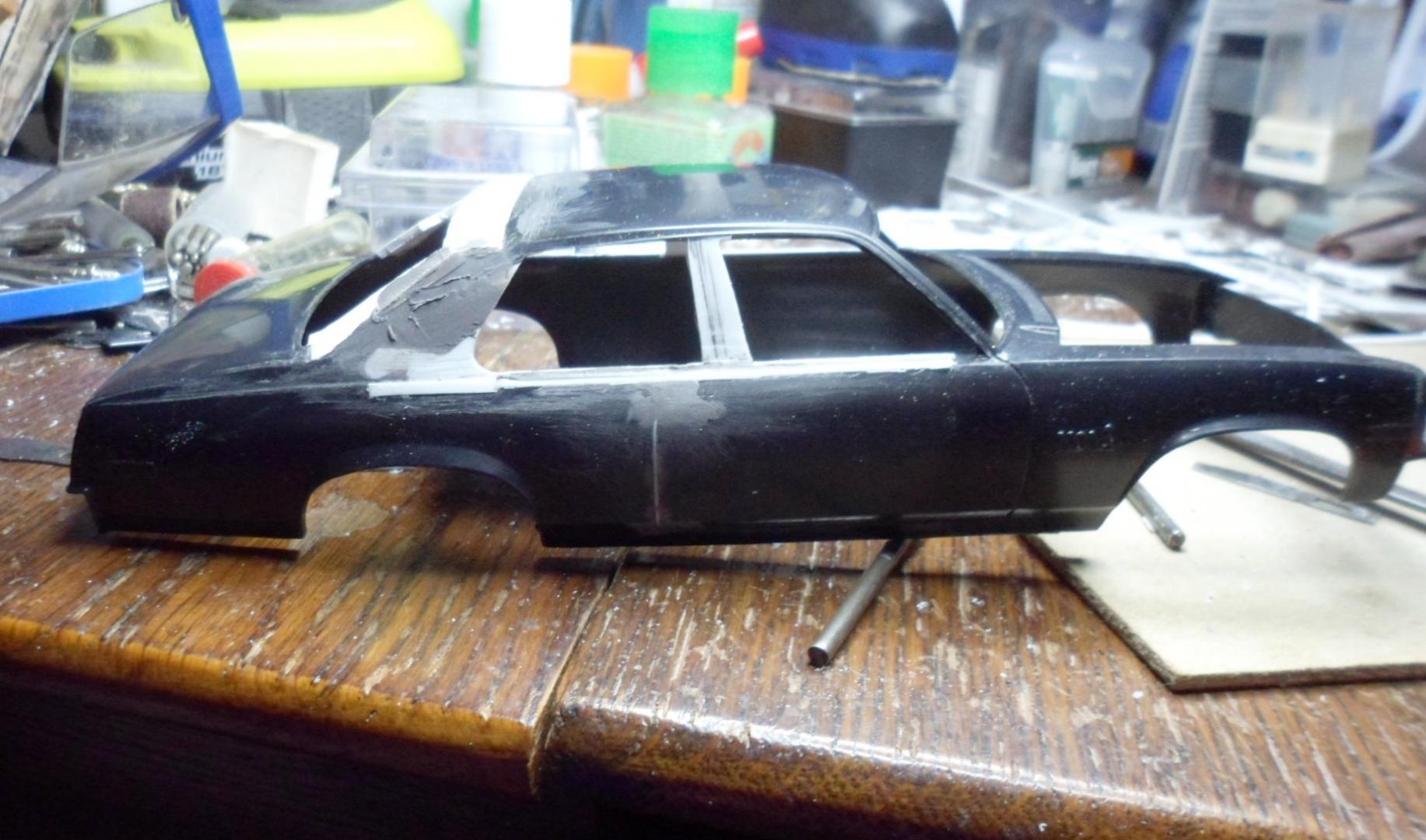

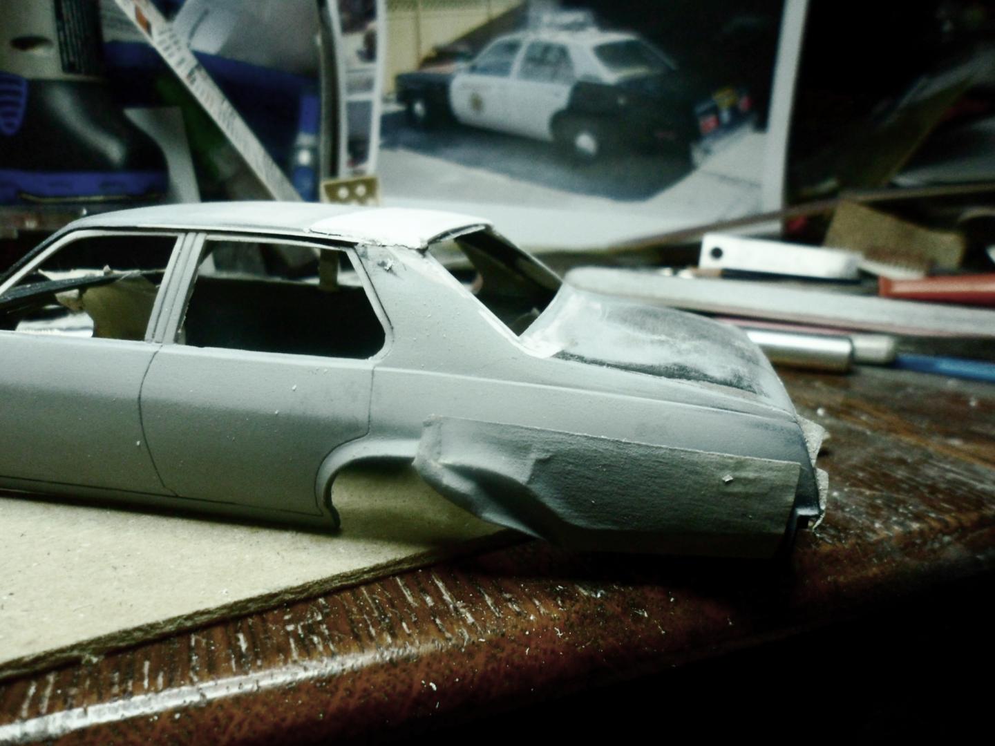

DEL Posted April 5, 2018 Posted April 5, 2018 This is a nice little subject that is very popular with the 1:1 police collectors/restorers. The ready availability of the MPC Squad Rod along with my fervent desire to do anything 1) POLICE, 2) 4dr and last but not least 3) 1970's brought me to this one pretty quick. Most of what one needs is there but as always one must spend quite a while removing the styrene kit builders equivalent of a heroin addiction to fastback roof lines on dang near every kit out there and fashioning in a more dignified and authoritative 4dr c-Pillar. Plus a natural sedan trunk lid surface. In its current incarnation with me, it's almost done. And only about 2 & a half months on it too! (of course there are three others on the bench right now too) Am I getting faster? Personally, I sure hope so as long as the end result does not suffer. There was some tedious re-aligning of the door tops from sloping downward 2dr ones to almost squared off 4dr ones. plus you must add the Impala/Caprice body accent welt line from the top edge of the rear door across and down the rear quarter panels. it is VERY faint in this scale and takes a bit of doing. Please have a look, and thanks for stopping by! Phase 1:

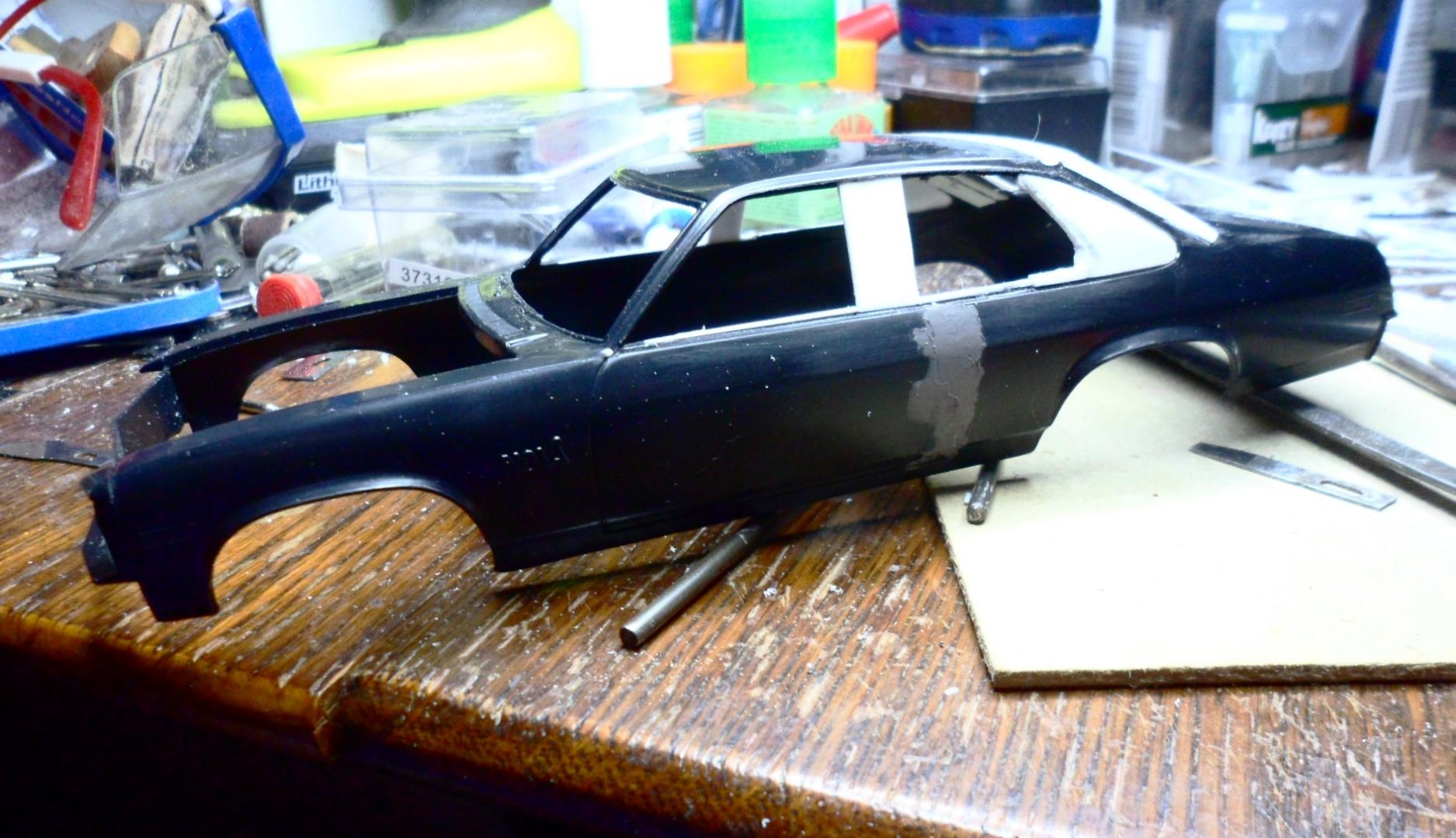

DEL Posted April 5, 2018 Author Posted April 5, 2018 Phase 2 - Closer detail work and fabrication of cabin ventilation grates for the C-pillar..

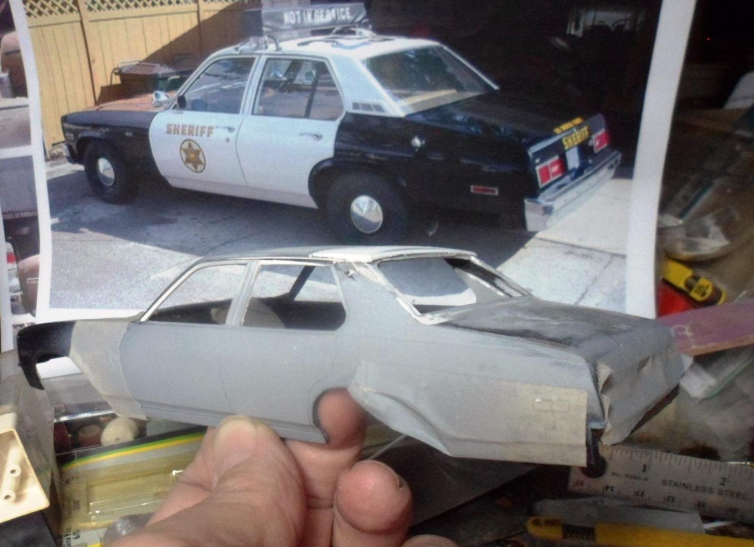

DEL Posted April 5, 2018 Author Posted April 5, 2018 And finally, where I am at this point. Just need to do some teilawork around the doors, add a rocker & drip moldings along with trunk line details and it will be almost done. Well, I have to modify the interior tub then the proper wheels & caps and DUNN!

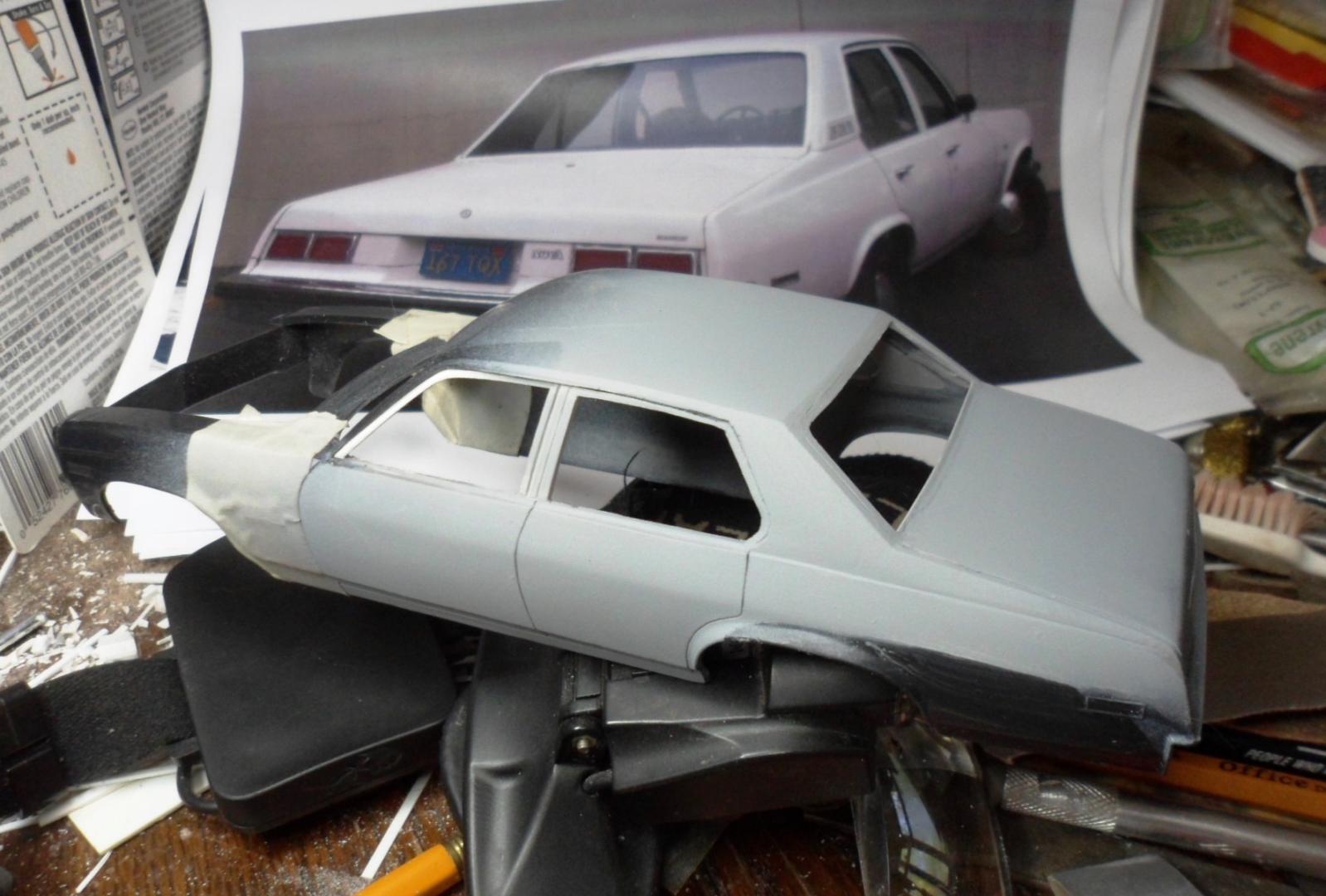

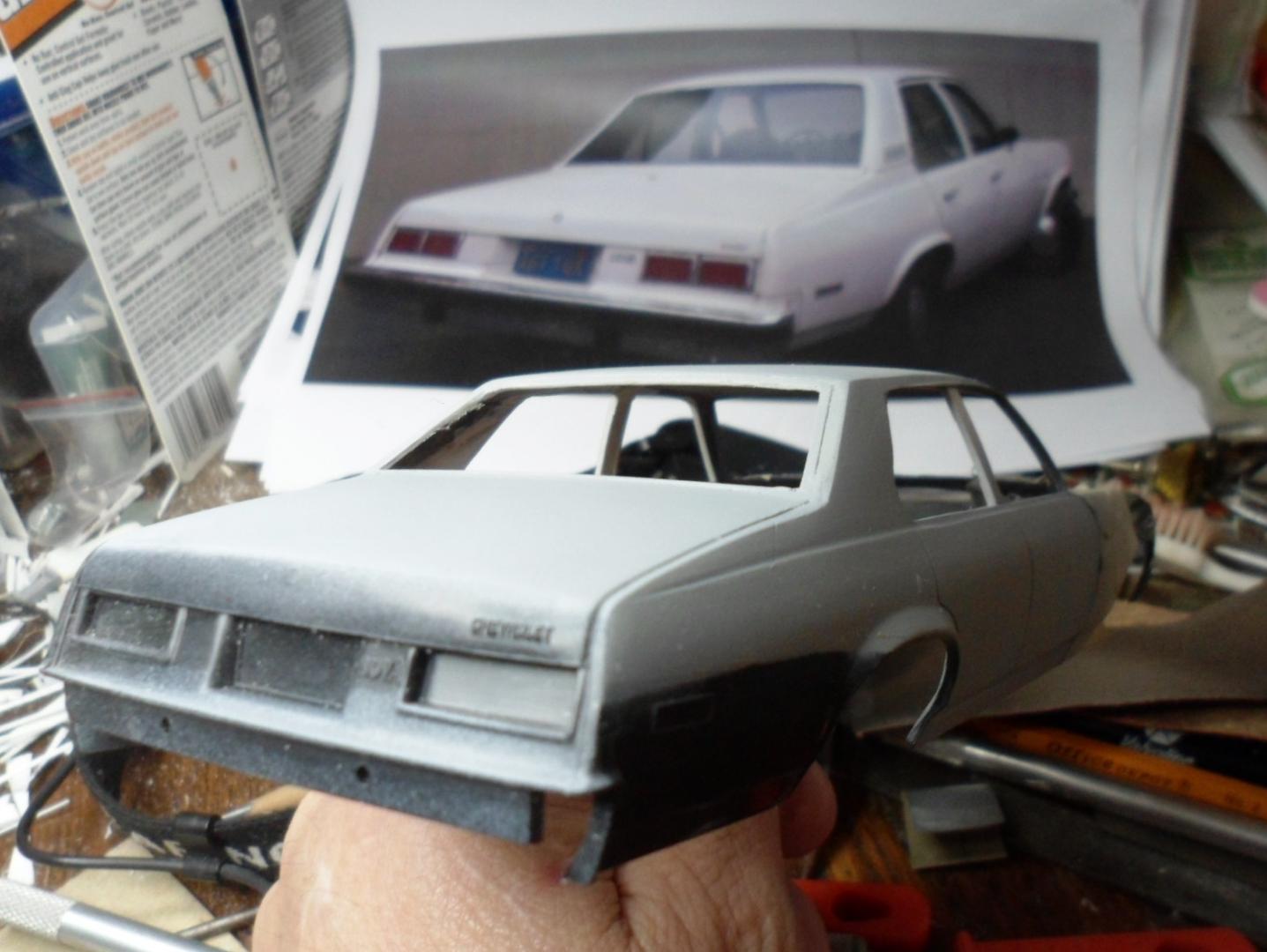

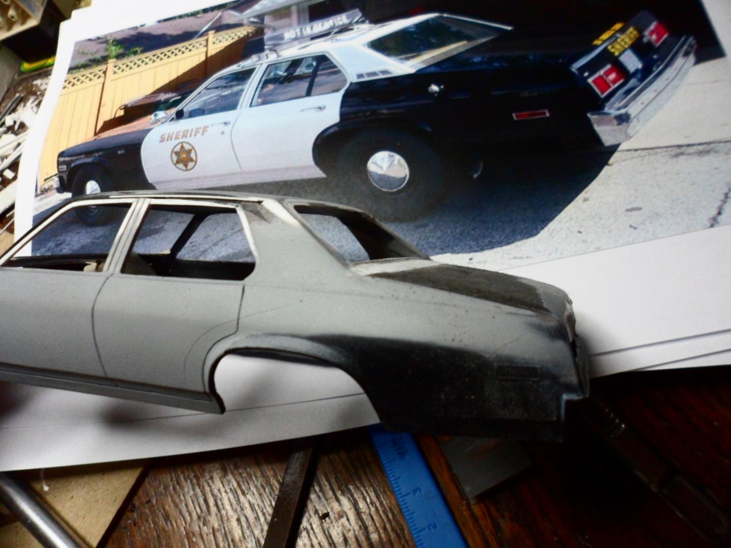

440 6BBL Posted April 6, 2018 Posted April 6, 2018 Loving this build already. I´d like to point something out regarding conversions of 2-doors into 4-doors. I´ve been working on a ´71 Valiant for a couple of years now and I posted this pic to ask for advice because I felt something was out of proportion. The result of the discussion was that I had built a sedan with a coupe roof height. The roof came out too low, like a very gentle top-chop. I ended up cutting the pillars and raising the roof 1.5 millimeters or so. I used a Duster front clip with a Dart body to get the correct style a-pillars and a simple body to work with for the conversion. Someone mentioned that the windshield of a Dart Hardtop wouldn´t fit a Valiant Sedan in 1:1. The picture of your modified body´s rear end with the 1:1 pic next to it. Compare the rear windows with each other. I could imagine that it´s not only Mopars to have different roof heights on sedans and hardtops. In the case of my Valiant it was pretty obvious, that the roof had some sort of issue. Easiest way to find out would probably be calling a glass guy and asking if 2-door and 4-door Novas use the same size windshields. Looking forward to seeing this evolve, digging the subject.

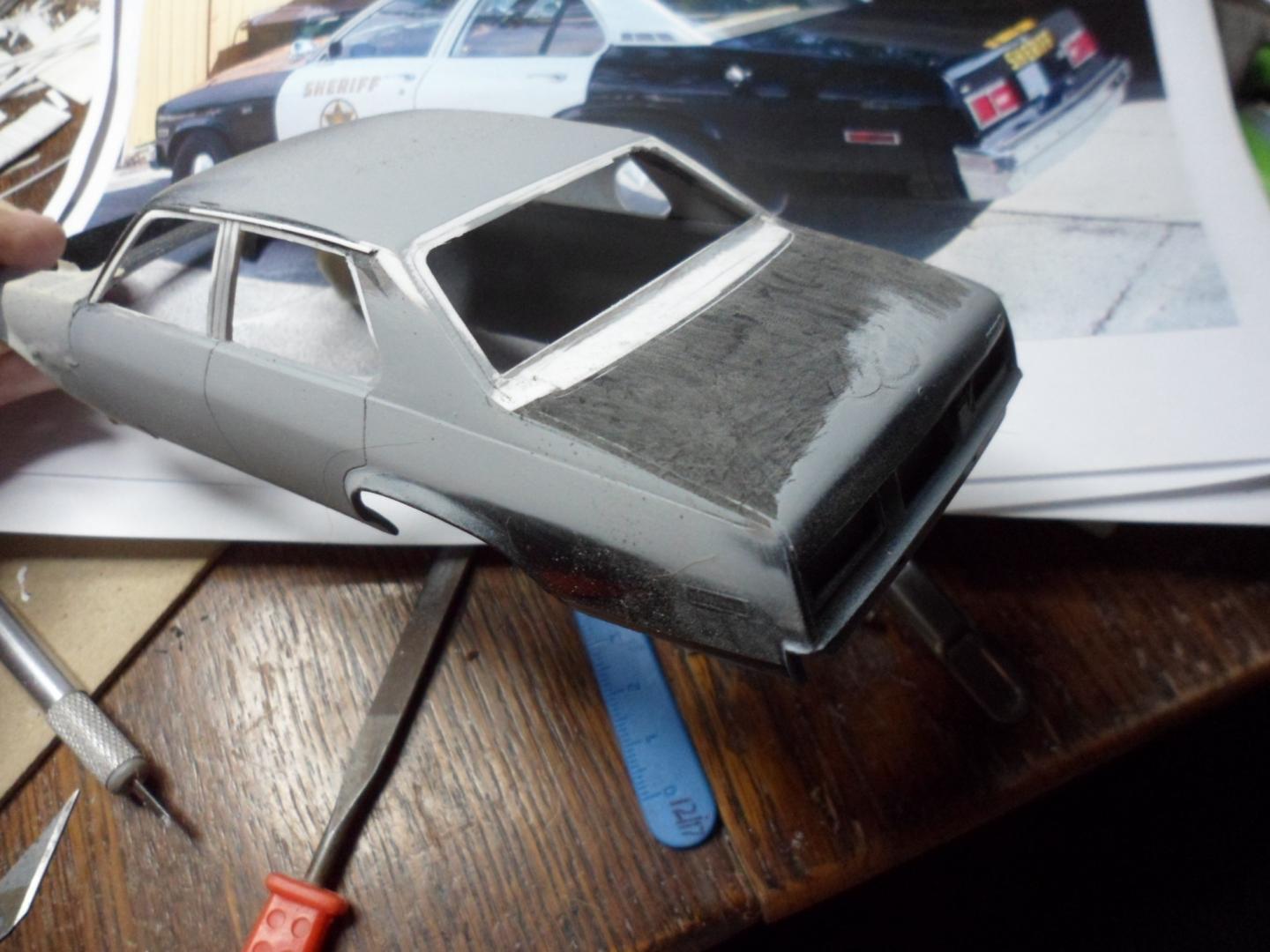

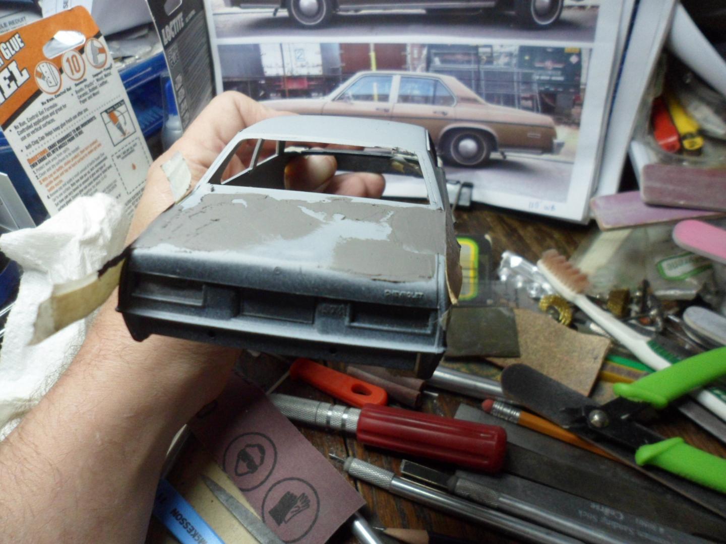

DEL Posted April 9, 2018 Author Posted April 9, 2018 Thanks to all for comments and encouragement! The Nova is on the list to be cast, and that will happen as soon as we can. Greg is still gearing up, he takes possession of the 91 CVPI project today and begins his work on it to make the molds and copies. He plans to post progress pics as he goes so you may want to follow that on that thread on the resin board. As to the 9C1 Nova here, I kidded myself with the posting of the last set of pics that it was mostly done but Ron and at least one other called me on the rear window being a bit short.. which was because the trunk lid (so pretty) was still a tad steep as it's angle to rise rose to meet the eel-like fastback C pillar of the 2dr version it was born as. No two ways about it, the trunk lid must flatten down at least a whole 1mm. (cm? I can't keep that metric stuff straight. It was about 1 & 1/2 on the ruler) That will add a bit of a bigger rear window coupled with a small addition to the roofline at the top. PITA it was but check out the progress and basic results..
DEL Posted April 9, 2018 Author Posted April 9, 2018 These pics show the addition of material to raise the rear roof edge a bit higher, adding some to the rear of the C posts to straighten them a tad, and finally, all of it primed over and door window frames being added in.. (If you look at where the C-pillar jumps up from the trunk surface to rise you can see from the earlier pics how that had to go down to be a bit more parallel with the body accent 'spear' from the door across the quarter panel..

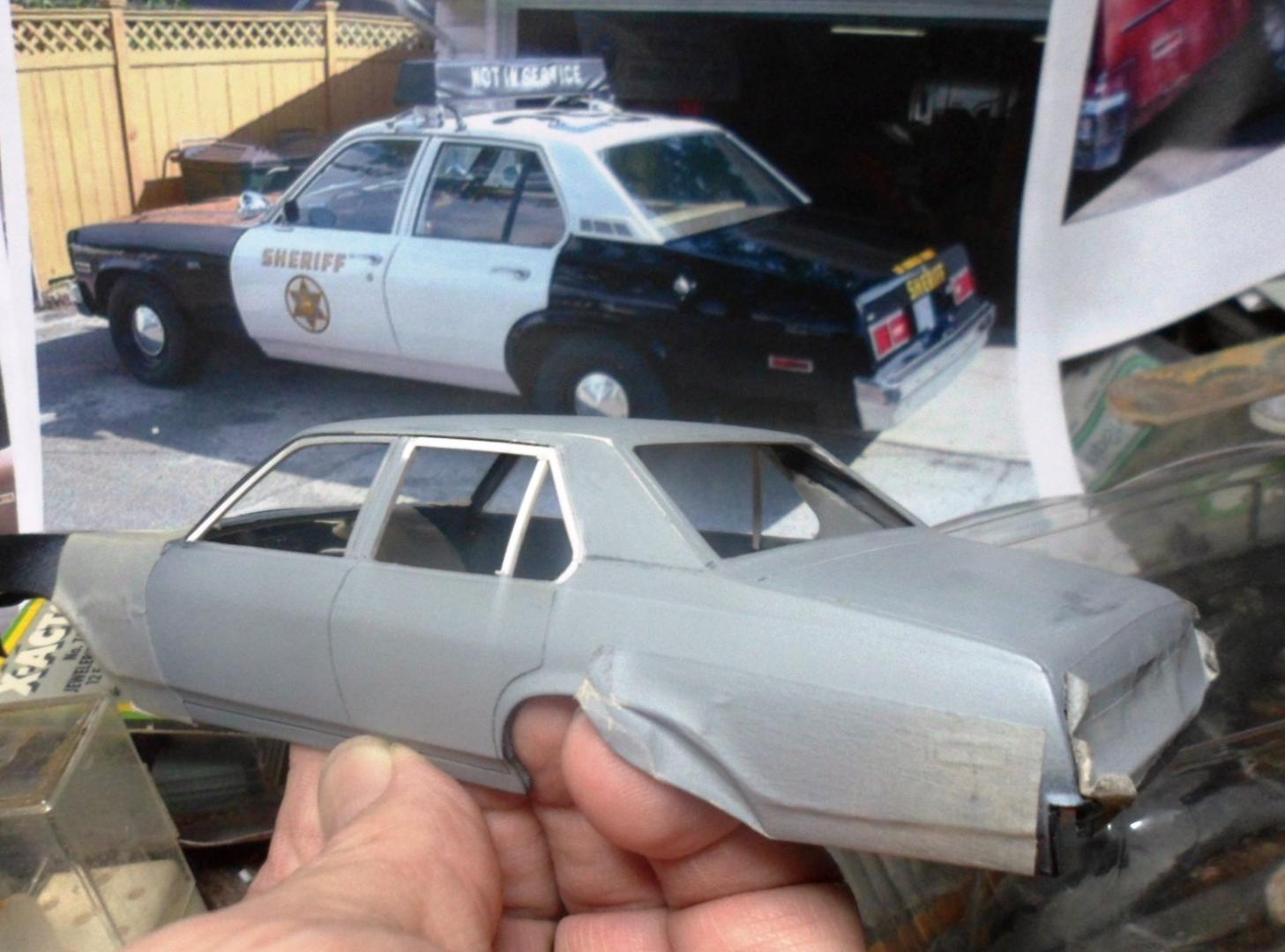

DEL Posted April 9, 2018 Author Posted April 9, 2018 And some of the final detail work around the door frames.. The second one below is almost the exact same angle for comparison as the LACSO unit in the pic..
