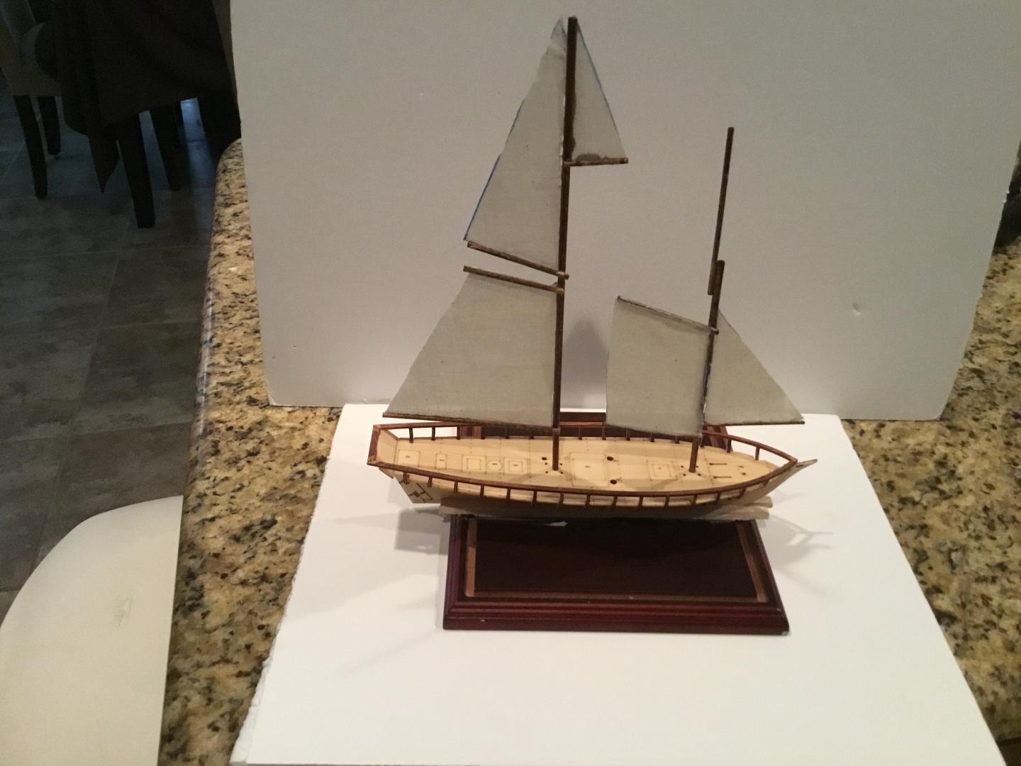

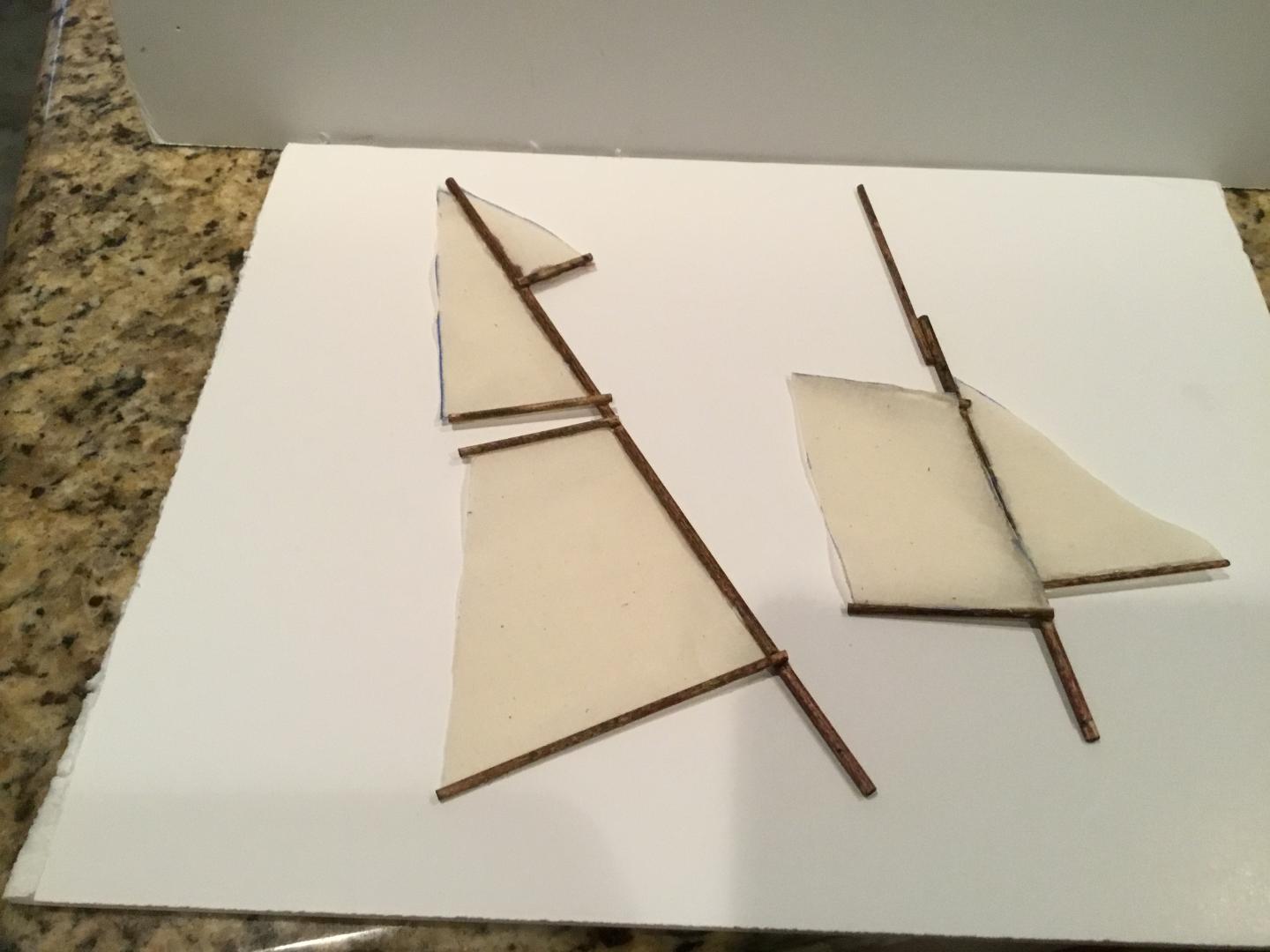

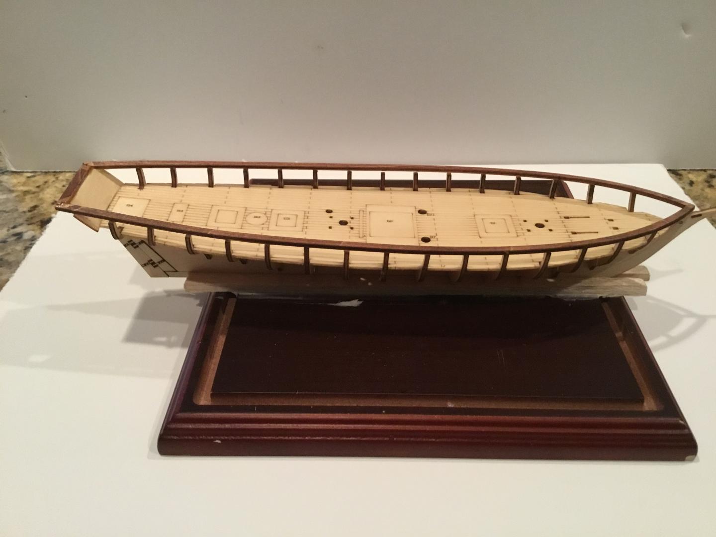

cobraman Posted April 11, 2018 Author Posted April 11, 2018 Progress ? Did a little more work on this thing . Got some of the sails cut and mounted . Not very well I will admit . Doing the best I know how to do and hopefully learning somethings to make the next one better . As I said before the instructions are bad but I won’t lay my bad work totally on that . Planking is pretty soon but I don’t have a bender yet . I may try the soaking in hot water for a few minutes to see how that works so I can keep building . So far not a bad hobby although my results may ( will ) not be too good but that’s ok .
slusher Posted April 12, 2018 Posted April 12, 2018 Coming along nicely Ray. I see you have the sails going. Are you enjoying it?
cobraman Posted April 12, 2018 Author Posted April 12, 2018 Thanks Carl. Yes, I am enjoying it but there is so much I just don't know. I find it pretty challenging but that's ok. I bought a book that is of some help but I have received much better ideas and help from some of the members here. If I can finish this it will be a lot because of their help. The guys here are the best and very willing to share their knowledge.
SfanGoch Posted April 12, 2018 Posted April 12, 2018 See, it wasn't that difficult. I didn't realize your Chinese was that proficient.
Rusty Irons Posted April 12, 2018 Posted April 12, 2018 (edited) It looks like fun Ray. I have a ship similar to yours in progress now. Model ships can have a lot of rigging if you want to have it fully rigged. There are different levels of rigging that can be used. For a first model you may want to have only the standing rigging. The standing rigging is only the rigging that holds the ship together. The running rigging is all the ropes to hold and set the sails. I don't see any dowels for your masts and yards. You should have some dowels that you will need to taper to match the plan. Edited April 12, 2018 by Rusty Irons spelling

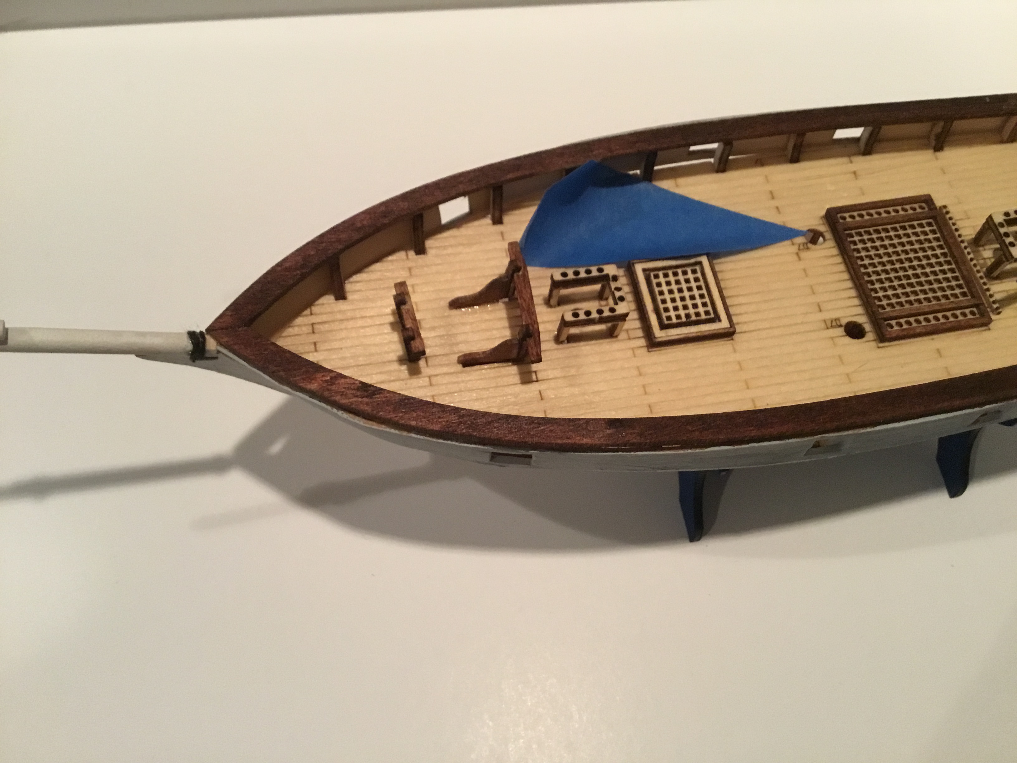

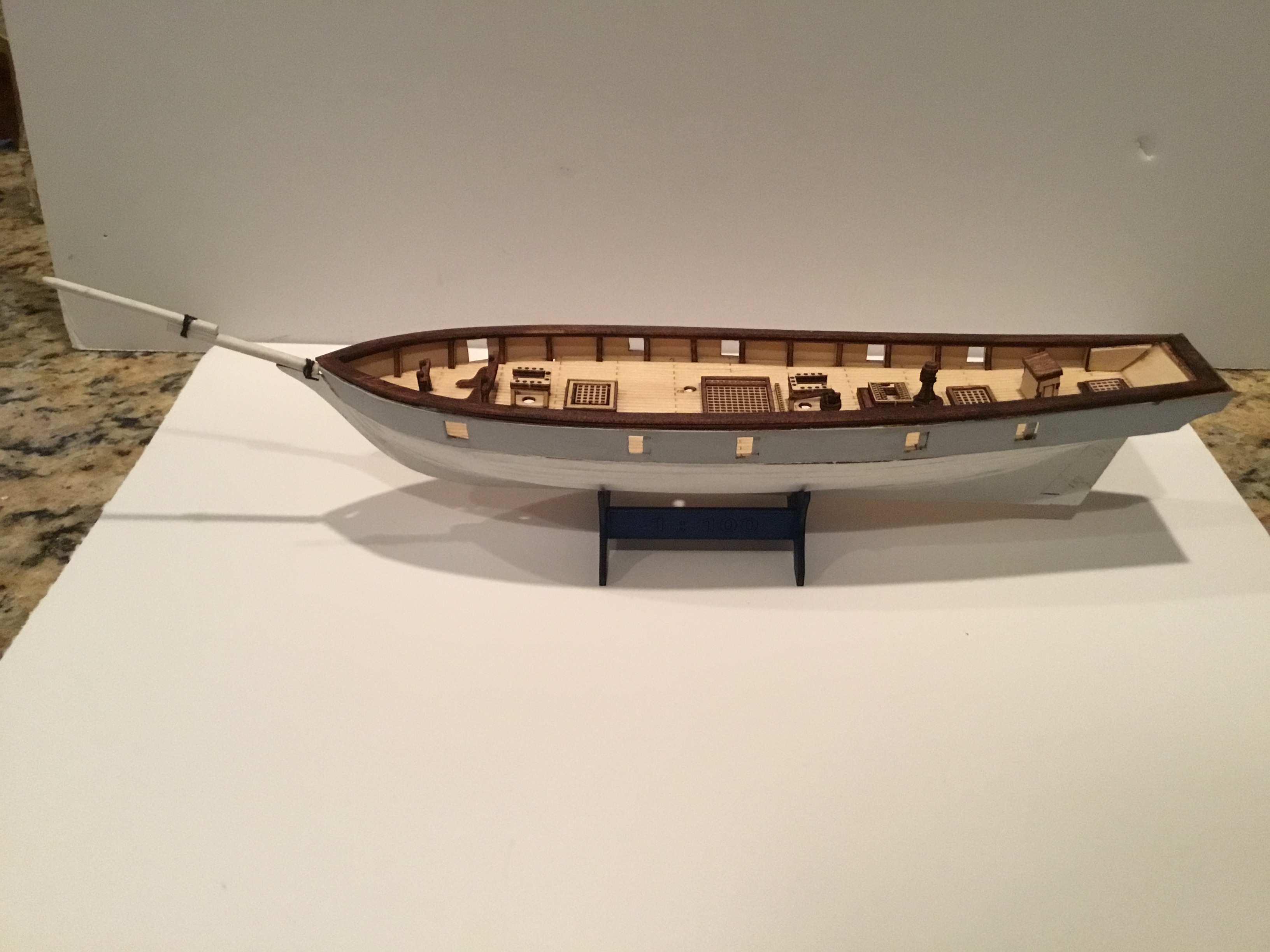

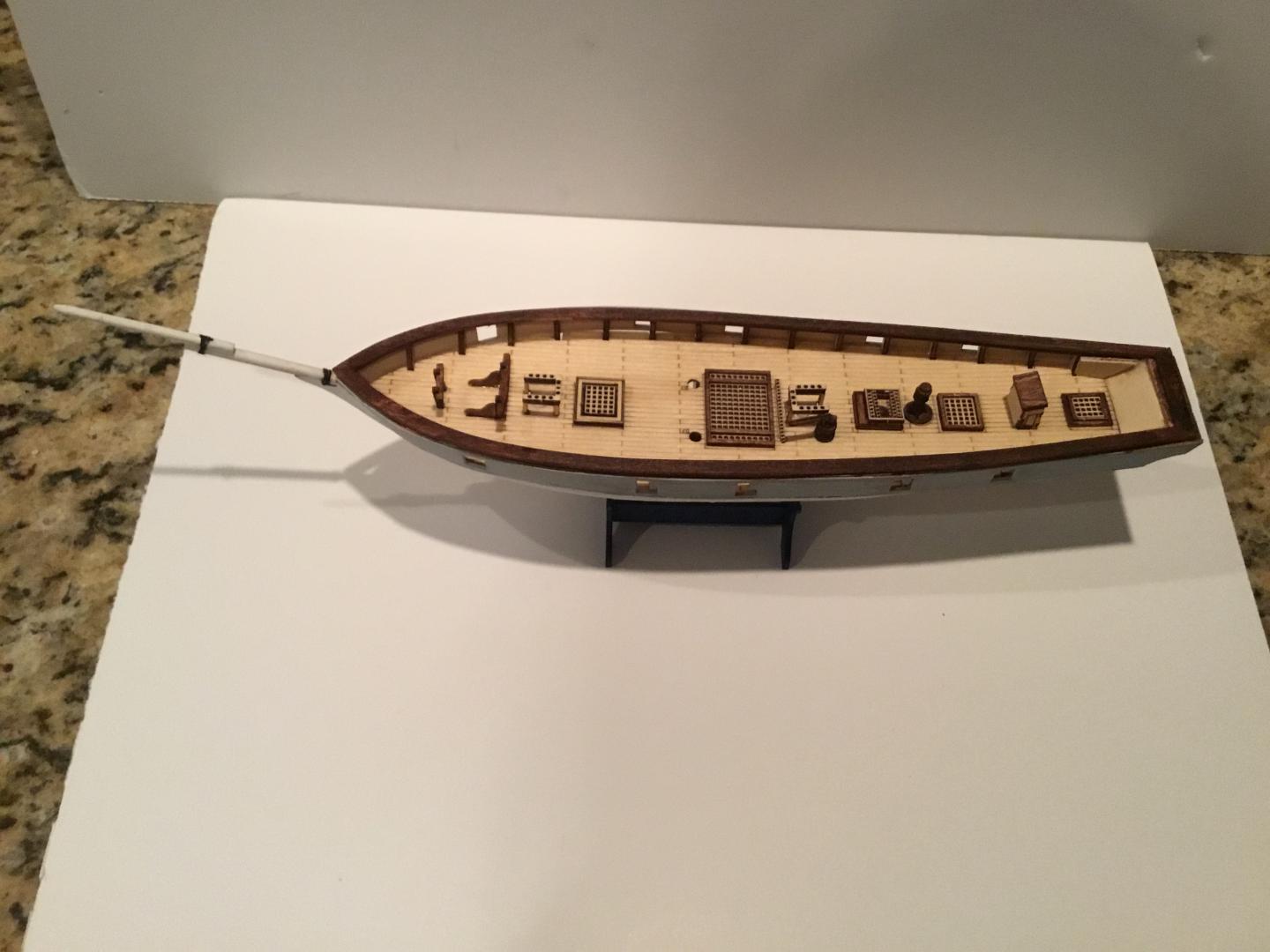

cobraman Posted April 16, 2018 Author Posted April 16, 2018 Ok guys . Here is where I am . Blue tape is pointing to one of the two,holes in the deck that have me at a loss . Any guesses as to what should be there ? Thinking I may just have to plug them with some mast plugs .
10thumbs Posted April 16, 2018 Posted April 16, 2018 Hi Ray, I haven't a clue as to what the two holes are supposed to be used for. Now there were holes in the decks for the levered pumps used to drain the bilges and to empty the hull of sea water from leakage, storms and war damages. These holes could be feasible for this application, being the area the largest and most voluminous area of the hull. Just it doesn't make sense to me them being there, plus the holes are too large for pump-type hardware. Also there were no derricks or cranes on these boats, the yards and winches were used as cranes to lift cargo and cannons. I'm stumped about the holes as of now. Anyway, the bilge pumps were not located so openly on the main deck, but more out of the way of the cargo area. The rest is taking shape, that's a nice looking deck in my opinion. I also agree this is a wonderful kit to get the feel of things, and for 15 bucks it looks pretty darned good. Rigging, and mast support and sail attachment is something for the next time around, especially when the kit has decent instructions available. Not to worry, you're on your way. Michael
cobraman Posted April 16, 2018 Author Posted April 16, 2018 The strange thing is the holes are marked for a part number but there is no such part that is supplied.
10thumbs Posted April 16, 2018 Posted April 16, 2018 Ray, check out closer about any cannons in this kit. Small boats like this had also a single, big cannon, like a carronade. A big, short range gun that packed a real nasty punch. This gun needed a good foundation, but these smaller vessels probably didn't have "two" side by side. Let me look at some plans I have for some insight. I have some that have a single gun, swivel mounted...maybe?
10thumbs Posted April 16, 2018 Posted April 16, 2018 Here, a single cannon on a swivel mount. Common armament from the day. Another, the red lines are from the instructions, not my doings; Here a look at the bilge pump I mentioned; This is an Occre model ship of the same classification as yours, a brig rigged clipper from the late 1700's. Still, I don't understand the two holes on your deck.
