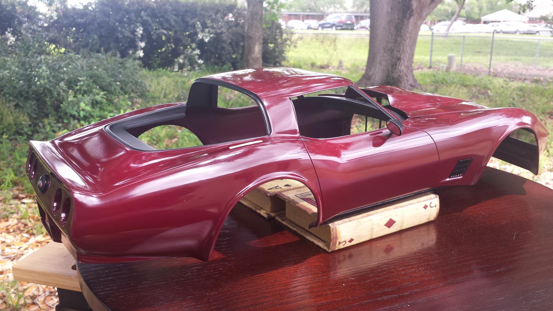

Steve Osbourne Posted April 24, 2018 Posted April 24, 2018 I use Tamiya TS colors from a can exclusively. They are a synthetic lacquer and are very forgiving. Problems with the finer colors showing scratches, you may want to use the Tamiya Gray primer (regular - not fine). It is much thicker than the Fine White or Fine Gray. Check out my big scale Corvette in the Big Boyz section. This was done with TS11 Maroon and no clear coat. I don't go higher than 600 grit sandpaper between coats. Instead, I try to avoid dust on the final coat and use Meguiars #7 Show Car Wax to smooth things out. Not perfect but works fine for me. If you let the cans sit in hot (not boiling) water prior to using you will have minimal issues. And shake, shake, shake between passes. I hope this helps.
