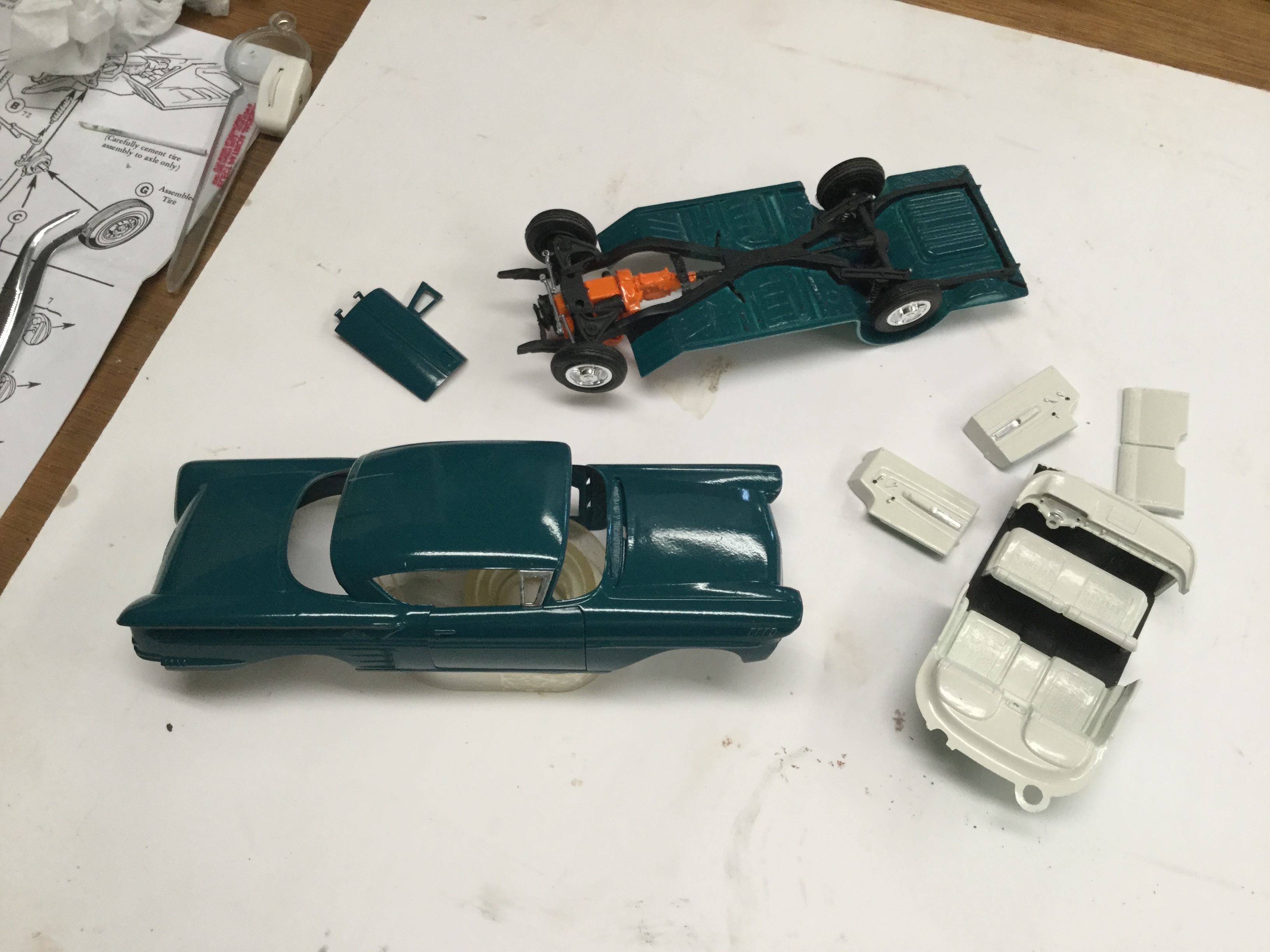

ewetwo Posted April 17, 2018 Posted April 17, 2018 Recent project. Love 1958 Chevy Impalas. Need some advice as to how to do a nice job on all the chrome body trim as there is a lot. The top will be white.

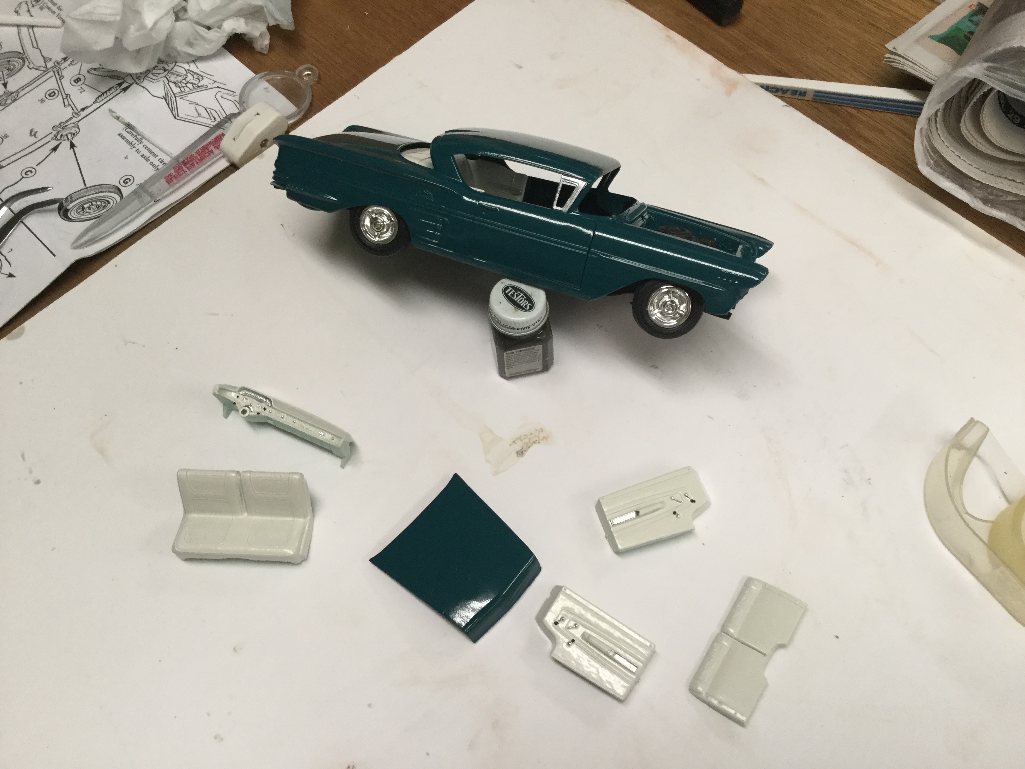

ewetwo Posted May 4, 2018 Author Posted May 4, 2018 (edited) Well I taped off the roof as I was going to paint it an off white to make it a two tone. Well when you share your hobby space with a golden retriever. You're bound to have a hair somewhere. And there was. In the white paint. I tried my best to just get it out seeing I just painted it and the paint was still wet. But that thing wouldn't budge. A mess did occur. So the Impala sat inside down with it's roof in some Purple Power. I hope this works. :-) Edited May 5, 2018 by ewetwo

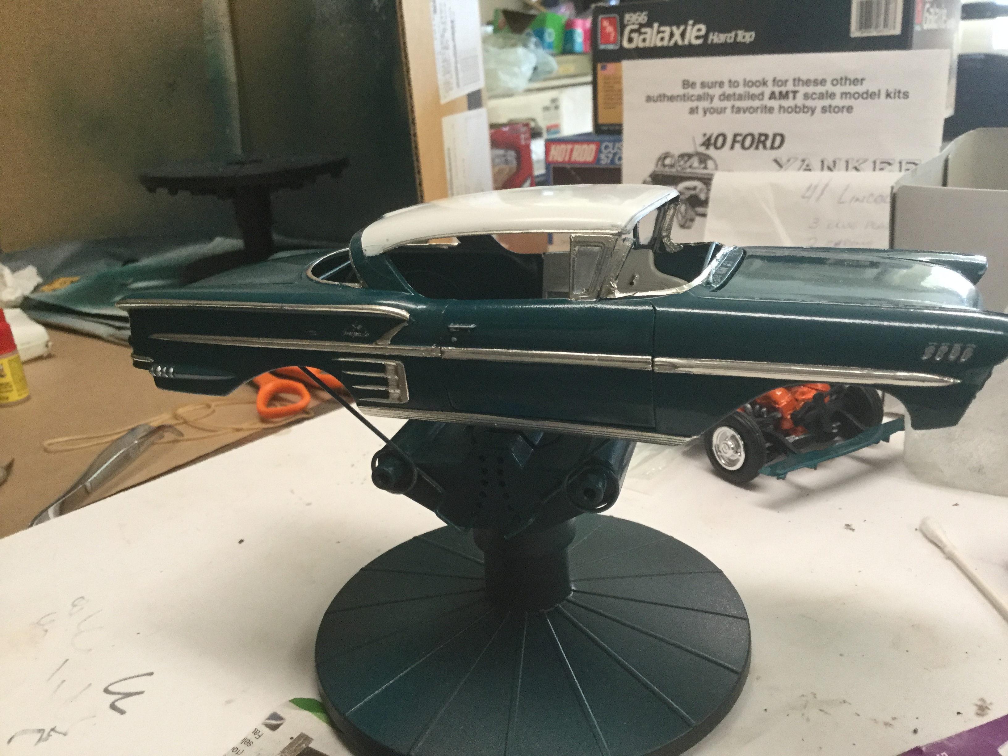

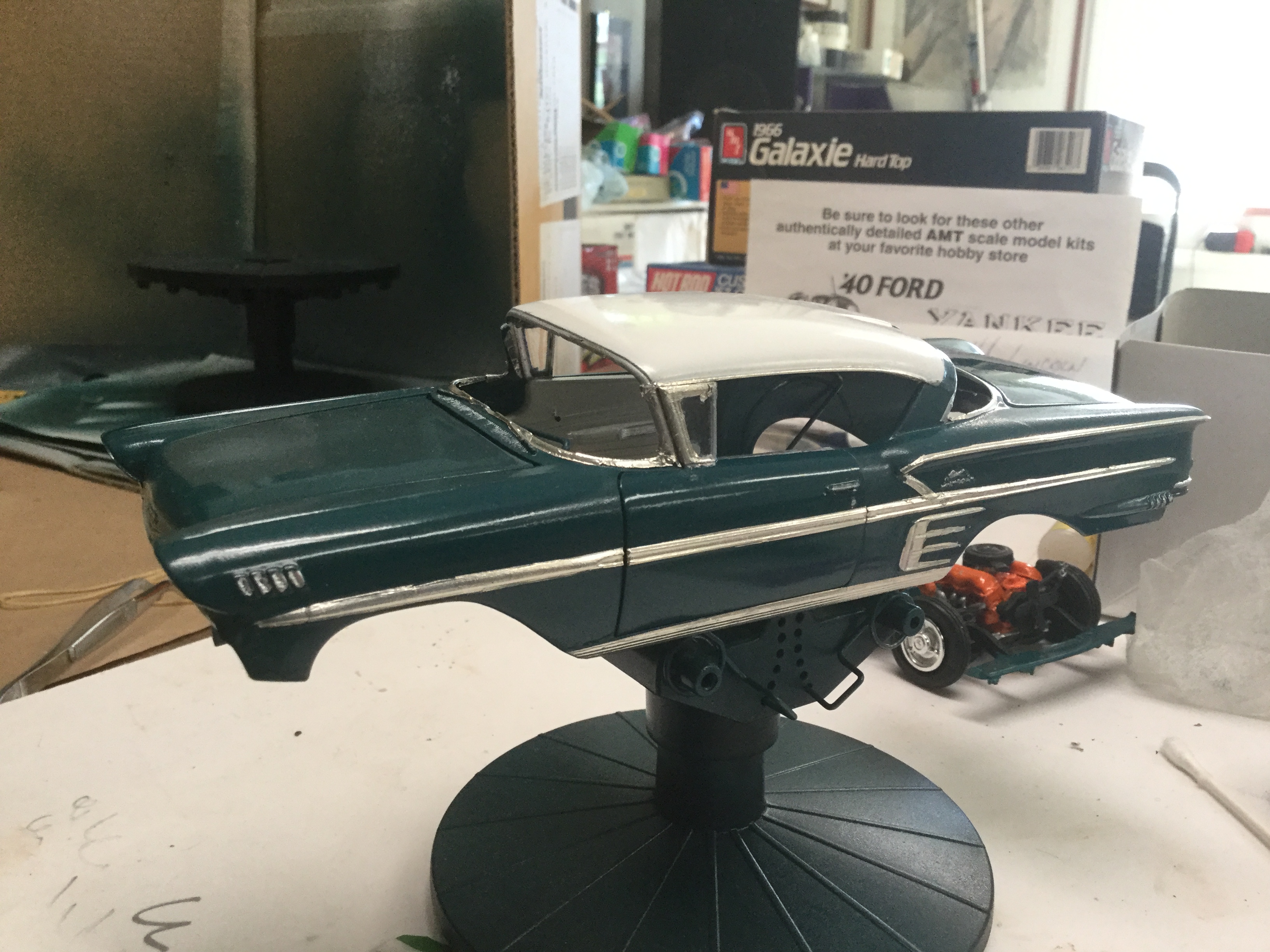

ewetwo Posted May 21, 2018 Author Posted May 21, 2018 (edited) OK. I've foiled most of the Impala. First time doing foil. I think it came out pretty good. But doing some buffing with the paint an A pillar broke. I've super glued. No luck. Trying Locktite hybrid glue. Tomorrow night will tell. Also trying the Locktite on the pieces of a pillar that were broken in a 1971 Thunderbird kit I got at a garage sale. Time will tell. The Impala is going to be tricky as I had glued the A pillar with super glue. Left it over night. Seemed ok. Tried to put the interior in to do a mock up and it came apart. I really am kind of confused as to how to get the interior tub inside the model with the wide door jams. Good thing is I now have picked up 3 additional 58 Impala kits since I started this one. You find them everywhere. So here are the pics. For some reason the pics look grainy. Don't know why. But it actually looks better in person. Edited May 21, 2018 by ewetwo
shoopdog Posted May 21, 2018 Posted May 21, 2018 David, you should be able to slip the interior in with the doors open. At least that's how mine went in on the AMT kit I just finished. First time foil work looks pretty good, I just hate foiling while others love it. It seems you've been having some bad luck with this build, keep it up though!
