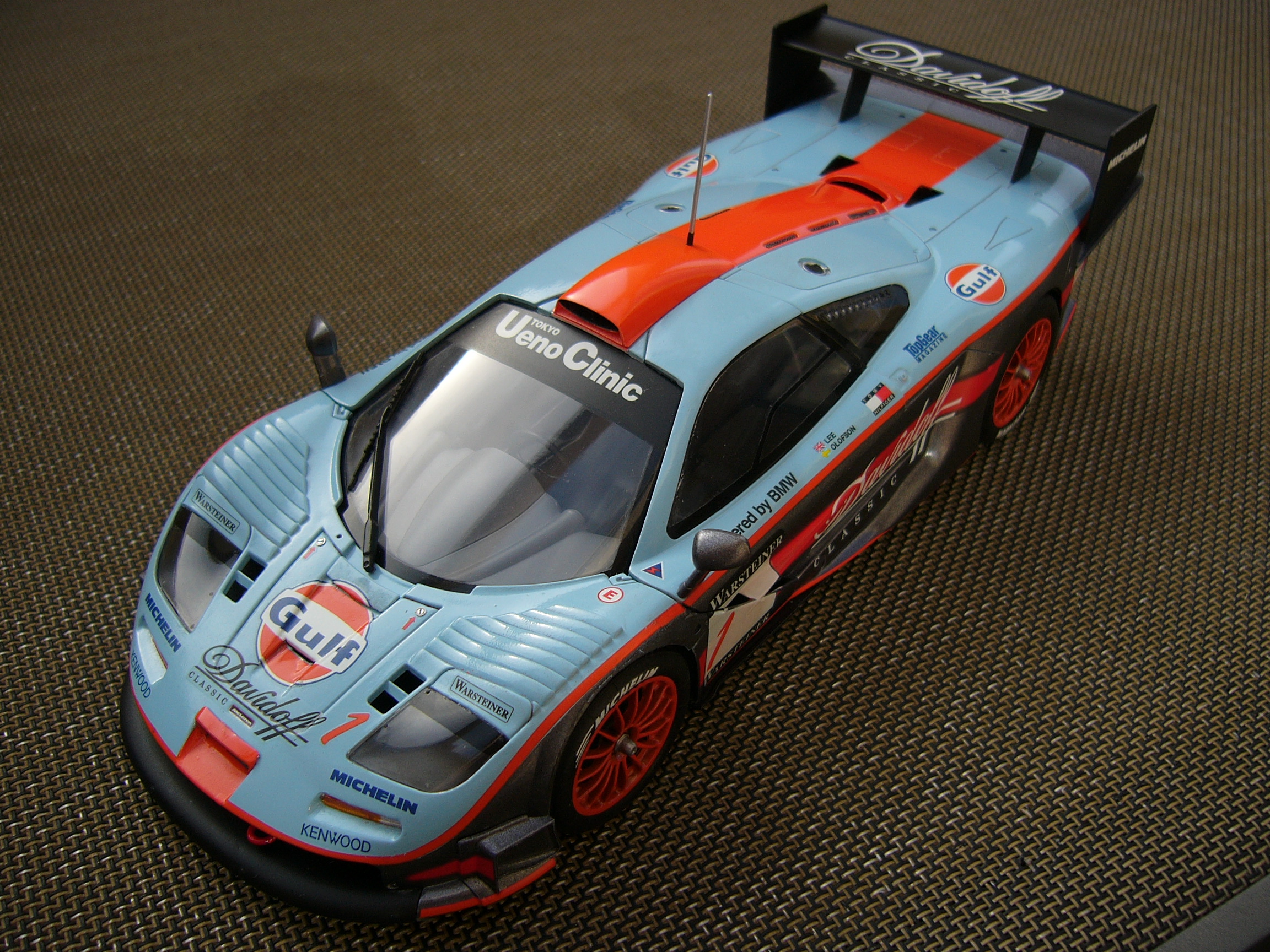

maltsr Posted April 23, 2018 Posted April 23, 2018 I used a Duplicolour Honda Blue on my McLaren with Tamiya Orange, both from spraycans.
VRM Posted April 23, 2018 Posted April 23, 2018 The original Gulf colours were old Triumph codes that John Wyer put on the original GT40s and Porsche 817s. They were Marigold for the orange and Powder Blue for the light blue. The Team Davidoff McLarens used a light blue pearl and a florescent orange. Steve
