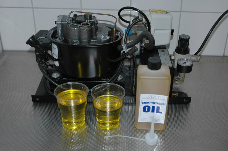

robdebie Posted May 29, 2018 Posted May 29, 2018 1 hour ago, robdebie said: I now have a Sil-Air 20 quiet compressor hat basically also uses a fridge compressor. Here's a view of my Sil-Air 20 opened up for oil replacement. Mine has a ring clamp for the 'lid' (that is not shown here), there are also versions where the lid is welded on, as is always the case in fridge compressors. You can see the vertical crankshaft poking out at the top, the cilinder is horizontal to the left. The cilinder head has a lighter color. The electric motor is down below. The oil level is about 20% of the height of the the casing. I'm pretty sure the electric motor splashes it around quite vigorously. The air enters the black casing through the pipe on the left, that has a air filter at the end. It also serves as the oil filling point, as indicated by the label. The air exits the pump through the long brass pipe at the top. Its length allows the motor to move around, since it is hung in springs. Hiding behind the plastic refill oil container is the rectangular steel air tank, and to the right is the pressure regulator with oil/water seperator below it. Rob
