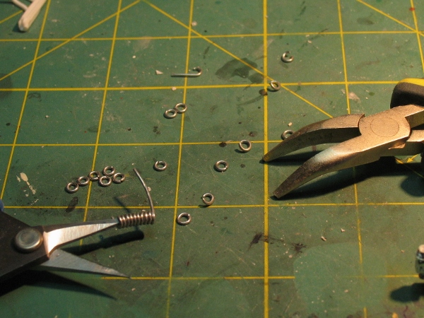

BigTallDad Posted May 2, 2018 Posted May 2, 2018 (edited) Small diameter solder can be wrapped around the shank of the drill bit you used to drill out the dashboard. Allow the ends of the solder to overlap, then cut through the intersection. Mate the ends, put a dab of chrome paint on, glue in place, and you're done. Edited May 3, 2018 by BigTallDad
Belugawrx Posted May 3, 2018 Posted May 3, 2018 (edited) Yep what bigtall said, I wrap silver wire around an appropriate diameter tube, cut it at the overlap and correct (adjust) with flat jaw pliers Edited May 3, 2018 by Belugawrx
