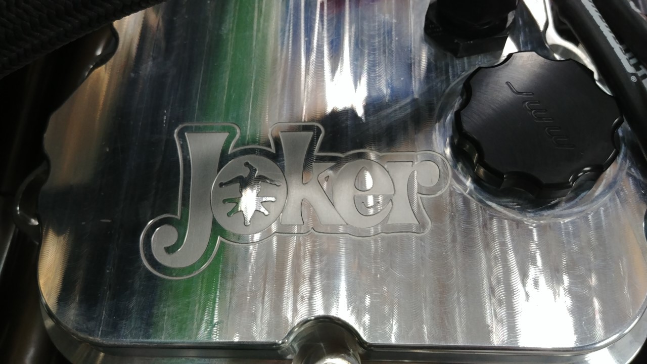

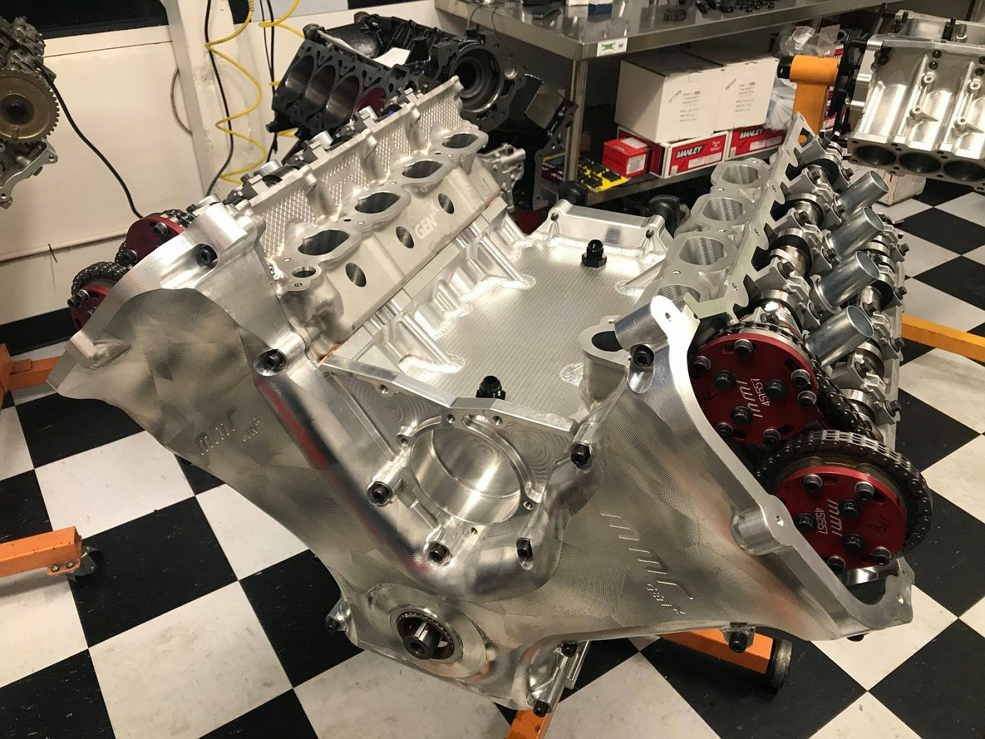

Couple of pics of MMR engines.
Here's a MMR twin turbo Coyote that we are putting in a Fairlane. Hope to build a model of it later.

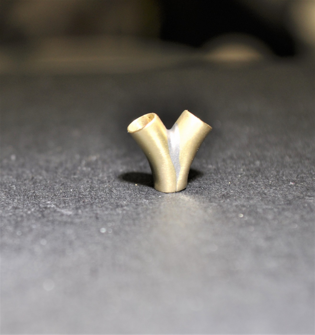

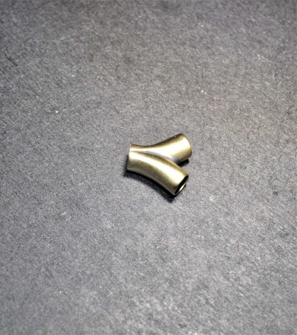

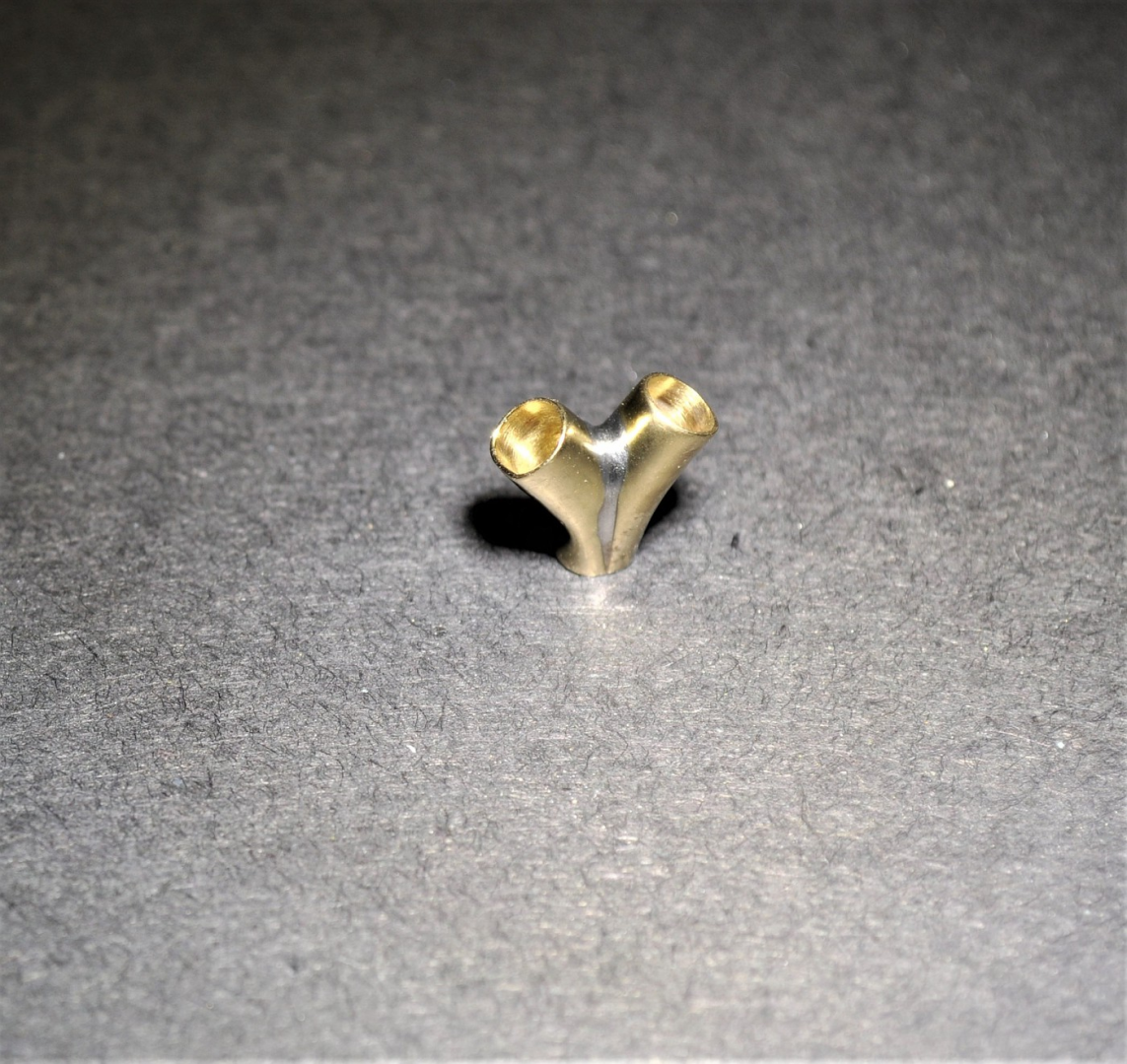

Appreciated guys........after several days of bantam time I wanted to try my hand at making a 4" 2 into 1 "Y"  turbo inlet pipe...........first attempt and learned a bunch but I like it for the most part.  This would be the induction piece that merges the twin turbo pipes into the throttle body on the plenum.  By adding some faux weld lines to it I believe it will really pop.   cheers
I've not cleaned it up completely btw.......
Tim....  outstanding work my friend. That Y pipe looks great. You are right adding some of the Archer weld beads will just make this piece pop for sure.

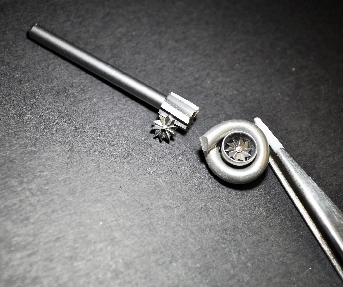

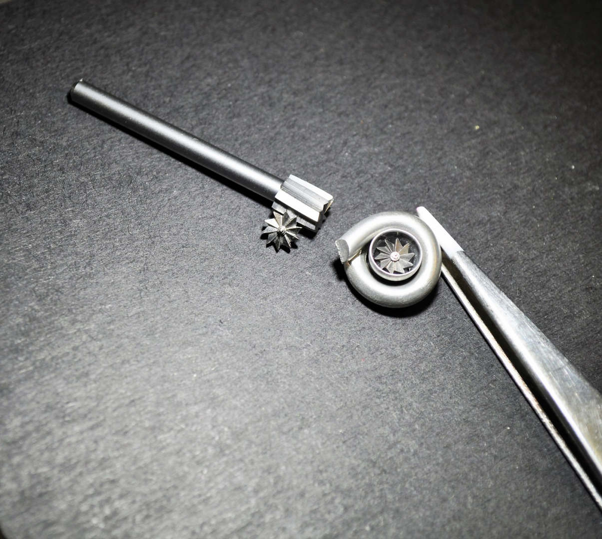

Thanks fellas, sorry bout' the very late reply to your comments.  I got the bantam body painted matt black on the inside and primered the outside in white so I can finish the paint  when the weather decided to take a turn for the worst.  Even though I live in Pa. it's more like Louisiana right now.  So much rain and humidity that I had to set the car aside.  So I thought I'd try to come up with a suitable facsimile of a turbo impeller.  I took a dremel high speed cutter, milled a hole out in the center and cut it off with a jewelers cut off wheel. Bit of cleaning up and I think they're good to go. The mock-up pics are just messing around as an fyi........the turbos themselves will be better I promise.  cheers, tim
That's crazy right there. Looks just right. I'll bet that took awhile to get through that Dremel attachment. Those guys are hard.
Oh so right there Brad......drill bits were worthless and went thru 2 end mills & 4 jewelers cut-off blades (they're reasonably cheap thankfully) to do them.   :wacko:
Holy Smokes Tim... that is awesome and had to been a pain in the Butt. I know drill rod can have a hardness of Rocwell C60 to C65 which would make it very hard to cut. You couldn't of found anything any better to use for the impeller.l without machining it all from scratch. Looks Killer. You keep raising the bar for us.
