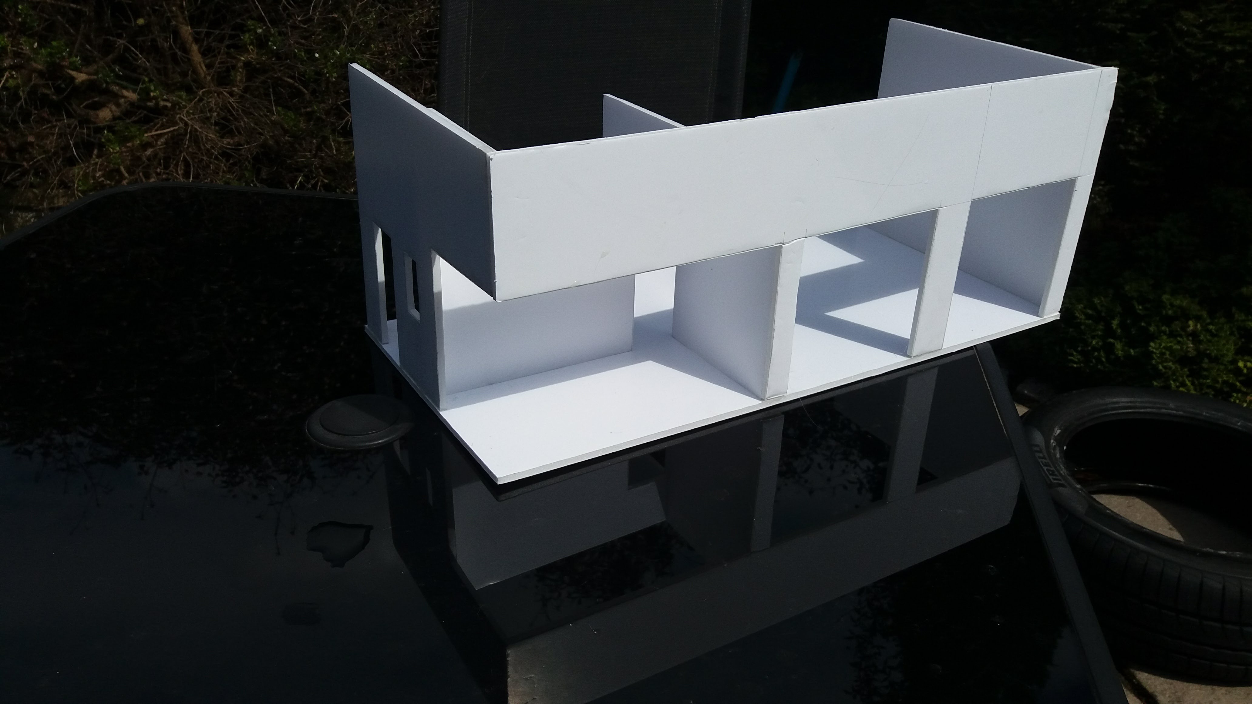

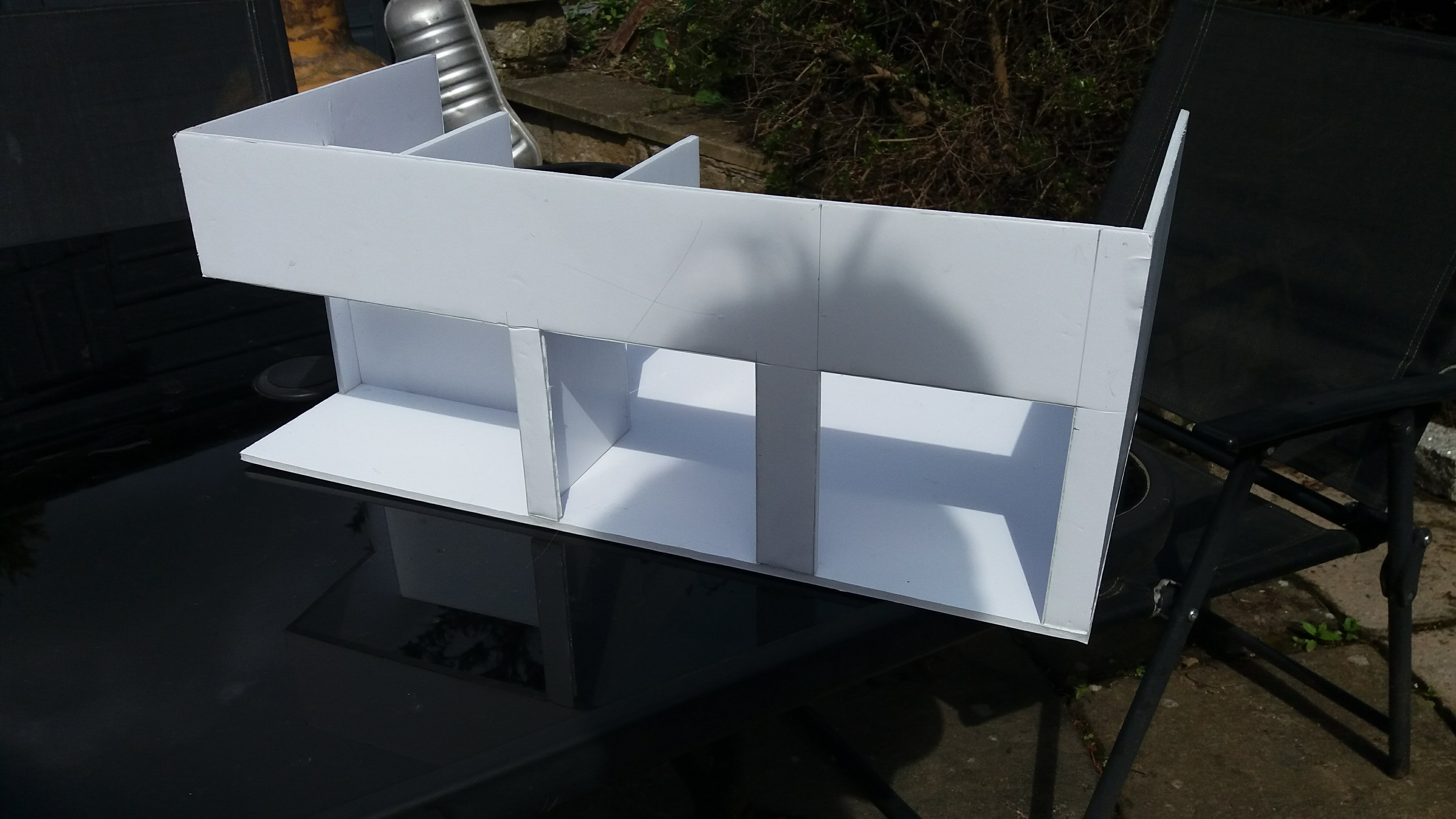

Red318 Posted May 18, 2018 Author Posted May 18, 2018 Vietnam Vet67 , thanks for this, another really useful photo and another variation, with no canopy and the pumps a long way from the building, maybe in a drier state where land was cheaper. The glazing in the shop is also different and appears to have glazing in the end wall. I like the "Registered Rest Room" sign - who did they register with? Lots of ideas here and I've ordered a copy of the book. I've got the basic structure done in foam board, now I need to decide how the details will look - here's a couple of pics of progress so far.

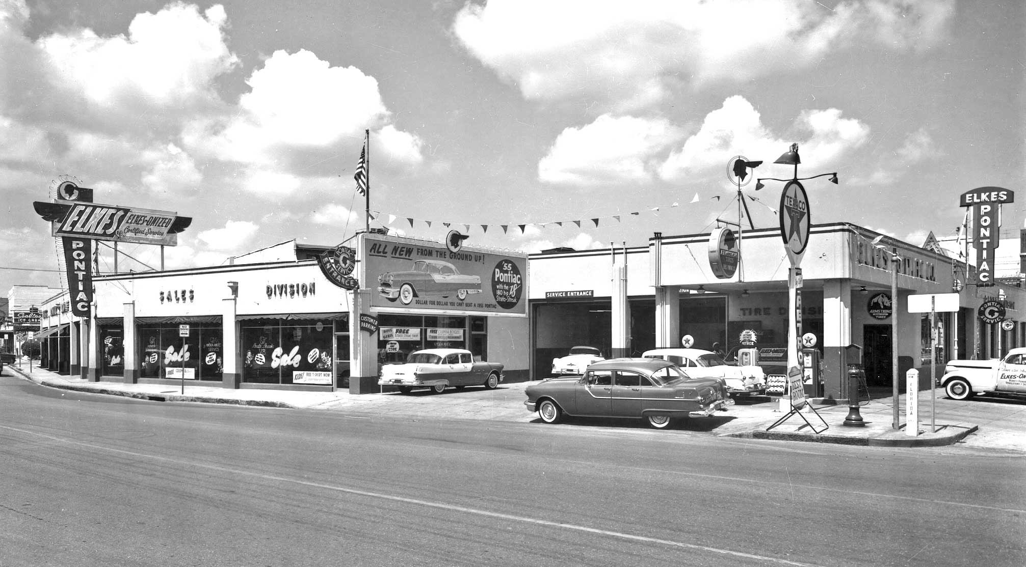

Vietnam Vet67 Posted May 27, 2018 Posted May 27, 2018 1956 Pontiac dealer along with Texaco gas station...........
Anglia105E Posted May 27, 2018 Posted May 27, 2018 I really like these '50's black & white photographs of motor car showrooms and gas / petrol stations, both in the USA and England too. They are always good for reference when you are building a scale model diorama from this period. David
Red318 Posted May 27, 2018 Author Posted May 27, 2018 Ellen, Ed Thanks for the pictures, these are absolutely dripping with atmosphere and that Pontiac dealership is amazing, but I don't think I've got the room for that in 1/25! Plenty of ideas though and I'm amazed by the variation in "standard" designs. Watch this space for my updates once I decide what it's going to look like.
