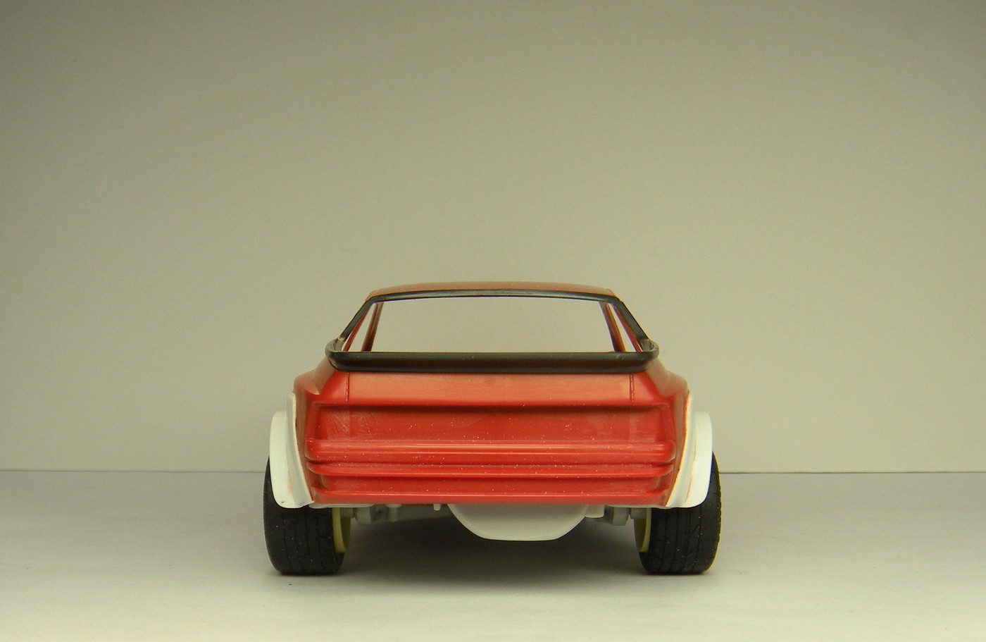

afx Posted May 22, 2018 Author Posted May 22, 2018 (edited) I appreciate the comments and the interest gentlemen. Fabricated a set of the rear flares but wasn't happy with them so I'll have another go. This is where I'm headed, not this livery but this is the look I'm after. Edited May 22, 2018 by afx

afx Posted May 23, 2018 Author Posted May 23, 2018 (edited) Thanks Mike & David. Ambitious indeed Brian - hope I can pull it off. Rear flare roughed in. Edited May 23, 2018 by afx
