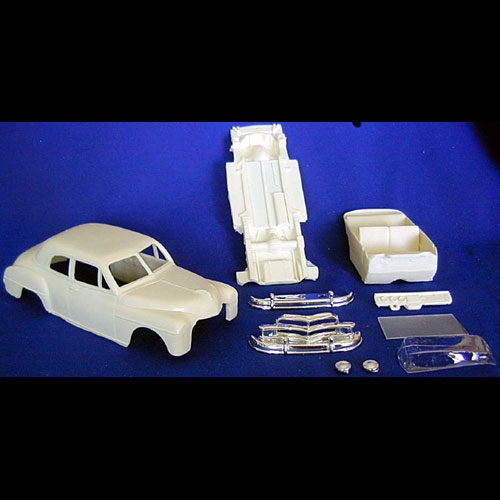

SfanGoch Posted July 1, 2018 Author Posted July 1, 2018 A special thanks to Chris aka "von Zipper". He had the R & R Resins '50 Plymouth. We made a deal and I received it this afternoon. Here are some pics Chris provided: The roof needs to be modified to look like this I'm thinking to use the chassis from the AMT '41 Plymouth Coupe. it'll need to be shortened 6 scale inches to give it a 111" wheelbase.
Ramfins59 Posted July 2, 2018 Posted July 2, 2018 22 hours ago, SfanGoch said: A special thanks to Chris aka "von Zipper". He had the R & R Resins '50 Plymouth. We made a deal and I received it this afternoon. Here are some pics Chris provided: The roof needs to be modified to look like this I'm thinking to use the chassis from the AMT '41 Plymouth Coupe. it'll need to be shortened 6 scale inches to give it a 111" wheelbase. I'd love to get one of those '50 Plymouth kits.
