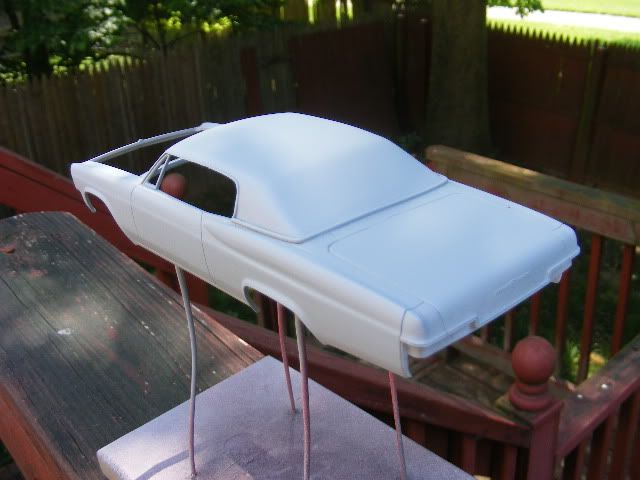

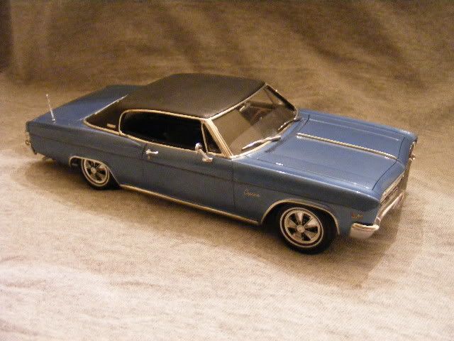

Ron Hamilton Posted June 4, 2018 Posted June 4, 2018 Tommy, that is one project I have always wanted to do. As you recall, I did my own 66 Caprice 2 door Hardtop from a 66 Impala SS kit, as I never liked the way that the Modelhaus 66 Caprice looked. As a matter of fact, I worked with Bob Kornow (Model car Garage) when he was developing the 65 Impala SS Photoetch set. I suggested that he include the scripts for the Biscayne, which I drew for him, Bel Air, Impala and Caprice so that all could be done. When I did the 66 Caprice roof, I kept the front half of the original hardtop roof, as the one to one would be using the same windshield and pillars. I would approach a 4 door hardtop basically the same way. It took quite a bit of plastic sheet putty, filing and shaping. The convertible's trunk lid and tulip panel is a better fit for the sport sedan's items, but face it, while it is a doable project, I will take a lot of work to achieve a good replica. I think the hardest part of the project, would be replicating the interior. I would love to do one, but It would be several years from now. I would do mine in Silver Blue, with the black vinyl roof and blue interior. Just like the one in the picture Bill showed.
