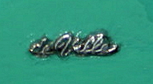

SfanGoch Posted June 8, 2018 Posted June 8, 2018 (edited) I made this Caddy deVille script with aluminum foil filled with CA glue this morning. Please excuse the photo quality. I don't have a macro lens and I had to enlarge the image a bit. The impression was filled with just enough CA so it would be flush with the foil and I could skip sanding the back flat. I then trimmed around the script with a scalpel blade (had my eyes checked last week. 20/15 vision in both eyes. ) and glued it to a piece of styrene sheet onto which I slapped some Floquil Verdigris. I used the back of a UMM scribing tool to remove the paint from and around the script, then polished it with Novus 2. It's a slapdash job so I could post a pic; but, you get the idea. One important thing not to overlook is to use a round toothpick, or a shaped piece of scrap wood, to burnish around the script and to push the foil into the loops of letters to give a sharper definition to your copy. Edited June 8, 2018 by SfanGoch
1972coronet Posted June 9, 2018 Author Posted June 9, 2018 Very impressive de Ville emblem , Joe ! Thanks for sharing a photo of the finalised piece ! I got some CA at work today --- hopefully I'll be able to test this new process this weekend

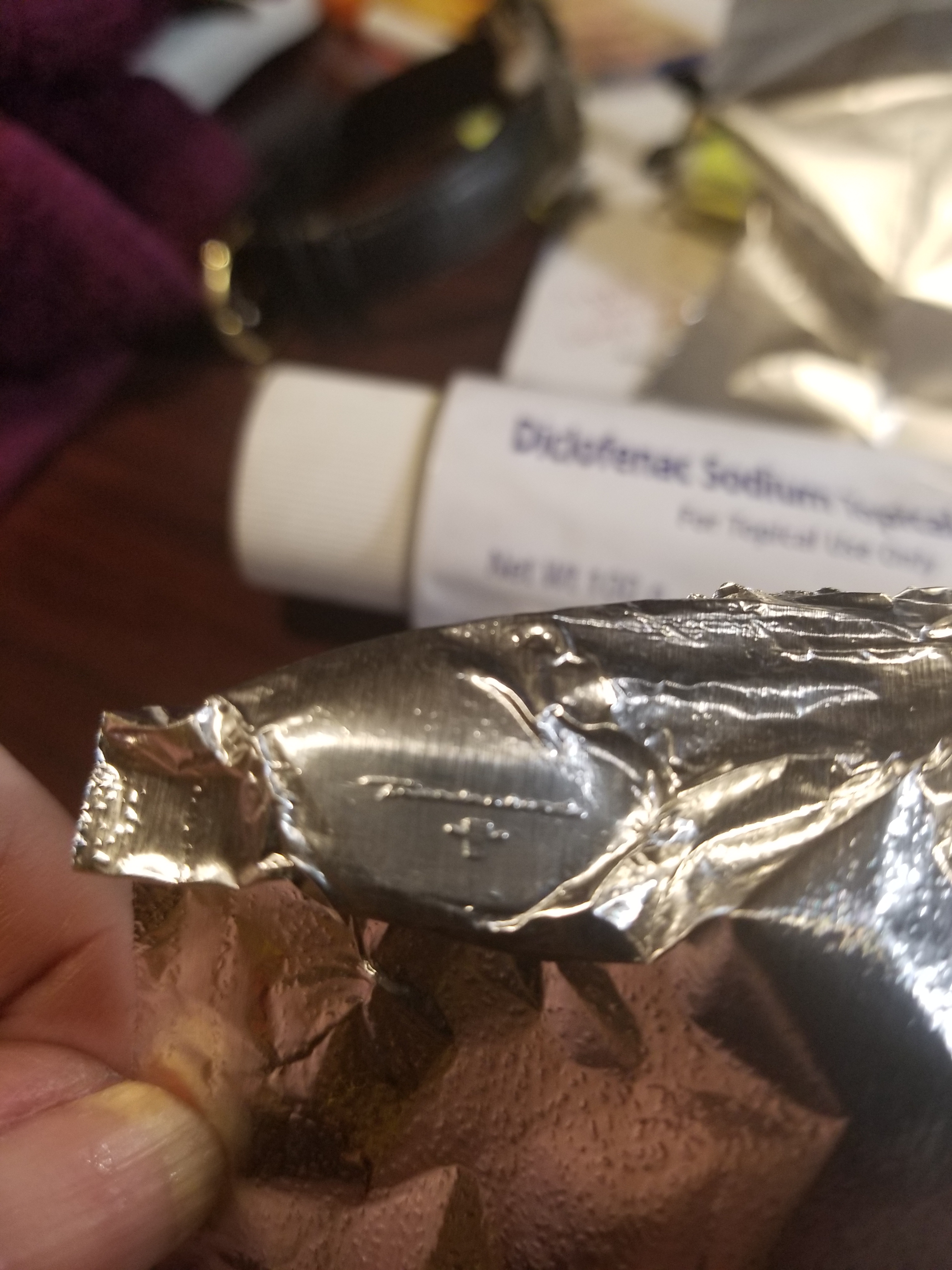

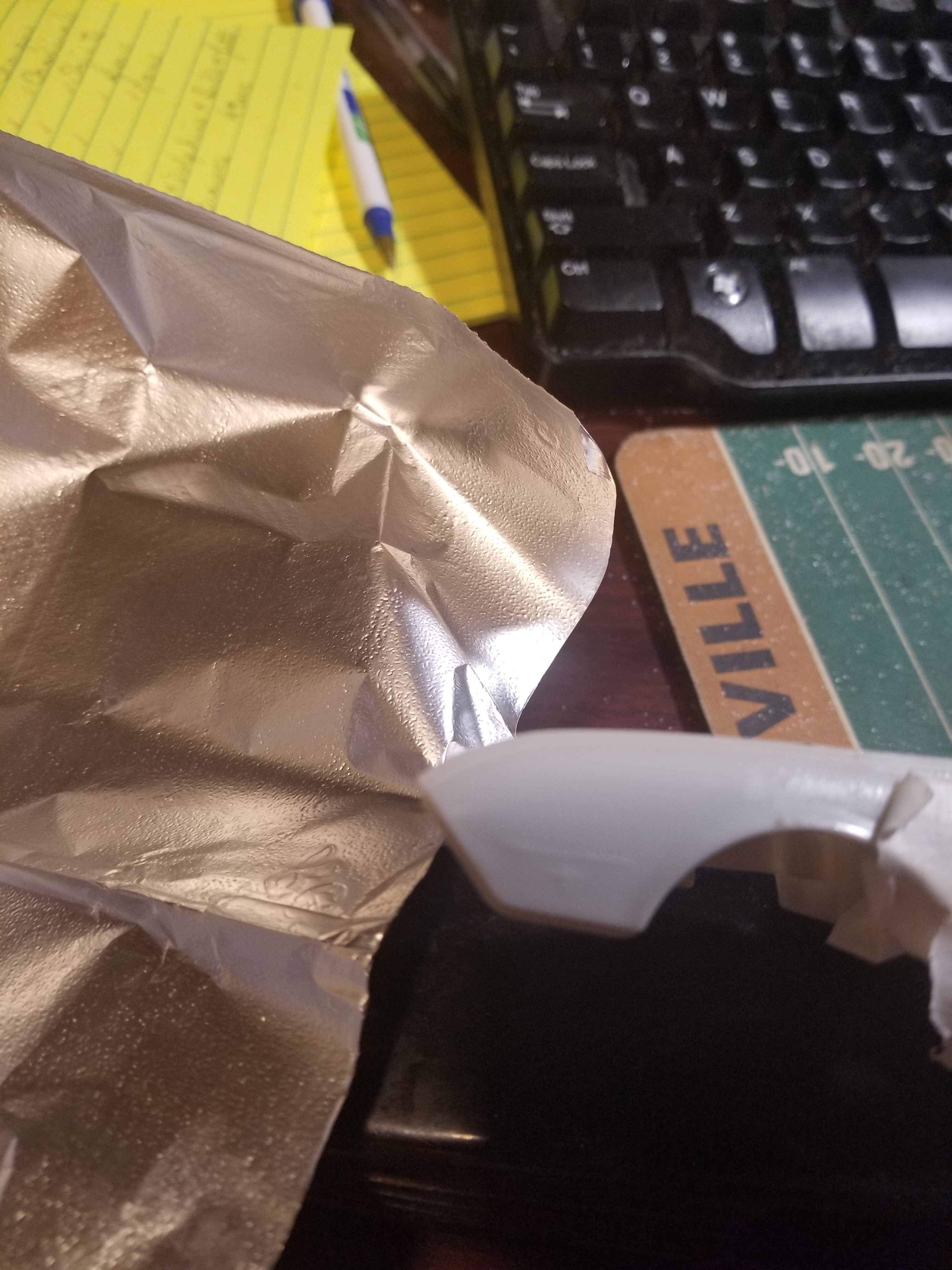

Super28 Posted November 14, 2018 Posted November 14, 2018 Ok, got this far. This is the "Thunderbird" and Thunderbird emblem on the front fender of a 1962 Thunderturd. What do I fill it in with? Then do I cut it out and glue it to the body after it is painted> What I "CA"? Help a fella out
