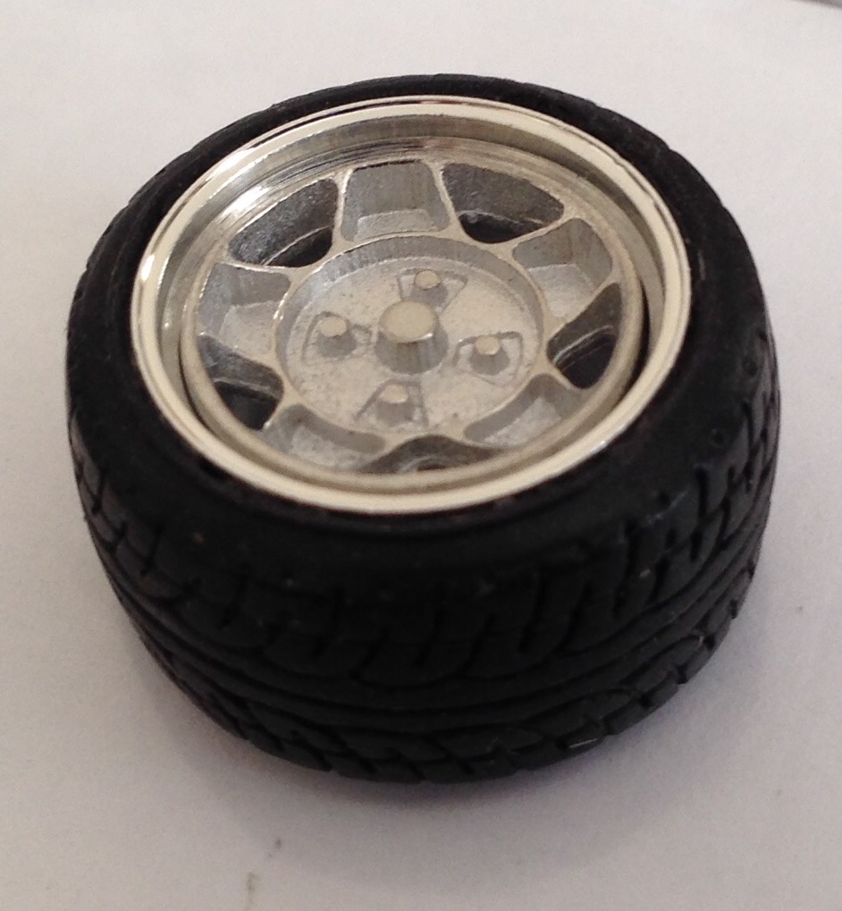

geetee66 Posted June 8, 2018 Author Posted June 8, 2018 I got the Tamiya kit from eBay for about £20. The Honda B-18 engine is by Studio 81, the seat, photo etched fuel caps, fire extinguishers and wheels came from ScaleProduction.de. I'm very impressed with the wheels. They're really well made and the tyres are good.

Janne Herajärvi Posted June 8, 2018 Posted June 8, 2018 Very interesting project.. Cant wait to see how you make that all work together.. You are right about those wheels they are really nice.. I used them lately in my Toyota Corolla TE27 Levin.. and best part is that they are really easy to detail paint..

geetee66 Posted June 9, 2018 Author Posted June 9, 2018 And a quick wheel pose, just to see how it's going to look. Luckily, the O/D of the tyres, is the same as the kit tyres, so no arch adjustment required.

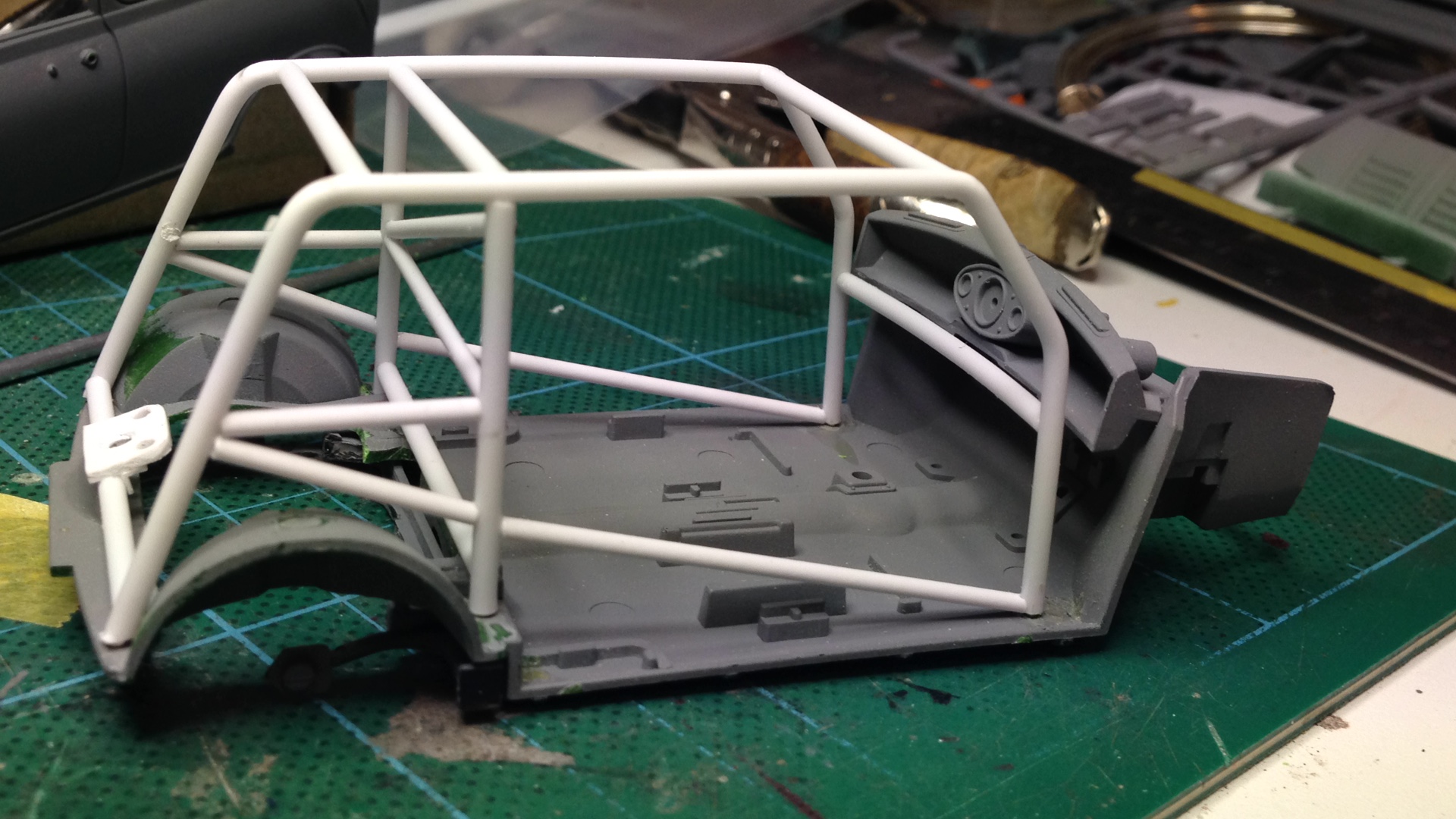

geetee66 Posted August 16, 2018 Author Posted August 16, 2018 It's been a while... Work prevented progress ? I had a go at one roll cage, but it looked too fat and I didn't like the shape:

geetee66 Posted August 16, 2018 Author Posted August 16, 2018 ...so I made another one from thinner styrene rod. I started by putting wire posts in the ends of any vertical parts, and drilled corresponding holes in the floor pan. styrene always wants to return to its original shape. The wire posts helped keep everything in place while I attached the horizontal parts. I used Rocket and Tamiya extra thin cement and it made a good bond.
Dann Tier Posted August 16, 2018 Posted August 16, 2018 2 minutes ago, geetee66 said: ...so I made another one from thinner styrene rod. I started by putting wire posts in the ends of any vertical parts, and drilled corresponding holes in the floor pan. styrene always wants to return to its original shape. The wire posts helped keep everything in place while I attached the horizontal parts. I used Rocket and Tamiya extra thin cement and it made a good bond. Now that looks AWESOME!!!
geetee66 Posted August 16, 2018 Author Posted August 16, 2018 Cheers Dan it's all done by eye, as the markings on my ruler are feint. It's not 100% , but as most of it hides behind bodywork...well.. 1 minute ago, Dann Tier said: Now that looks AWESOME!!! s
Dann Tier Posted August 16, 2018 Posted August 16, 2018 2 minutes ago, geetee66 said: Cheers Dan it's all done by eye, as the markings on my ruler are feint. It's not 100% , but as most of it hides behind bodywork...well.. s You said it right there, Guy....."by eye", it totally looks perf!!…..models aren't displayed under magnifiers, and IF they were, that'd be one weird person!!
geetee66 Posted August 16, 2018 Author Posted August 16, 2018 Made some modifications and devised a way to mount the engine. I had to remove the rear horizontal bar to fit the engine, after I installed more pipe work to the centre hoop. added some side bars too. now I've got to add some sort of structure for the rear shocks to bolt to.
