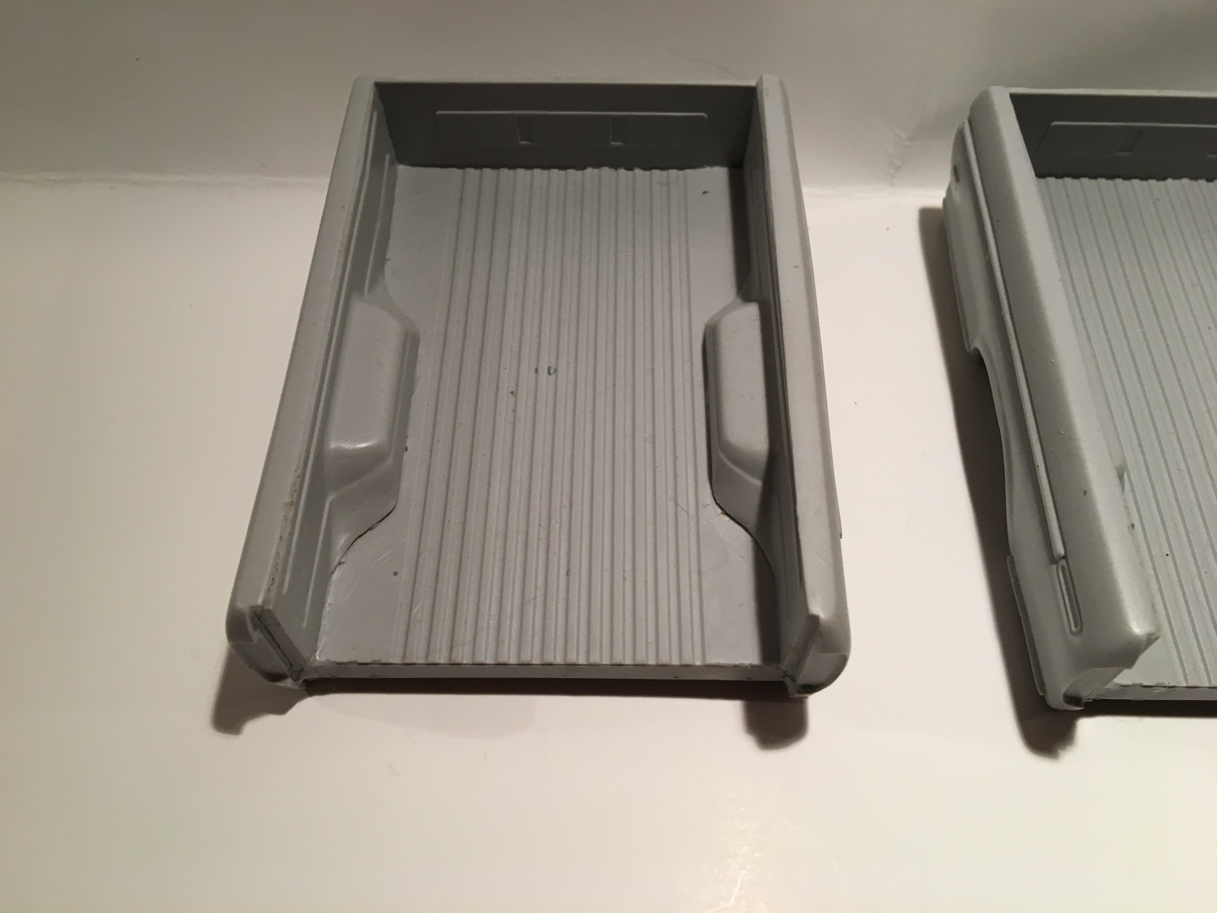

Fat Brian Posted June 28, 2018 Posted June 28, 2018 The other issue you're going to run into is that this kit has the bed toolbox on the passenger side so the inner bed side is different from the drivers side. To make a correct 133" bed the wheel arches need to come forward but also down. Here's the two beds from the same angle.
crowe-t Posted June 29, 2018 Author Posted June 29, 2018 Brian, Thanks for posting these 2 pictures. I know exactly what you are saying. I downloaded pictures that Repstock(Tom Ellifritt) has in his Photobucket showing what needs to be cut and moved to make a correct 133" bed. He shows a good way to lower the wheel arches. I'll remove the bed tool box too.
mk11 Posted June 29, 2018 Posted June 29, 2018 Here's another great thread on the box modification procedure... ...also, the compartment built into the box side on the camper special is actually a spare tire compartment; that's why the inner wall is shaped like it is. The regular toolbox is shown in the second pic. mike

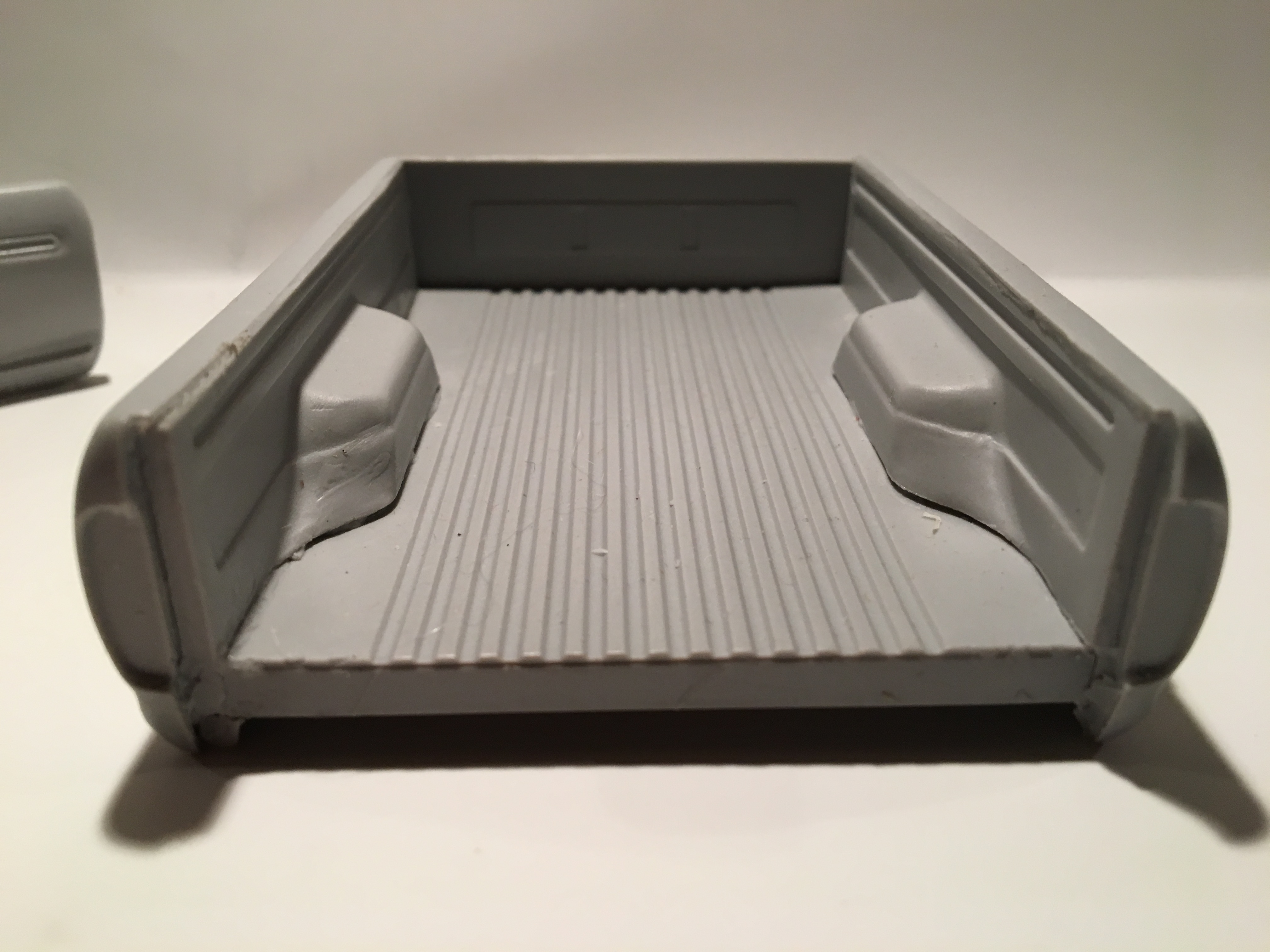

Mercuryman54 Posted July 13, 2018 Posted July 13, 2018 Got these a couple years ago at a swap meet in Indy. I can't recall who modified and cast them. I haven't seen him at the swap meet since. Dennis
leafsprings Posted July 15, 2018 Posted July 15, 2018 I thought we would have a good quality regular '73-'79 8' F 100- F250 bed readily available in resin by now.

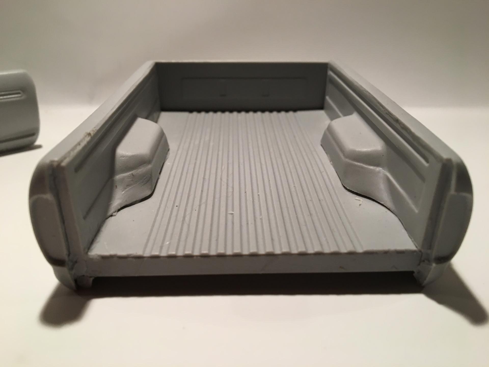

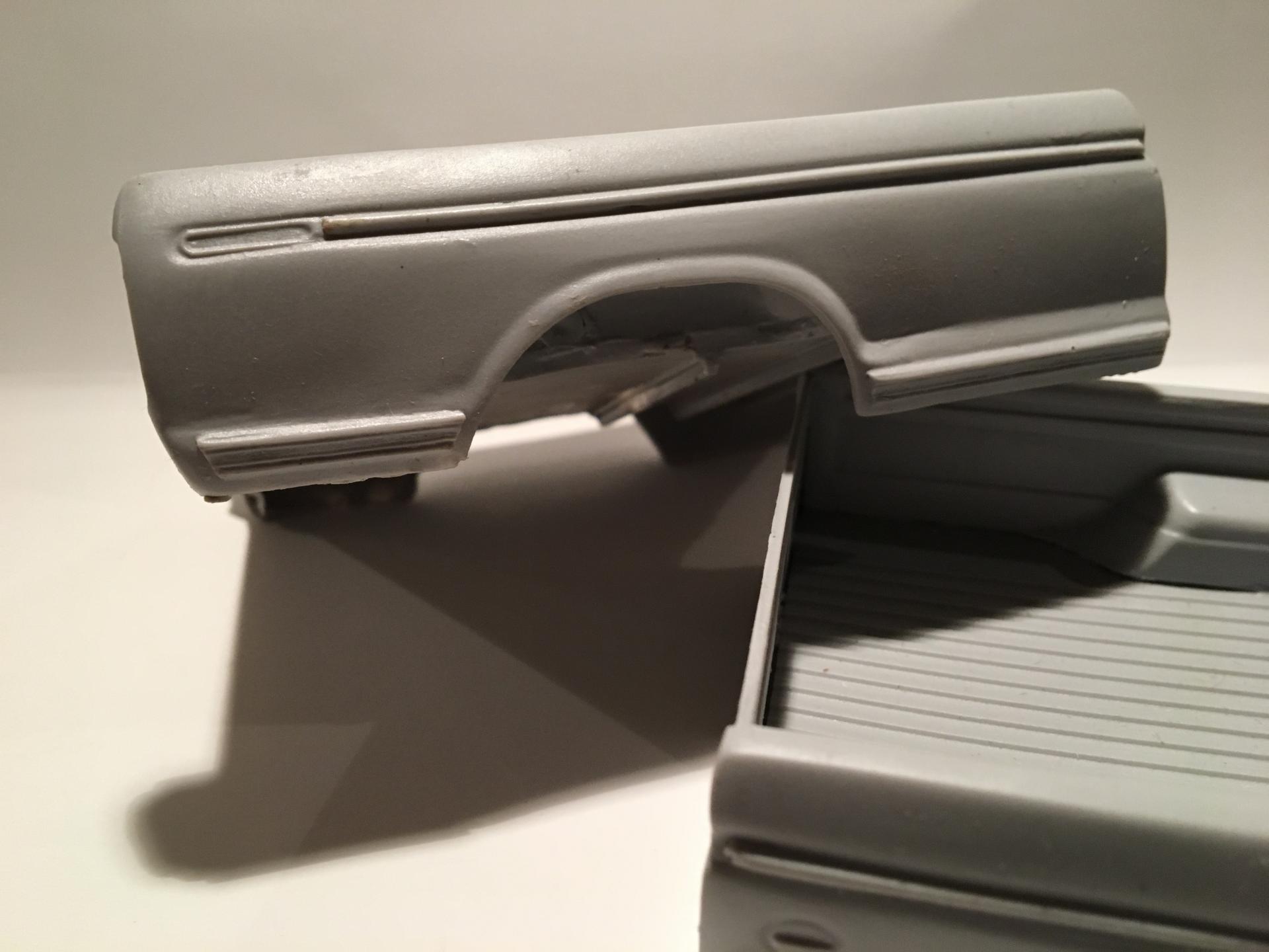

Repstock Posted July 17, 2018 Posted July 17, 2018 (edited) It's not a good pic, but here's the Morgan Automotive detail Ford bed, dechromed. Edited July 17, 2018 by Repstock
leafsprings Posted July 18, 2018 Posted July 18, 2018 13 hours ago, paul alflen said: DOESN'T MORGAN AUTOMOTIVE DETAIL DO ONE??? Not shown on their website, only shows the Chevy Longbed being available.
Repstock Posted July 18, 2018 Posted July 18, 2018 8 hours ago, leafsprings said: Not shown on their website, only shows the Chevy Longbed being available. That is true, but it is available, I have three of them. I bought mine at shows, but I suppose you could contact him directly.
paul alflen Posted July 18, 2018 Posted July 18, 2018 I'LL SEE HIM HOPEFULLY AT OUR MEETING THIS FRIDAY, JULY 20TH. I THINK THEY ARE STILL AVAILABLE, JUST NOT LISTED IN THE CATALOG/WEBSITE. LEAFSPRINGS , P.M. HIM OR CONTACT HIM ON HIS WEB PAGE.

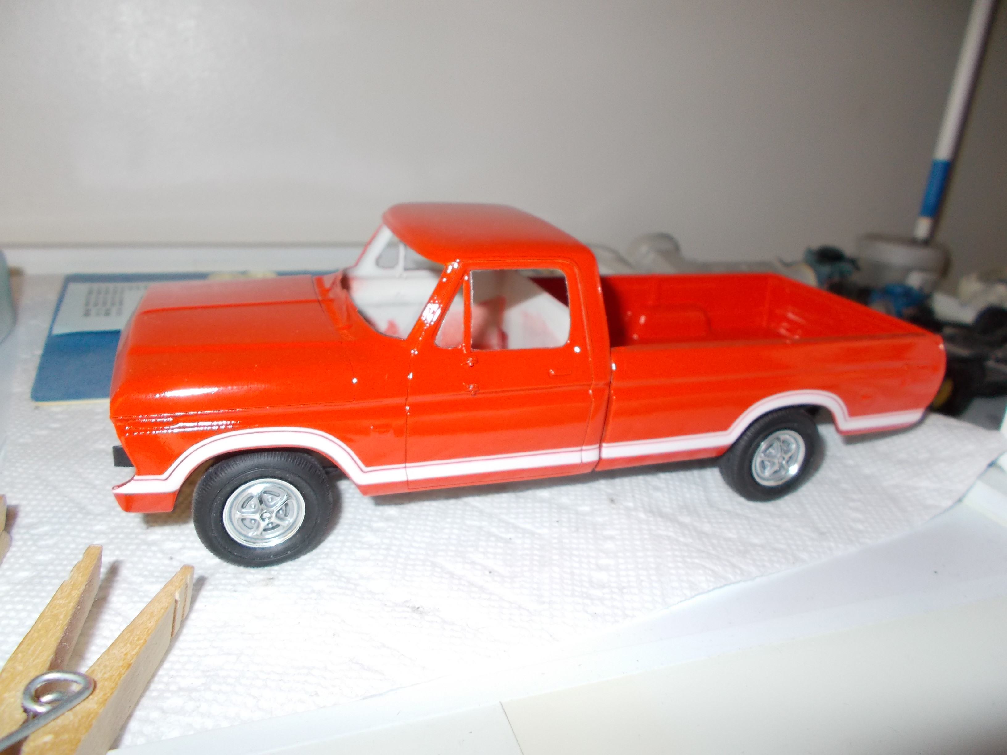

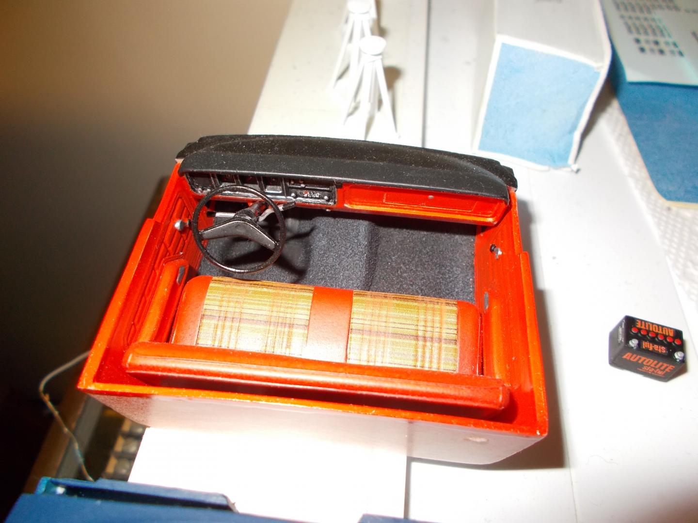

leafsprings Posted July 18, 2018 Posted July 18, 2018 7 hours ago, Repstock said: That is true, but it is available, I have three of them. I bought mine at shows, but I suppose you could contact him directly. Thankyou for the update Repstock. Your Explorer looks great. Factory colors, paint stripe and molding deletes are right on target, can't wait to see the special plaid bench seat!
Repstock Posted July 18, 2018 Posted July 18, 2018 1 hour ago, leafsprings said: Thankyou for the update Repstock. Your Explorer looks great. Factory colors, paint stripe and molding deletes are right on target, can't wait to see the special plaid bench seat! Here you go...
