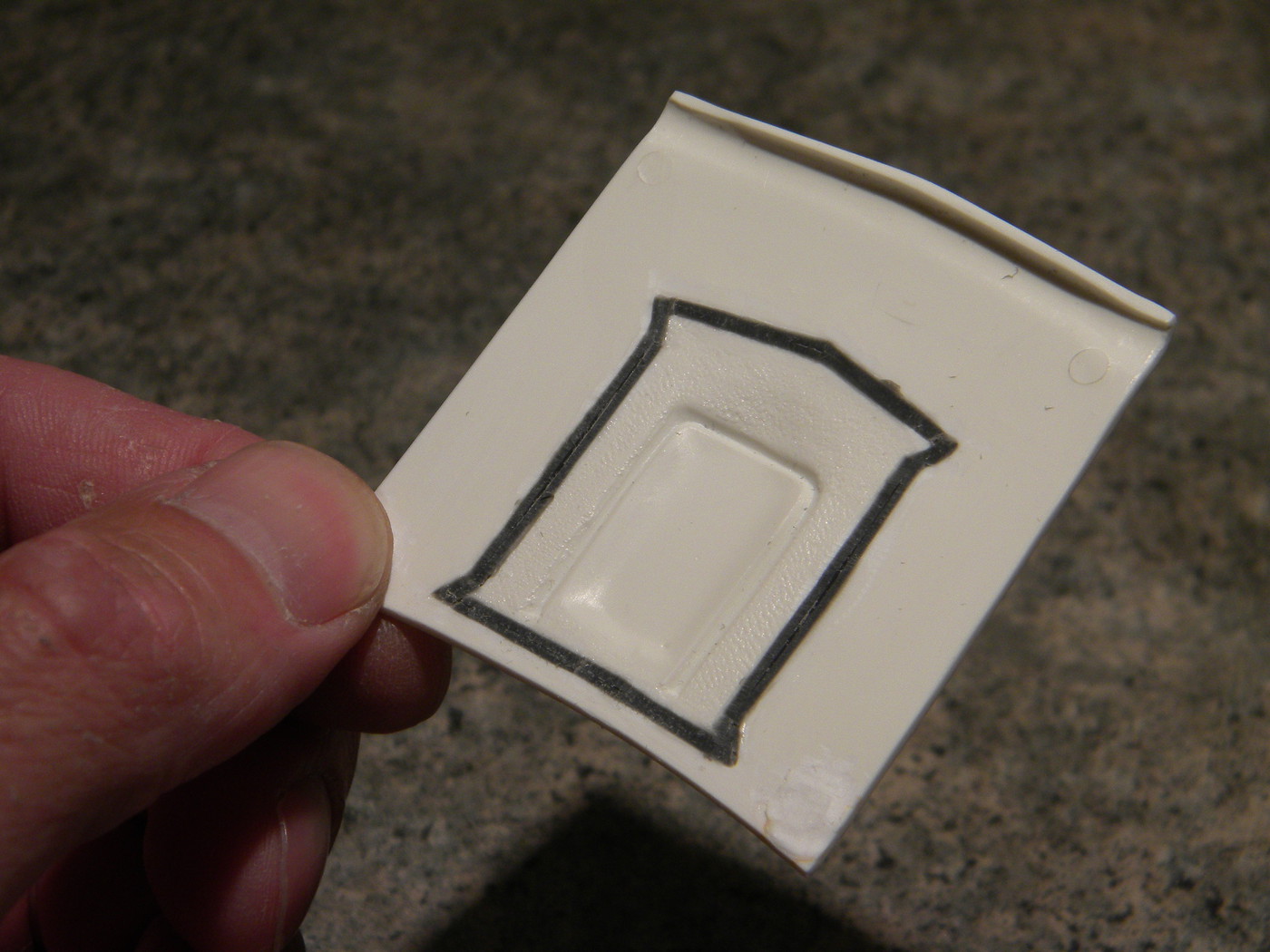

ChrisBcritter Posted June 27, 2018 Posted June 27, 2018 (edited) The other day, I filled the cutout areas under the hood of my '61 Tempest with Bondic UV resin and cured it for about 15 minutes. Hasn't affected the top side of the hood. Yet. If I live to regret that idea I'll let you know right away! Edited June 27, 2018 by ChrisBcritter
StevenGuthmiller Posted June 28, 2018 Posted June 28, 2018 10 hours ago, ChrisBcritter said: The other day, I filled the cutout areas under the hood of my '61 Tempest with Bondic UV resin and cured it for about 15 minutes. Hasn't affected the top side of the hood. Yet. If I live to regret that idea I'll let you know right away! I think that's a great idea. The only draw backs to these UV glues is that they don't adhere particularly well & the don't cure real hard. But I think in this instance, it may work quite well. Steve
ChrisBcritter Posted June 28, 2018 Posted June 28, 2018 Oh yes, I hit the areas with a coarse sanding stick first to give the resin something to bite into.
