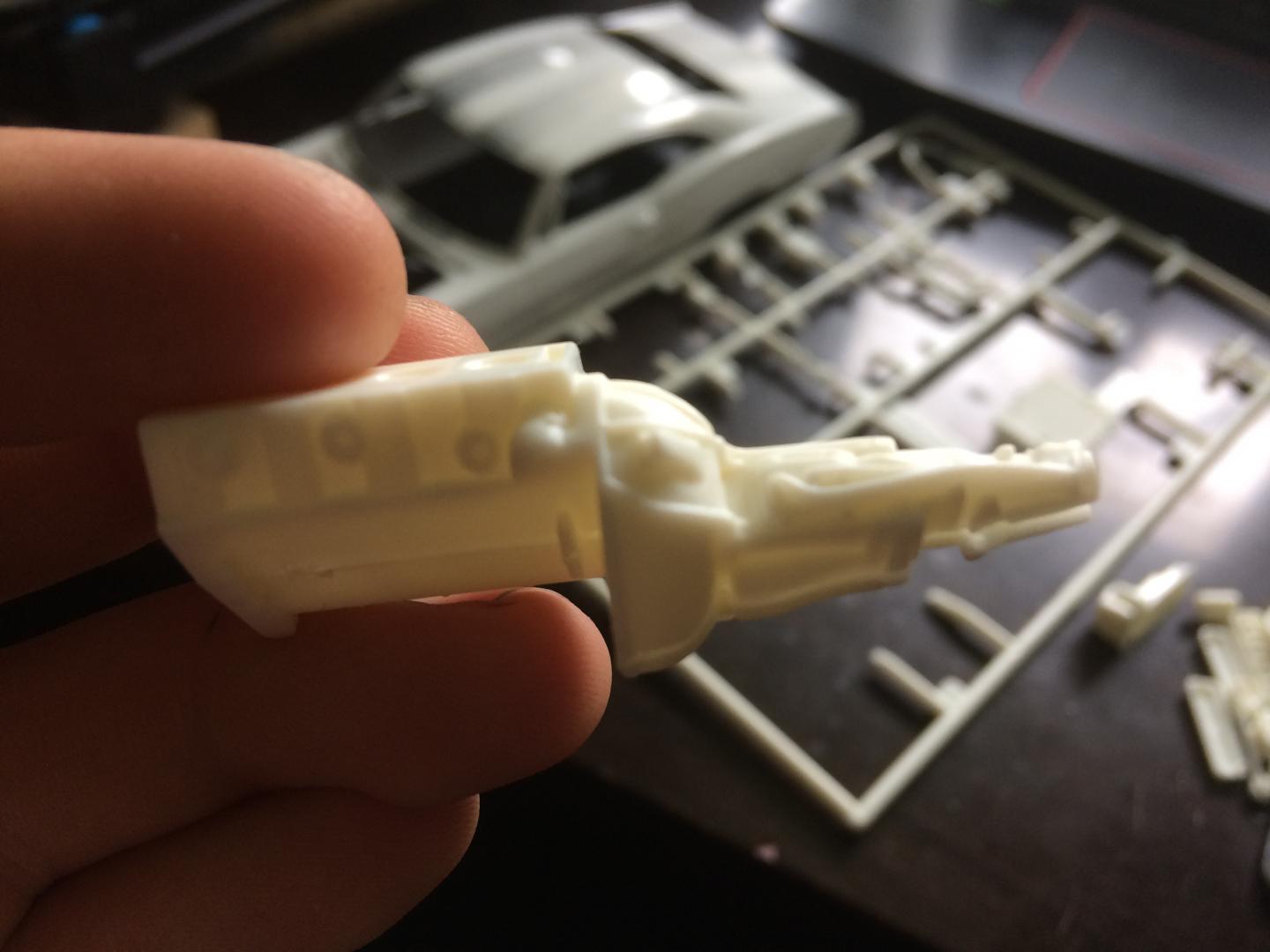

espo Posted June 29, 2018 Posted June 29, 2018 You have mentioned thinking that the kit represents a 3 speed manual transmission. I think you're mistaken. Look very closely at the drivers side of your engine/transmission part. There is three very faint ridges representing the shift linkage. The bottom two are for the 1 - 2 gears and the next up is for 3 and 4th gear. the top one is extremely short and is for reverse. The Brake and Clutch pedals are hung from the bottom of the dash board, unless yours have been broken off at some point. If you don't already try Googling '67 Impalas or Chevrolets. This will give you pictures from allover the Net to give you a general idea of how they looked 1:1. Beyond that this builds up into a very nice looking kit and you should enjoy building it. I personally like these cars a lot and I will watch what all you do with it.
THORDOOR220 Posted June 29, 2018 Author Posted June 29, 2018 Now that I've looked closer, I think it is the 4 speed manual after all. It resembles this 3 speed used at the time (this one is out of a 66 chevelle) very closely, and I knew a lot of the SS cars had a heavier duty 3 speed, so that's what I assumed was in it. I was at least sure of the manual part, since it lacks a lower pan. Thanks for pointing that out. Also, I looked at the dash. It doesn't appear to even have a place for a parking brake pedal. Had it broken off, you would think there would at least be a sign of where it was. At the least, if the parking brake was on there, I don't have it anymore. Upon closer inspection, I found that the gas pedal is actually molded into the floor, so what I have on the dash is brake and clutch. One less pedal to print at least!

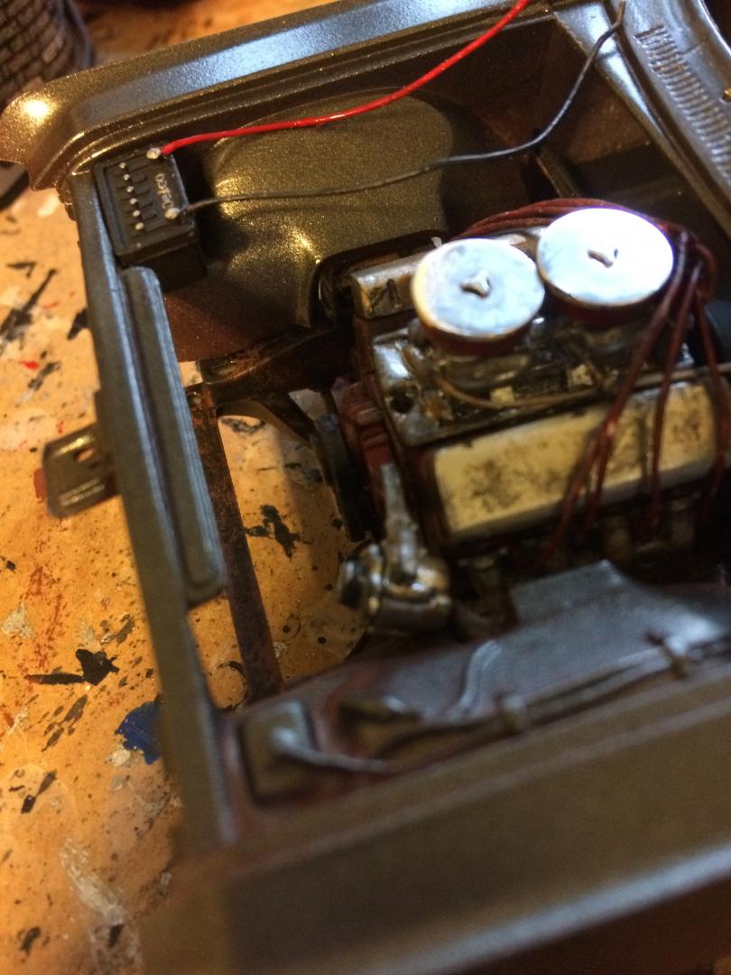

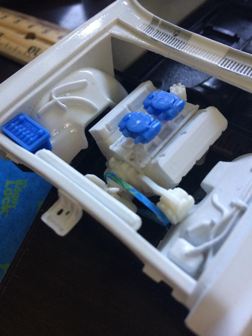

THORDOOR220 Posted July 1, 2018 Author Posted July 1, 2018 Haven't had a whole lot of time to work on it this weekend. What I have done is 3D printed an intake manifold and valve covers, and fabricated a new belt out of masking tape. It's mocked up just using white glue. With old resin belt, the alternator to hit the inner fender, so I trimmed it away to replace it. I have the alternator bracket trimmed where it'll clear better, but this belt I've made is a little too small and pulls the alternator over to where it hits again. I'll be trying to make a better one before the day is over. The battery and carburetors are off of the 66 nova pro street model, which I have yet to build but won't be using them for. I replaced the battery because I didn't like the lack of detail the original had. I forgot a breather on the valve covers, but I think it'll be fine without. I have an air filter I was going to use, I believe it was from a 70 cuda model, but it won't clear the plug wires when I get those attached, so I need to figure something else out for that. Also, does anybody know what those molded lines on the inner fender are for (shown in the left of the picture)? I first thought battery cables, but they don't line up. I'm thinking about cutting them away if that is the case, since I'll be using actual wire for them.

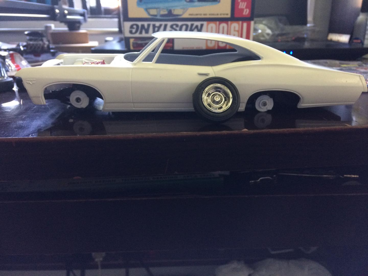

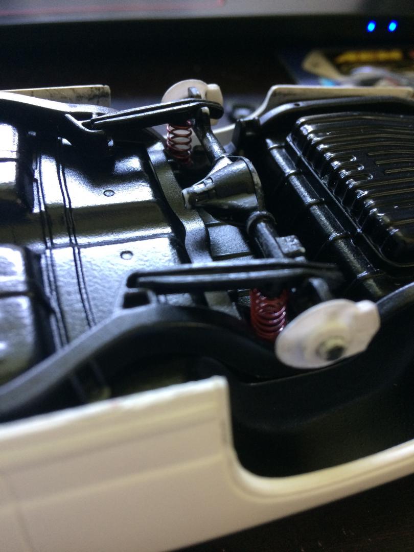

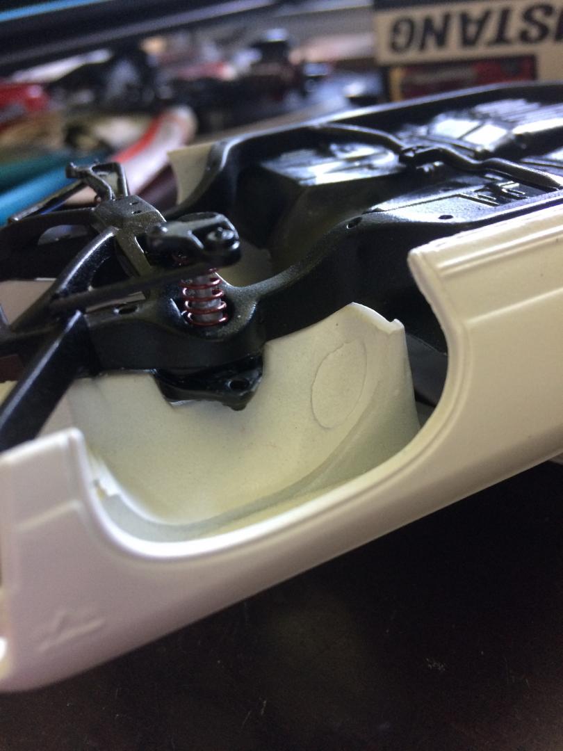

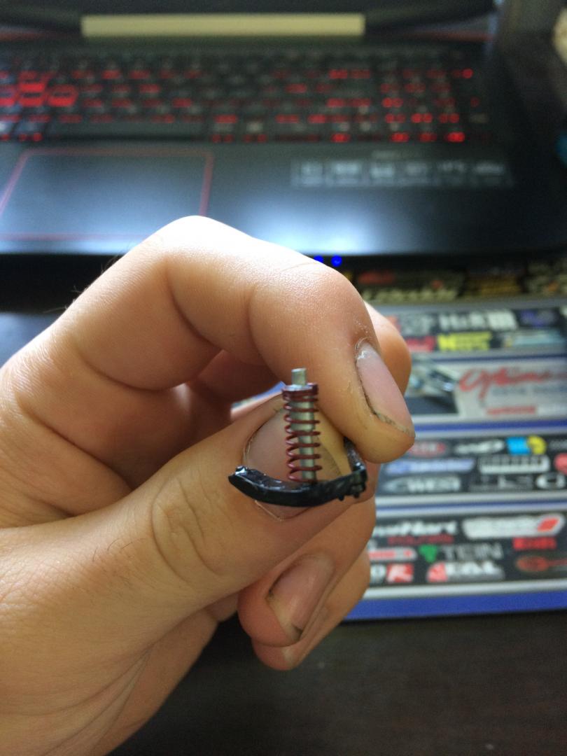

THORDOOR220 Posted July 8, 2018 Author Posted July 8, 2018 (edited) I've had a fair amount of time to work on it this week. I've made new springs and front shocks, I always wanted to do this and finally have, I really rather enjoyed that. It won't be seen much, but I know it's there. The suspension won't be fully functioning on this one but it's close. I also made some simple disk brakes for all four corners, and cut the wheel backs to allow it. I have some small pieces of sprue I drilled out to use as spacers, if you will, for the wheels. That way they aren't too far in and hitting on suspension components. Those, along with the cut wheel backs, are chrome painted. I was going to do bare metal foil on them, but decided I'd be weathering in there enough that it didn't matter that much. There's one picture I'll include where you can See the car sitting with the suspension and brakes on, and a wheel as reference, so you can kind of imagine how it'll sit. I also started making brake lines for the back, then realized I set them up to be on the bottom of the differential. Whoops! Gotta reshape those. The last image is of where the engine currently sits. The valve covers have bare metal foil, but the intake is just chrome paint. I've got the plug wire holes drilled out and wires in place (with the proper firing order for a 427 chevy, I almost forgot that part!). I made a small ignition coil and mounted that to the intake manifold, and have a wire running there, too. The wire I have is white, so I painted it red. I apparently didn't give them enough time to dry, so I need to touch up, but that shouldn't be a problem. I have yet to black wash any of these components to bring out detail, but it's on my list. Also have holes for fuel lines and throttle cables drilled out in the carburetors, though I don't have a picture. I have silver beading wire to use for fuel lines and throttle cable, it should hopefully look alright. Still have to figure something out for an air filter. I'm not super fond of having an individual one per carburetor, but I might have to go with it. I'm considering trying to add A/C as well, scratch built. I'm working on a 67 Cutlass with factory A/C at work, so I might use that as a basis for how to do mine, and I intend to use it's exhaust setup, too. We shall see. Anyways, back to work. Edited July 8, 2018 by THORDOOR220

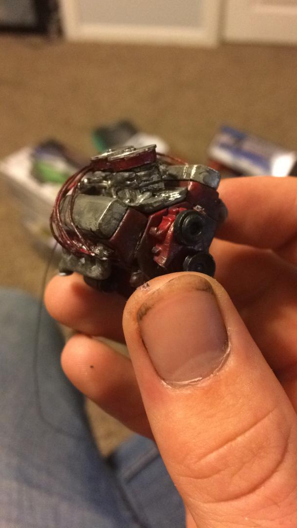

Snake45 Posted July 9, 2018 Posted July 9, 2018 There's a nasty-looking red spider on top of your engine.

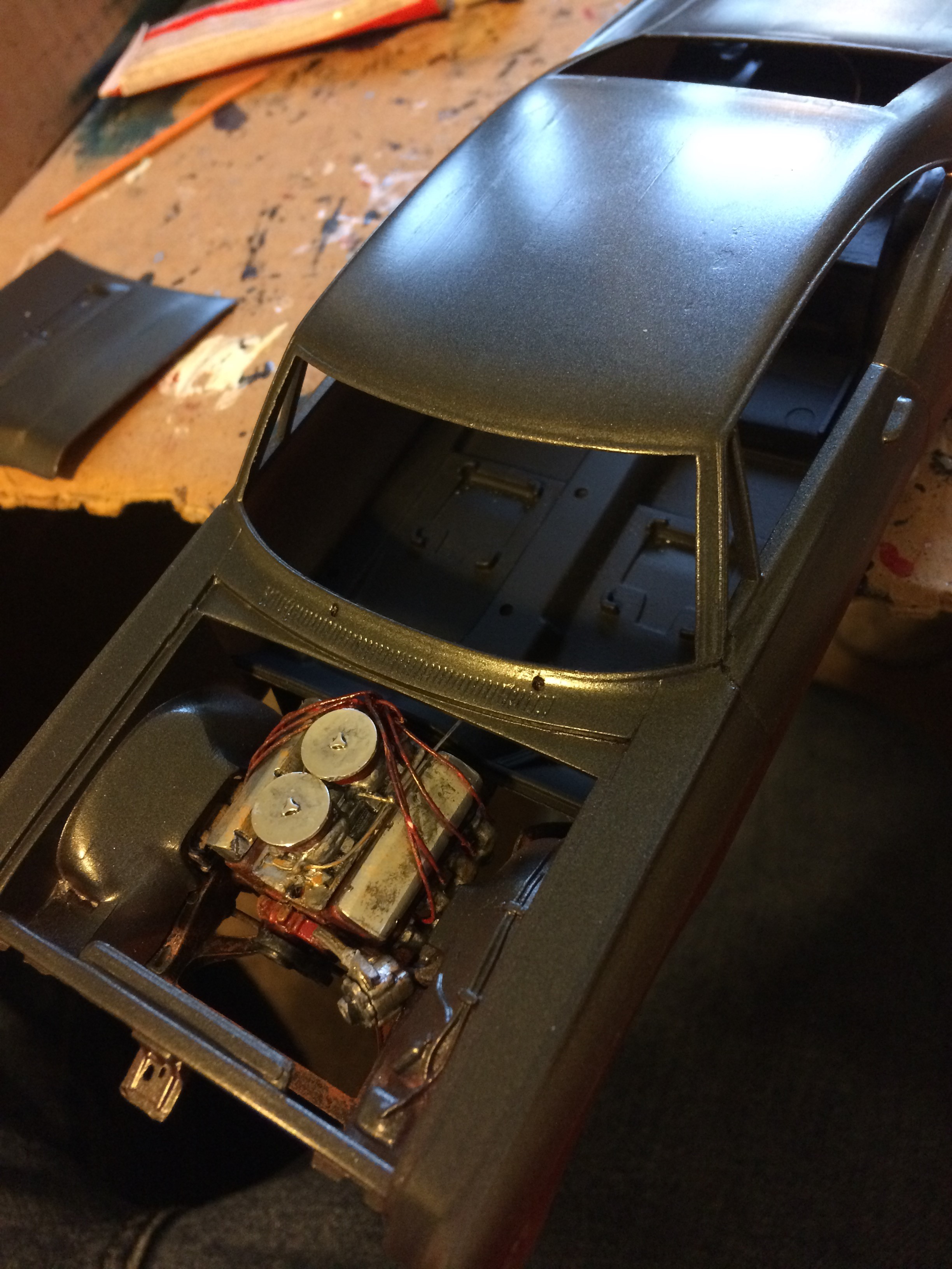

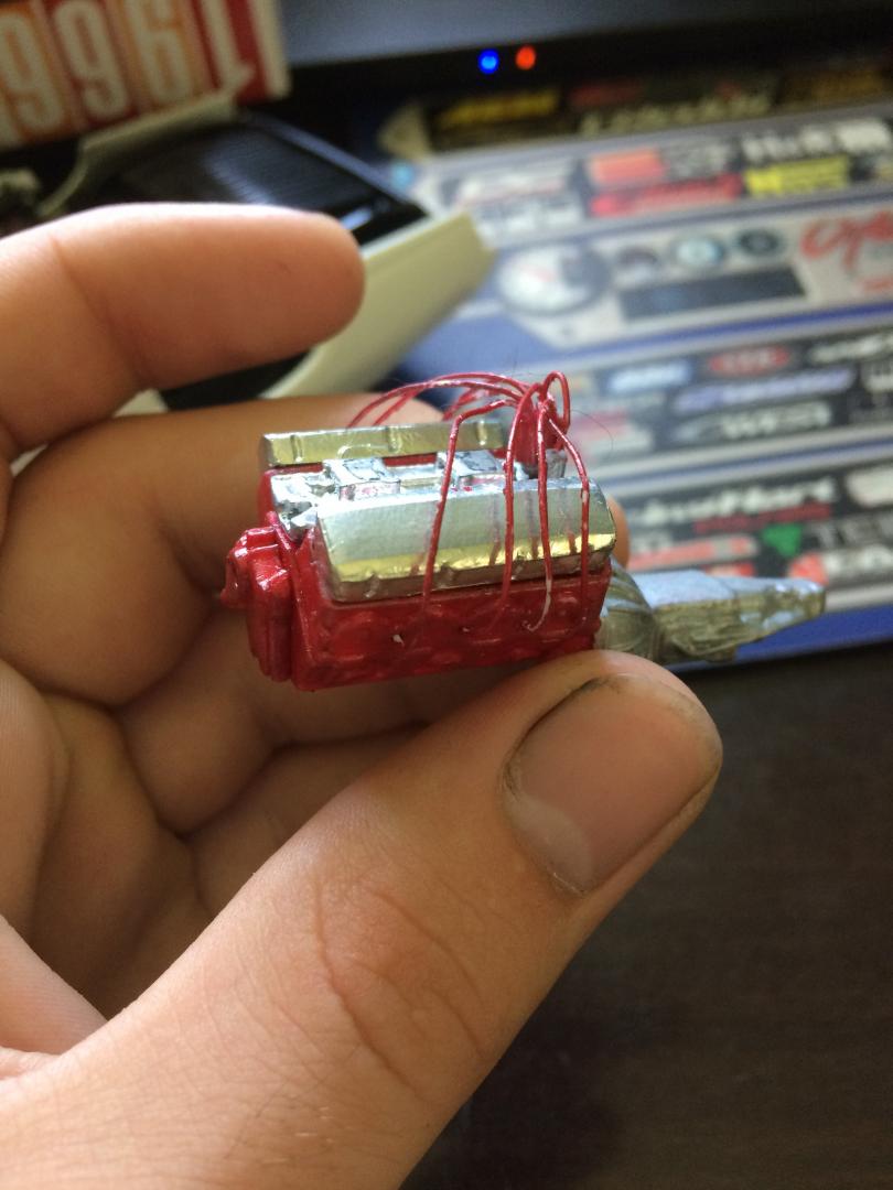

THORDOOR220 Posted July 9, 2018 Author Posted July 9, 2018 I thought the same for a while. For final assembly, I trimmed them a bit. I'm kind of going for a messy look with it, so I'm not using any plug wire looms or anything. It's also had a lot of black wash. This is where it's at after tonight, I'm going to finish it tomorrow.

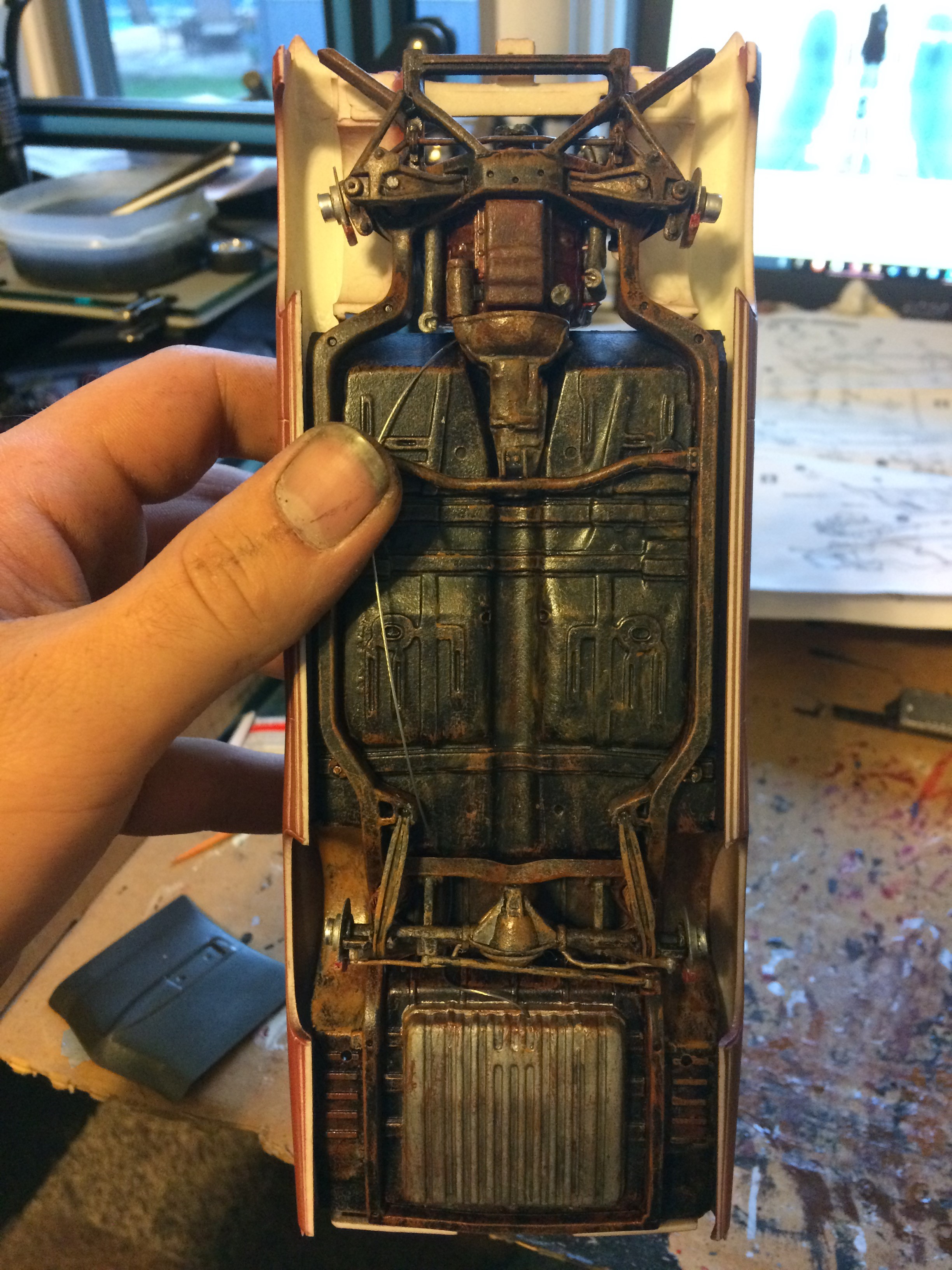

THORDOOR220 Posted July 15, 2018 Author Posted July 15, 2018 Had an unfortunate mishap that ruined the clear coat on the model, and in the process of trying to fix it, I burned through the paint. I tried to strip the paint with Purple Power, which mostly worked, but there are a few spots that refuse to come off. The stripes won't at all, not even peel up. So I'm currently trying to get the body straight with a bit of sanding, which is mostly working. I'll be repainting the model over the next week, with a bit of a change. I'm out of the diamond dust Testor's paint I used for the stripes, and I figure contrast won't hurt, so I'm using Ford's Dark Shadow Grey for the new stripes. This is actually going to be a bit helpful, as it's going to be identical to how I was thinking about my 69 nova project (real car, not scale). Other than that, I haven't gotten very far this week. I got the belt, alternator, and fan attached to the engine, have yet to blackwash those portions but will tonight. Interior is painted flat black, still have a lot of detailing to do there. Also intend on attaching suspension parts either today or tomorrow to the frame, so I can have the car mocked up on wheels at least, since wheels have a little work yet. I'll probably post update pictures with whatever is done tomorrow evening.

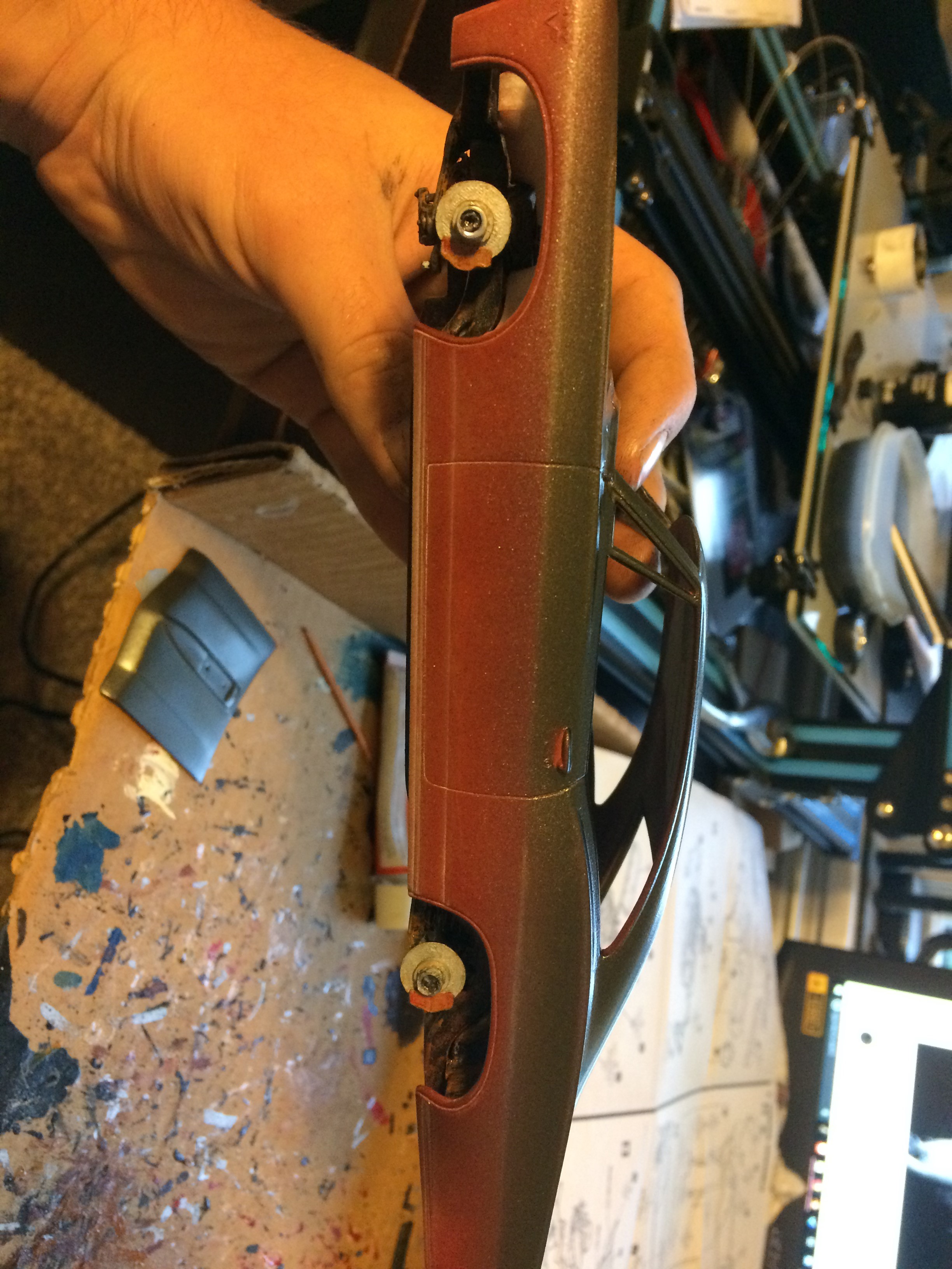

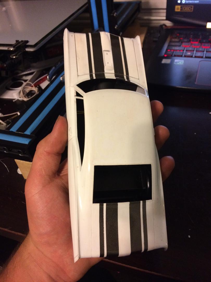

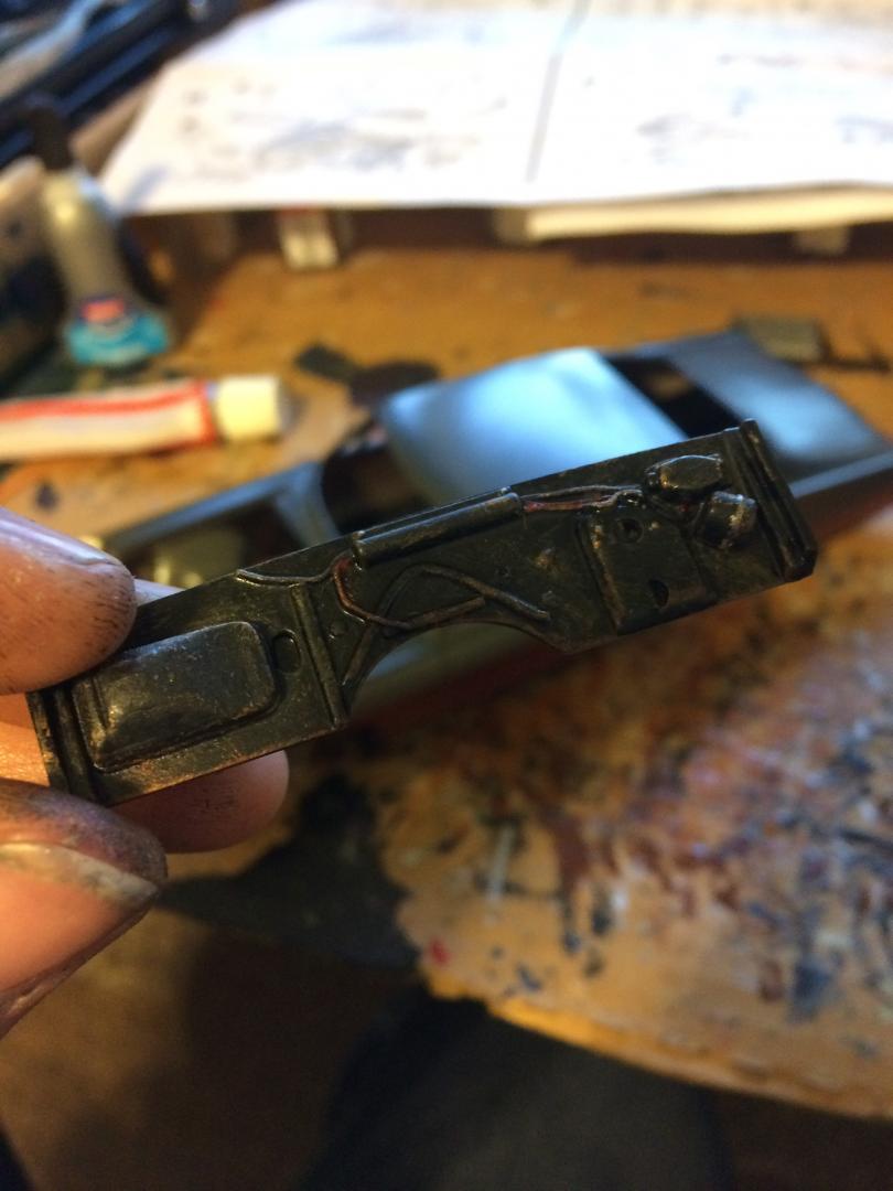

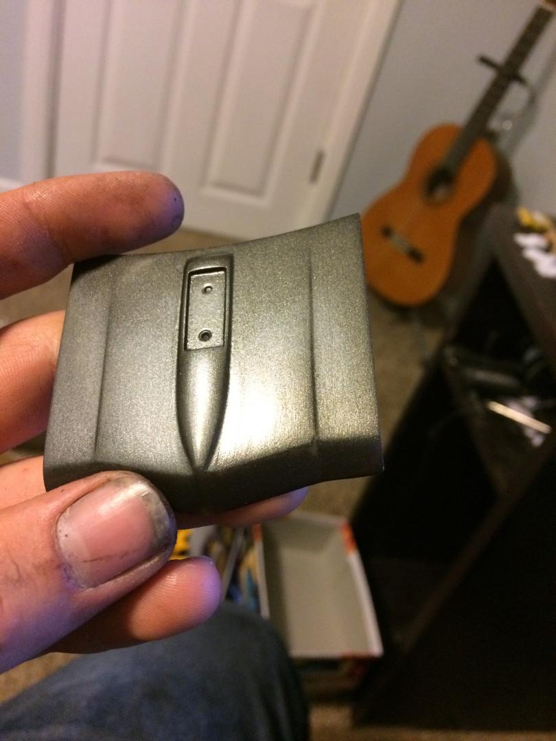

THORDOOR220 Posted July 16, 2018 Author Posted July 16, 2018 (edited) 12 hours ago, MeatMan said: Sorry to hear about the mishap. Otherwise, nice going! Thanks, it's definitely a learning experience so I'm glad I can do alright as I learn. So here's some pictures. You can see the new stripe color, which looks a little more brown in person. Mind the red primer. Not ideally what I want, but we'll see what it looks like with the white. I'll be masking the stripes yet tonight, just figured I'd do pictures beforehand. The firewall is detailed, though dark. Very dark. There's a small hole in it for the throttle cable to go through. You can see the cable in one of the pictures, it's not really how dual carburetors work but it works for this project at least. I got all the suspension on, except the steering. I want poseable steering, which it currently how it is. The catch is the steering linkage falls off when you flip the model right-side-up. I'm working on how to fix that, I have a couple ideas. Worst case scenario, I find a pose I like at the end of the build and glue it in place. Unfortunately, that isn't my only problem. The alternator doesn't quite clear the upper control arm. I'm going to need to make a new bracket for it and raise it up, and then do the belt and fan. I've also got the fuel line mocked up, though it's not held in place. It'll run along the frame, just not yet. And the battery is detailed, still need to attach the wires to the starter and frame. The last thing to point out is the weathering on the underside, which I might have gone *slightly* overkill with it I'm thinking that since the paint isn't going to be super nice after the mishap mentioned yesterday, I'll have it something that isn't real well taken care of. I wanted it to be driven, not a show car, so this I think is just a step further. So I suppose the next step (besides fixing the steering and alternator) is interior. I'll put in my valve stems first, and perhaps attach a picture to this post when I do. I just remembered them, and they shouldn't take long. As stated before, suggestions are welcome, as are any comments. Added a picture of the valve stems. So tiny! Edited July 16, 2018 by THORDOOR220 Added an image

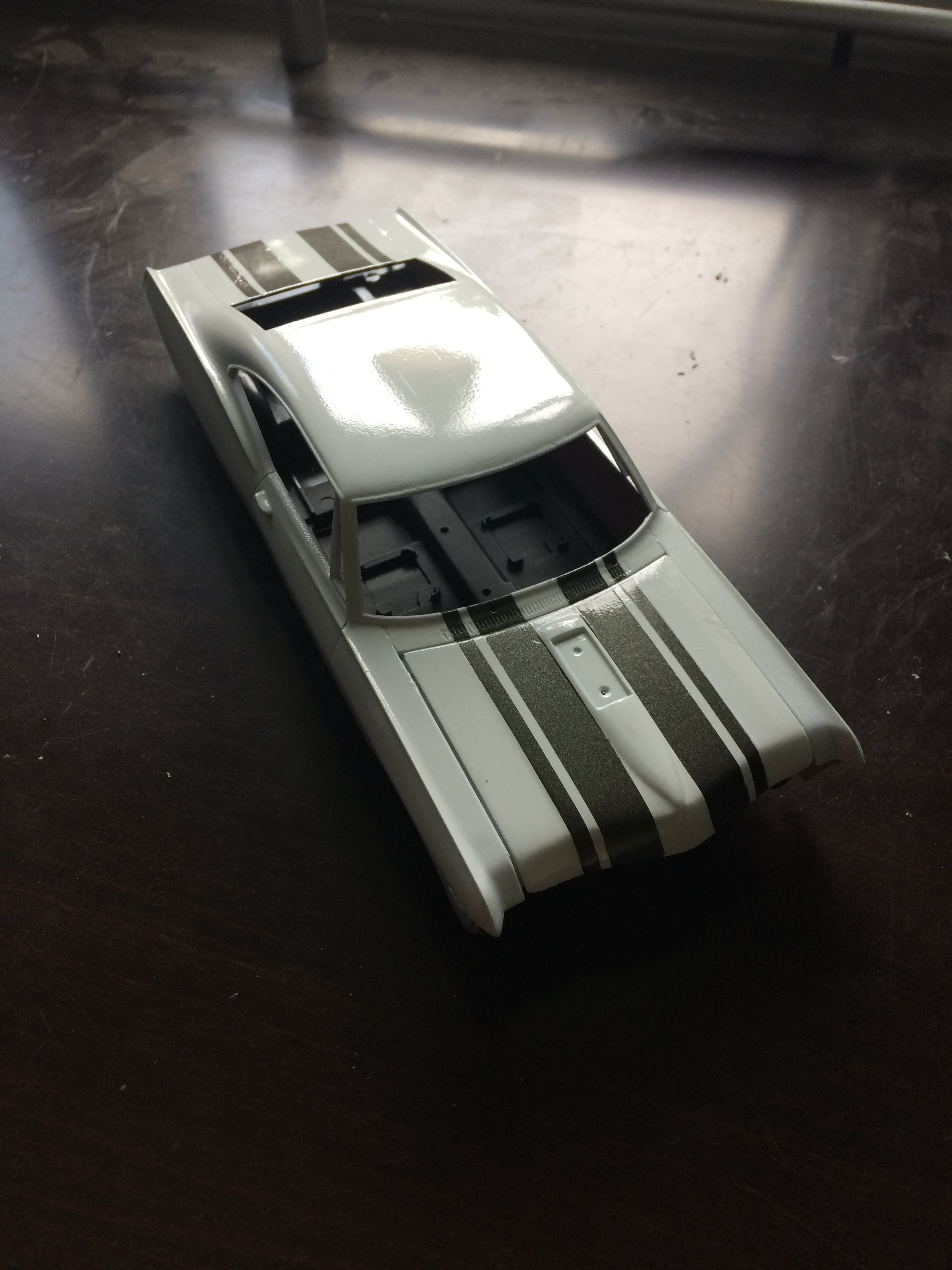

THORDOOR220 Posted July 16, 2018 Author Posted July 16, 2018 Here's the new paint. I have yet to wet sand it, that'll be tomorrow followed by another layer of clear and then buffing to get it all smooth. I was happy to find that the stripes appear darker with the white around them, and the brown is gone. I'm happy with how it looks, almost sad that I'll have to dirty it up. Speaking of dirtying things up, I'm going to want to dirty the glass up a bit. How have you guys done that? I imagine using a compass to mark out masking tape for where the wipers would be effective, but the actual weathering part I'm unsure of what to do with it.

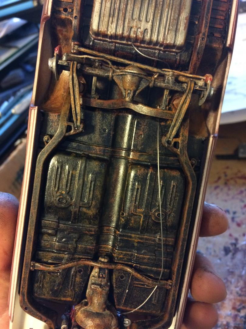

espo Posted July 17, 2018 Posted July 17, 2018 Your idea on the windshield sounds about right. With the masking of the area of the Wipers Sweep area masked off just a light coat of Flat Clear would give the effect you're looking for. Your Chassis looks like a car that has seen a lot of Winter Road Salt. If you're going to distress the exterior remember these cars were notorious for the rear windows rusting out in the lower window Chanel.

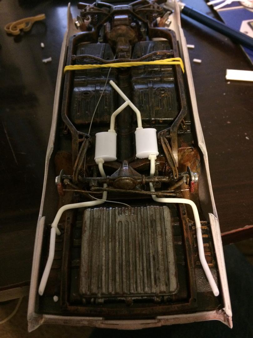

BigTallDad Posted July 25, 2018 Posted July 25, 2018 (edited) Very nice work so far! I noticed the yellow rubber band wrapped around the frame; here's an easier way to do it http://www.modelcarsmag.com/forums/topic/102170-variable-length-rubber-band/#comment-1429461 Slide the loose rubber band around the part(s) and tighten it via the clip. This reduces the risk of breaking off protruding pieces when wrapping the rubber ban. The same holds true when removing the rubber band. Edited July 25, 2018 by BigTallDad

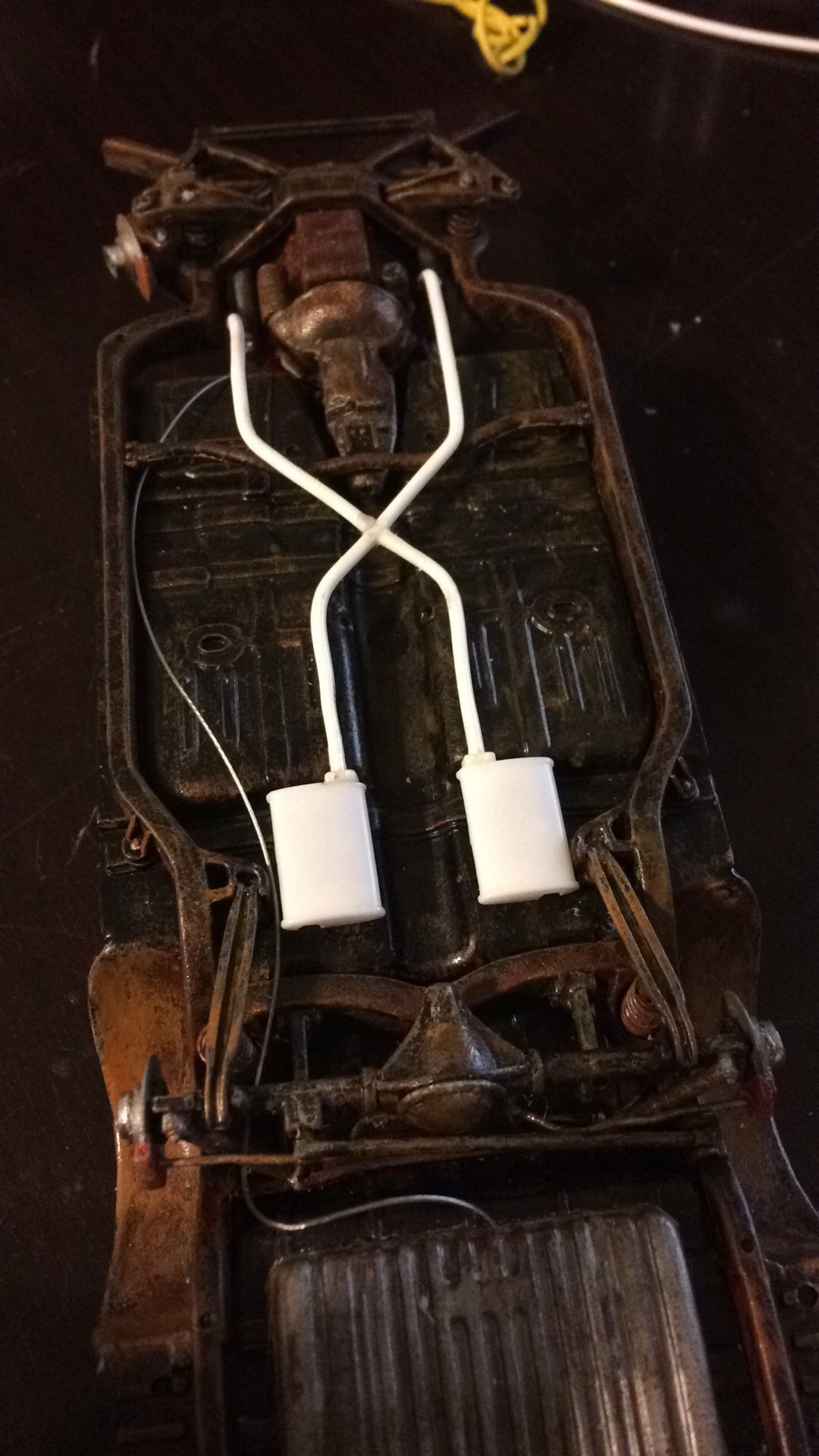

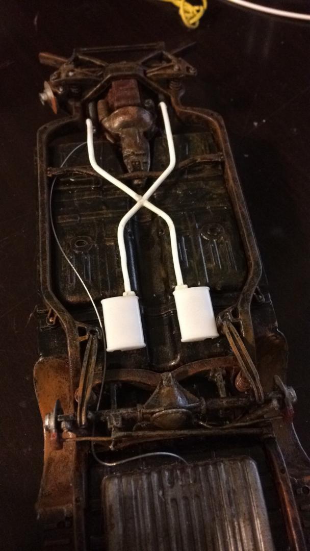

THORDOOR220 Posted July 26, 2018 Author Posted July 26, 2018 2 hours ago, BigTallDad said: Walmart, in the camping area as well as the sewing area. JoAnn Fabrics also carries them, but at a higher price. I'll have to go pick one up (or a couple?). Thought I'd show where I'm at with the exhaust while I'm here. Restarted, same mufflers as I was going to use. The fittings are from the Impala's original exhaust. I'm using PLA filament (1.75mm) for the piping. It doesn't glue very easy, but it's easy enough to work with otherwise.
